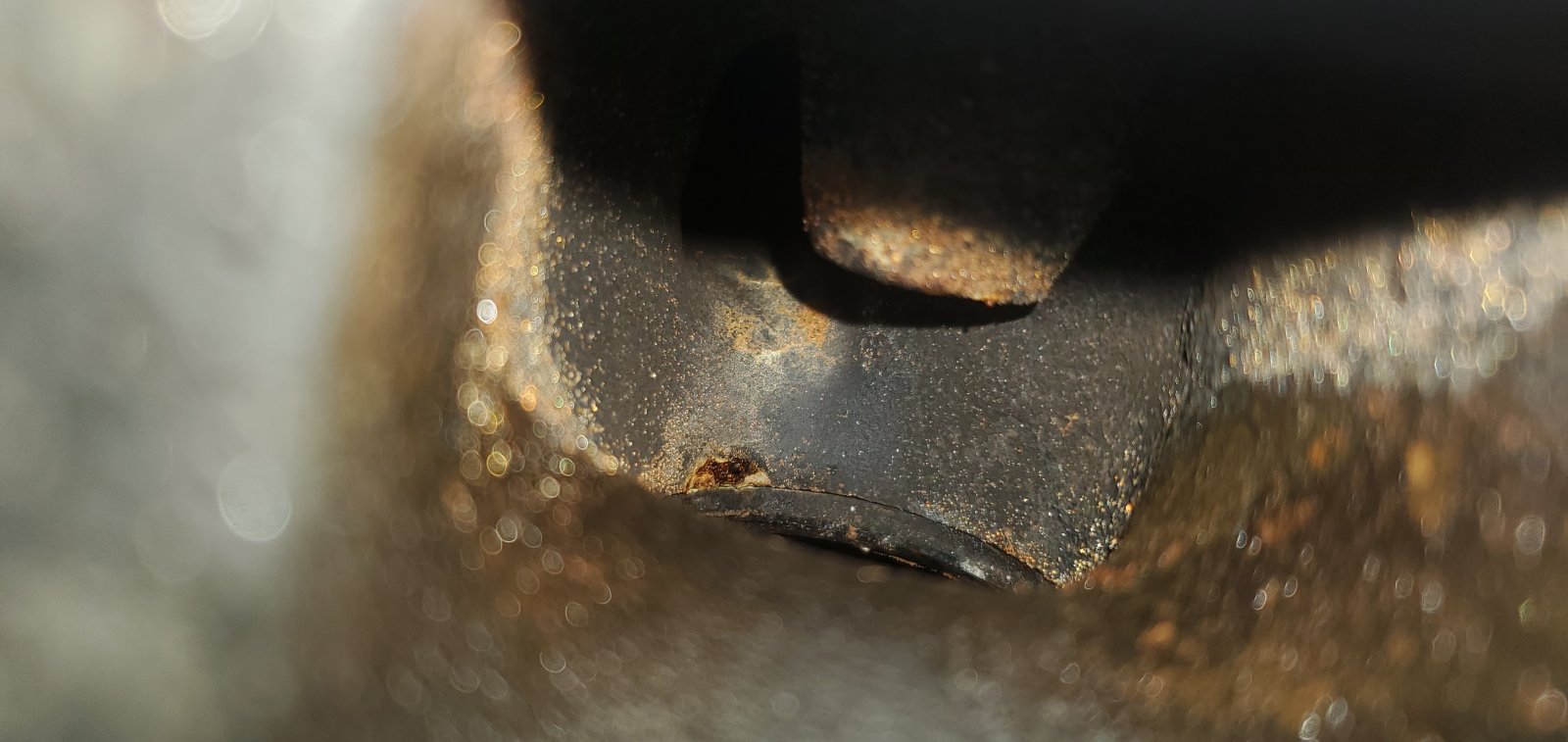

    For the longest time we were fighting cylinder #7. This time it was #5. The valve itself broke. The bottom half of the stem and head are gone. And like said prior, both were in good condition and in place as should be. Below is a pic of #5 exhaust. It blew up bad enough that it spit **** out of the exhaust. But some was caught at the bottom of the header dump. 20221210_112802.jpg

  18. saltflats
    Joined: Aug 14, 2007
    Posts: 13,572
    saltflats
    from Missouri
    Am I seeing a hardened seat in there, is that a coolant leak at that stain?
    If so, leaking on the exhaust valve stem could have made the valve hang open.
    Tickety Boo and Dick Stevens like this.
  19. halfsack
    Joined: Dec 27, 2012
    Posts: 230
    halfsack
    That makes sense also due to corrosion on the stem.

  21. halfsack
    Posts: 230
    halfsack
    So im also ***uming that the heads are now junk if they've had hardened seats installed? Which now would also make sense in why I kept getting moisture up in the heads.
