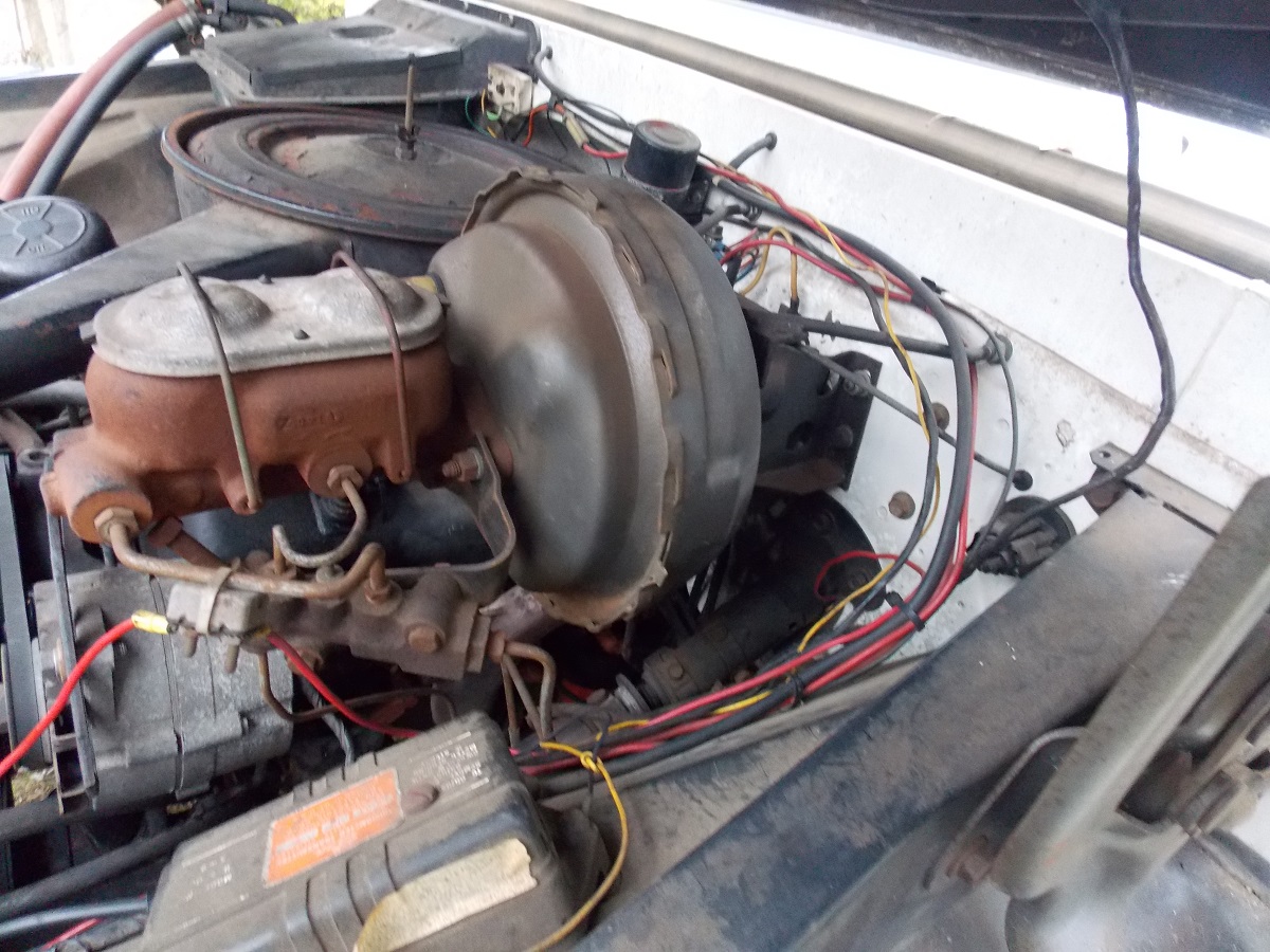

    Take a look at this 72 C20 master cylinder & booster...if it was a 72 C10 master, the front of the master would feed the fronts, but the 3/4 ton master is reversed...the front of this one feeds the rear brakes. No clue why GM did that.??
    The A/T column is one I used on most A/T swaps back then, around 68-70 C series with the chrome shift indicator bezel. Around early 70s the bezel was a bit bigger and plastic which looked too modern for this truck. I also added the tach dash from a 62-63 C60-C70, and I also used the 64-66 big truck grille which looks pretty cool compared to stock C10-C30.
