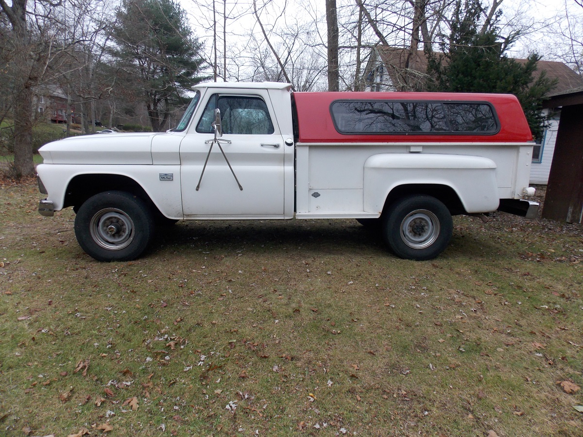

    Forgot to say that I had to build a extra wide stepside so that the camper would fit in.
    I narrowed a set of stepside fenders, then had to add narrowed fleetside inner bed wheel tubs. Only a sharp eye would notice that I also modified the rear fender lips to look like the fronts. I also made the rear steps from 16 gauge. It uses a 67-72 Fleetside tailgate that was a "new take off" that I saw on some guys front lawn for FREE...he had just found it in the attic of his garage when he bought the place,

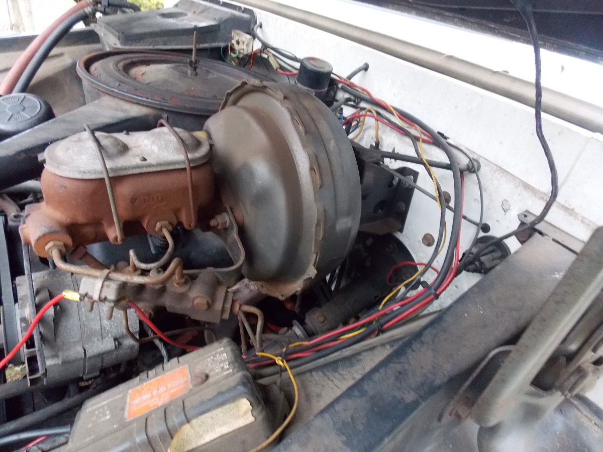

    WOW, great detail and that helps a bunch. I have several junkyards around me; I definitely need the PB, I pump the manual ones up now when braking and they work great but the booster will save some knee pain. I looked on NAPA and they have 10" and 11" which ****s; I don't know what size so I guess I break it down first then get the parts. You all know this already but when doing the "truck" searched with an after market engine throws some things off but this is the journey. I found a driveshaft company on Amazon that will help the customer with the needed measurements for a custom like driveshaft for a couple hundred bucks. I will practice my welding skills on the truck body not the driveshaft hah. Great info Frank thank you!

    It would be great if you could find a stock 63-66 booster, but they are very hard to find. That would be a bolt on in an hour or so. Then put a stock single master to that booster, or it can be swapped to a 67-70 C10 master which were 4 wheel drums, if you want dual circuit brakes.
    I would not put the huge 71-72 C20 booster on your 1/2 ton, it would be overkill...and it's huge and takes up space to work on the motor. A smaller booster will still put you through the windshield the first time you get to try it out. I had to warn every owner of that, when they picked up their trucks. Drums are fine if not worn oversize. ...then the new shoes won't get full contact.
    Discs are simply not mandatory on a daily driver that rarely ever carries very heavy overloads on big long hills. Putting front discs without a booster is just plain counter productive, "if" you are just trying to have brakes that stop quick with very little foot pressure. I live in hill country and built many and drove them as dailys for 2 decades at least.

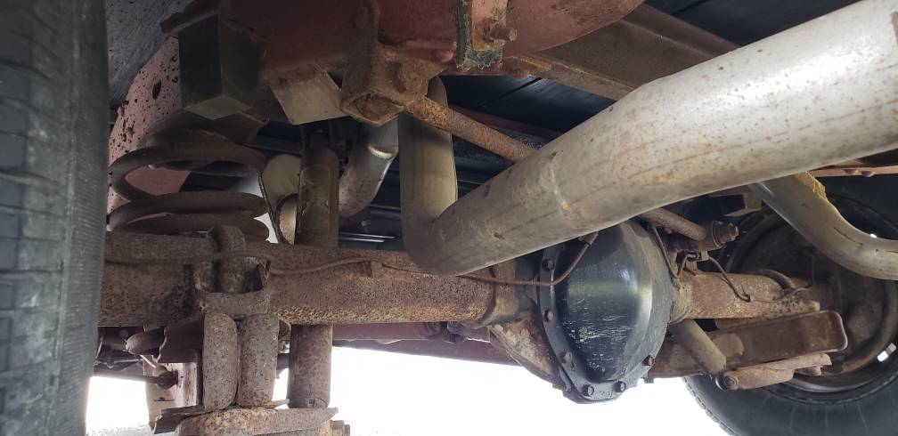

    I need a better pic at the bracket that holds that angled cross rod which is the panhard bar.
    64-up C10 rear has the mounting point casted on to the top of the center section of the rear end. I need a better pic because your mount point looks too close to the center section, but it could be the angle of that pic.
    the 63 mounting point is made of bent-up steel plate and welded to the top of the p***enger axle tube...I just can't tell so far.

    the other end! ...the p***enger side bracket on the axle. LOL. I can wait till you pull the bed.
