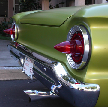

    i cant find any good pics ill have to post em up soon but another easy thing to do is make custom tailights.. with 59 caddy bullet lights.. if i can find some pics of mine ill put em up .. have you looked at the falcons done right thread .. post yours up there. theres so pictures to get ideas from

  29. Did you mention caddy tail lights on a Falcon?
