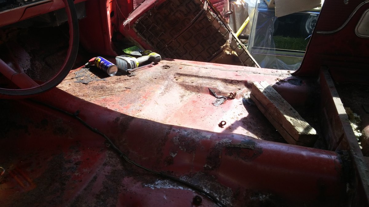

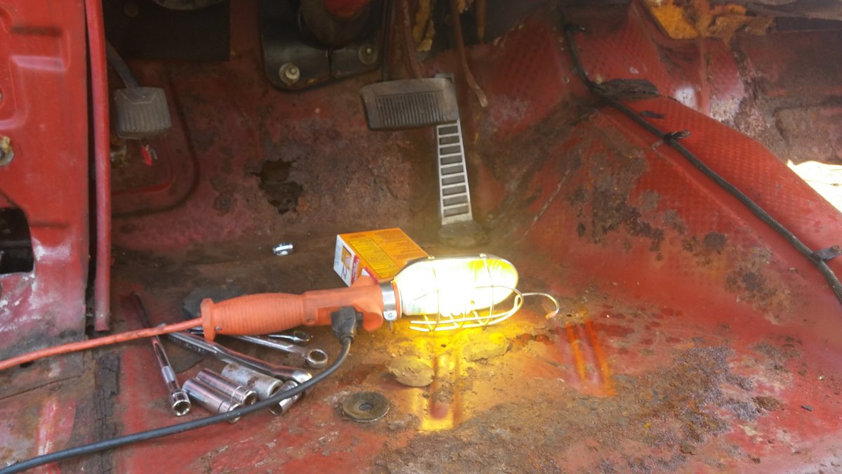

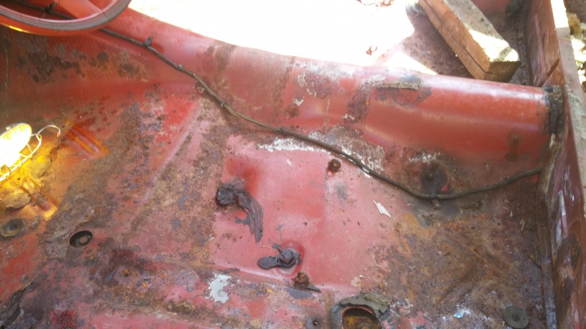

    I removed all the seats and carpets. I cleaned the seats up and gave them a Duct tape upholstery job. I disposed of the mouse pee carpet. Floor is pretty solid, couple of rust holes, but not bad. Dash pad was shot and there was a mouse nest behind the glove box. The dash is rusted pretty bad in the corner by the glove box. I think the mouse pee ate the metal away.

    mice are hard on sheet metal! you wouldn't guess until you seen it. They made quite a bit of rust in the roof of my Edsel, and really tore up the roof of an old Suburban I had.

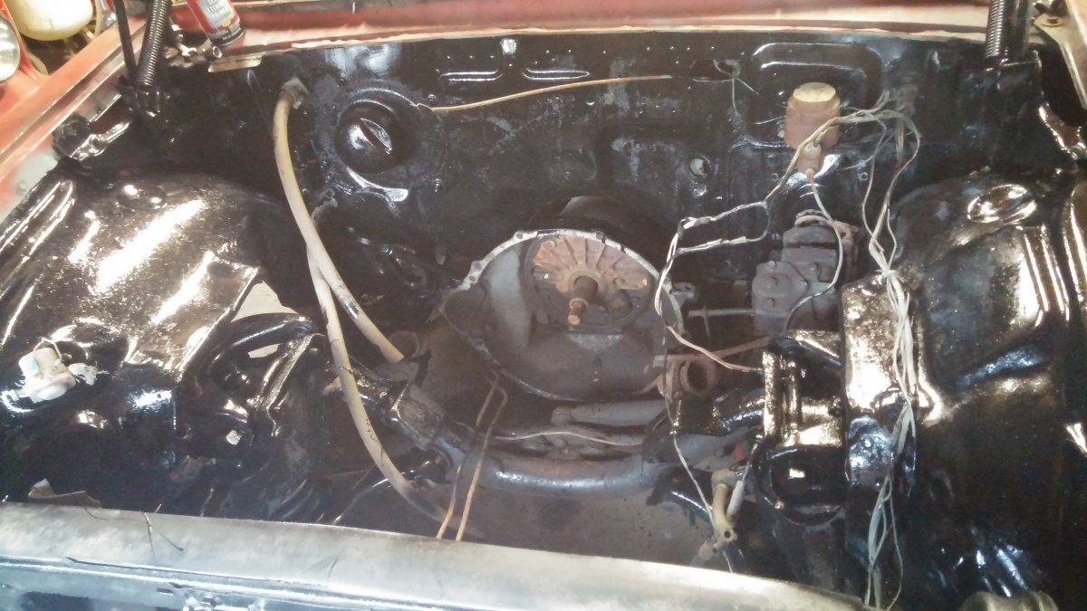

    The PO has kept Marvel in it and was able to rotate the engine on the stand when I bought it. I tried to rotate it while hanging on the engine hoist and it just wants to swing on the chain. The torque converter and flex plate are on the original seized engine still in his barn. I am going back Thursday night after work with the torches and heat up the nuts. I blasted the intake, gave it a coat of etching primer and high heat aluminum paint. I thought the aluminum paint would make it lighter LOL. Stupid question...What goes in this hole?

  22. DFH-GMC
    Joined: Dec 24, 2011
    Posts: 128
    DFH-GMC
    from Texas
    That should be a hose to the waterpump.
  23. NewGuyOldFord
    Joined: Jan 17, 2011
    Posts: 596
    NewGuyOldFord
    I think it is a press in nipple for the hose to water pump. There is like a 4 or 5 inch hose the connects the intake nipple to the back of the pump.
  24. hotrod428
    Joined: Feb 7, 2007
    Posts: 320
    hotrod428
    that looks like the back, if it is it's for the breather tube.
  25. Yep, that's where the road draft tube connects... Pre-PVC valve intake.

    I just called the PO and asked him he said that it was a draft tube for the PVC. Does that need to be there? If so I will add it to the list of parts I need. The PO has a ton of parts and when I made the deal for the engine I stipulated all the parts to make it run.
  27. That is certainly the hole for the road draft tube. And it need to be there or a PCV retrofitted.

    This tube was connected to the spacer plate under the carb. It looks to have a PCV valve inline. The tube is shaped to fit the back of the manifold in a vicinity of the "hole". I need to find the insert that plugs into the manifold and has a nipple for this rubber hose. I also posted a pict of the engine compartment. My plan is not to do any body work until I get it running, but I couldn't bring myself to put a pretty engine in a dirty/rusty hole. When I was younger any hole would do, but with age I have become more discriminate. LOL
