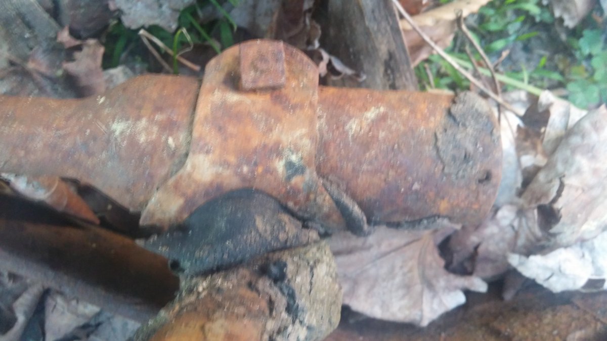

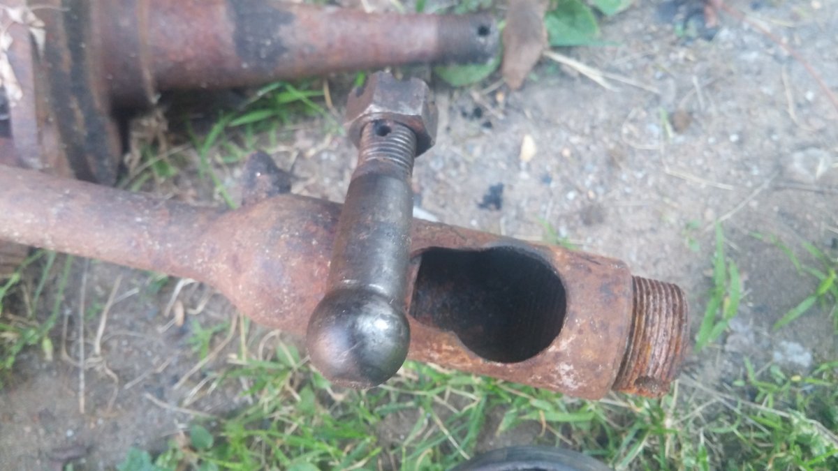

    Another problem in the process of removing the Steering box, I popped the "Ball/Taper End" out of the control valve. I am not feeling the power steering as it is a ton of **** that I don't need. I found what looks to me to be a tierod end for $200. What makes this thing worth $200? Cant I just find a female tierod end that screws on the link and has the same taper to go into the pitman arm?

    Input shaft of a c6 is pretty darn hard to turn by hand. Of course given the amount of work to install a c6, I am pretty certain I'd tear it down and at least toss an overhaul kit in it (it's like $60). I have a build thread for a c6 above that might reduce the intimidation factor a lil. They REALLY aren't that complicated once you understand how they function.
    The Ballstud needs to be pulled from the control arm with a tie rod remover, NOT a pickle fork or you'll ruin the control valve. Course you know this now. I use a Ford power steering pulley remover to force the ball stud out of the pitman arm. Anyway, that Borgeson part above replaces the control valve. It works well, I have it on my car. Manual steering isn't that bad to be honest. If you wish to rebuild teh control valve, those aren't that bad either, but they are kinda tricky to get set up perfectly. I don't care for the factory power steering, so I sold all the PS parts. You could look for a tie rod end, I looked and couldn't find one that was perfect.

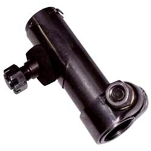

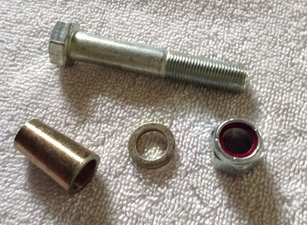

    What do you think about this little guy and a heim joint that screws onto the center link. $8 on ebay and $12 for the cheap heim. Maybe I would even spring for the higher quality heim and a grade 8 bolt. I know I'm cheap. But $40 is a lot nicer than 140.

  27. The main reason you can't just use a tie rod end or heim joint is that 'special' end has two springs inside holding the ball sockets for the tapered stud that absorb road shocks and prevents transferring them to the steering box. Your power steering link does the same thing, only it's done hydraulically.

    Yeah, I'm with crazy steve on this one..... I'm an engineer by nature and profession, I view all parts for a specific purpose. Thus why I went with the proper part for the job. I cannot tell you what *might* work for something that could very well detach your steering while driving and kill you. :p

    That makes sense. I guess. I have a drag link off my 48 F1. It has the exact same end As the one in the pict. Just need to cut it off and ten some thread in it.

    Looks like the same thing to me.
