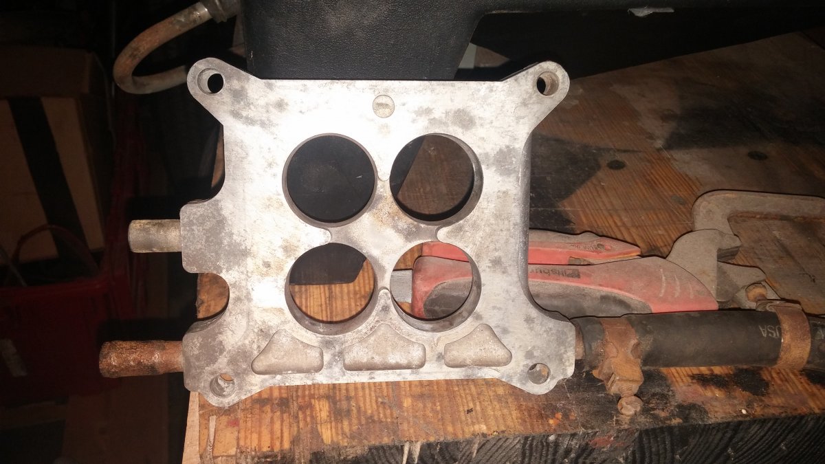

    I have the OE aluminum spacer with the PCV port. I just cleaned it up. I will try to get a pict, but raining cats and dogs and I'm not going the garage until it slows down. The steel spacer must be pretty thin, because I wont have enough stud left to bolt the carb on.

    This is what I got. Looks like I will need a special shaped gasket from spacer to the manifold to accommodate the PCV port. The Spacer to Carb gasket look pretty standard. So am I missing a "Steel" spacer or am I good?
  19. town sedan
    Joined: Aug 18, 2011
    Posts: 1,288
    town sedan
    Well, I learn something every day. So your aluminum spacer is also water heated, or am I looking at the photo wrong?
    My experience is with FE powered '64 Galaxies, but the '63 should be the same or close to it.
    The open side of your spacer goes down, but where the PCV port is located without the (yes it is thin) steel spacer there will be a vacuum leak there. At least on the '64 intake. My 352 had both pieces and ran fine, but I'd never seen such sludged up valve covers. My friend rebuilt the carb on his 390, but only used the aluminum piece. This engine had several small fires and one big one. Your experience may be different.
    I've got both pieces somewhere I'll see if I can find them and post a picture.
    -Dave
  20. Yes, you'll need the correct gasket. You don't need a 'steel spacer' as your intake has the matching flange for the PVC spacer.

    Posts: 1,288
    town sedan
    So your saying the '64 4bbl intake is different than the '63 4bbl intake? All I know is what I've observed on two different '64 cars. Actually my '64 was a November '63 built car and the engine had several carry over parts, like "earlier" cylinder heads. Don't have any way to reference the casting numbers on the intake since the car has been gone a long time.

  24. All the '63-up intakes I ever saw were set up for a PVC system using an aluminum spacer (except multi-carb). If you go back to post 58, the OP shows a picture of the manifold carb flange and you can see the 'extension' meant to cover the PVC 'intake' on the spacer. All he needs is the right gasket. I suspect you had an earlier manifold if it lacked this.
    Your 'sludged' valve covers were a result of the early PVC design, and is one reason why Ford changed the design on the later cars.

    Maybe the steel plate adapted a the aluminum flange to an intake that did not have the raised area to seal up the PCV port.

    It takes a standard carb gasket on both sides, the pcv pulls from the holes in the center under the throttle plates.
    I've had an fe that was sludged up like that, the old man never ran a thermostat and never drove far so it never got hot and that sludge was everywhere.

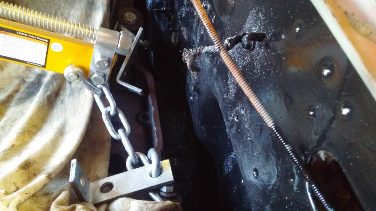

    Update! the engine is in... sortof. I found out that FE engine mounts changed over the years. I removed the original mounts from the seized engine knowing that they had 3 holes and my rebuilt engine only had 2. I new I had a set of 2 hole mounts that came off one of my truck engines...guess what? They don't fit. The 1963 car engine I have has smaller distance between the holes. Then I ran into a problem with the transmission mount. The C6 was original to the seized motor (I will refer to it as the 1966). The ****** mount is a bit a cobbled up mess but is functional. The problem is that the 1963 motor has the road draft tube port on the back of the manifold the 1966 did not. This allowed for the engine to sit back closer to the firewall. I created a set of motor mounts that clear the firewall and lets the ****** sit where it is, but when I go to install the intake the road draft tube hits the fire wall. I have ordered the correct set of mounts and I will slide the ****** ahead. I hope the drive shaft is long enough and doesn't fall out. Seams to be one thing after another.

    Yeah, engine mounts changed in 65.
    Proper mounts for an early FE in a 63 Galaxie
    are Anchor part # 2222 and #2223
    $20 for the both of them at Summit racing. They are pretty stout.

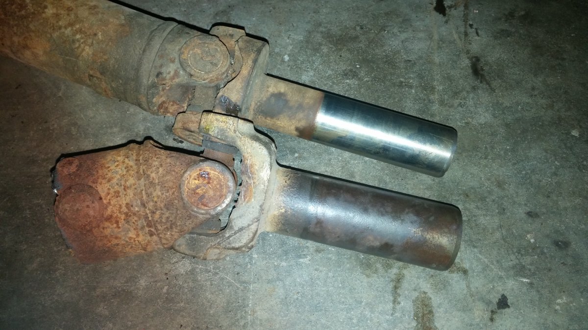

    Engine mounts arrived FedEx today. I got them in and the engine sits correctly and clears the firewall. Very Happy!! Now as I presumed Driveshaft is too short. I thought I was going to be OK since it only slid ahead about 1 inch. But the slip joint is not fully splined and I don't think its going to catch the spline. I was digging around the shop and I found another slip joint and it is fully splined and fits the shaft, But it is too big in diameter.(See Pict) I happen to have a lathe and could easily mill it down to the correct diameter. I know its not the correct fix, but it should work fine. I think that the slip yoke may have came off one of my t-18 4 speeds. But not sure. I will also have to make sure the U-joint will work. Are there any 31 fully splined yokes in the smaller diameter?
