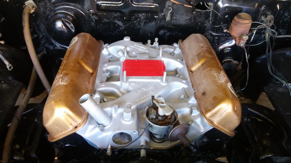

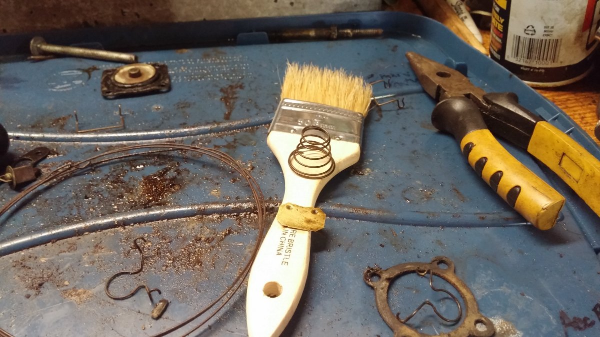

    I slipped the drive shaft back in and its catching about 1 inch of spline. I think it will be ok to start the engine and attempt to move the car around. No burn outs! ... yet. Here are some picts of the engine. I also attached a pict of a Spring left over from the 4100 Carb rebuild. It looks to be the accelerator pump spring, but it already has one. The vacuum secondary side also has a spring. Where in Hell did it come from. also I hope I don't really need the Equalizer Baffles...cause they broke. Thanks everyone with all the input on this old girl.

    Spring from a dashpot?

    I gave up on the location of the spring. I have one in the Accelerator pump and one in the secondary. Maybe a "gremlin" left in the bench when I wasn't looking. Moved on to ordering Carb and valve cover gaskets. Should be here in a couple of days.

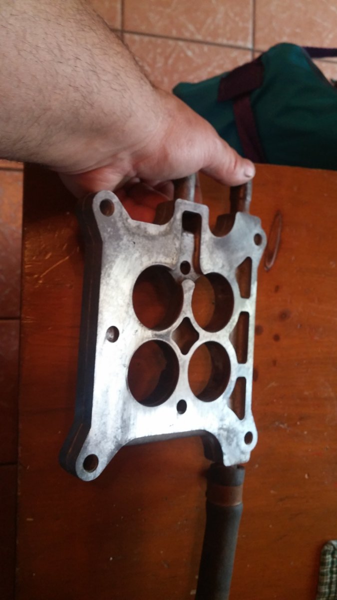

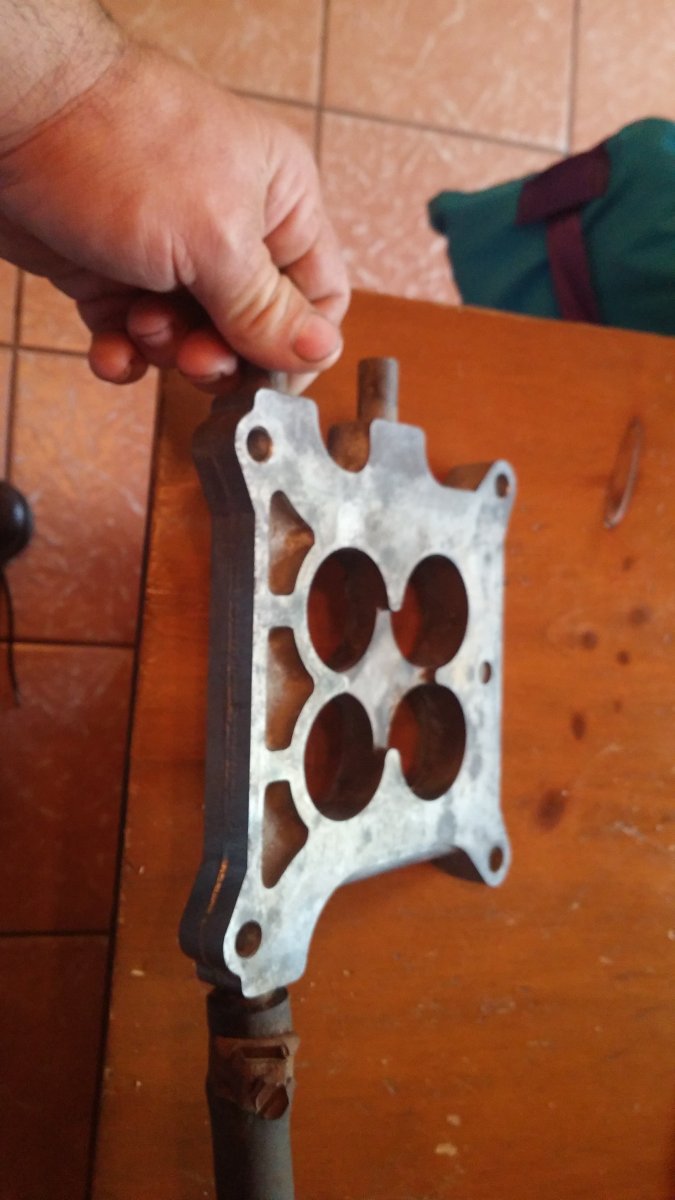

  7. steel spacer 001.JPG steel spacer 002.JPG steel spacer 003.JPG steel spacer 004.JPG Here are pictures of the aluminum PCV and water heated spacer,s and the thin steel plate that's often needed to prevent vacuum leaks. notice the aluminum componets are different and the steel plate has a flat smooth side and the other side milled out to facilate flow.
  8. The pictures I posted the aluminum spacers are both pictures of the bottom side where it contacts the intake. The first one pictured will not work without the milled out steel spacer even with the correct intake. it needs that milled p***age in order to create vacuum. without the milled steel spacer it just seals off the PCV port.

    My spacer is different. Mine is not recessed like yours. I see how that one would need the steel spacer.

  11. Yes that's all you need if your intake has the flat extension at the rear . I just posted the pictures to show that Ford did indeed use a steel plate in conjunction with the aluminum spacer on some applications.

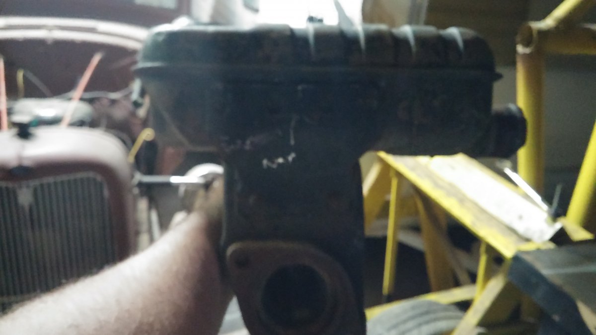

  12. Do you have the water resivor that attaches to the block. its a necessity on a 61 thru 64 ford to be able to close the hood. I have a extra that one I would sell. Ive owned several early 60,s ford,s back in the day.

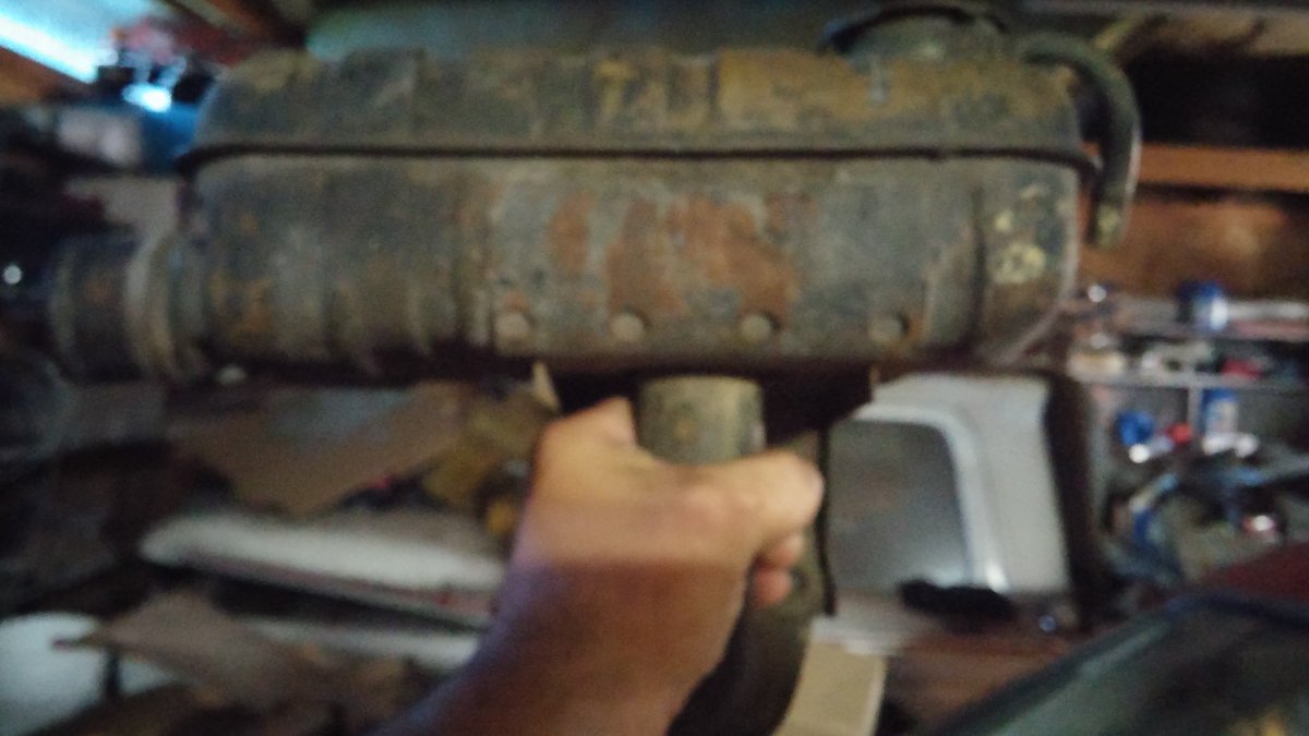

    I lucked out on finding the expansion tank. I have an old friend that has a "true junkyard" Nowadays we call them s****pers. He is up in his mid 70's and use to race stock cars and seams to have "one" of everything. I stopped in last week just to say Hi and show him the Galaxie Project. I told him I was one the way to another friends to check if his 62 Galaxie with a 292, had an expansion tank. He said "the tank that you put the water in" I said ya. He says "I got one of those out in the trailer body. Sure enough we walk out to the 40' Tractor trailer body, climb up in and laying on top of a shelf was a dam near perfect tank. He handed it to me and says "here ya go" Free "what in hell am I going to do with it" Its about time something workedout in my way on this car.

  15. The 292 and 6cyl engines had different tanks. The 292 has a hose connection on it .the 6cyl hooked up between two top radiator hoses.

    Your right, the FE, Y-Block and 223 all had different tanks.

    Little more progress. Waiting on Carb Gaskets, Valve cover Gaskets, upper on lower radiator hoses. Should be here tomorrow or Tuesday. Expansion tank seamed to fit well, and I modified an alternator bracket to hold the One wire Alternator. Where is the correct location to mount the coil? I usually just stick where there is bolt.
  20. The factory usually mounted the coil in horizontal position on the intake right beside the dist. Ive seen a few bolted to the front of the cyl head.

    I ended using the flywheel and converter off the seized engine that came out of it. I figured that if it was in their once I should fit again. I bolted the coil to the front of the head last night... looks good. I had it cranking on the starter last night. I need to adjust the valves and figured it would be easier that tuning it by hand. I got the correct carb gaskets and installed that last night. Can't find the tube that goes to the PCV and back of manifold. Put it somewhere just cant lay my hand on it. Radiator hoses ****** lines are going on tonight. Getting real close to firing it up!
