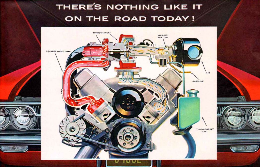

    Nick,
    There is a cross over pipe that takes the driver exhaust to the p*** side and then up to the turbo.

  14. Neat car, love the four-speed. What do you use for the Olds’ “Turbo-Rocket” water-methanol injection mix.

    I just thought I would post a photo of the Oldsmobile Turbo Rocket Fluid. You need this to make the whole thing work correctly. I do use a water-methanol injection mix. The only reason for the methanol is anti-freeze. I think windshield fluid would work.

    Yep windshield washer fluid works fine. Found out on OT turbo rice rocket.
