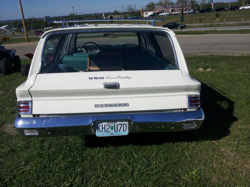

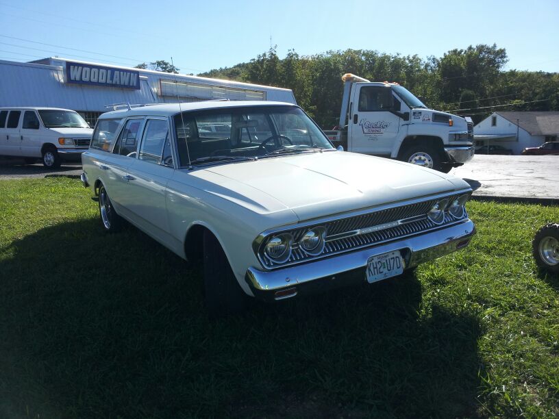

    Here are a couple pics of one for sale locally.

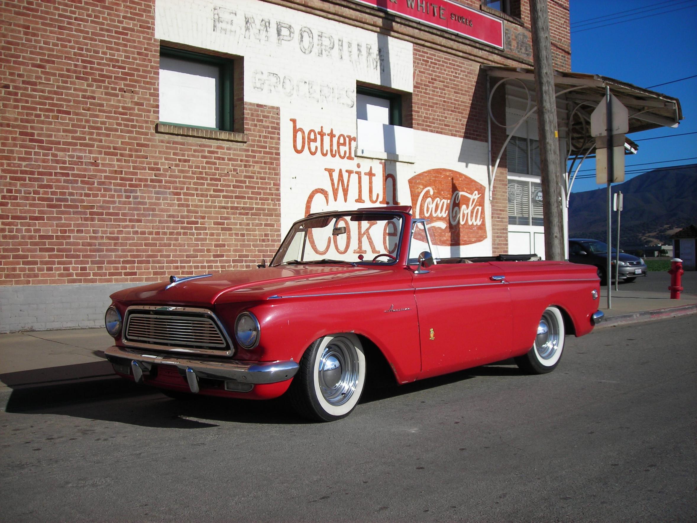

    Ramblers have turned out to be a lot of fun for me. My wagon and my convert.
