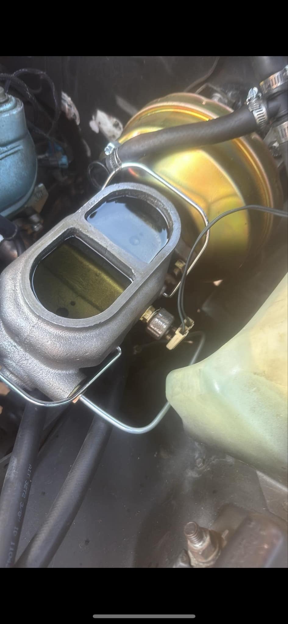

  16. Johnny Gee
    Joined: Dec 3, 2009
    Posts: 15,002
    Johnny Gee
    from Downey, Ca
    I’ll say very little but I have to ask. How did you bleed the rear circuit??? IMG_3380.jpeg
    SS327 likes this.
  17. Anthony Herrera
    Joined: Nov 16, 2024
    Posts: 32
    Anthony Herrera
    that one line that’s connected from master cylinder goes down to Tee line i’ll go take a pic right now

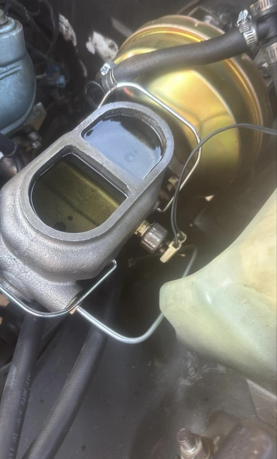

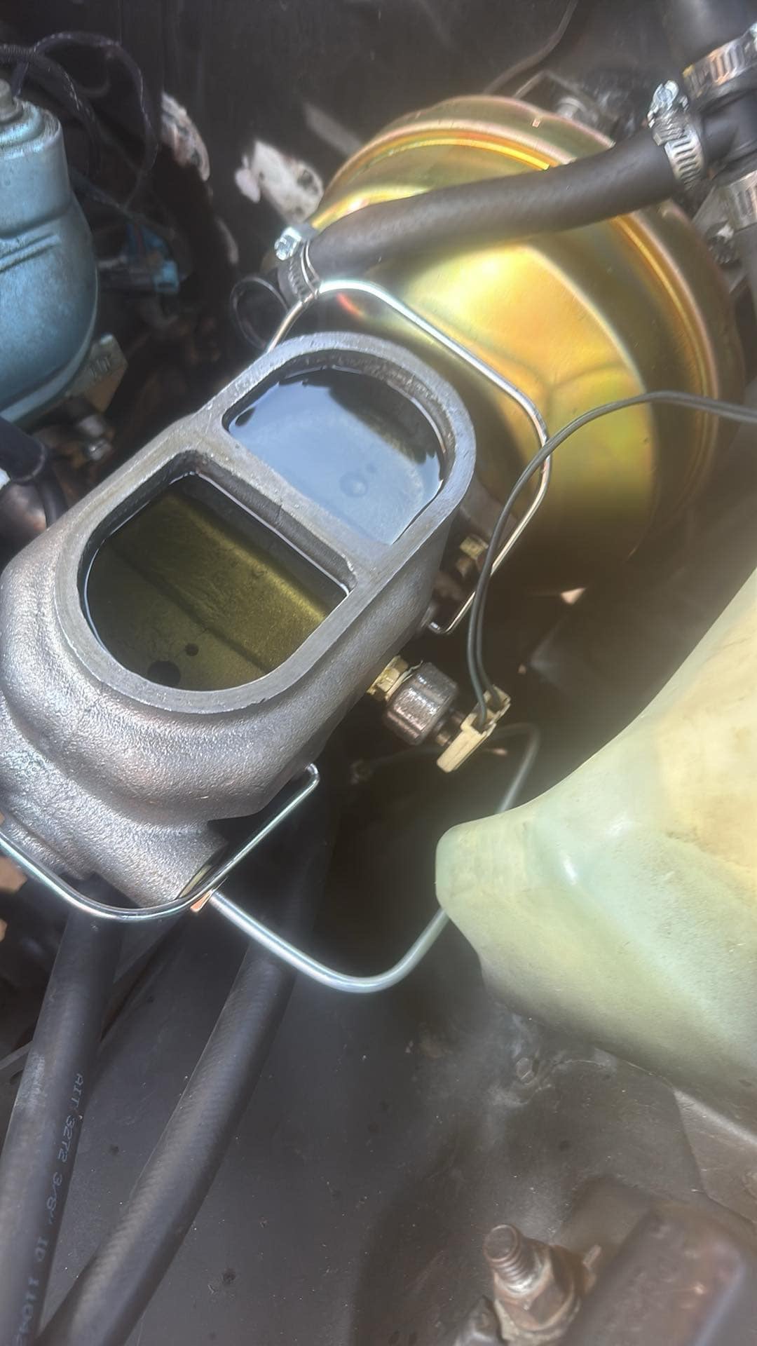

  18. Anthony Herrera
    Posts: 32
    Anthony Herrera

  20. Johnny Gee
    Joined: Dec 3, 2009
    Posts: 15,002
    Johnny Gee
    from Downey, Ca
    I understand what you’ve done. What I’m asking is, is there zero air left at the rear circuit of the master cylinder?
    SS327 likes this.
  21. SS327
    Joined: Sep 11, 2017
    Posts: 4,533
    SS327
    That ain’t going to work there sparky. Split the front and rear brakes and get a chevelle proportioning valve and plumb it correctly. Or better yet find one from a GM B body 67 and up and use that.

  23. dave agosti
    Joined: Nov 28, 2019
    Posts: 123
    dave agosti
    I believe the second unused chamber of the M/C is the problem. I think both chambers need to have bled pressure.
    You are so close, eliminate the tee, and connect front and rear lines to the M/C.
