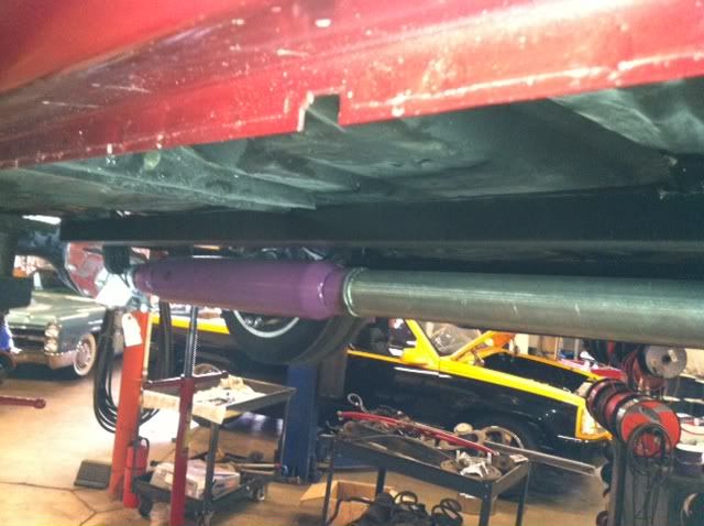

    Setting the pinion angle, Calvert recommended 4 degrees with all his suspension items I have
    Exhaust and subframe connectors
  8. Thefalconkid
    Joined: Feb 5, 2012
    Posts: 177
    Thefalconkid
    I had those same frame connectors in my car. They really stiffen the car up well. The ch***is guy told me they were too thin, (1/16th thick) and had to cut them out, and they put 1/8 inch thick 2 x 3 through the floor. Don't be discouraged by what I'm saying about my issue, I had the cage built to p*** certification to 8.50. I don't know how fast you plan on running with your car mike, but I'm sure you'll have no problems with tech.
