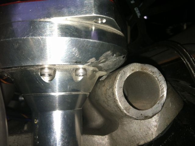

    Some progress today. Got the injector intake installed. Had some clearance issues with the distributor, nothing my angle grinder on the dist I couldn't handle. Also took out my old comp plus shifter, to install my new supershifter 3

    The new injector manifold hilborn recently stopped producing for sbfs has screw in type pipe fittings for the water inlets and I had a chance to get one instead of this one, but this one is stamped #106 and since hilborn started numbering at #101, it is the 6th one ever made and is period correct for my car, I like history, especially when it comes to ford. Trying to keep it true to form but also a compe***ive racer is definitely been a challenge. One that fit better would be nice though too!

    Mike;doesn't MSD make a taller base available for their SBF distributor?It looks like you may have hose clearance issues too. ROY.

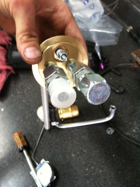

    Got some fuel lines/ an fittings installed and installed my new sending unit with -8 fittings for feed/ return lines.

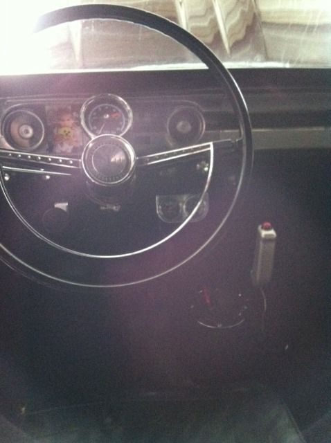

    Still waiting on the surge tank and lines/fittings for the injection! I got the Hurst supershifter 3 installed. I had to cut about 3 inches out of a Hurst shift handle i got here on thr Hamb to shorten it, then redrill new holes and slightly bend it. That was a PROJECT.. got the boot modified also for the reverse lockout. Roy thanks for the pistol grip. Put it all together, got the carpet and seats back in, looks normal again. Now I have a super short throw, reverse lock out shifter with a pistol grip that sits perfect for my arm to shift, hopefully this will help.. Oh and my crew chief had to try out the shifter.
