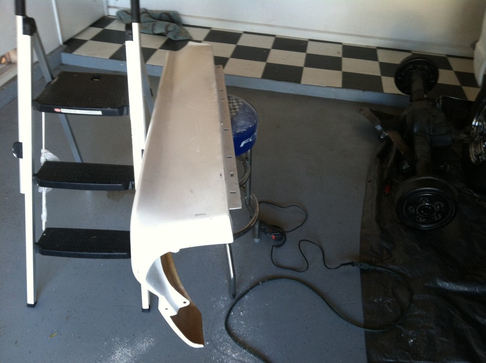

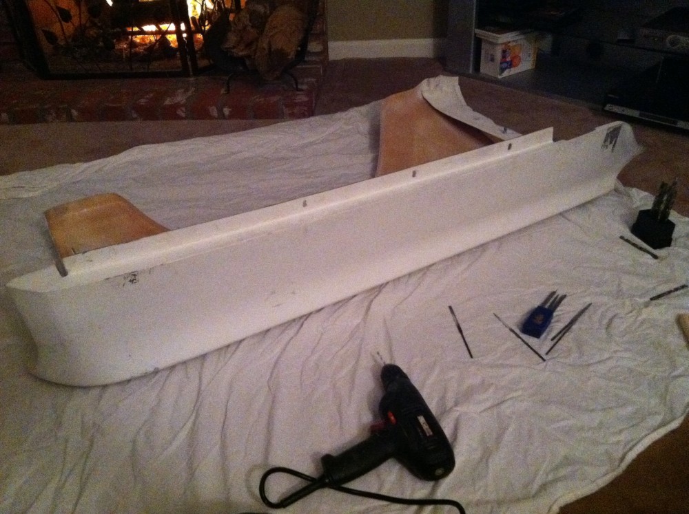

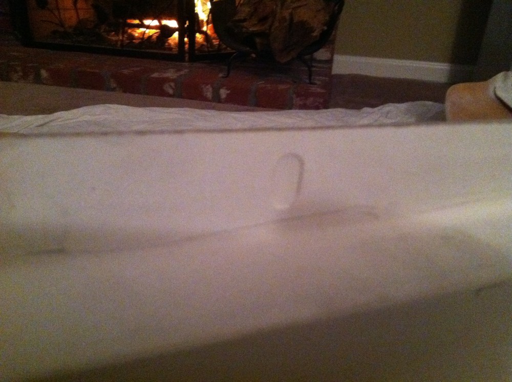

    Anyways I have been working on the fibergl*** fenders and got all the bolt holes drilled out on one of them and cleaned up, I will post some pictures later today. Those Crites fenders are made of very sturdy fibergl***!

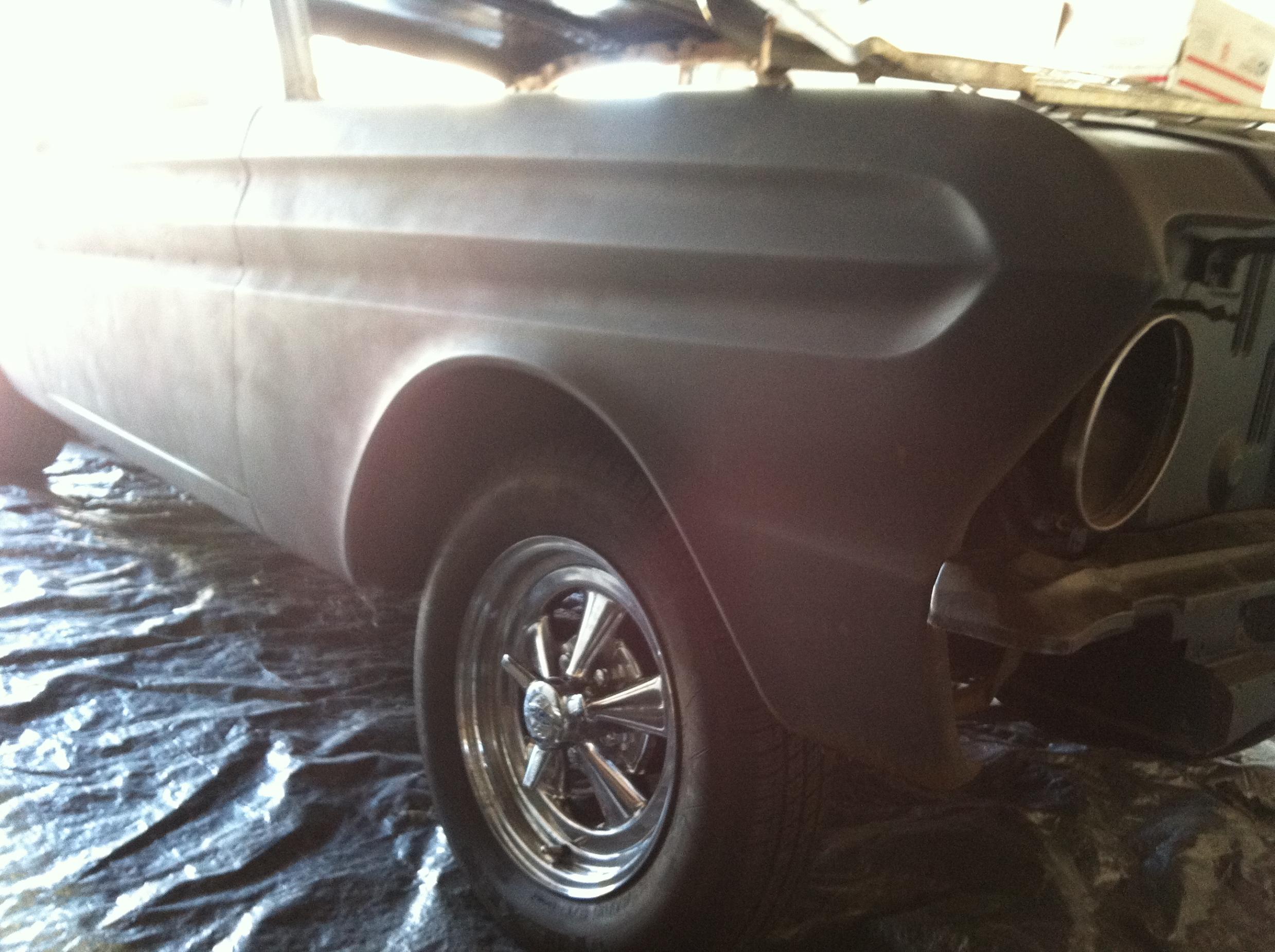

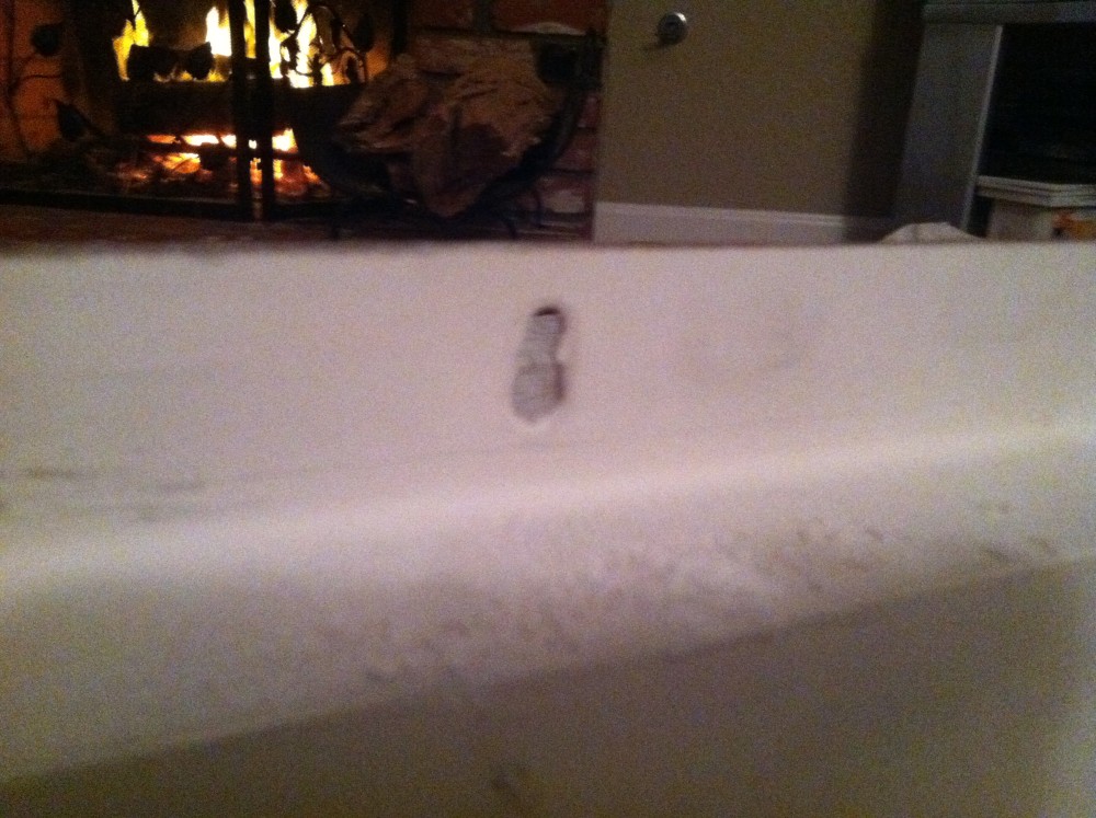

    One benefit to being single is working in your warm livingroom next to the fire, on car parts. The crites fenders come solid, with no fender holes drilled. They are dimpled where the holes need to be. I drilled out the holes, then used a hand file to get the correct shape. One of those not so glamorous parts of a build, but details are what makes great cars to me.

    Mike;I have not used the Falcon fenders but on the 65 Comet ones I had to relocate the drivers side lower mount.Crites had it too high which lowered the fender,was not a big deal to do.I have found Crites pieces to generally be well built and solid. ROY.

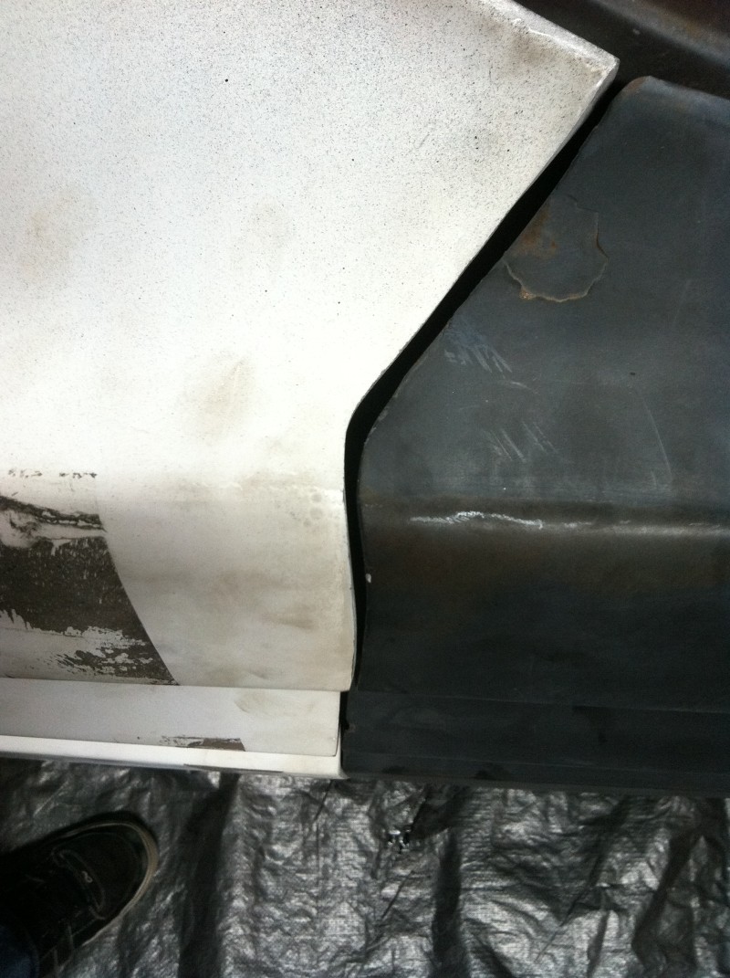

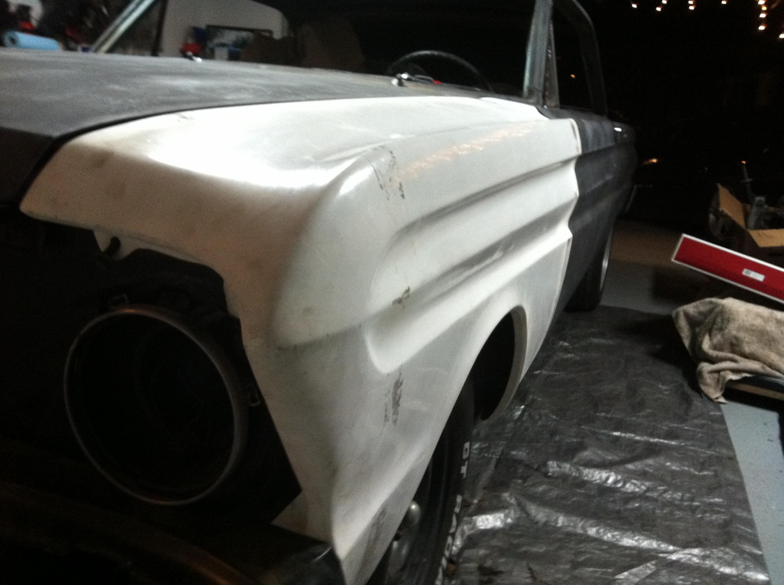

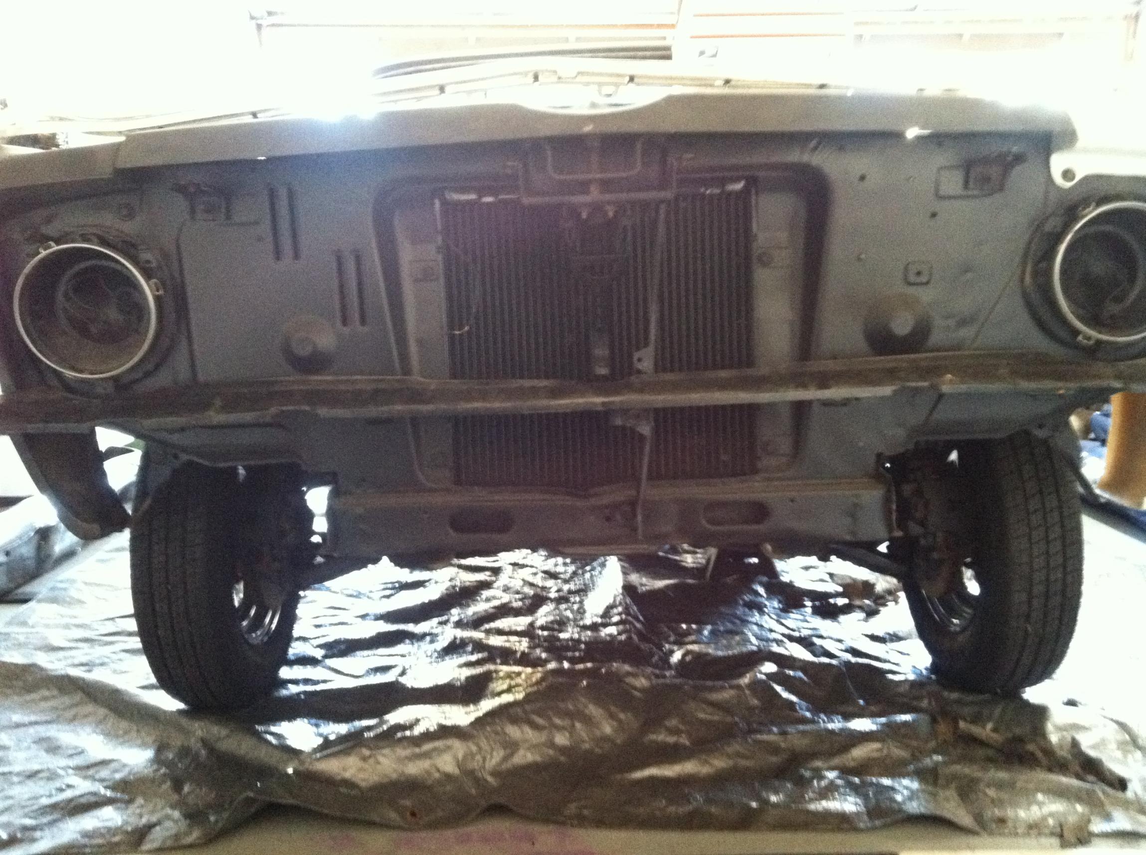

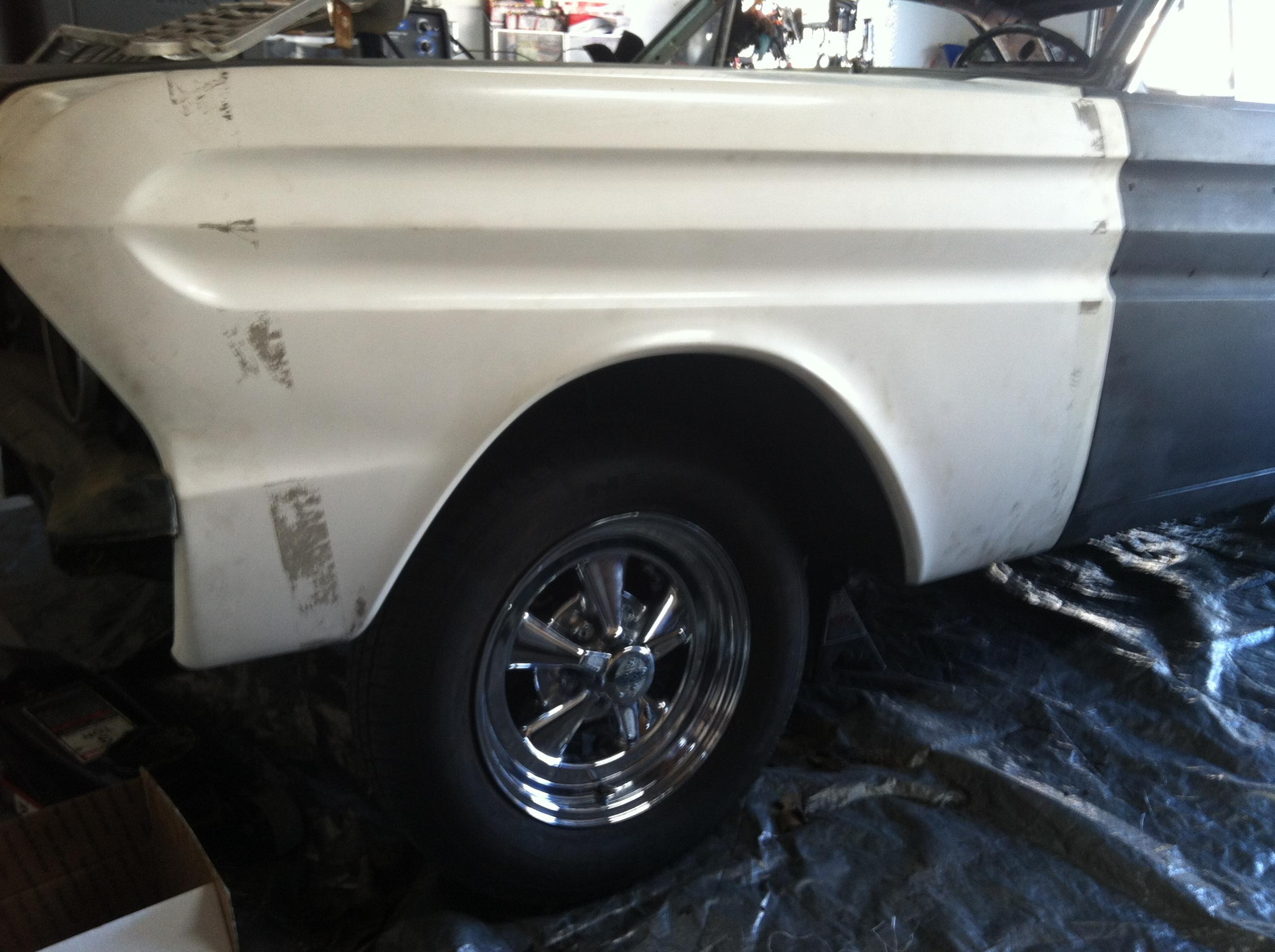

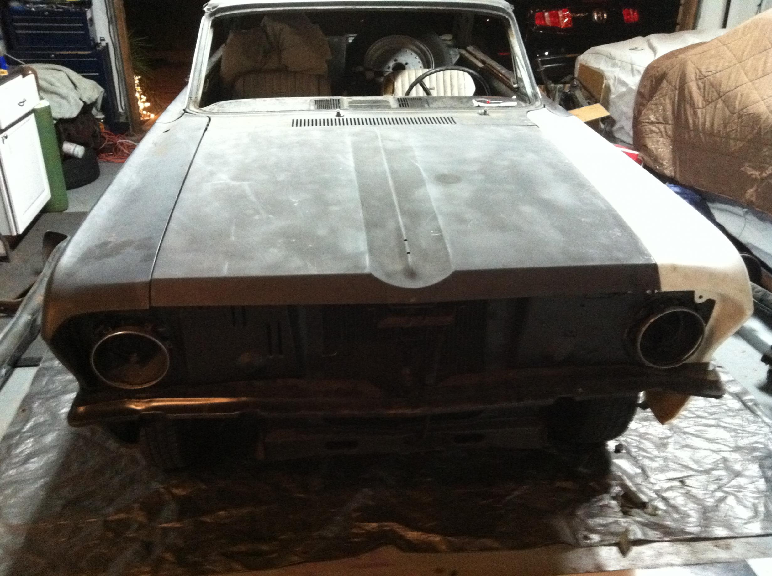

    Well I got the front end off and the drivers side fibergl*** fender on. Overall it fits pretty good, the door gap is decent. The hood gap is a little big, but I am not building a show car, its a racecar so I am not sweating it. Once I get the fibergl*** hood, it may be a little large and fill part of the gap.

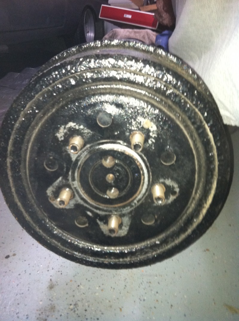

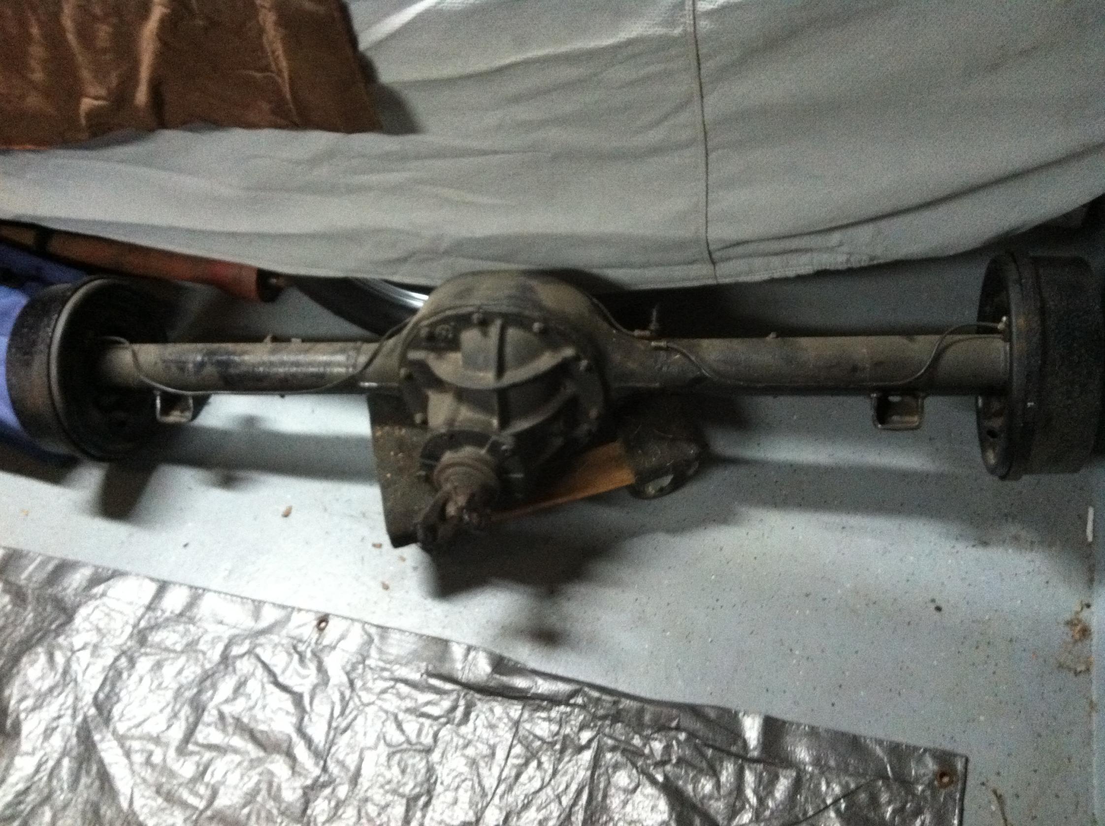

    Is there anyway to tell if the axles in my rear end are 28 or 31 spline without removing them? I have heard if they have three circles in the end versus the rectangle cast into them, they could be 31 spline, but that is not true 100% of the time.

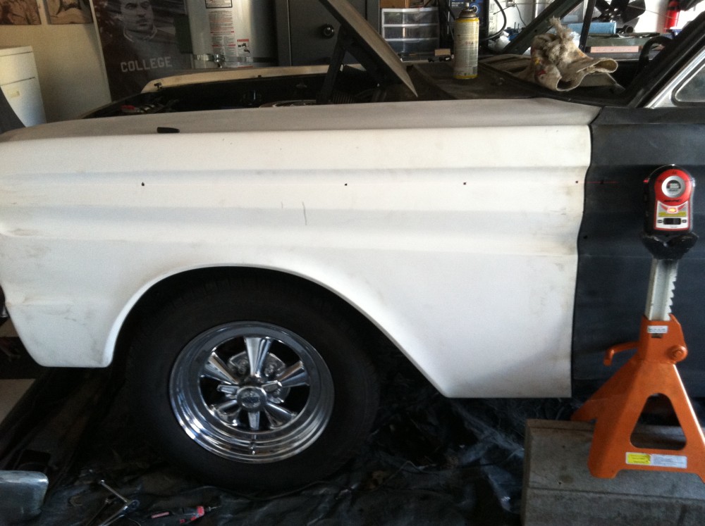

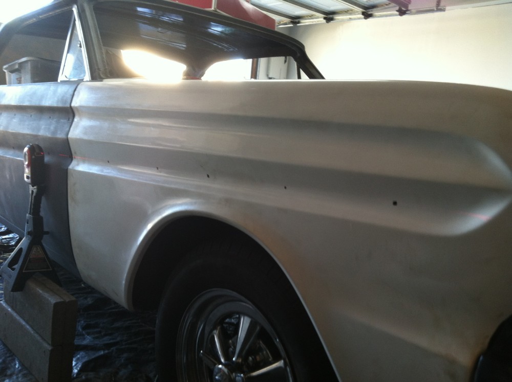

    Rooster, I need to take the fenders off again soon to do some work on suspension etc... so I will weigh them then. Just by lifting them vs the orginals I would say they are at least 1/2 the weight.
    I put the trim holes in yesterday and got the p***enger side fender mounted, so far no major modifications needed and the fenders fit real well. A little sanding the gap on the drivers side where it meets the door and I have to move the p***enger door forward about 1/8" just to look right.
    In the photos below you can see my super scientific way of laying out the trim holes, some 2x6's, a jackstand and a laser level I use to hang pictures. It actually worked out real well.
