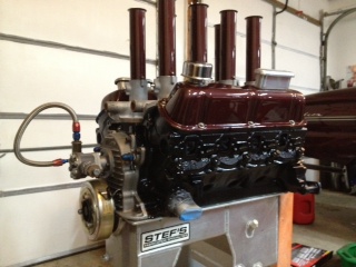

    Yo Mike, how's the Falcon running? I had the valve covers & the ram tubes painted to match the body color. I have to get smaller nozzles, I have 16A's, I need 10's or 12's. I also need new hoses, then it's ready to go in the car. I'm getting really close!

    The injection system is at hilborn getting reflowed , barrel valve adjusted and nozzles changed to straight ones instead of 90 degree ones so the can be serviced. With the way they are now, being 90 degrees, I can Only remove them if I removed the manifold because they hit the head. So straight nozzles should fix this.
    It ran like **** on the Dyno, didn't even make a pull. Fouled plugs and one cylinder wasn't firing. I couldn't get the manifold ripped off fast enough sent back to hilborn I was so mad! Oh well hopefully they will get it figured out. I hope your hilborn experience goes smoother, it should since yours was already set up for injection.

    Hilborn called two days ago. My shaft bores are wore out... I need oversized new shafts, new ****erfly's, new nozzles, new hoses, reworked barrel valve... Some stuff to my fuel pump.... $980 later!
