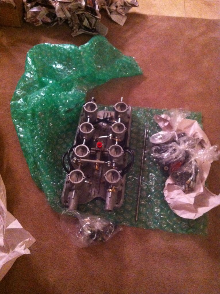

    Just got home from work, look at what found! ImageUploadedByH.A.M.B.1376646801.675091.jpg

    Oh hell yeah!
    Betcha a dollar you stayed up all night getting it back on the car too,didn't ya..?

    Mike;it is about time they got it back to you!!!Did they give you any information on the "NEW" system? ROY.

    Not much info, just said to run it! I went to Napa and Oreillys, neither had intake manifold gaskets, napa ordered them and they will be in tomorrow morning.. I also need to get another filter between the hilborn pump and barrel valve. I have seen some guys run a cone shaped metal filter that slips inside an -AN fitting, but I can't find them anywhere
