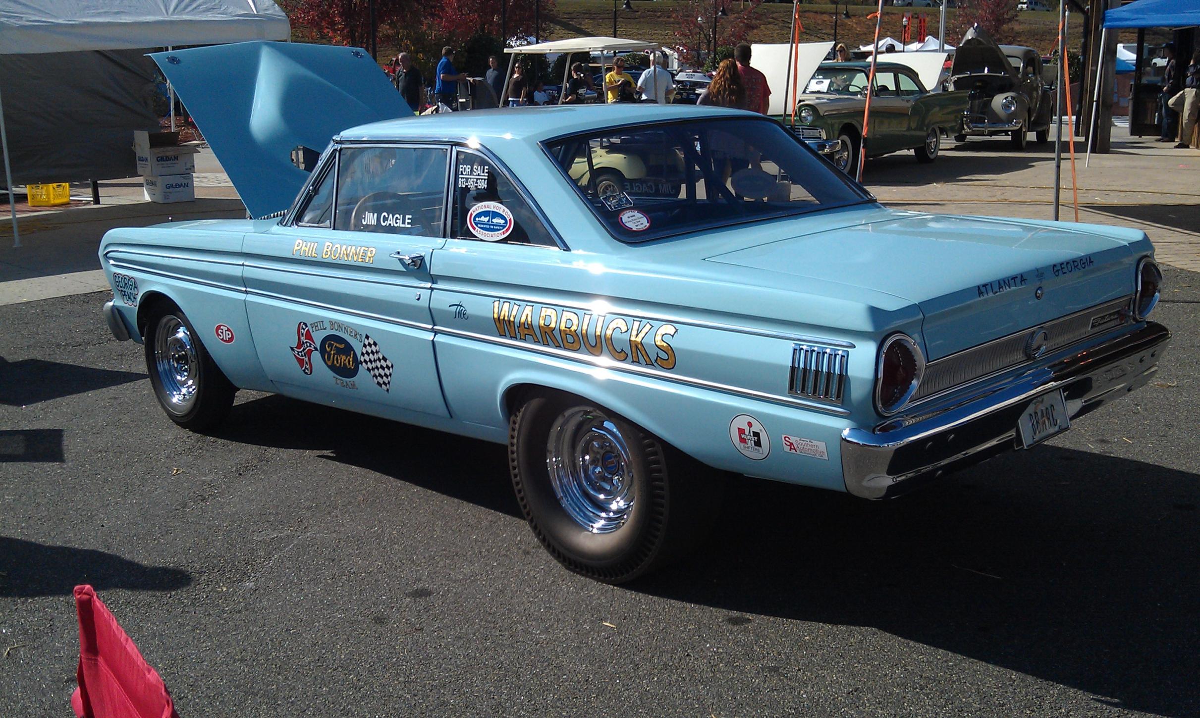

  2. A Phil Bonner clone certified & approved by Phil Bonner. 427 Thunderbolt motor. Owned by a guy in Donaldsonville GA. Was at Moonshine Festival in Dawsonville GA. last year.

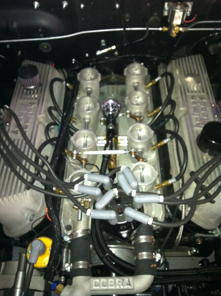

    Alright got back on it today, I got all the notches cut out of the valve covers thanks to Roy's handy air grinder and the valve covers installed. I also added a fuel filter from the front tank to the mechanical fuel pump, so I had to redo the main fuel feed line to the pump. Got the distributor set in and radiator lines hooked back up. It's getting close to firing again!! Next order if business is to cut a hole in the inner firewall on the drivers side so I can better access the clutch linkage. ImageUploadedByH.A.M.B.1377567757.013826.jpg

    That looks really Nice Mike, that Cobra piece in front sets it all off.......Al

    Mike;glad that worked out,you can't see the notches! It looks like the nozzles can be pulled if necessary!After all the **** that got into the fuel system on the Altered I like seeing fuel filters!The car owner would never listen to me or the driver on filter issues,it took having a Funny Car Crew Chief helping us tune the Altered,and his finding junk in the system,before the owner finally put in a filter and replaced all the lines and fittings!Did you do anything about the timing pointer? ROY.

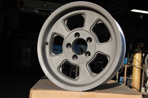

    Getting some new front magnesium looking rims (thanks dale) and front tires. Also a new oil pan gasket, oil, filter and spark plugs.( have a pan gasket leak) also a new stronger throttle cable, getting rid of that lokar stuff.
