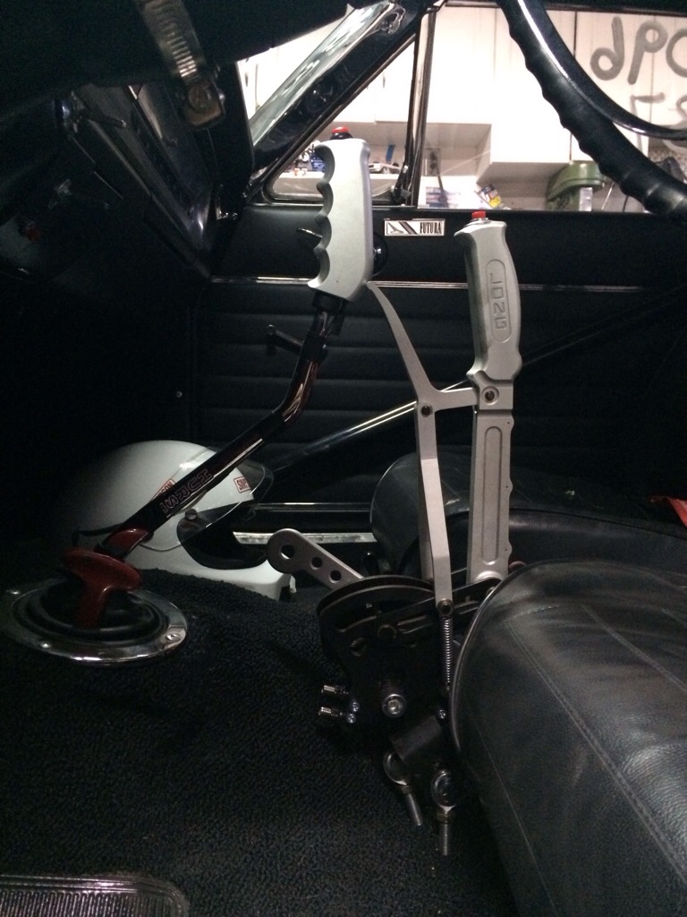

    Got a new part I need to install..... ImageUploadedByH.A.M.B.1394601691.722970.jpg
    Need Roy the master trans tunnel fabricator to ***ist on this one
