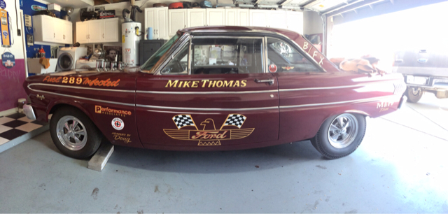

    ImageUploadedByH.A.M.B.1403327181.330743.jpg ImageUploadedByH.A.M.B.1403327192.029568.jpg
    Mike Thomas
    64 Falcon B/FX
    65 Cyclone
    BHoover and loudbang like this.
  2. loudbang
    Posts: 40,351
    Looks perfect to my eyes. :)

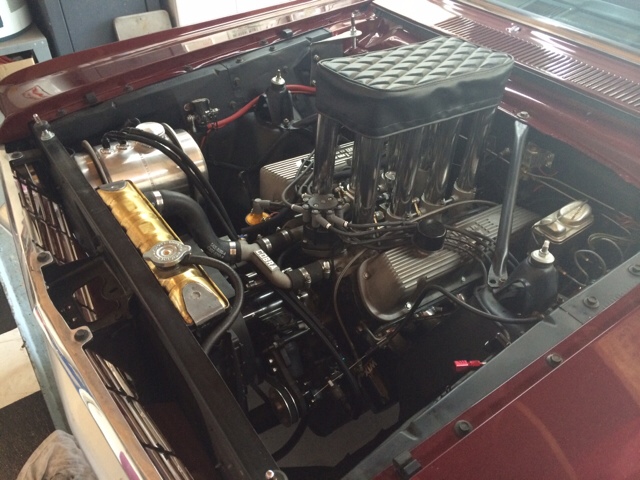

    Old surge tank out , moon tank in

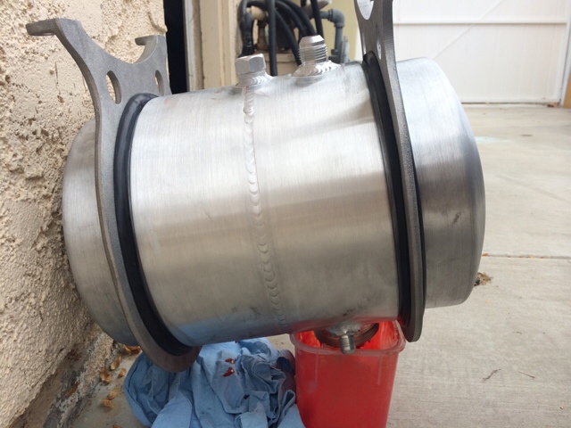

    Coating my moon tank for alcohol! This stuff is a pain, but from what I have learned necessary so you don't get corrosion and white powdery aluminum in the injectors

  8. 65COMET
    Joined: Apr 10, 2007
    Posts: 3,086
    65COMET
    Mike;I like how they made the brackets for the rear hood pins,very clean!How did the tank turn out? ROY.
  9. fiveoh108
    Joined: Jun 15, 2010
    Posts: 1,189
    fiveoh108
    Tank turned out good. I made brackets and got it installed, Got the injectors changed out, new main byp*** spring and pill installed, bigger fuel feed line almost done, got 5 gallons of methanol today $30.00! Hopefully I won't use quite double of race gas. Waiting for the toplube stuff to mix with the fuel and need to set the ****erfly's/ leakdown for alcohol.

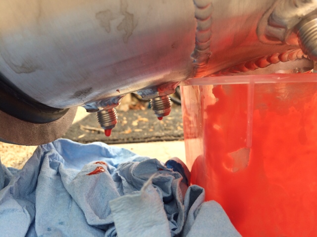

    Was going to a test and tune tomorrow at Fontana. But the fuel tank coating began peeling off in large chunks when I went to take the cap off to fill it up to get it tuned. I spent 4 1/2 hours s****ing red stuff out but I just can't reach it all and don't want to chance clogging something.. Feeling pretty dejected!

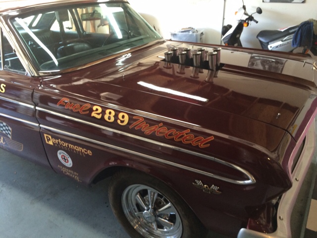

    Mike,great job on the stacks! Are you going to pin the hood or leave off? Is there any rule to not running one?
  14. fiveoh108
    Posts: 1,189
    fiveoh108
    4 pins with custom back brackets

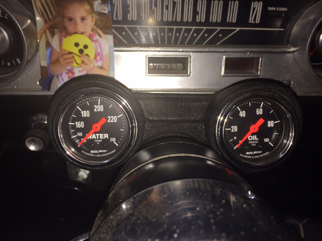

    Stayed up until 1am but got the rally pack installed and tach moved to the speaker grill. Much easier to see!

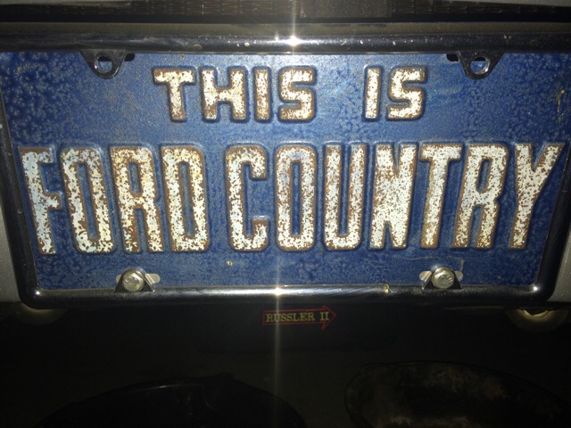

    Mike, what is the origin of your "This is Ford Country" front plate? I had one for 30 years that a local Ford dealer friend gave me but it was pretty beat up when I got it in about 1980. My pal has it on the front of his survivor GT350 now.
  18. fiveoh108
    Posts: 1,189
    fiveoh108
    Something I saw on ebay for $30 and had never seen one before.i matched the blue paint that was on it, but left the white that is original. I have no idea how old it is, but I ***umed old ImageUploadedByH.A.M.B.1404656791.231266.jpg

    Mike;are the gauges in your new pod crooked?Is it just the way the photo was taken?****s about your tank,hopefully you can get it cleaned up!!!! ROY.
  20. fiveoh108
    Posts: 1,189
    fiveoh108
    Just the photo angle

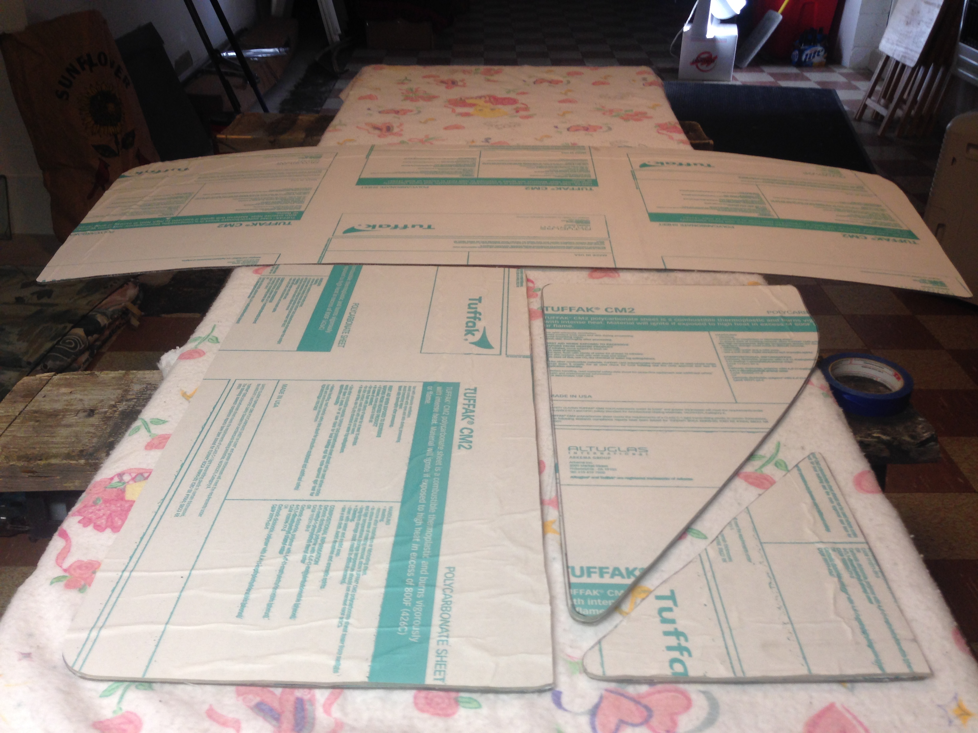

    image.jpg image.jpg No more vent windows! I like this look better!
  26. 65COMET
    Posts: 3,086
    65COMET
    Mike;have you figured out how to do it yet?You going with Lexan or gl***? ROY.
