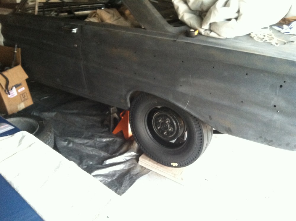

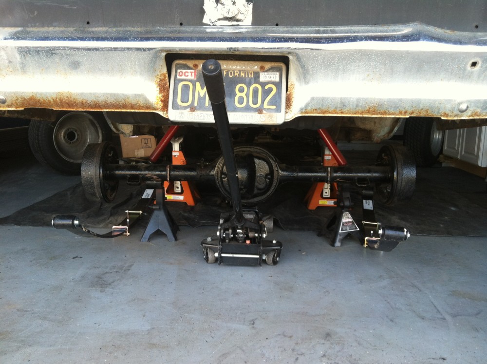

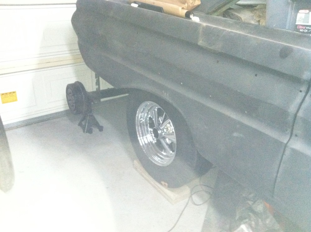

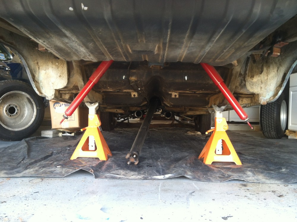

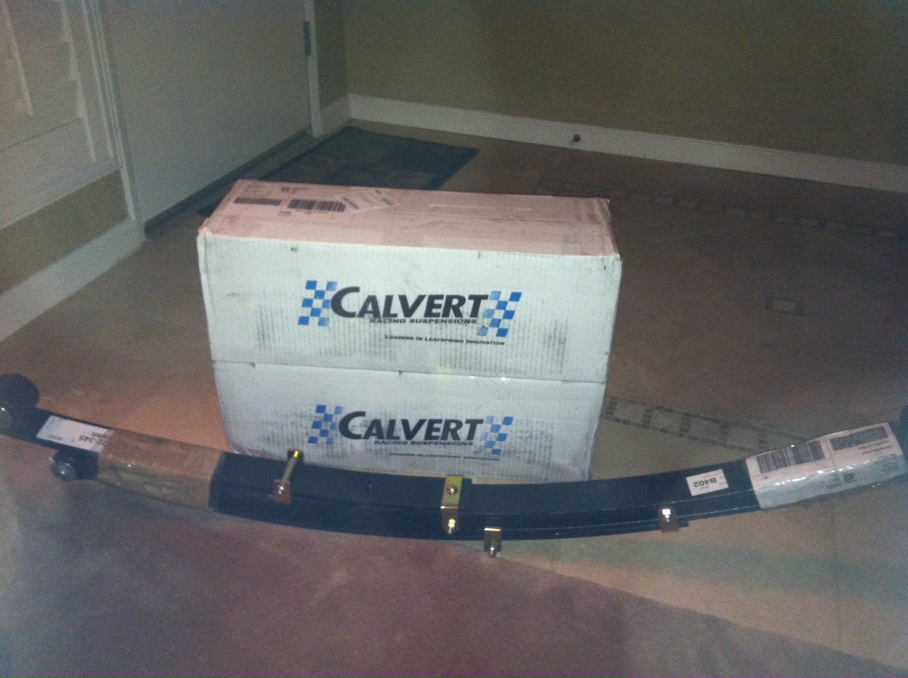

    Well got some more stuff done today. The old 8" and old leaf springs out! The new 9" and new calvert mono leaf springs/ cal tracs in today for fitting. I forgot how much a pain the rear shakle bushings can be!
    The new rear end is about 1/4 wider, also the spring perches are on 42" centers instead of the needed 43", I guess i will have to take it over to the rear end shop to have new perches welded on :mad:. I thought about just reaming out the hole on the perches a 1/2" on either side, but then they dont sit flush side to side on the leaf spring, so the u bolts wont sit straight either.

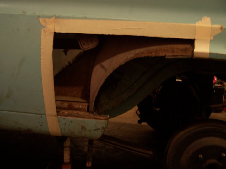

    Also the tires I will be running will cause some interference in the front of the wheel well. I was thinking of just following the wheel well opening and cutting the front, back about 1 3/4 inches. I saw what fast eddie did on his as well to retain the stock look, i am not sure which way to go yet. I may even see if i can get the rear end shop to drill centering holes on the perches an inch forward to move the entire rear back to clear the tires? Opinions are welcomed!

    Mike;I don't think the locating holes being off that little will hurt anything.I ran mine that way for many years until I switched to coil overs.The factory cars like a T-bolt or Comet/Falcon just trimmed the rocker below the body seam,I did that trick too.Dale Snoke runs Mopar SS leaf springs that have the pin 1" back.I wonder if moving the axle back 1" won't upset the geometry of your bars?Maybe call Calvert next week about both issues!!I just noticed the bottoming stop,GET RID of it,it WILL cut your tire!! ROY.

    I cut and moved the front of the wheel well opening forward AND moved the rear end back 1" I moved the leaf spring forward mounting holes back 1 inch and used the stock rear location But I didnt use the Cal Tracs I used Crites Tbolt bars and crossmember

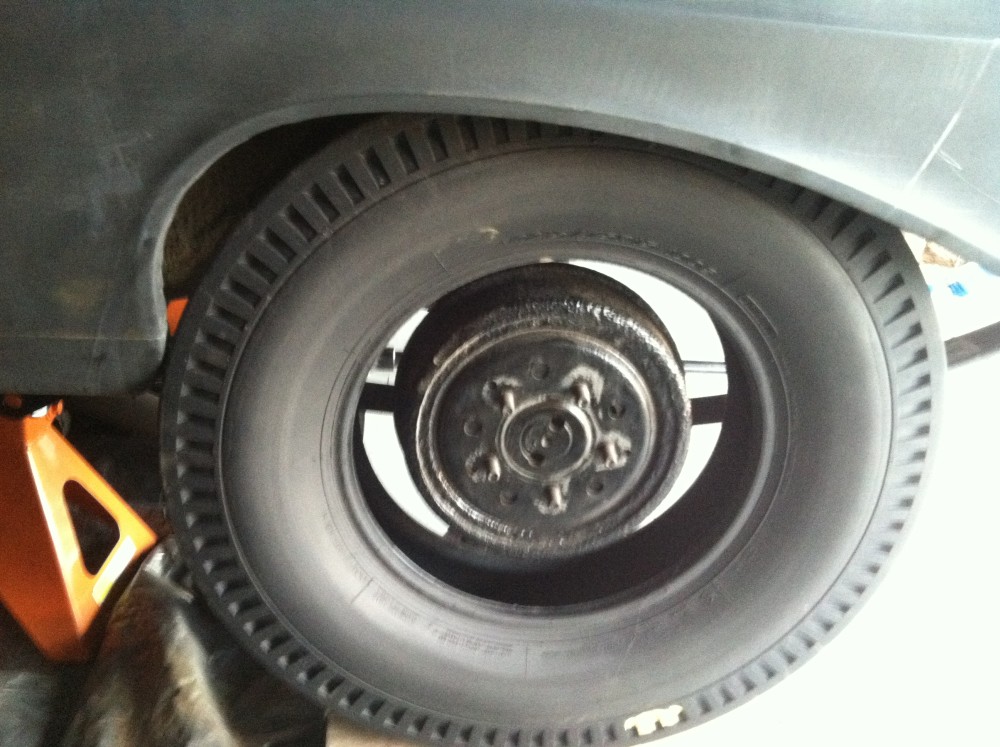

    Roy and Russco Thank you! I just ordered my wheels and will get my tires mounted, that is the smart way i believe, to get the proper rear end width. So once I get my tires/ wheels mounted i will set them up in the well and see how they line up. I also left a message with Calvert Racing today about the length of the bar issue.
    I put the rear end on the front mounting hole of the leaf spring pad which moved it back 1 1/2 inches, holding the tires in place it will clear the front with no problems, I just dont know if it looks right, I think these cars look better with the rear shoved forward, not back! I will wait to hear from Calvert racing before I do anything else..

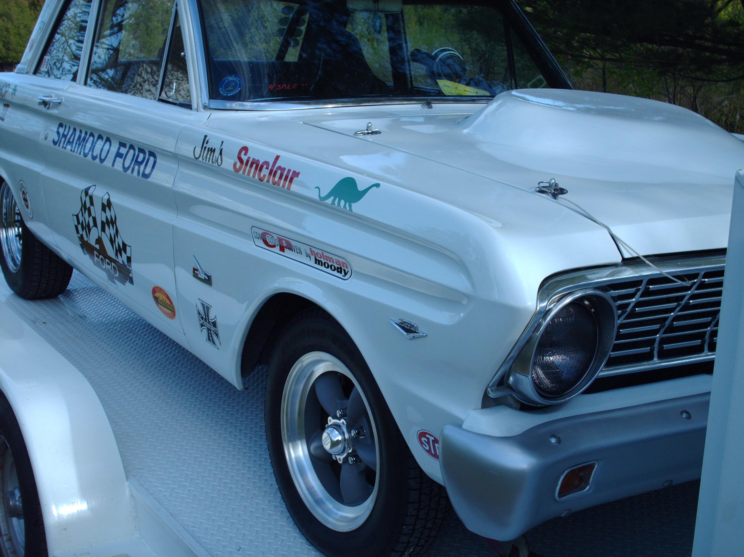

    Fast Eddie, Hopefully I can give you a run for your money someday, you have a bad looking car! I think I decided on Praire Bronze for my car, a little differnt, but still a cool factory color. I attached a picture of a 65 in that color.
    Hiboy I have never talked with BIlly, but will keep him in mind when I have some questions, because I always like bouncing ideas off those who have been there done that.

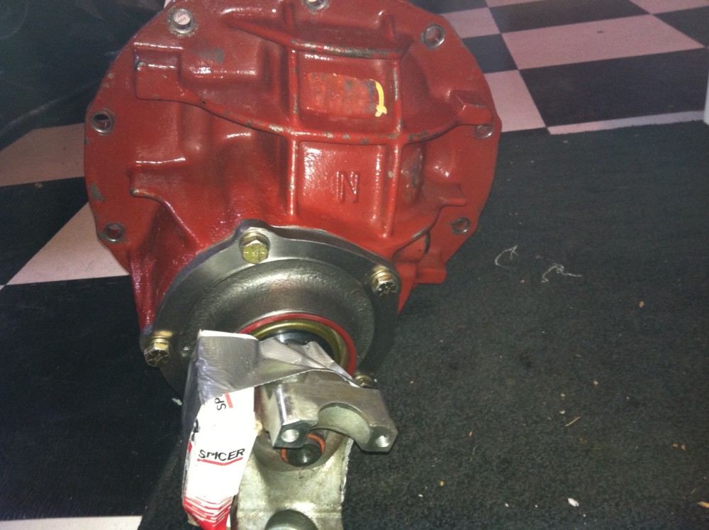

    I also did some more measuring for the rear end. I think I am going to shorten it 1 inch on each side to make it 56" from wheel mounting pad to wheel mounting pad. The 7 inch cragars will fit without this mod, but I have to go through it anyway so I figured I would give myself some room to grow. Also the current spring pads are on 42" centers, so I am going to have the calvert pads mounted on the correct 43" center. And lastly, I am going to have the pinion moved 1 inch to the drivers side to have in line with the trans output. I may have got a line on a new nodular "N" case 9" third member as well.....We will see in a couple days.

    Yea Roy that is what I was thinking, slide the pinion over by taking 1 inch off the drivers side then having the perches rewelded at the 43" center. That should save some time/ money at the rear end shop...Now just to find some strong, somewhat affordable axles!

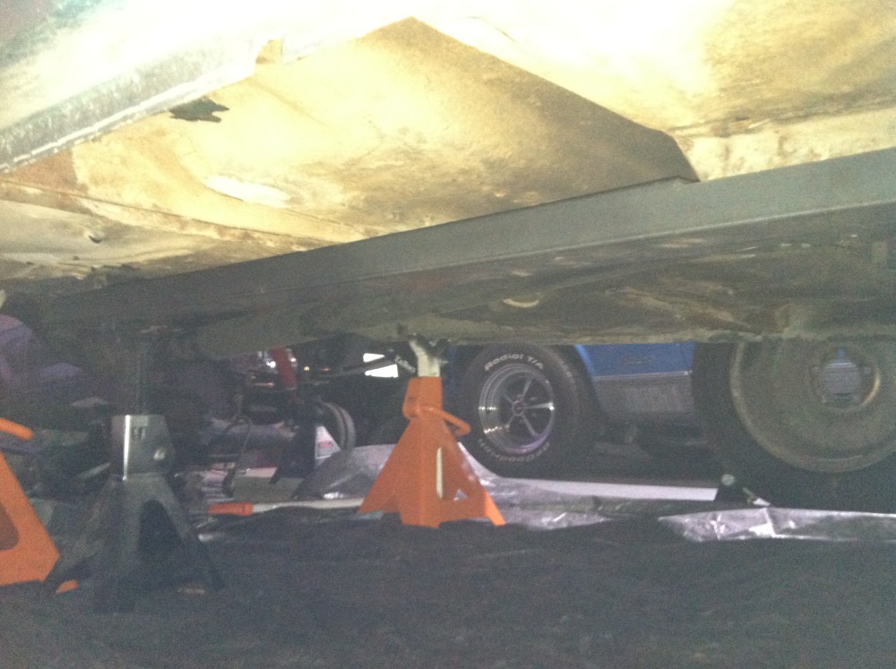

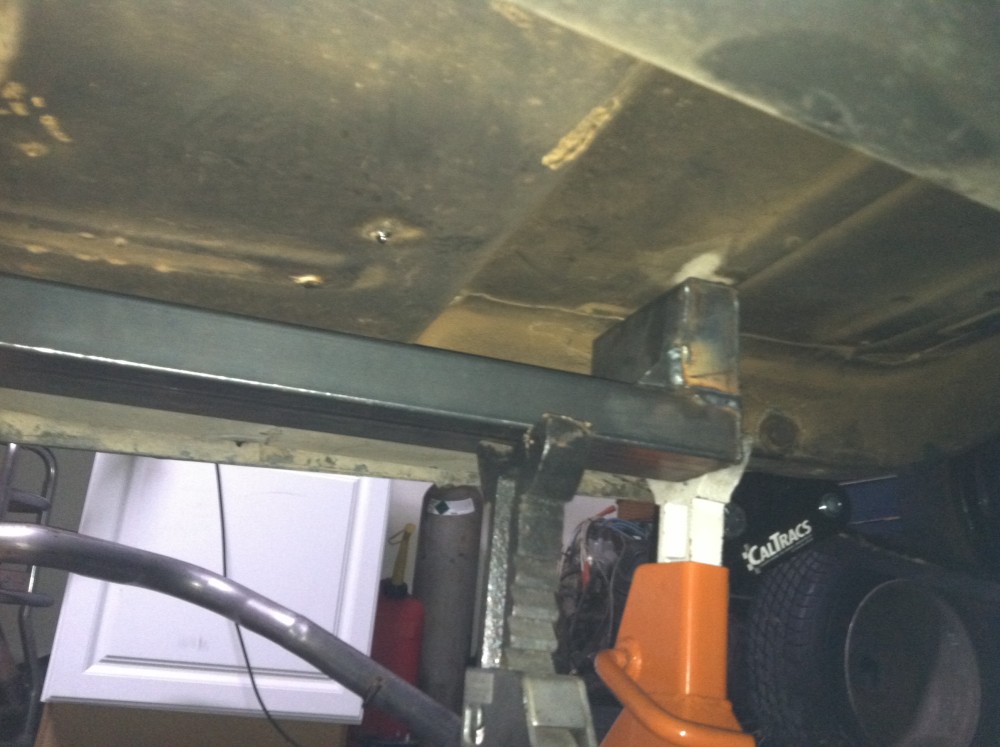

    Started working on installing the Crites subframe connectors, they dont go through the floor as i originally thought, but **** up next to so i can lay a weld there. Also think i might run some lateral supports from the connectors to the rocker panels (Roy's suggestion). I had to cut reliefs in the seat braces for the connectors to fit tight to the undercarriage as well.

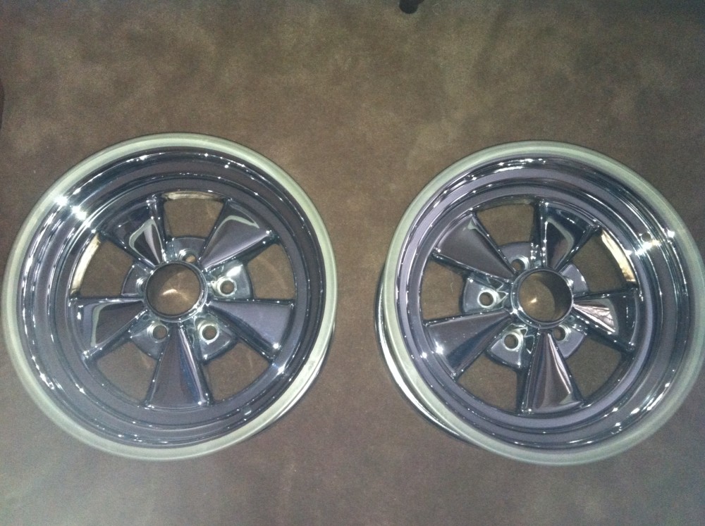

    I also got my rear cragars today and got my tires mounted, I will get some pictures of that up later today.

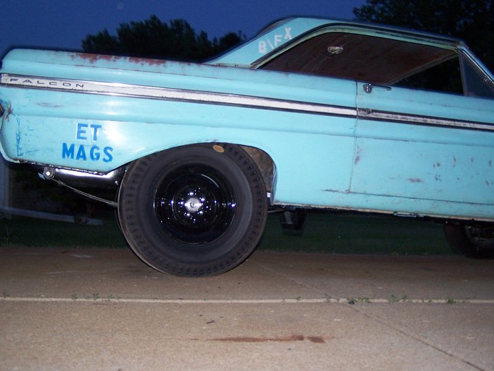

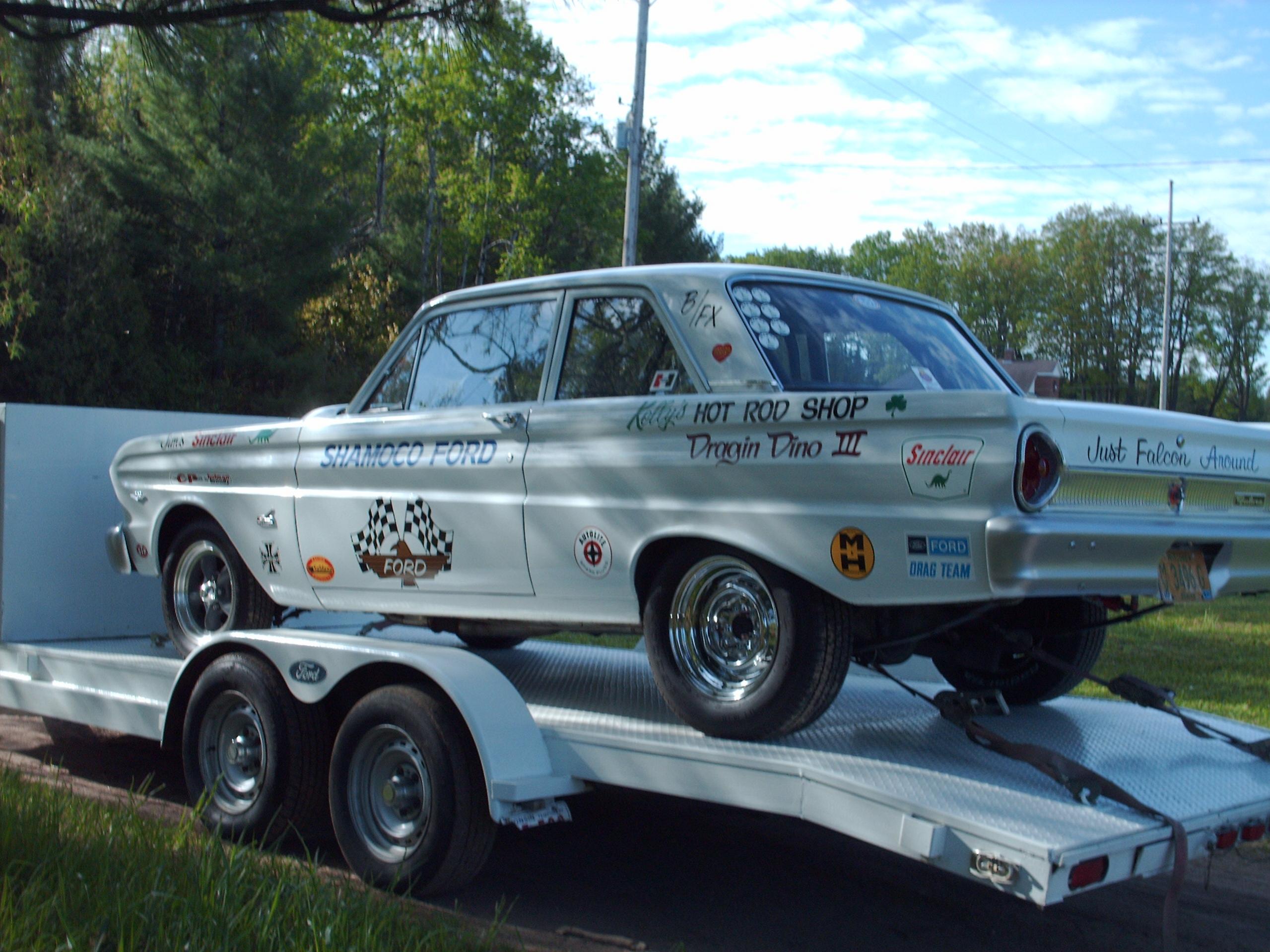

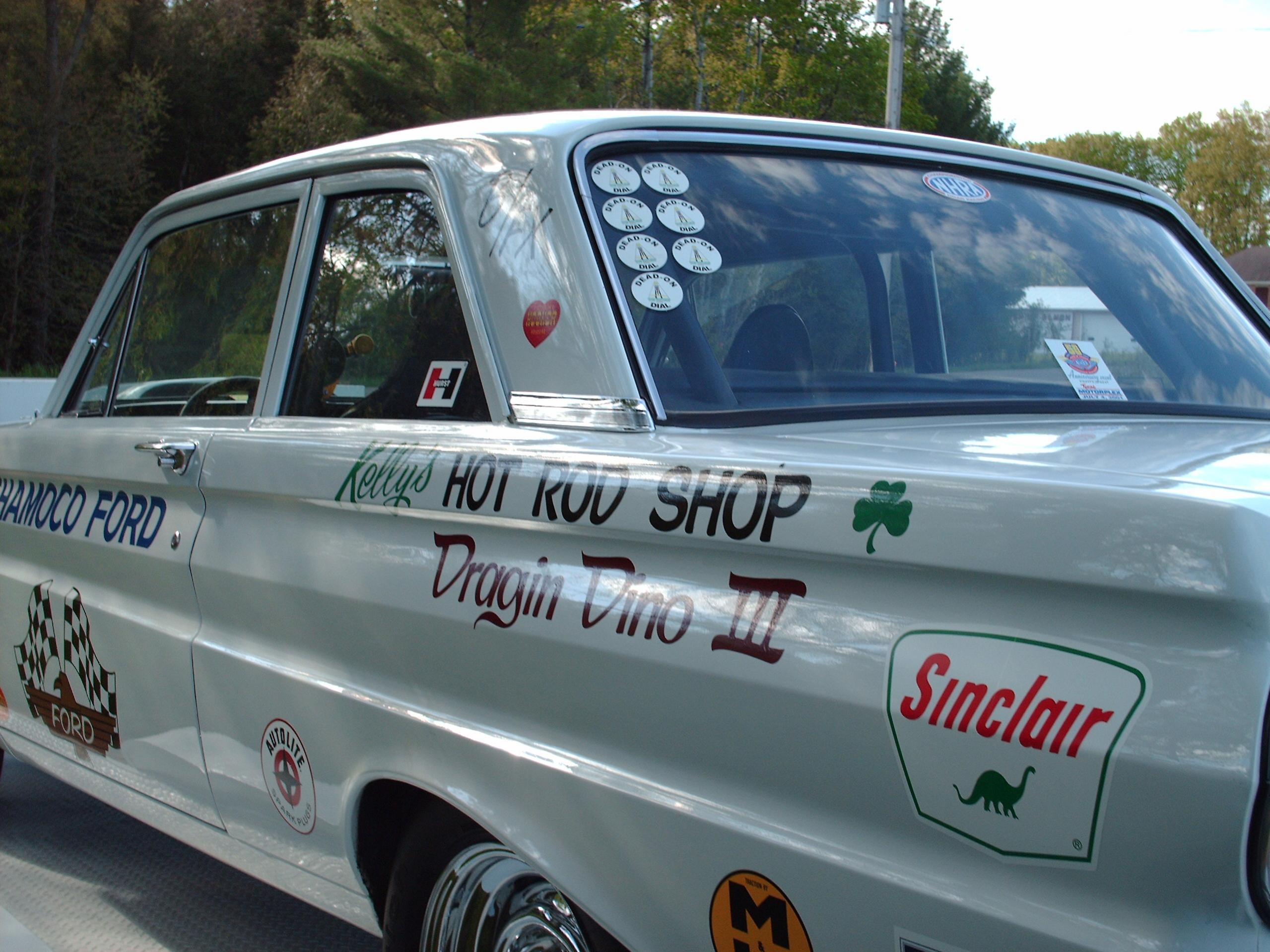

  19. Here are some pictures of the one I did and sold.. all hand lettered it was a race car most of its life!
  20. Kelly's:
    Diggin the Falcon!
    Fast Eddie

    I got my main rollbar hoop this week. I also got my N Case ford 9" with a detriot locker, 4.30 gears and a billet 1350 yoke! Finished mocking up the rear tires/ wheels. Off todriveshaft ear end housing shortened tomorrow and new perches installed!
    Next order of business will be to clean the bottom of the car off with a wire wheel, paint it as well as the new rear springs and gas tank in anticpation of the rear end being re-installed!
