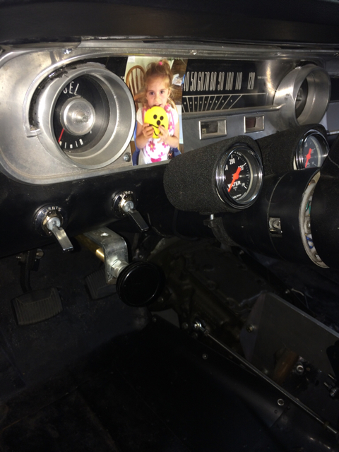

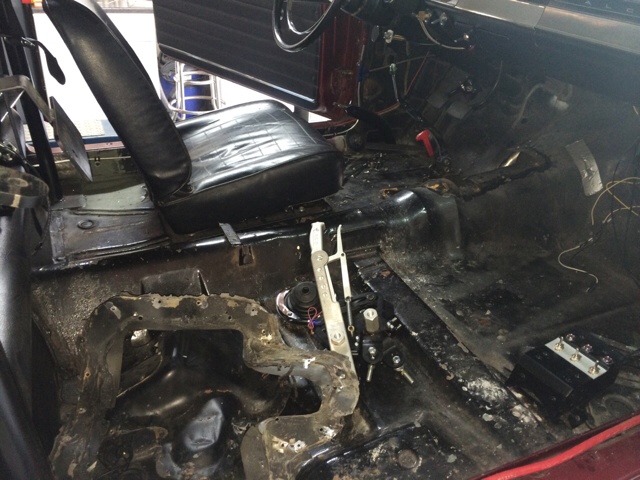

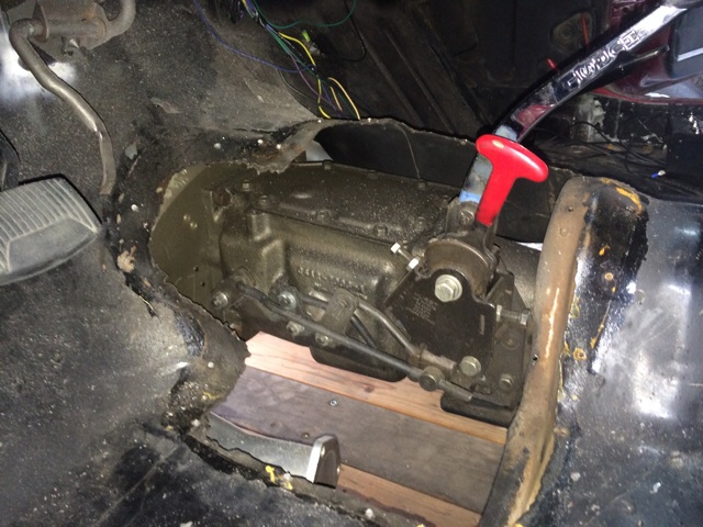

    New shifter installed, now I gotta make some rods for it! ImageUploadedByH.A.M.B.1410921770.747003.jpg ImageUploadedByH.A.M.B.1410921782.662878.jpg ImageUploadedByH.A.M.B.1410921793.497043.jpg

    Damm pretty serious shifter...looks like prostock shifter...cool !

    I agree very nice shifter mike!...........Al

    It's the same one Roy's been running for years, maybe I'll be able to shift better now!

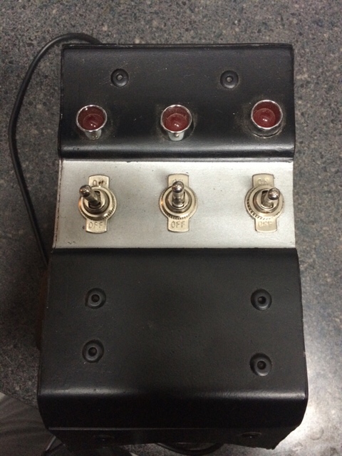

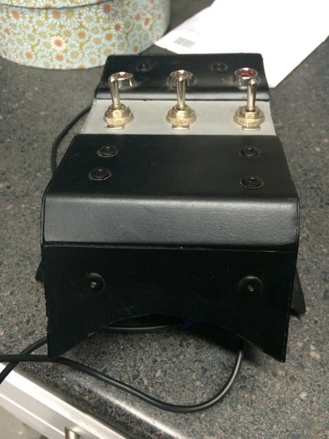

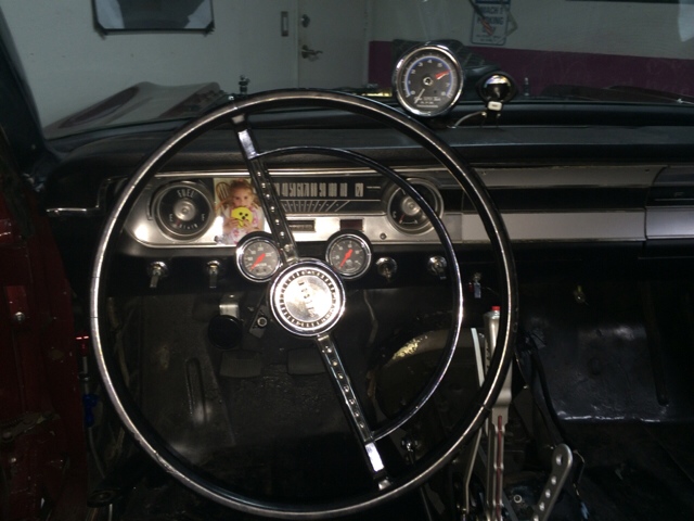

    Moved my water pump and fan switches to where the headlight and windshield wiper switched were. Now all my switches look the same. Got one shift rod made as well.

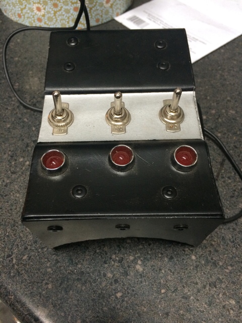

    My old switch panel I made out of a glove box door is for sale $30 plus shipping, one of a kind and has more money than that in the switches and lights! ImageUploadedByH.A.M.B.1411266330.525243.jpg ImageUploadedByH.A.M.B.1411266340.092273.jpg ImageUploadedByH.A.M.B.1411266352.876728.jpg ImageUploadedByH.A.M.B.1411266360.777433.jpg ImageUploadedByH.A.M.B.1411266371.495178.jpg

    Clean look and will save you some weight!.....Al

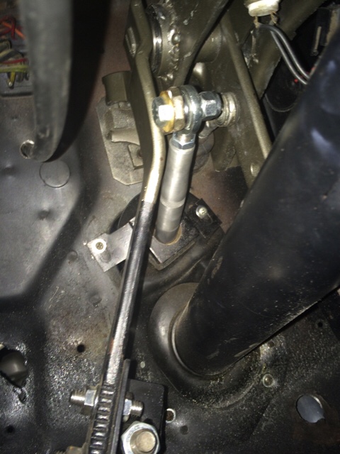

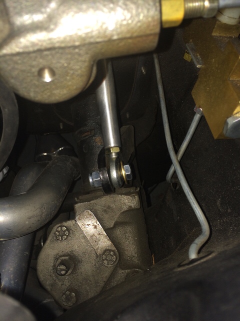

    Made some good progress today, almost got the tunnel cover done. The shift rods are done, had to cut and reeled the reverse arm on the transmission to work properly. Got a new clutch rod, from the pedal to the zbar, that is a 5/8 outside diameter threaded tube with Heim joints. Feels so much better and weighs half as much as the stock threaded rod. Got the header extensions on and welded the bungs for the pan-evac system to them. Just gotta work on securing my side windows then I should be ready to race! ImageUploadedByH.A.M.B.1412139349.416729.jpg ImageUploadedByH.A.M.B.1412139373.247629.jpg ImageUploadedByH.A.M.B.1412139390.632032.jpg ImageUploadedByH.A.M.B.1412139402.318695.jpg ImageUploadedByH.A.M.B.1412139414.117457.jpg ImageUploadedByH.A.M.B.1412139431.386046.jpg
    ec164 and powrshftr like this.

  29. powrshftr
    Joined: Mar 29, 2013
    Posts: 4,794
    powrshftr
    Mike,
    I really like that clutch rod you got.
    Where did you find something like that?
    Scott
