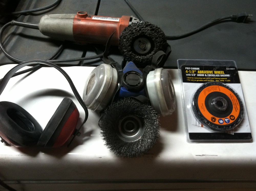

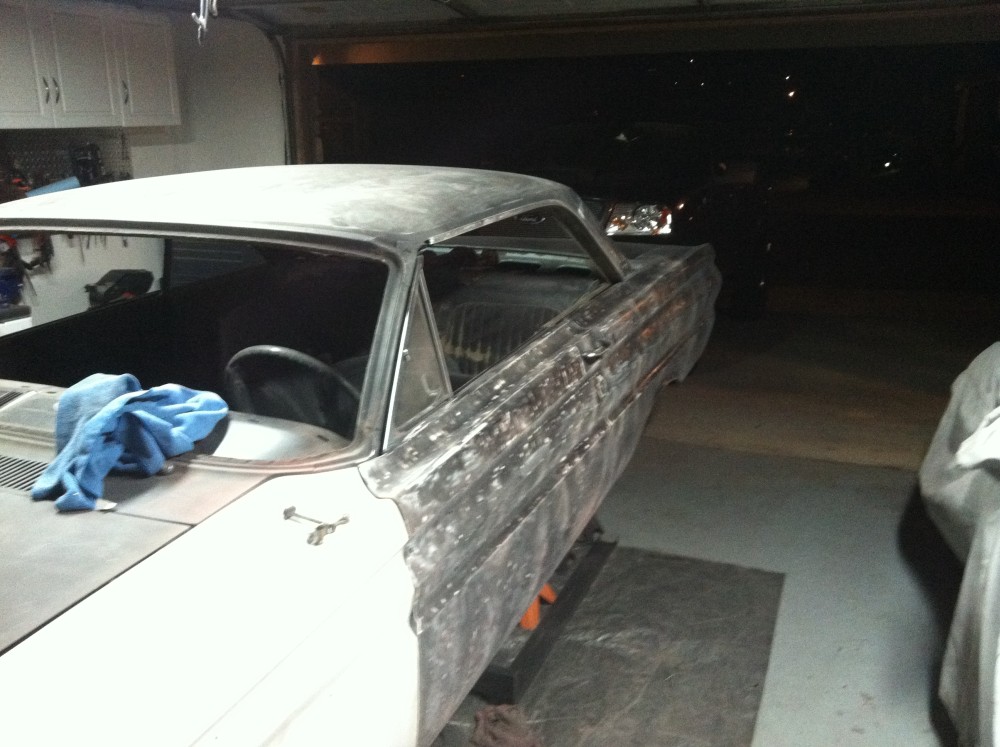

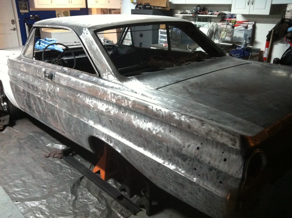

    I got the car all down to metal!! A little patch work needed, but not too bad. The abrasive wheel in the picture below from Harbor Freight knocked the layers of paint and primer off in no time. Just keep it moving and stay away from hard body lines so they dont get sheared off! The face mask and ear protection are required for this messy and loud job. I am sure my neighbors are happy i am done paint stripping though. Took about 10 hours over 3 days, was not bad at all.
    I think i am going to use PPG products and should get the car in DP90LF expoxy primer here in the next few days.. My first paint job..whats the wost I could do? :eek:

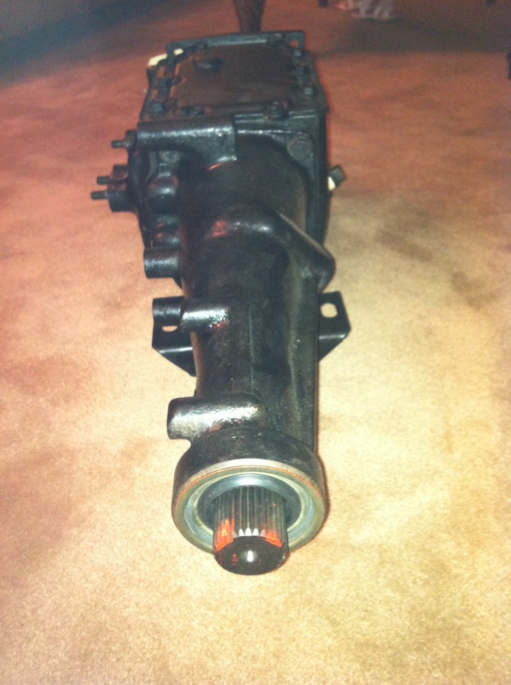

    Picked up my Toploader today, I had the big block 1 3/8 input shaft and 31 spline output shaft installed. They had to bore the tail housing for the larger mainshaft. I thought about going the Liberty route to have it pro shifted, but decided i would see what type of damage i can do to the br*** blocking rings LOL! Now i just need to modify a small block clutch fork to fit a big block throwout bearing!

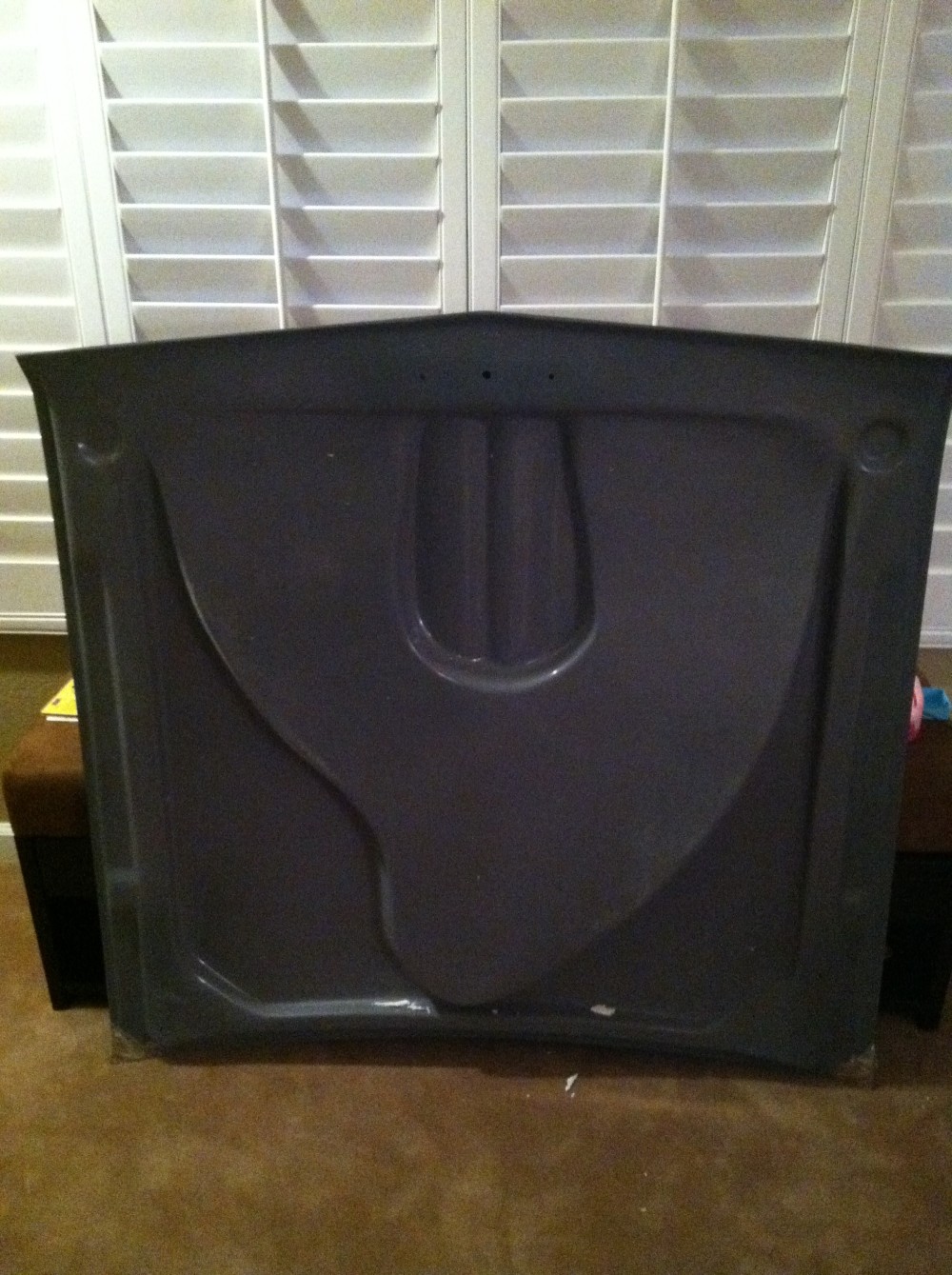

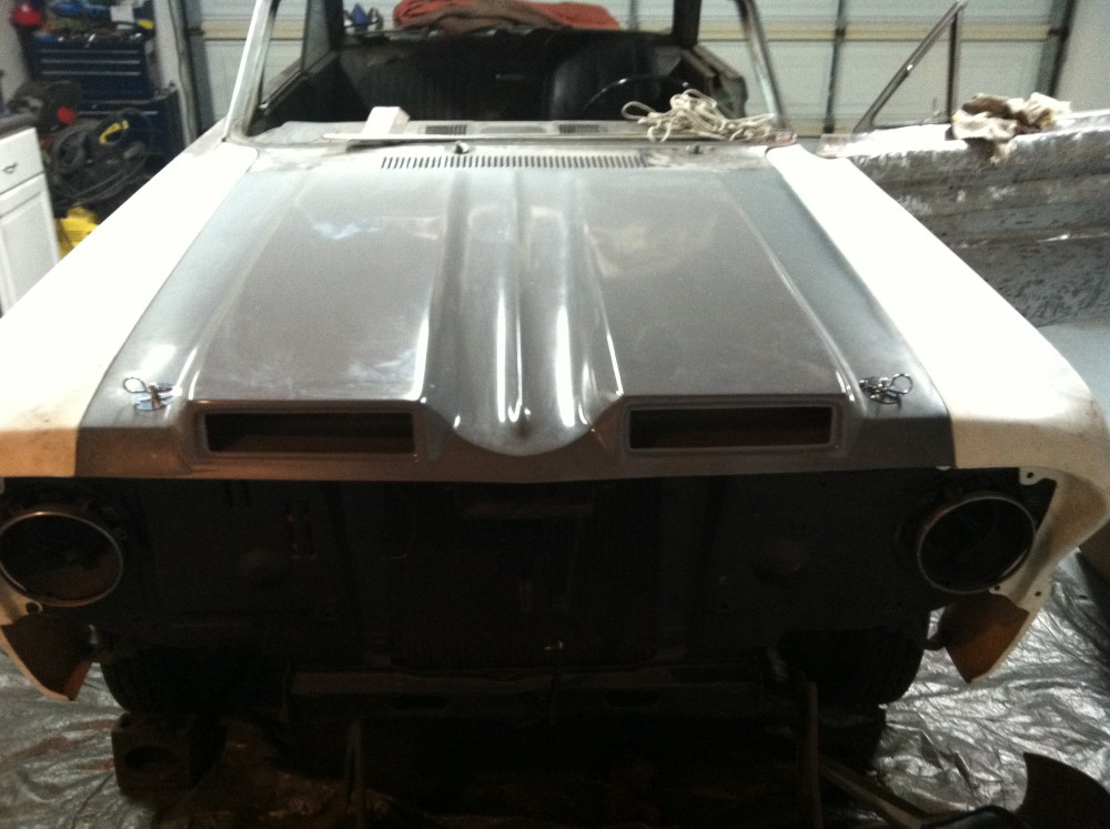

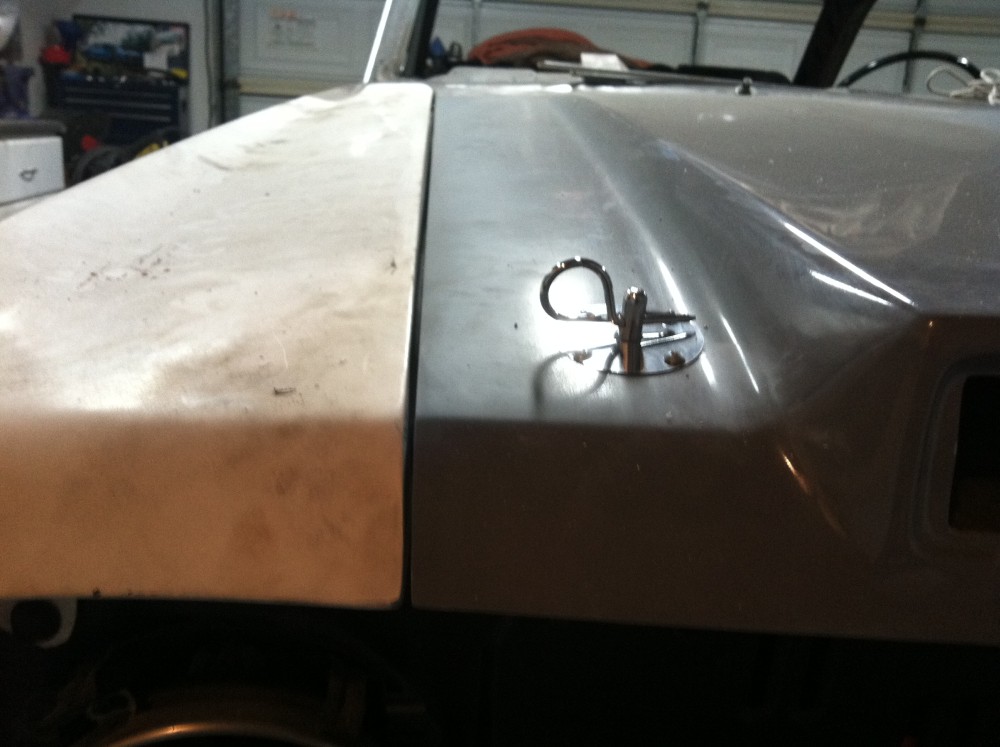

    fiveoh108
    UPDATE:

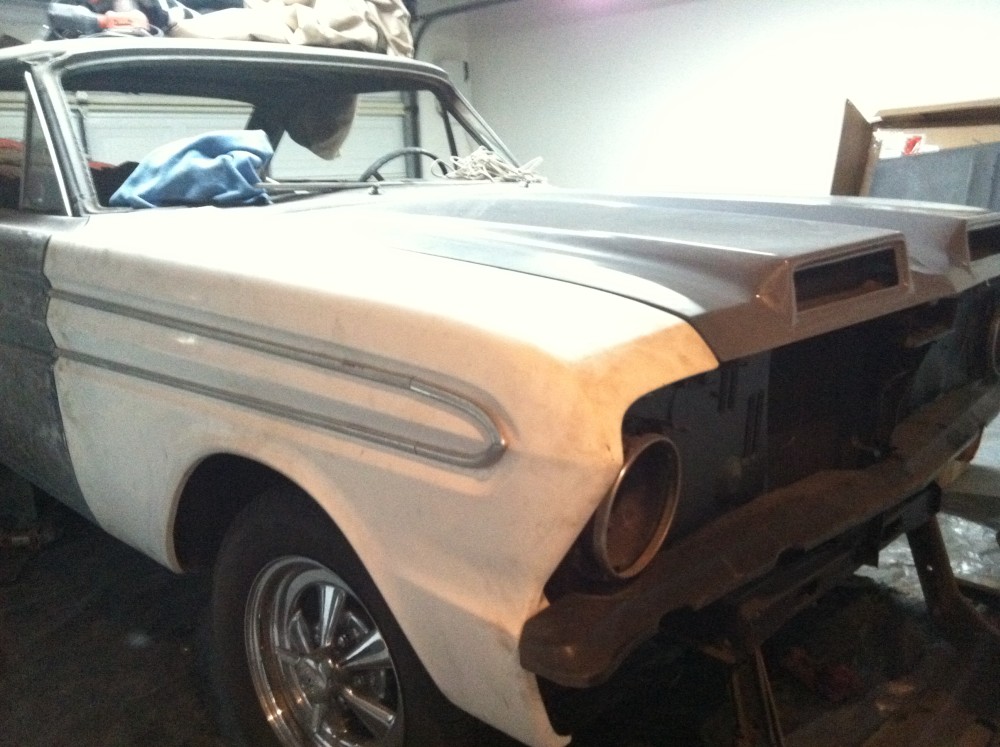

    I got my new comet style dual snorkle hood. I think it is really cool. At first it did not fit super great, but i shimmed the drivers side top hood hinge to the body hole about 1/4, it moved everything over to where it needed to be. The hood is slightly twisted so the drivers side sits a little bit higher at the front than the p***enger side. After installing the hood pins, they hold the hood in place and you cant tell its higher on one side anymore.

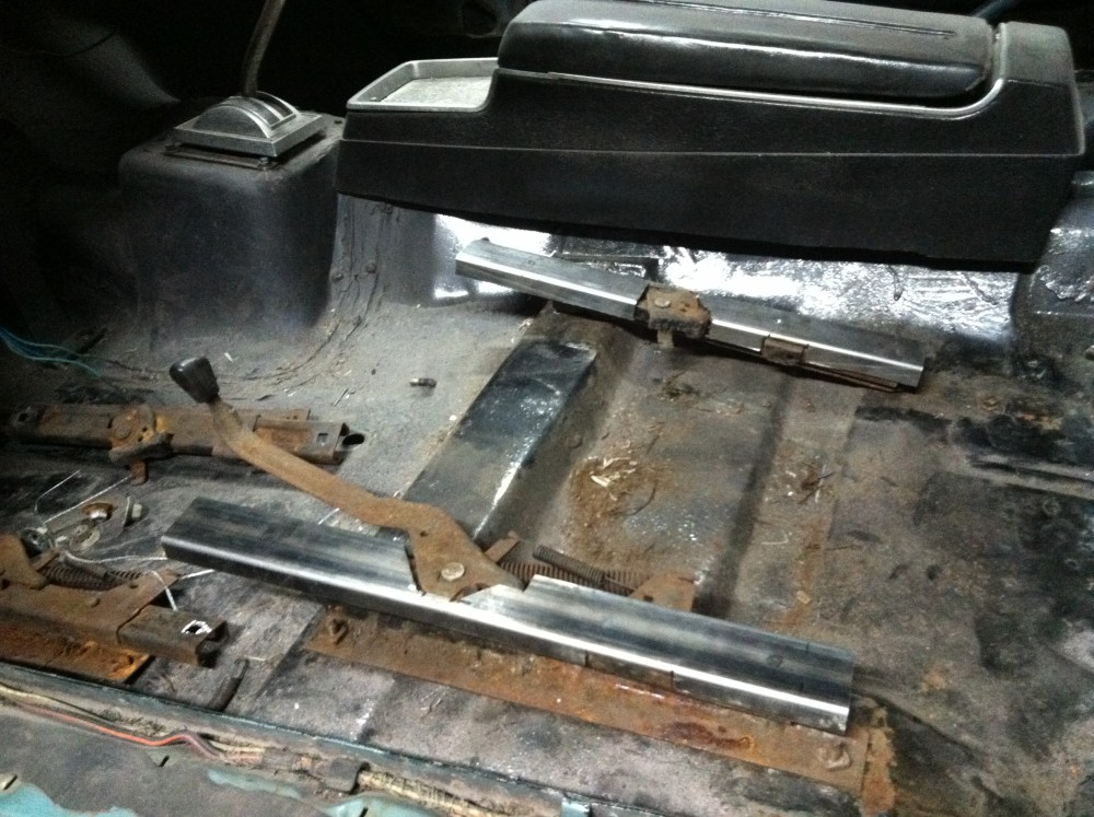

    I also made metal covers per-se to go over the stock seat brackets and extend them 3 inches to fit the a100 seats. I need need to borrow a drill press to pop some holes in the new extention brackets, then i should be good to go.
