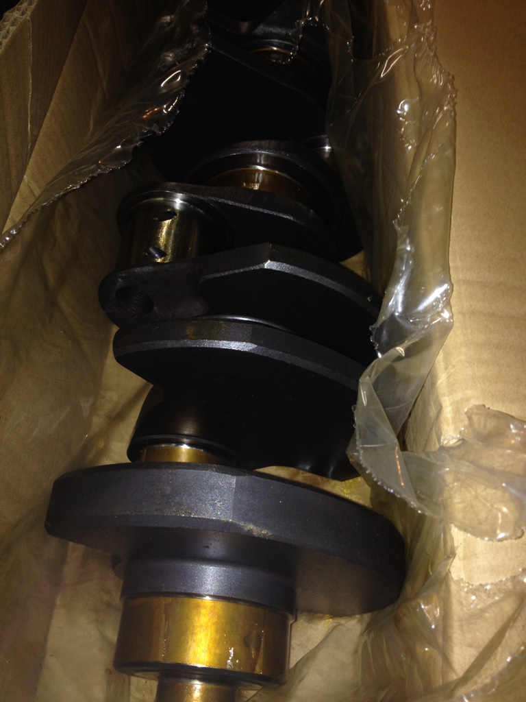

    Parts for the new motor are arriving , 4.170 crank and 6.250 rods, pistons are on order[​IMG][​IMG]

    Nice new stuff. Spiffy rods too.

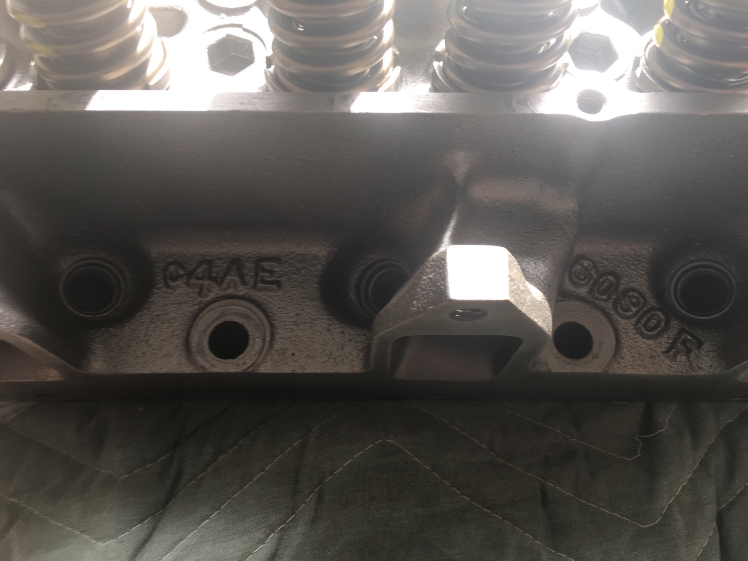

    Well I found one! 427 Ford Side-Oiler, High Riser! Things will be busy over the next year getting it to fit in the falcon and building it![​IMG][​IMG][​IMG][​IMG]

    Posts: 40,351

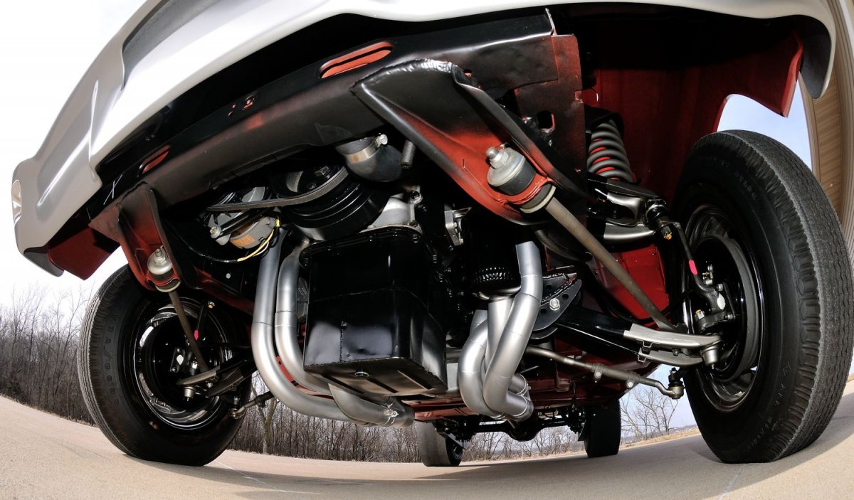

  28. LOLOL... I had a stroker 427 in a '67 Cougar, and I remember those headers very well. First install (by myself) was 8 hours per side. I eventually got it down to 8 hours for both sides.... Definitely an exercise in patience....
    You'll pretty much need to totally remove the shock towers for the FE. Compared to a '67 Mustang, the Falcon engine tub is 3+" narrower. Ford used custom-fabricated short upper control arms and moved the springs outboard about 5" to get the FE in. Here's a pic of Dyno Don's Comet.... https://blog.hemmings.com/index.php...omet-cyclone-to-cross-the-block/#&gid=1&pid=5
