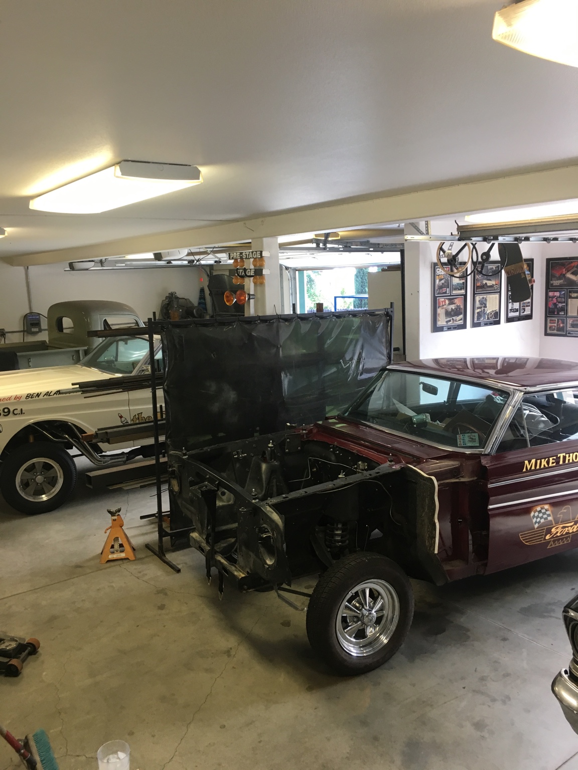

  27. fiveoh108
    Joined: Jun 15, 2010
    Posts: 1,189
    fiveoh108
  28. powrshftr
    Joined: Mar 29, 2013
    Posts: 4,794
    powrshftr
    That is a big old ***y slab of aluminum right there...[emoji16]
  29. powrshftr
    Posts: 4,794
    powrshftr
    Gene Cromer who's a die-hard Ford man since forever,has stated that he sometimes ran quicker times with a Hi-Riser than a Cammer,depending on track conditions,car setup etc,because the wedge motor made so much more torque,so much sooner in the power band,that it would just grunt a light little car (sort of like yours) right out of the hole,and pull like a freight train all the way through the lights,where the Cammer wanted a bunch more rpm to really work its magic.
    I think you're gonna have a pretty serious weapon on your hands,Brother.[emoji16]
    Scott
  30. fiveoh108
    Posts: 1,189
    fiveoh108
    Made a lot more headway today, got the shock towers cut back, interior gutted and some of the lettering removed. It's slow with 1200 grit and water! [​IMG][​IMG][​IMG][​IMG][​IMG][​IMG]
