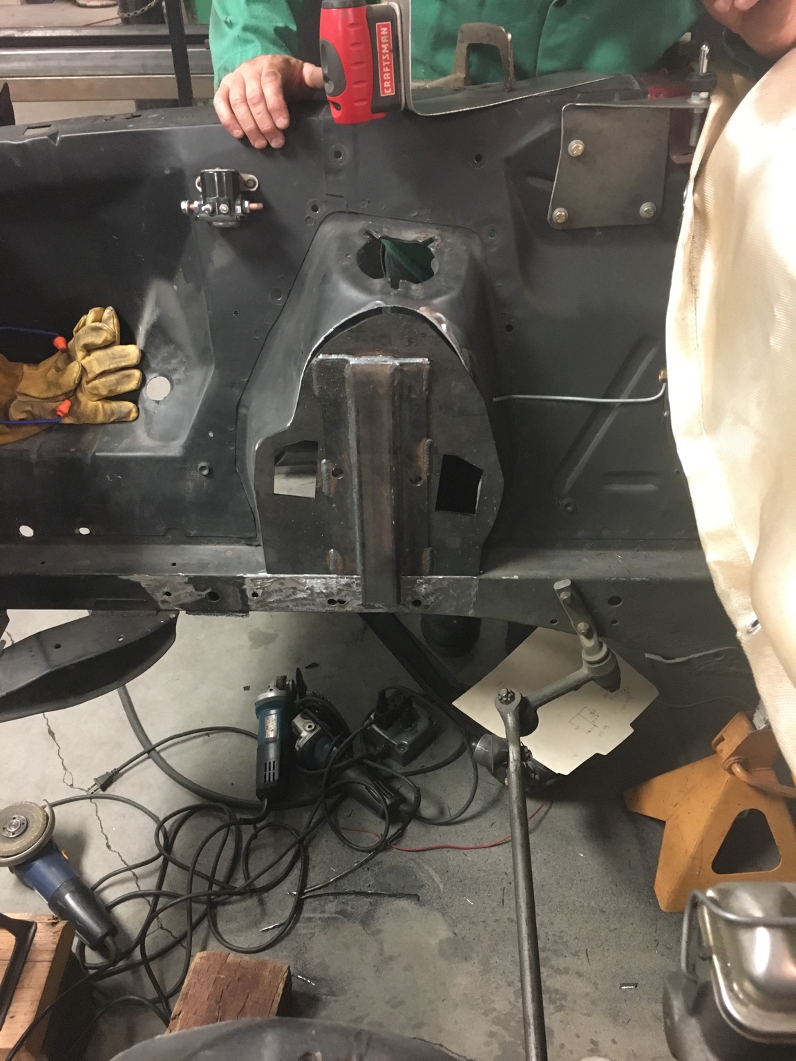

    Yes it's the Crites kit. We did a couple extra things like removing the sway bar mounts ( I haven't run one in 3 years) and closing up the cowl ( Dale's idea), for a cool look! Plus it will keep water out. Dale is one heck of a fabricator and welder, that's for sure. [​IMG][​IMG][​IMG][​IMG]

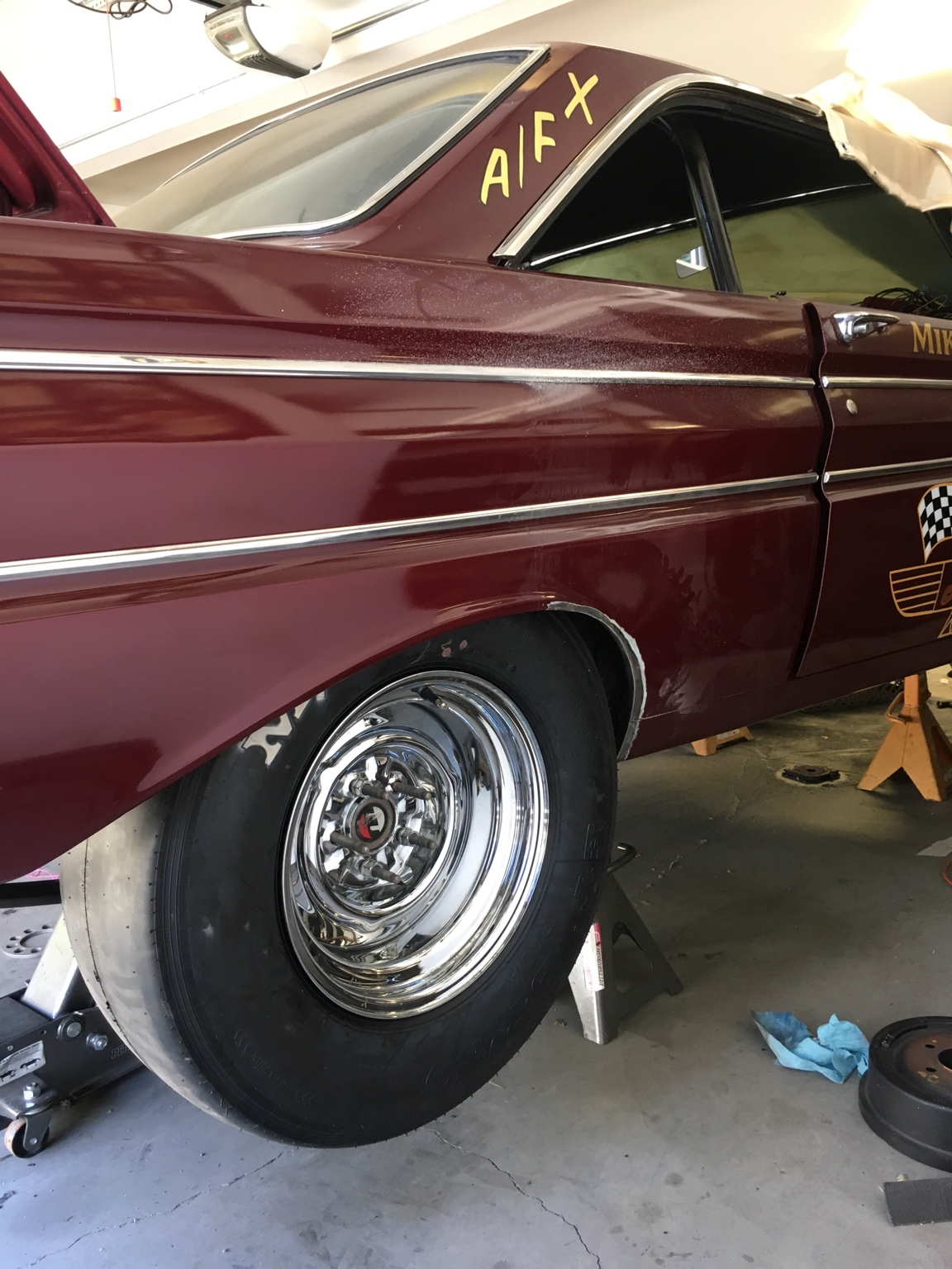

    Some updates, final welding on shock towers and cowl. New lettering!

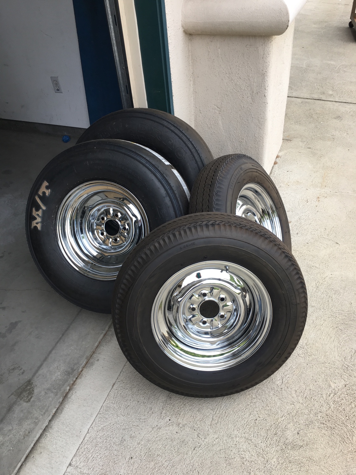

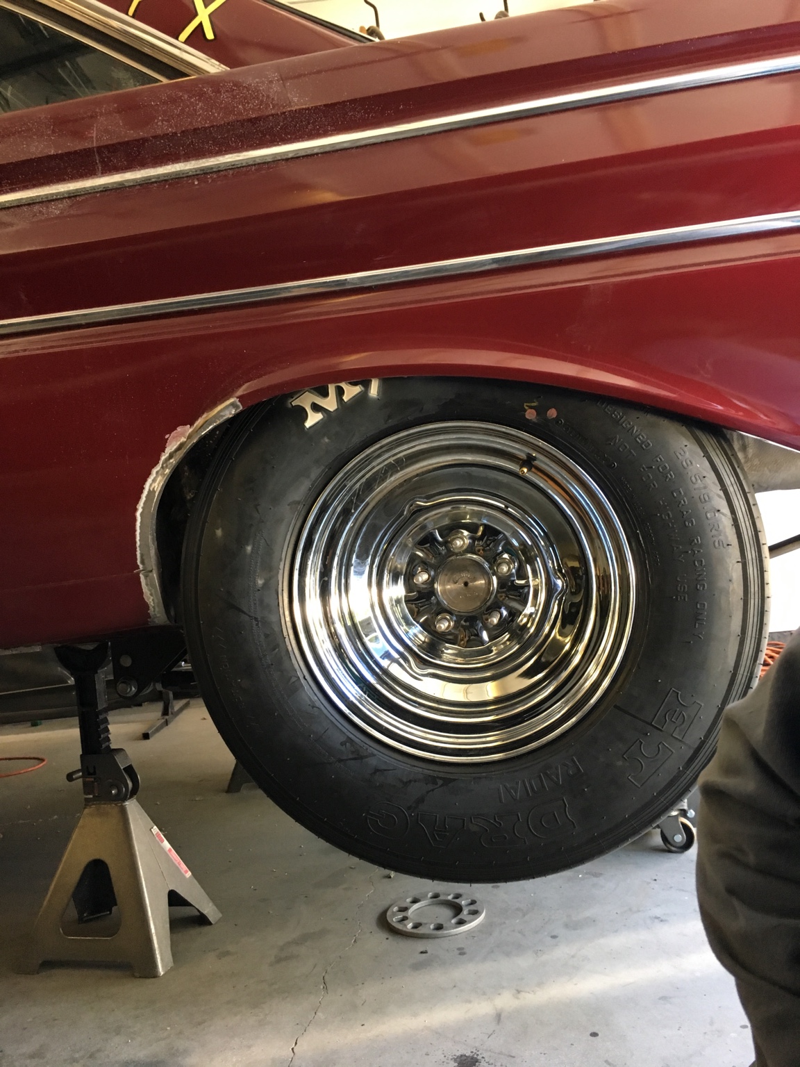

    Fitting the new wheels and tires[​IMG][​IMG][​IMG]

    1947knuck, fiveoh108 and Gammz like this.

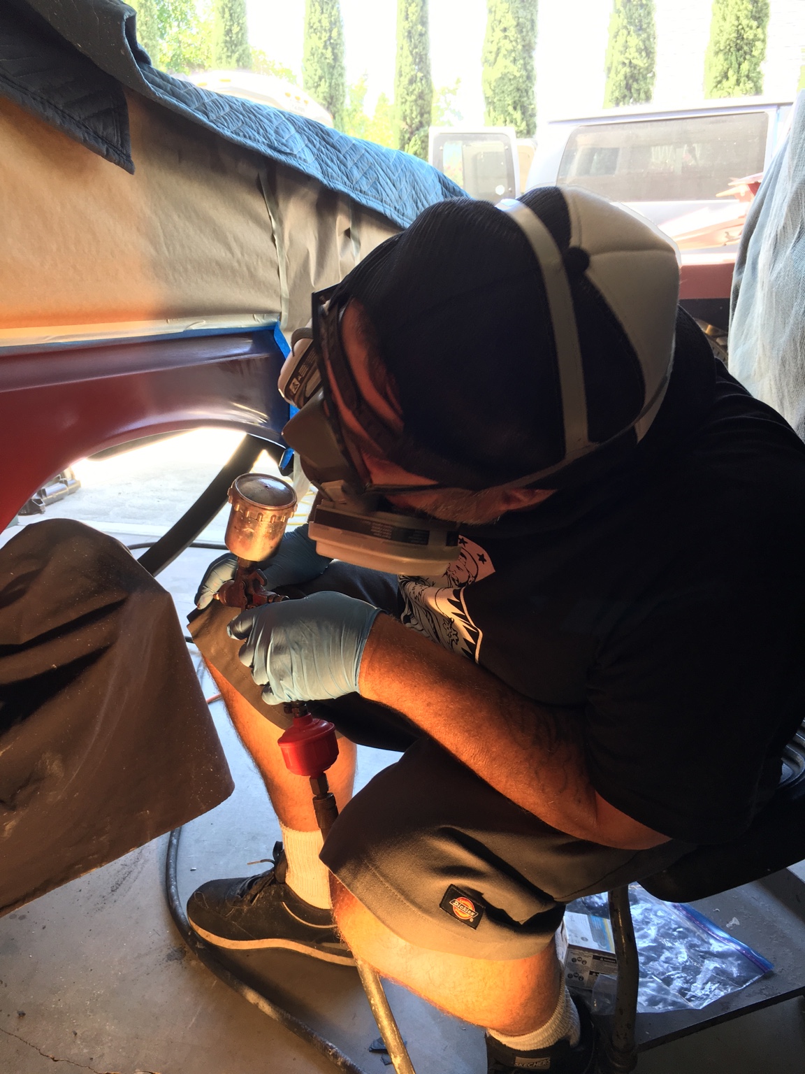

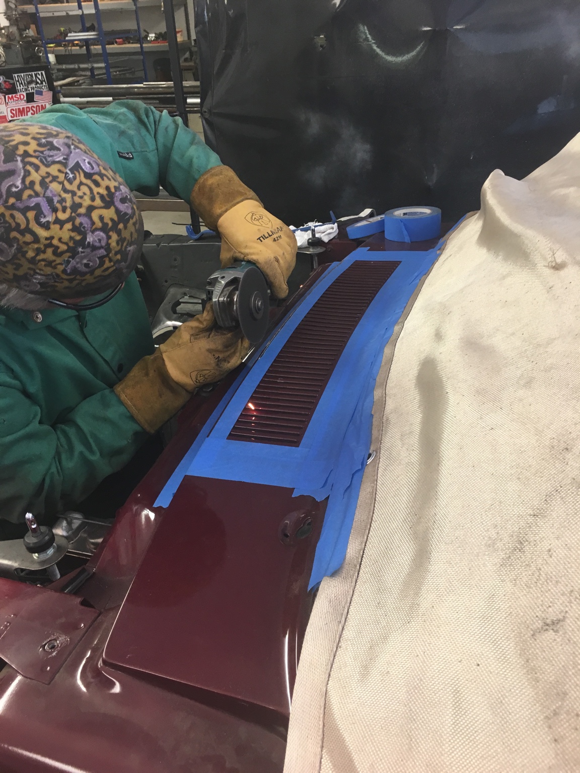

    Paint and body work blend/ touch up by "Super" Todd Hoffman [​IMG][​IMG][​IMG][​IMG] No more cowl grill

    New wheels and tires mounted[​IMG]

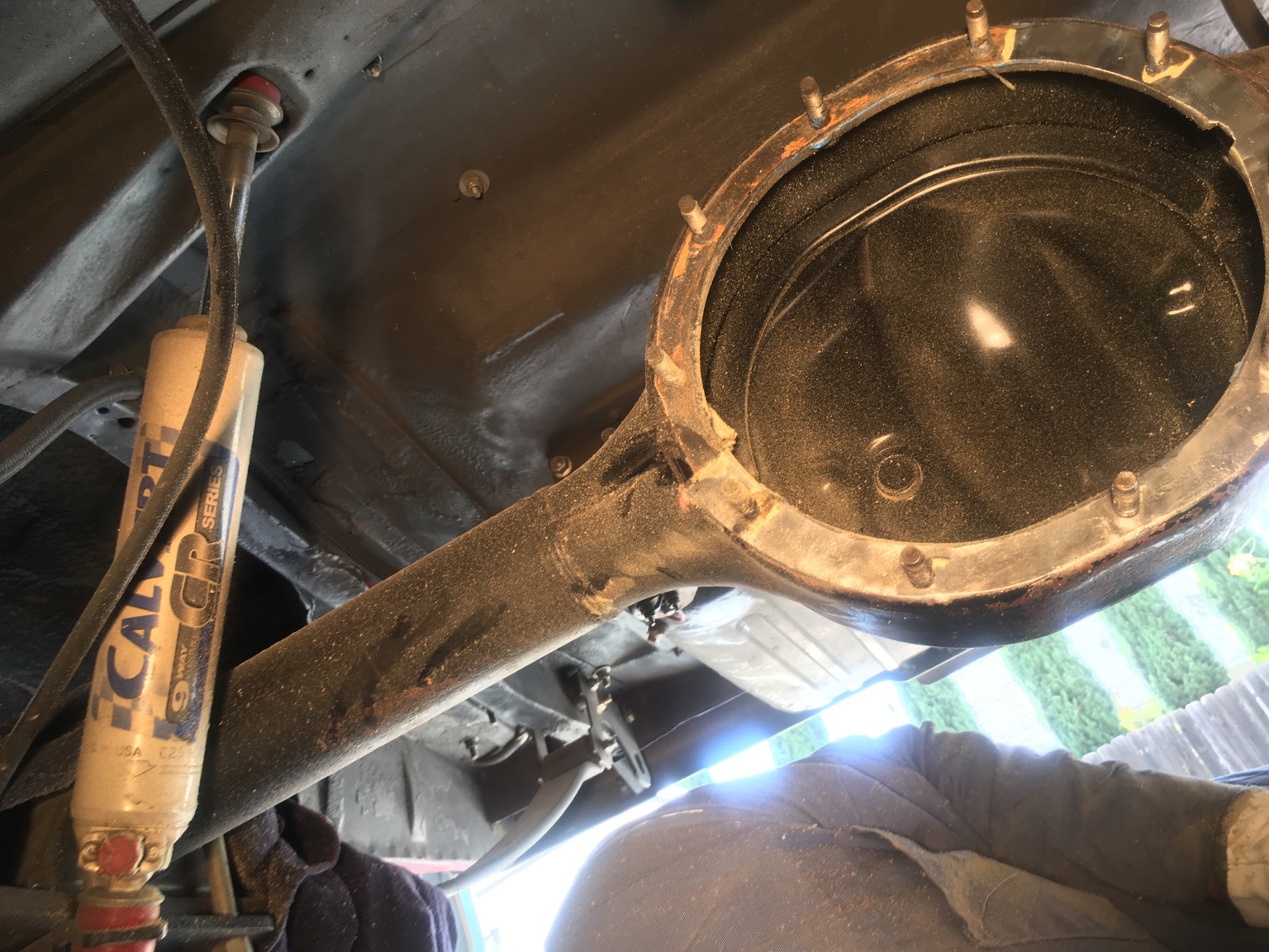

    Dale working his magic filling in that huge trans hole[​IMG][​IMG][​IMG]
    Taking out the 4.63s and putting 4.11s in
    [​IMG][​IMG]

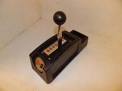

    Trans tunnel about done[​IMG]
    Original Hurst shifter to get me through the gears[​IMG]
