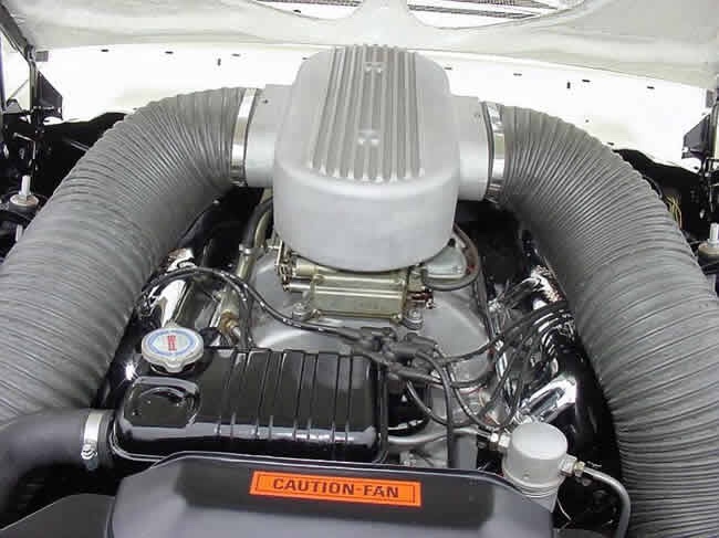

    Trying to make it look kinda like this. I have a perfect overflow tank I might try to run, I just heard with all the vibration, they spring leaks. Every thunderbolt I have seen had one on it though....[​IMG]

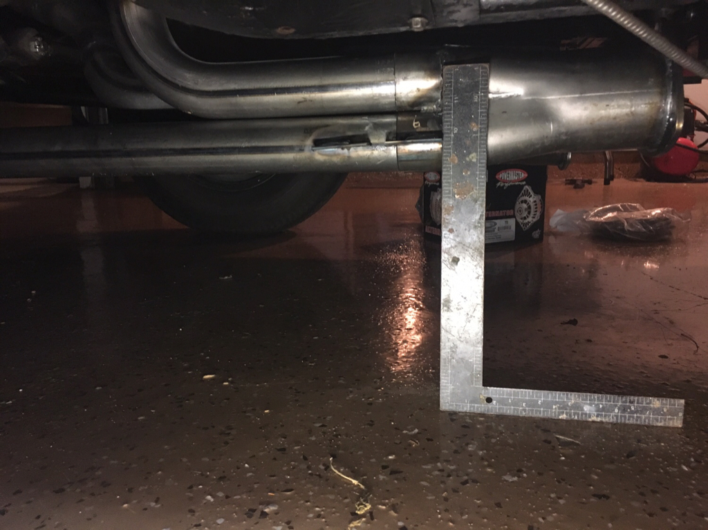

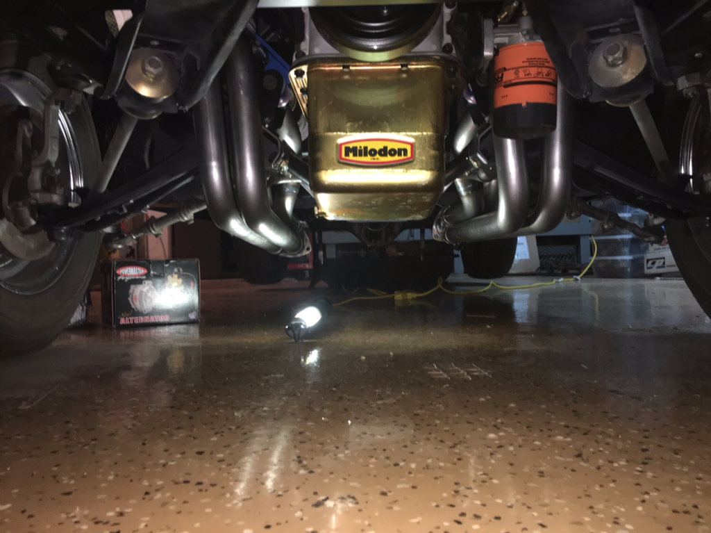

    The headers arrived after 7 months of waiting, I wasn't ready for them anyway before now, but they fit amazing. I have 9.5" of ground clearance too. [​IMG][​IMG][​IMG][​IMG]Now I can take them off and get them coated

    Nice, the individual flanges MAY make spark plug changes a LITTLE easier. But nothing helps much. Gloves and a cold engine is the trick to saving your hands. :rolleyes:

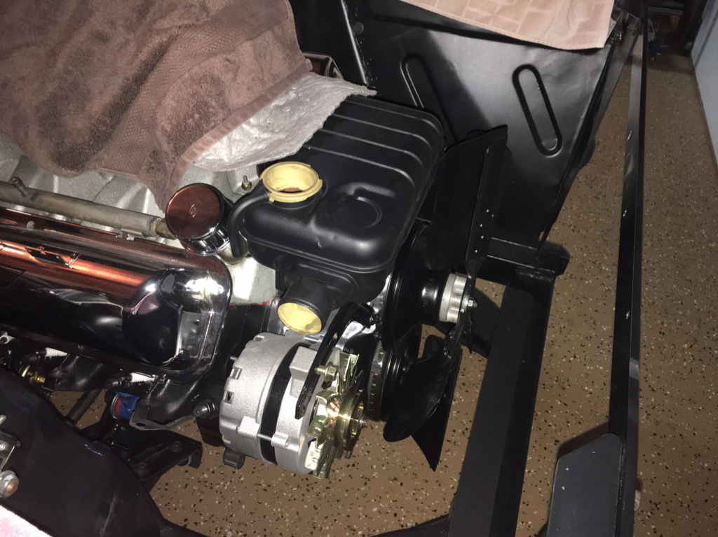

    Dropped the headers off to get coated today. Also got a new steward emp thermostat, not cheap, but from my research seems like a good investment. I also decided to run the factory style surge tank. The fan spacer is too short and try fan hits the surge tank so I need 1/4" more spacer to clear it. My lead mechanic helping!

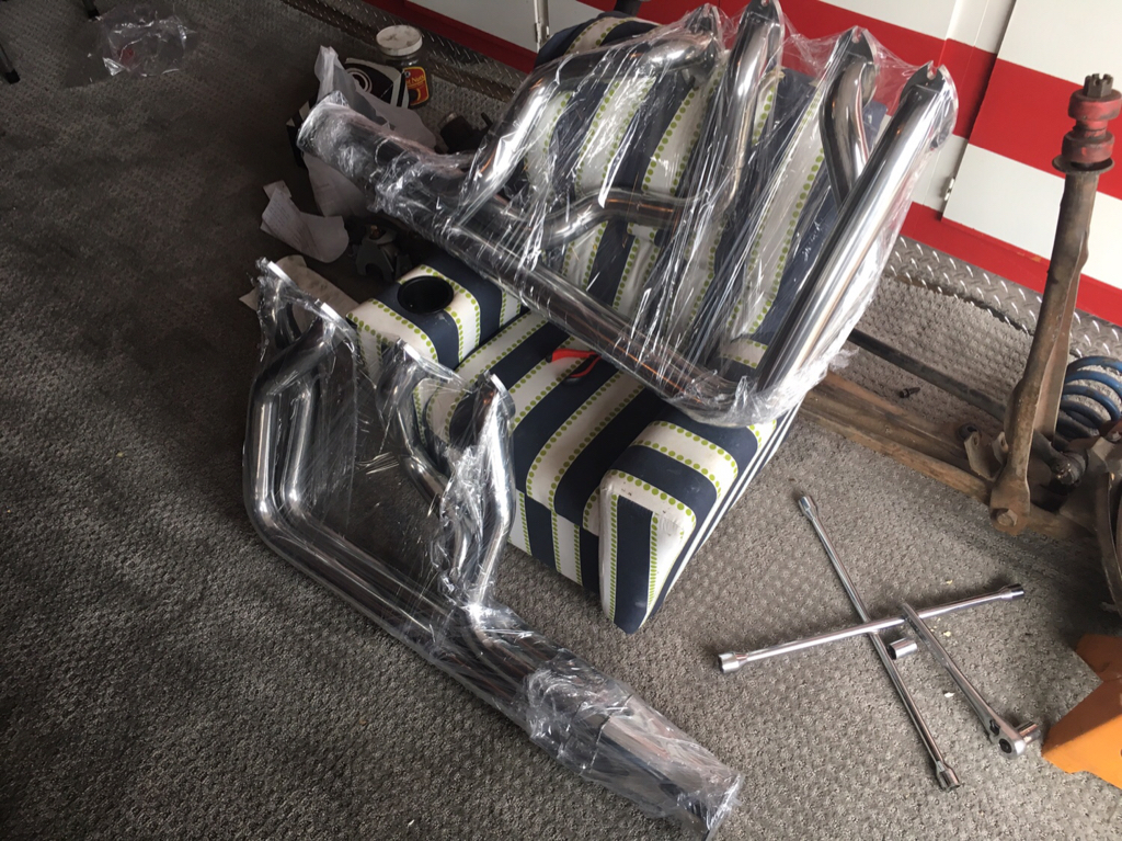

    Headers are back and hopefully will be [​IMG]installed this week
