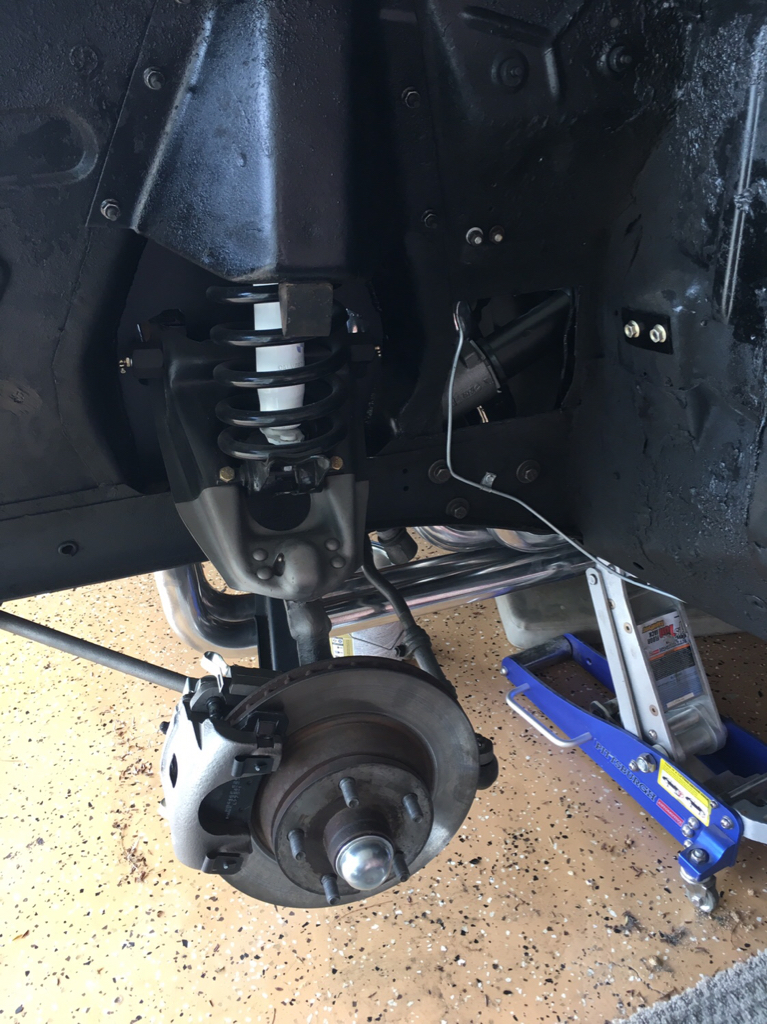

    For the calipers and some of the brake stuff on today. Got the headers on too![​IMG][​IMG][​IMG][​IMG]

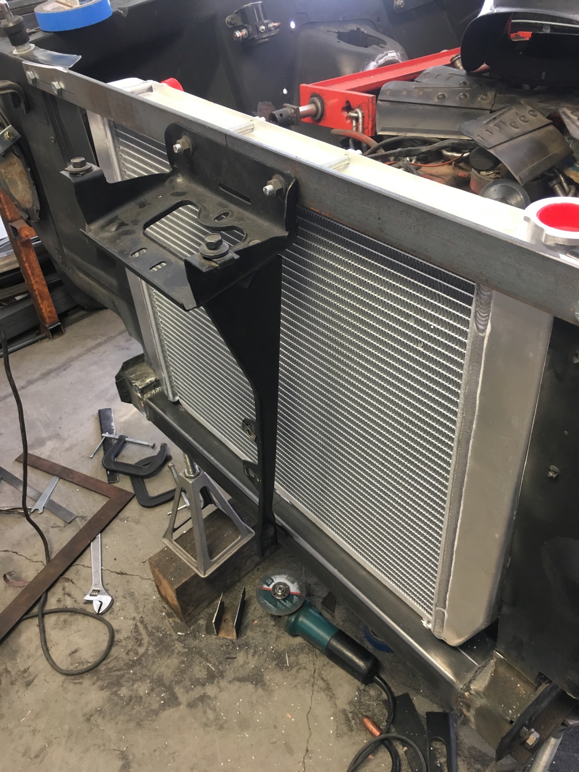

    bigmikes50chevy

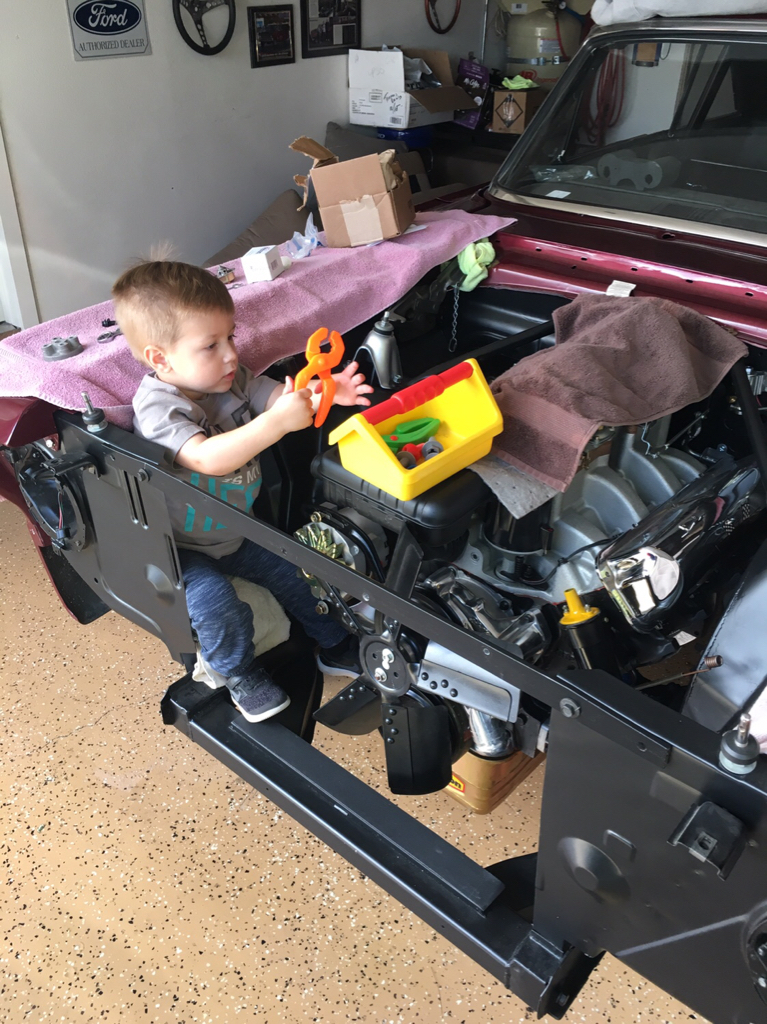

    what's the bottom of radiator mounted to? or, how is it mounted?
  4. bigmikes50chevy
    Joined: Mar 19, 2010
    Posts: 372
    bigmikes50chevy
    because I'm stealing some ideas here.........
  5. fiveoh108
    Joined: Jun 15, 2010
    Posts: 1,189
    fiveoh108
    Not a problem! It is a speedway radiator, it has a saddle on the top and bottom. Dale welded a male type raised portion that on the frame that the saddle of the radiator sets over with a piece of thin foam on the bottom to stop vibrations and metal to metal rub. In this picture you can see the raised portion on the frame that my sons shoe is on...I shouldn't be sharing this with someone who has "Chevy" in their handle! LOL [​IMG]

    They are already in, not to bad, the headers dive almost straight down, they don't come out much towards the shock tower so it's not much tighter than the small block with tall valve covers

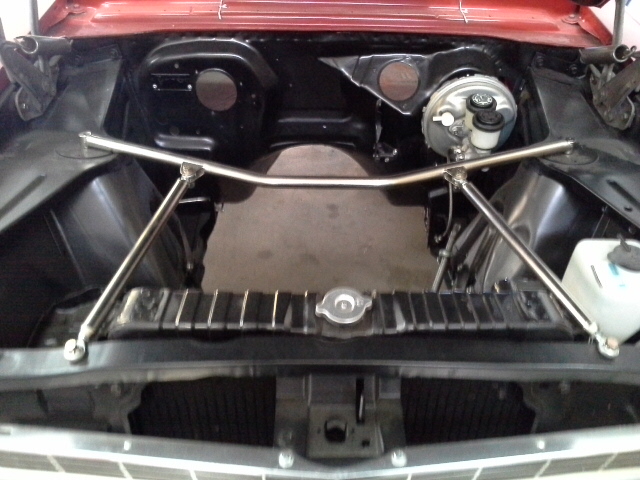

    It's uncanny how the Falcon and Nova front inner structure look alike.
    Not that you will be doing any "canyon carving" with your Falcon but this is what I did on my Nova after substantial modifications to the front suspension (not HAMB kosher).

    They do look the same, the Nova looks to be much better supported from the factory! I took out my sway bar and mounts, plus removed the factory shock tower braces, the cut some of the inner wheel out and lastly, made the radiator support removable... hopefully it doesn't bend in half!

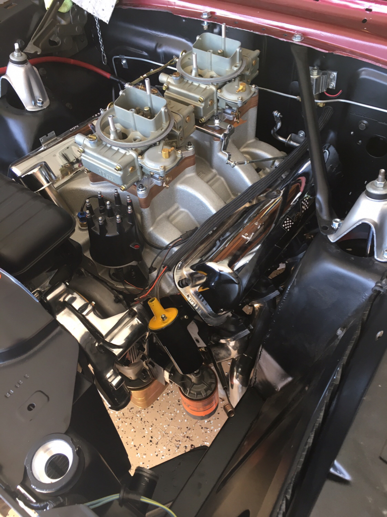

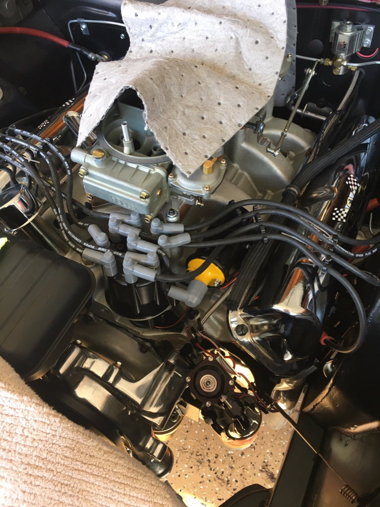

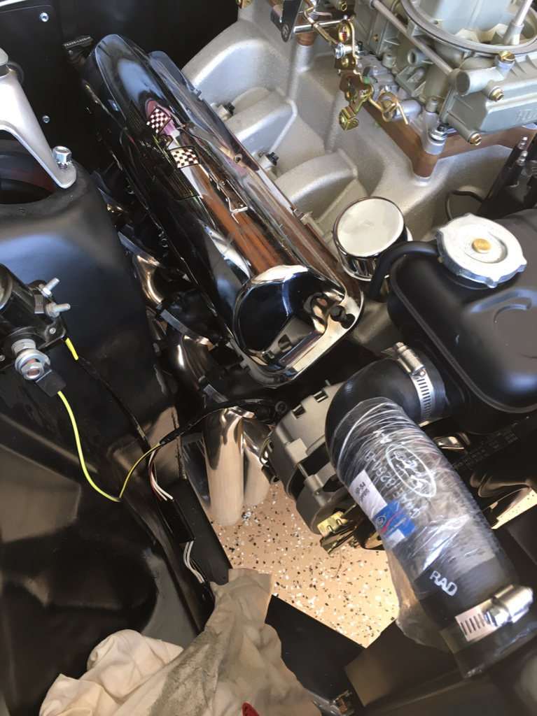

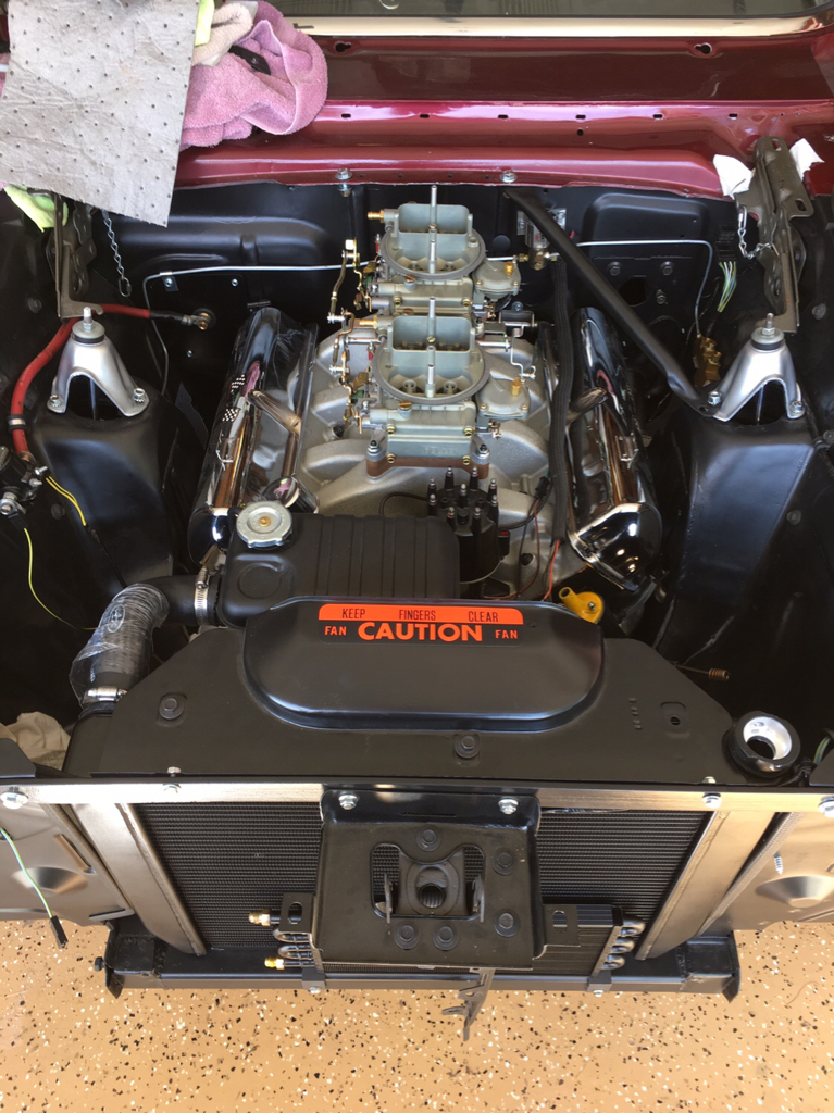

    Got some exciting news this week!! My car will be featured in Derale's ( one of the first members to start SEMA along with names like Cragar, Moon, Isky, Edelbrock etc..)booth at SEMA this year. The Derale booth is right across from the FORD display and in the main building.. it is a great honor and I am truly humbled....Now I have a deadline to make.

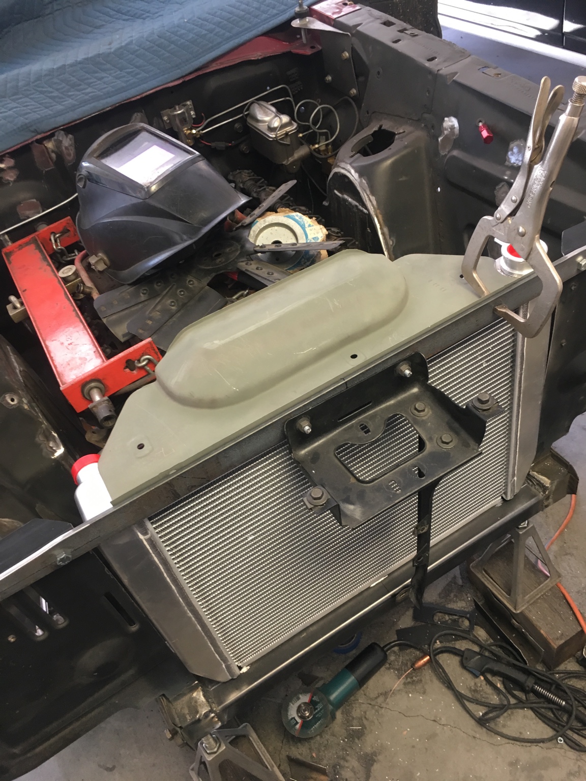

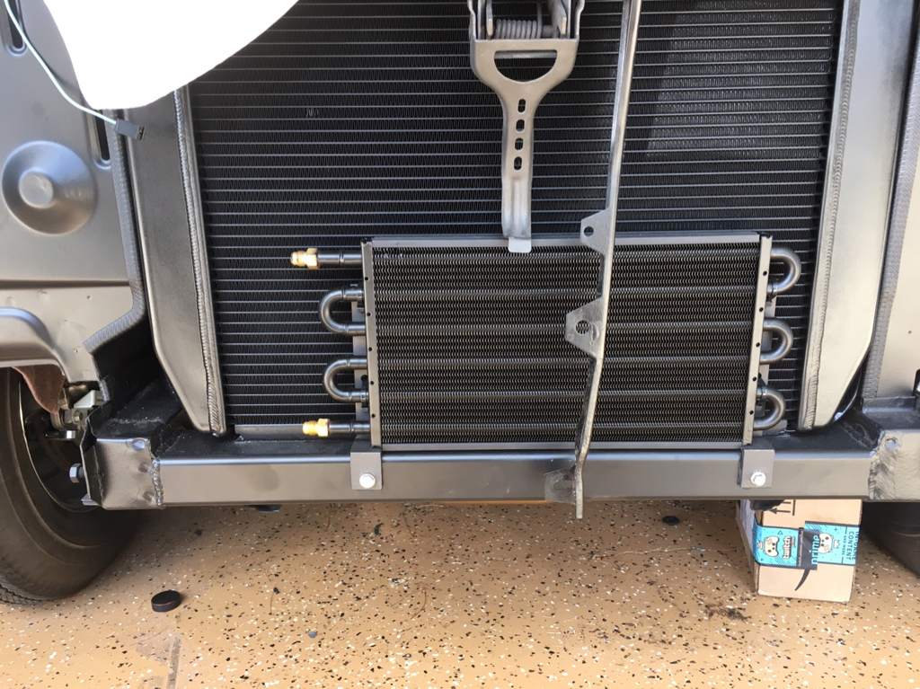

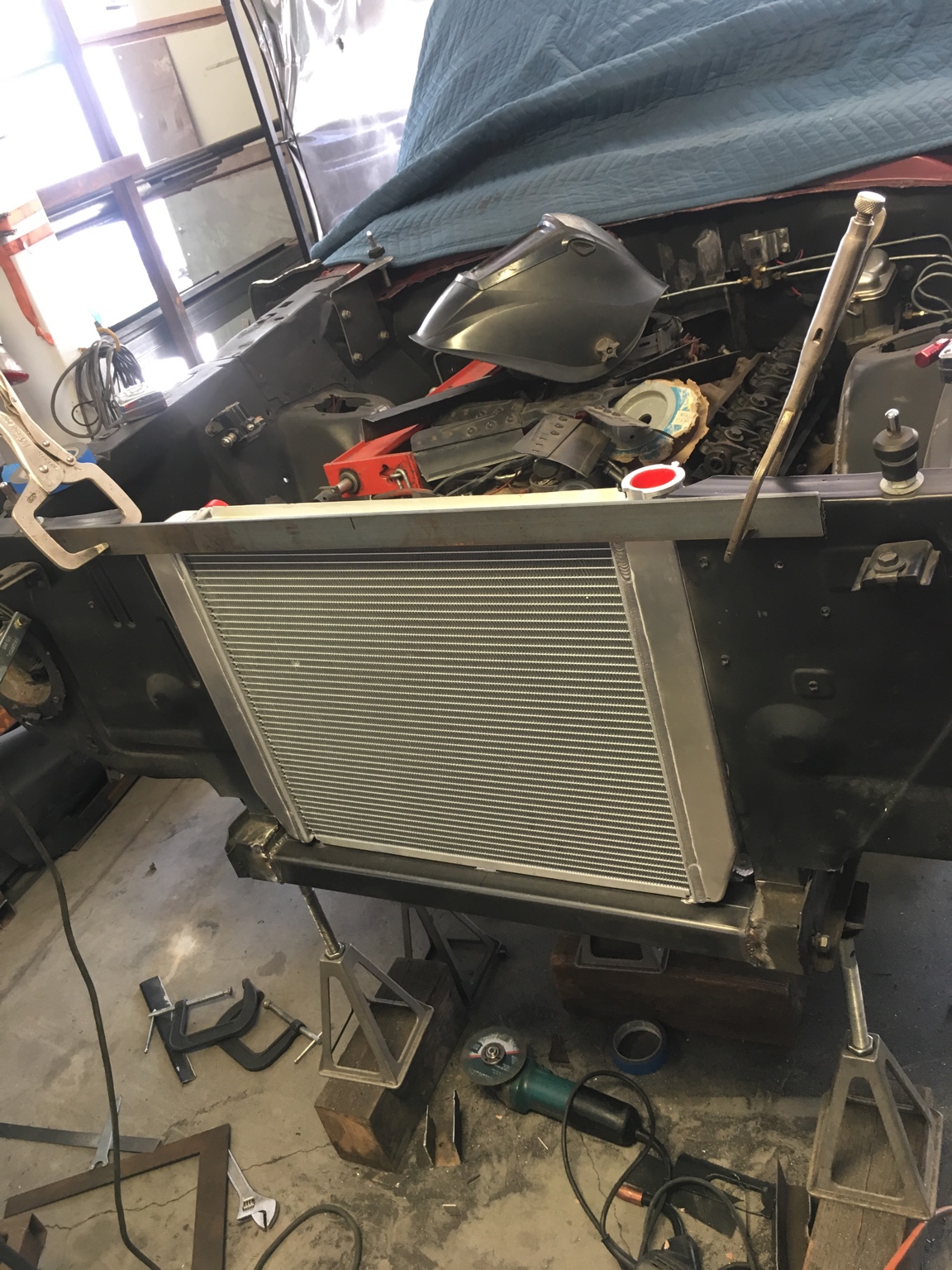

    Had to move the coil, I just didn't like how the fire sat beneath the fuel lines! I also custom made universal msd wires and got the seat mounted with a custom Dale Snoke mount! Got the final radiator and trans cooler mount fit done too.

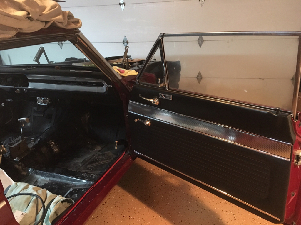

    Door panels in, it's starting to look like a car again![​IMG][​IMG][​IMG]

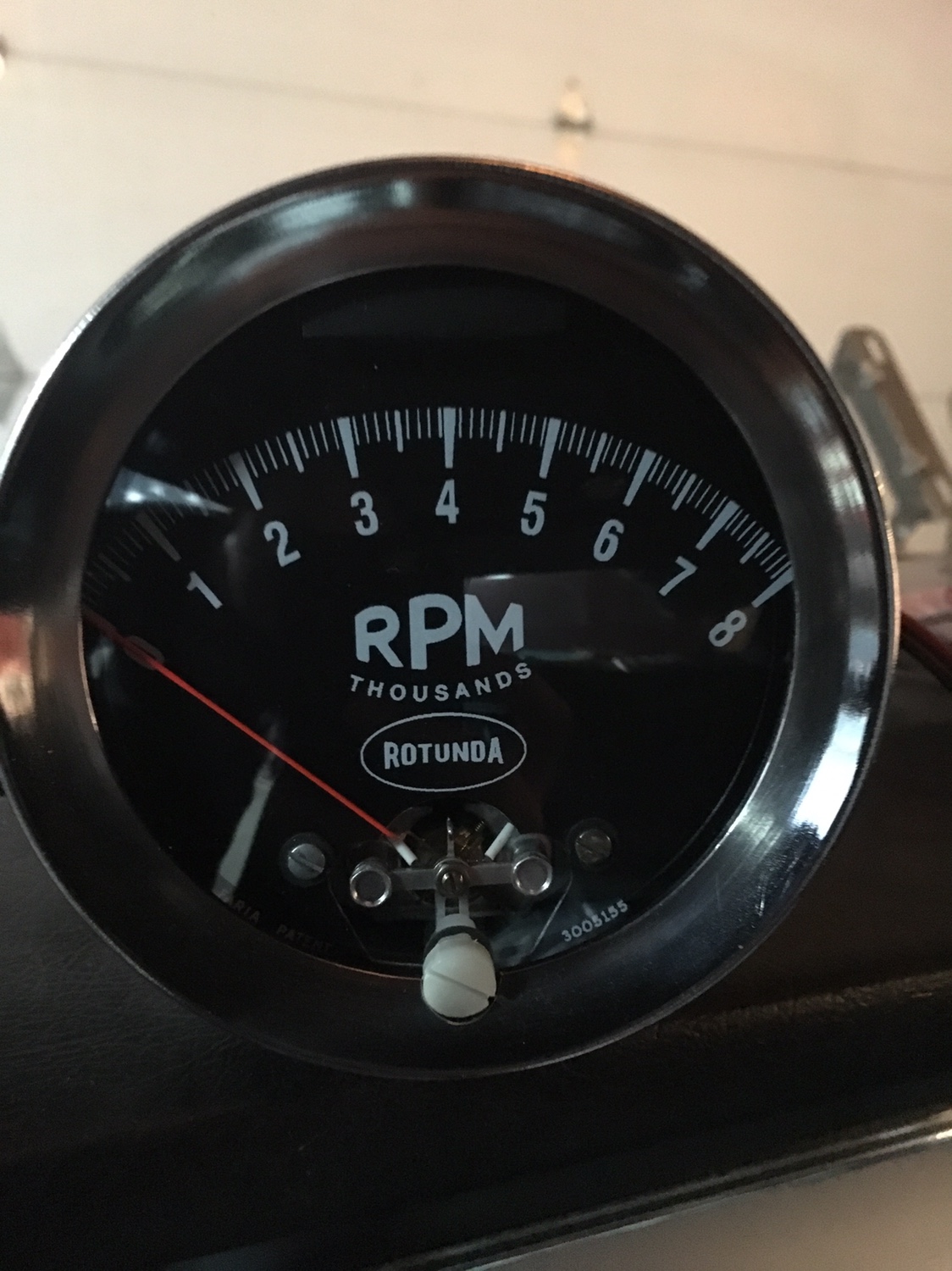

    If you know ford tachs you will recognize this one, NOT easy to find, or get restored!
    [​IMG][​IMG]

    I found it on eBay and had it converted to an 8k, from a 6k. It is hard to find the tachs with the front light like this Factory Thunderbolt one, most have the rear push in bulb that is not correct for the cars, but will work. The cup I found separately on eBay. I had it restored by Phil Severance, he also restored the tach on my dad's cyclone. Came out amazing and he's a good guy.

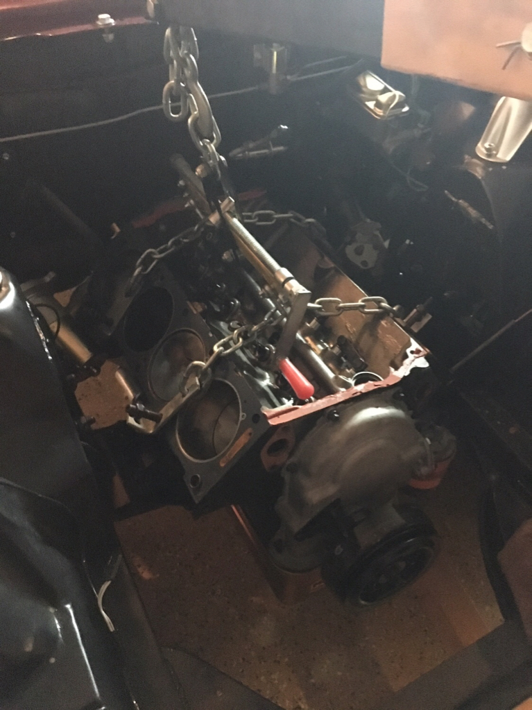

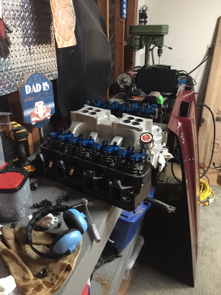

    And.... back out... water filled #1, one pushrod tip smashed... glad I haven't paid the engine builder yet... going to someone else tomorrow .. [​IMG][​IMG][​IMG]

    They can be if your engine builder isn't a liar and a putz!!

    It was a "friend" 7 hours away who facilitated everything with his shop, he won't answer the phone. It's ok, I will see him at a race in the future, you can't hide forever. Either way, it will be fixed and something really cool came out of this.... I will have the details in the future.
