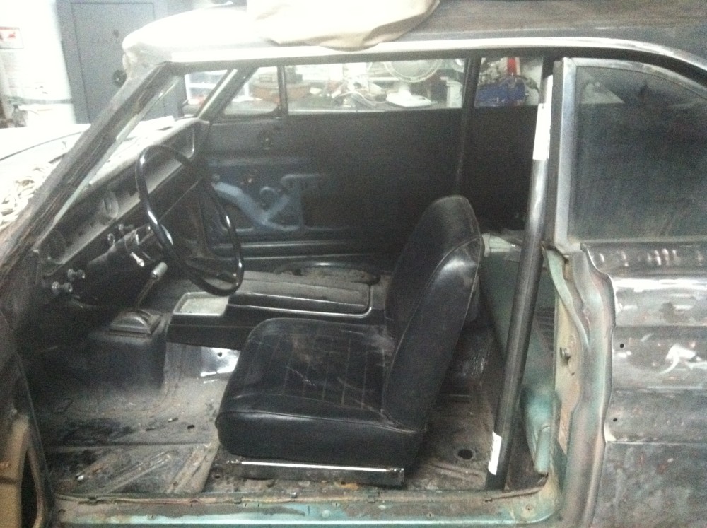

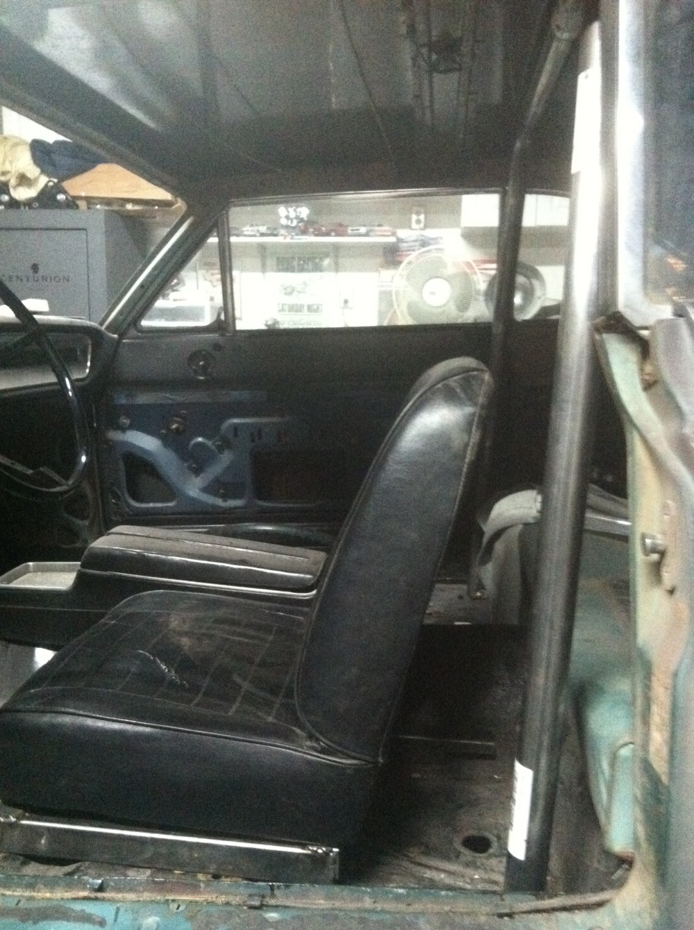

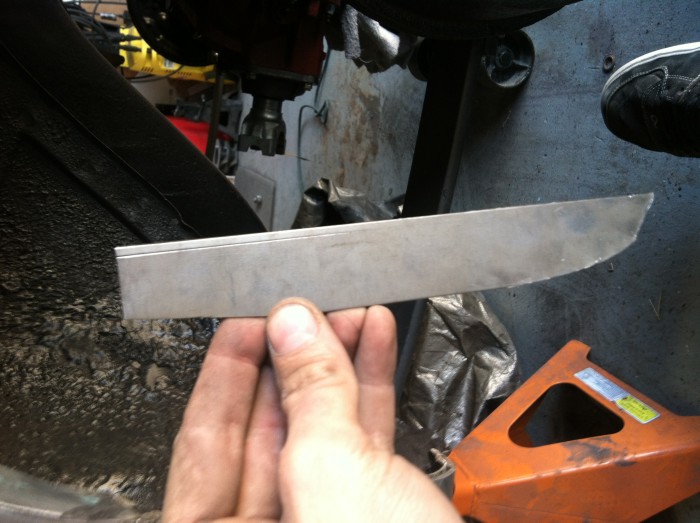

    Got one of my seat mounts built and welding together, I was going to use the stock bucket seat tracks, but decided it was going to be difficult to mount my A100 seats to them. I spent a lot of time making brackets for the stock seat tracks, but oh well, the new set up is much sturdier and simplier, keep it simple!

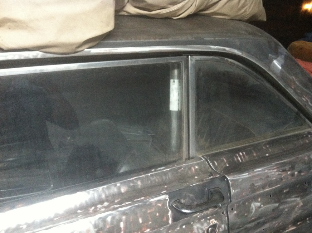

    I also started fitting the main roll bar hoop, getting it lined up with the stainless window trim from the back and front side windows, looking from the side directly you will not be able to see it. (thank you for the suggestion Roy).

    Mike;the seats look like they are kind of LOW! Have you sat in one to check position?John does not have measurements or angles for the rear bars,sorry. ROY.

    Without my helmet or a headliner I have about 2-3 inches to the roof a most. The seat brackets I made are a little shorter than the factory ones to give me just a little more room so the roll bar is higher than my helmet and I meet all of Nhra s requirements

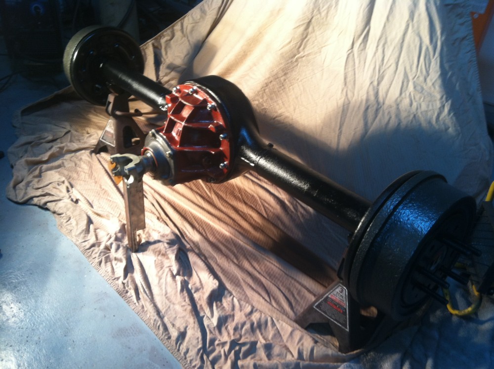

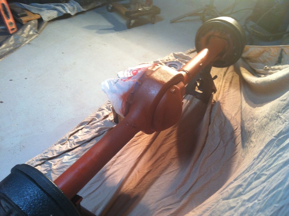

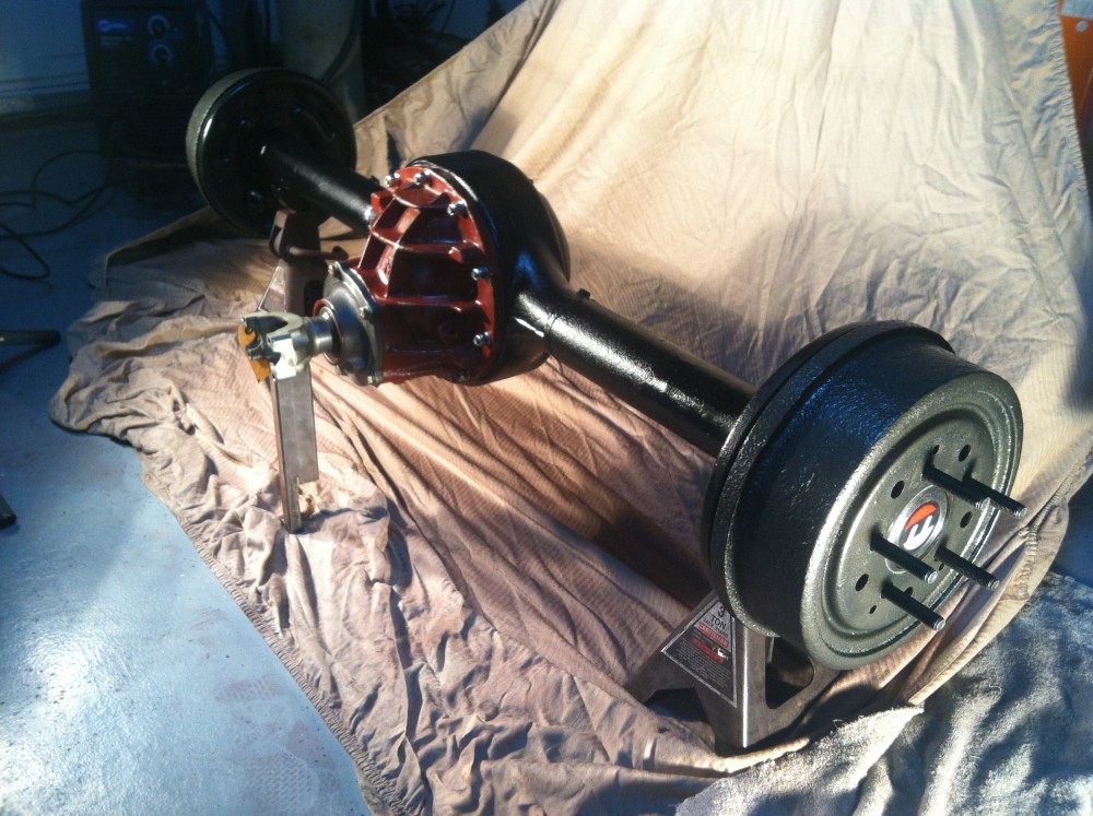

    Got the rear end back shortened, pinion center moved inline with the transmission and new Moser 31 spline axles. Finally after fabricating 3 different seat brackets for the A100 seats, I found one i like and works with the stock bucket seat brackets.
    I was trying to overbuild and overdesign, when I thought back to what they would have done in 60's, make it light weight and simple ( i added safe to the equation.) I build a steel plate outof 10ga and it works great, I will post pictures in the next couple days. Started also fitting the main hoop now i got some seats to go off of for reference!

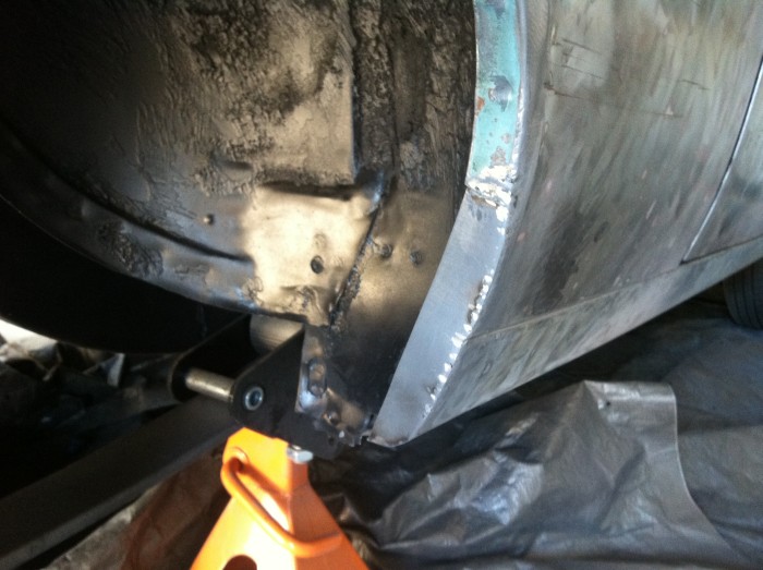

    Rear end installed, Seats installed on factory tracks with some fabricated metal plates, rear wheel well opened up slightly to follow the body line and fit the rear tires...PROGRESS....

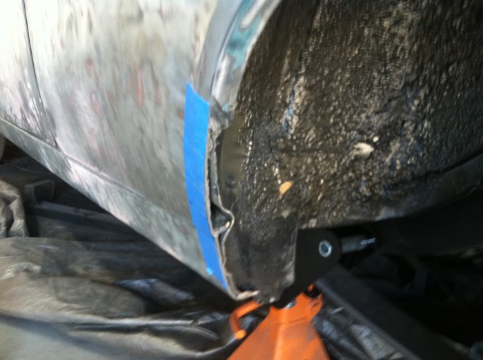

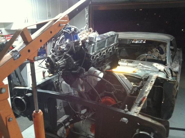

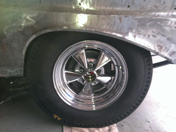

    So I finished the rear wheel lip with some pieces of 18ga I had. I still need to do a little shaping. I think i only moved it forward maybe an inch, but it looks good. I also took out the old engine/ trans. I wish I had another car that needed an engine, because this thing runs nice. This week the car is going to the roll cage guy to the the chris alstons kit installed. Also I ordered some SPI epoxy primer and 2k surfacer primer which should be here by friday... maybe get some primer on it soon!
    I received my McLeod bellhousing and Dougs headers in the last couple days too. I did have a Lakewood bell, but got a great deal on the McLeod and I like the iradited (sp?) color better and sent the Lakewood back. Depending on who you talk to the McLeod is supposed to fit better too.

    Mike;the wheel well lip is similar to what I did with my wagon.Now that the engine is out get rid of the weldin supports and get a bolt in style,you WILL be happy you did!!!!Give me a shout if you need help loading the car. ROY.

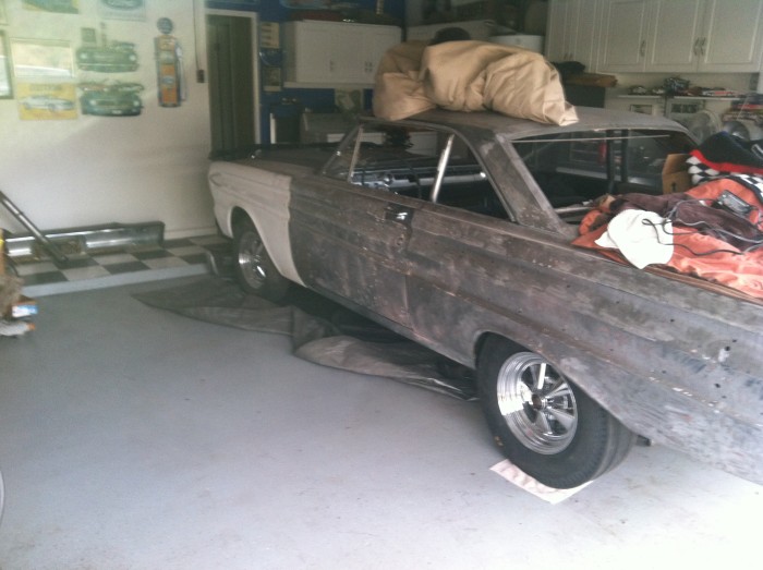

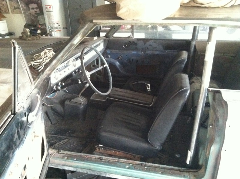

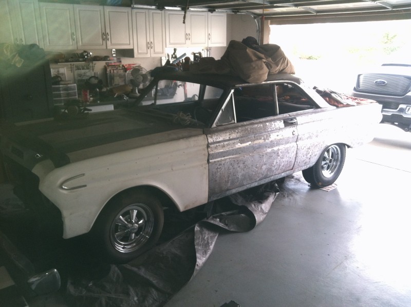

    6 Point cage installed. I still have to have the shop make some seat braces that attach to the rear of the seat/ cross bar. I had them install seat belt loops and a headrest pad. The swing outs were installed and fit perfectly. The back bars follow the roof line so well you can't even see them when looking at the car from the side. The main hoop is almost disguised with the side window and front window trim pieces when they are rolled up. I am really happy with the job the shop did.

    Mike;stock type factory seats do not have to be supported by the cage,my Sunbird seats were never an issue! Not saying you can't,your call,just not required.Jim's guy does great work,you setup looks great!! ROY.

    Yea I know the seat brace is not necesarry, but I think it would help alot upon acceleration. The four little bolts through flimsy sheet metal dont make me feel super secure, but with the addition of a back brace, I should be good.
