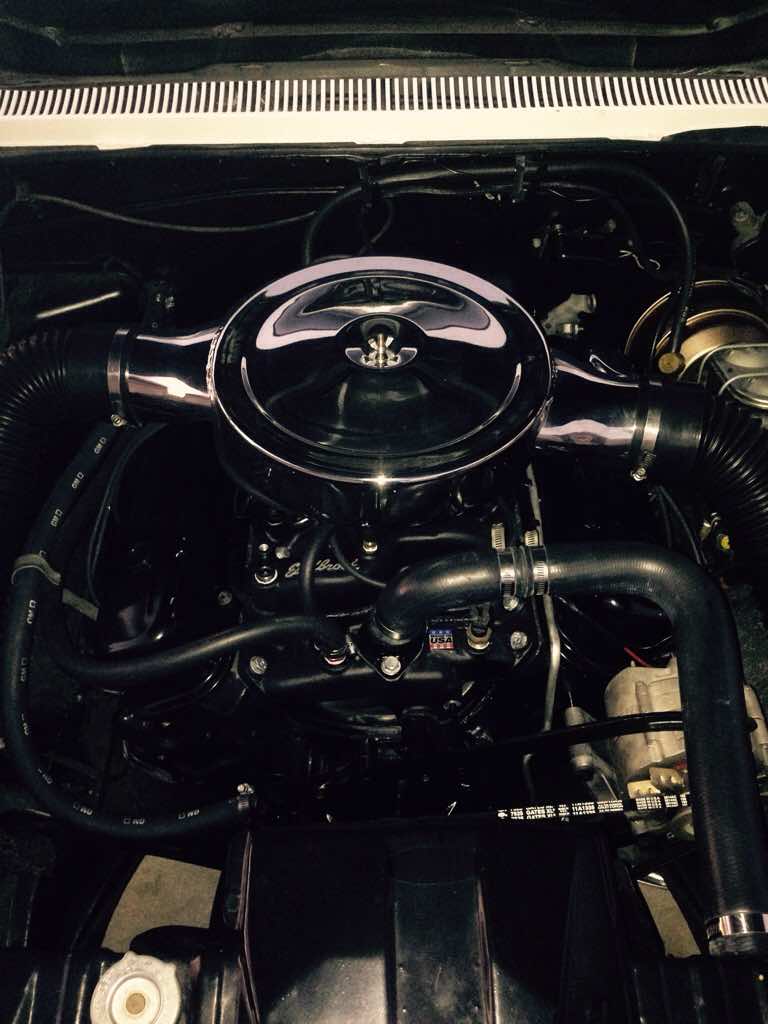

    ImageUploadedByH.A.M.B.1416963841.048304.jpg ImageUploadedByH.A.M.B.1416963859.546615.jpg
    Good news is she is home and very happy with the 455. I'm not blown away yet cause I can't really get on her. I was really happy with the 389. It was a beast so I hope I'm impressed after I do the first oil change and can actually get on it. Anyone have a rev limit suggestion?
    Please don't burn me at the stake for painting everything black

    52-5500 max for a short burst , unless it was balanced then its about 6K . 455's are not a high rev motor . a 55 has a lot of m*** in the lower end ( the 4 bolts of the H.O. Help hold it in place , and the reason why we convert the 400 to a 455 with a crank change as its a lighter ***embly ) . but the thing was built for torque not RPM . try to keep it under 4000 for the first 1000 mi. . its ok do a few sprinted take offs to get the rings to seat . but space them out with 25-30 miles between them helps cool the motor down . try to keep engine braking/ down hill coasting to a minimum so it will keep the ring grooves clean as they will **** oil till they are seated and that promotes coking .
    nothing wrong with Black , my street motors were this color to confuse guys what was under the hood . and trying to find the Proper metallic blue was a PIA around here .( plus the fact I had several years with the several different blues . ) the motor in my 50 is going to be the green they used back then .
    64grand likes this.
