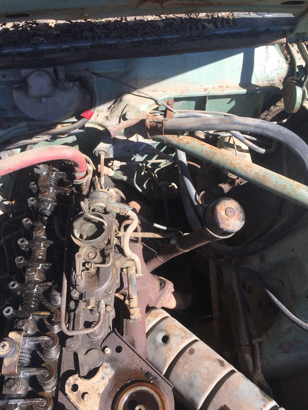

    Here’s my first project I purchased not so recently. I discovered this forum and gained a little confidence to start back at it. I’ve been extremely intimidated by this project as it is my first and my experience as a mechanic has been limited to a 1981 c-10 and my now 1995 GMC Sierra.
    As well this 64 doesn’t seem to have been dis***embled ever other than what I’ve removed and carefully labeled and do***ented. I’ve purchased the Technical service manual. And a collision parts catalog. The catalog practically of no use.
    Engine is seized up, so first order of business is seeing if I can get her loose. Got it soaking today, now prob on 80/20 mix of acetone and used trans fluid.
    1st thing I’d like to get input on is and anything anyone might like to add feel free. Is there any other methods besides cranking on the harmonic balancer bolt?
    I’ve tried this on the 81 I mentioned and was able to get the bolt to split coil around the threads. Lucky I caught it before I broke it.
    Could I fabricate a piece of angle iron “drill two holes in it” to accommodate the two bolts around the cir***ference of the harmonic, bolt to that and use that instead of the center bolt for leverage? Plus It would give me the ability to turn it clockwise or counter clockwise. Maybe if need be even use a floor jack on it; which I know would prob be way excessive force than what would be healthy, but its a thought.

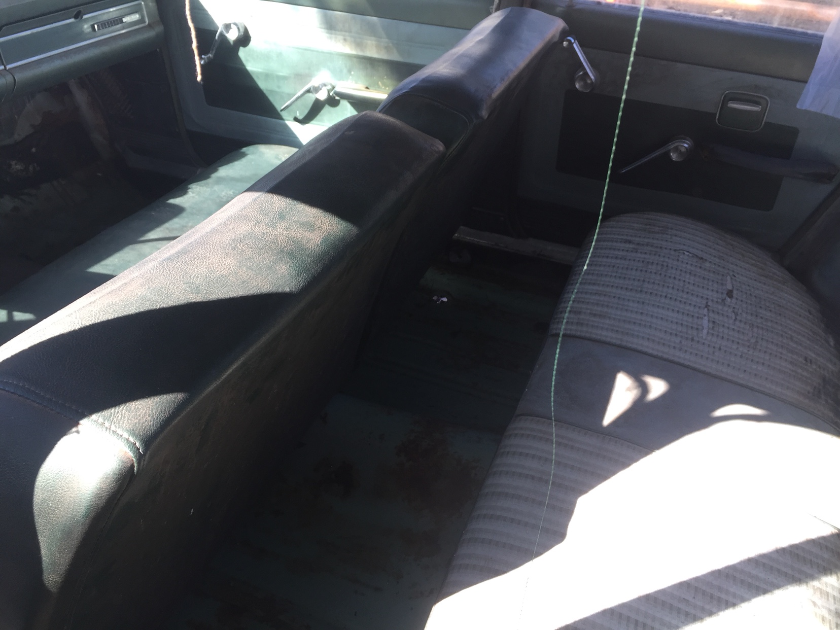

    But hey here’s some pics, only thing I seem to be missing is my air filter housing, rear gl*** and taillights covers. I have all the trim and Crome down to the hubcaps and spare tire.

    Go to an auto parts store and ask for a flywheel turning tool. They are not that expensive and work if you have a straight shot at the flywheel from under the car. If the bellhousing goes directly under the flywheel, it won't work.

    ATF acetone or lacquer thinner mix is good, let it sit in the cylinders with plugs in to stop evaporation over a few days.
    Skip using the front damper to turn it. That could certainly work if it is barely stuck, as sometimes they can be. But, I'd pull the starter out and use a bar on the teeth, just a tweak in each direction, don't force the **** out of it, just try to gain a little in each direction...but, I always make sure the valves are not stuck first. Grab each rocker with big channel lock plies or whatever, to see if you can move each valve.

    Yea I noticed, should probably put the spark plugs back in. Prematurely thought it was penetrating then realized it was probably evaporating. Initially Filled them up all the way till it overflowed figured I could monitor them better. Guess not. Plugs going back in tomorrow!

    You may want to pull the drain plug from the oil pan and see where al of your mix went, probably about full. Then put the drain plug back in and re-fill them and see where it goes.

    That's a Rambler 196 in there. 1st gen ohv derived from a flathead block. The heads are very prone to cracking if the head bolt torque is not maintained on a regular basis.

    The old 196 is tough... but as stated, it needs the head bolts re-torqued every 10K miles, or every third year if not driven much. Has a lot to do with the fact that it was converted from a flat-head (bottom end and timing gears/chain is the same as the flat-head, but the right side of the block casting was changed a good bit above the side covers). The rather m***ive head with the intake bottom cast in is another reason. The head contracts and expands as much as 0.020", and the sealing areas are a bit narrow. Combined that makes the bolts loosen over time and the gasket then blows. The factory manual says to check every 8K miles, but I ran one for 14 years and just retorqued every spring. I averaged about 12K miles a year on it.
    Look for rust on the p***enger side cowl just above the heater. That's a common place for them to rust out. Also along the side where the side meets the floor on BOTH sides. Not to hard to fix as that's not a really stressed area. Looks like you might have some rust on the p***enger floor, which probably comes from the heater. There is a lipped hole in the cowl floor above the heater for air intake, a lot like an early Mustang (which has the same issue). You can buy a patch panel for the heater from www.amcrambler.com, or make your own. I've done both, and have a write-up on fitting thae patch panel on the AMC Forum in the body section. Also have a photo of my fabbed patch panel in that thread.
