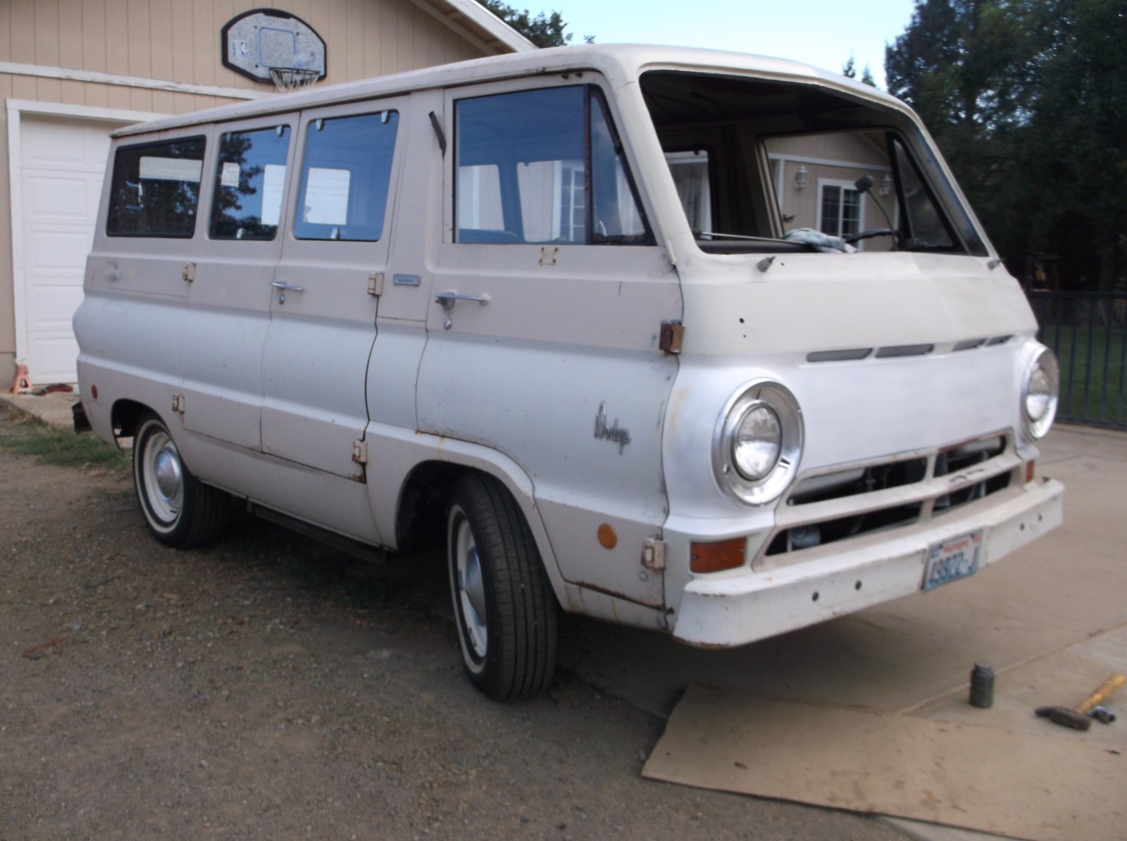

    i wouda never figured it out . much/mucho thnx DSCF6172.JPG now i wonder if the alt.s any good

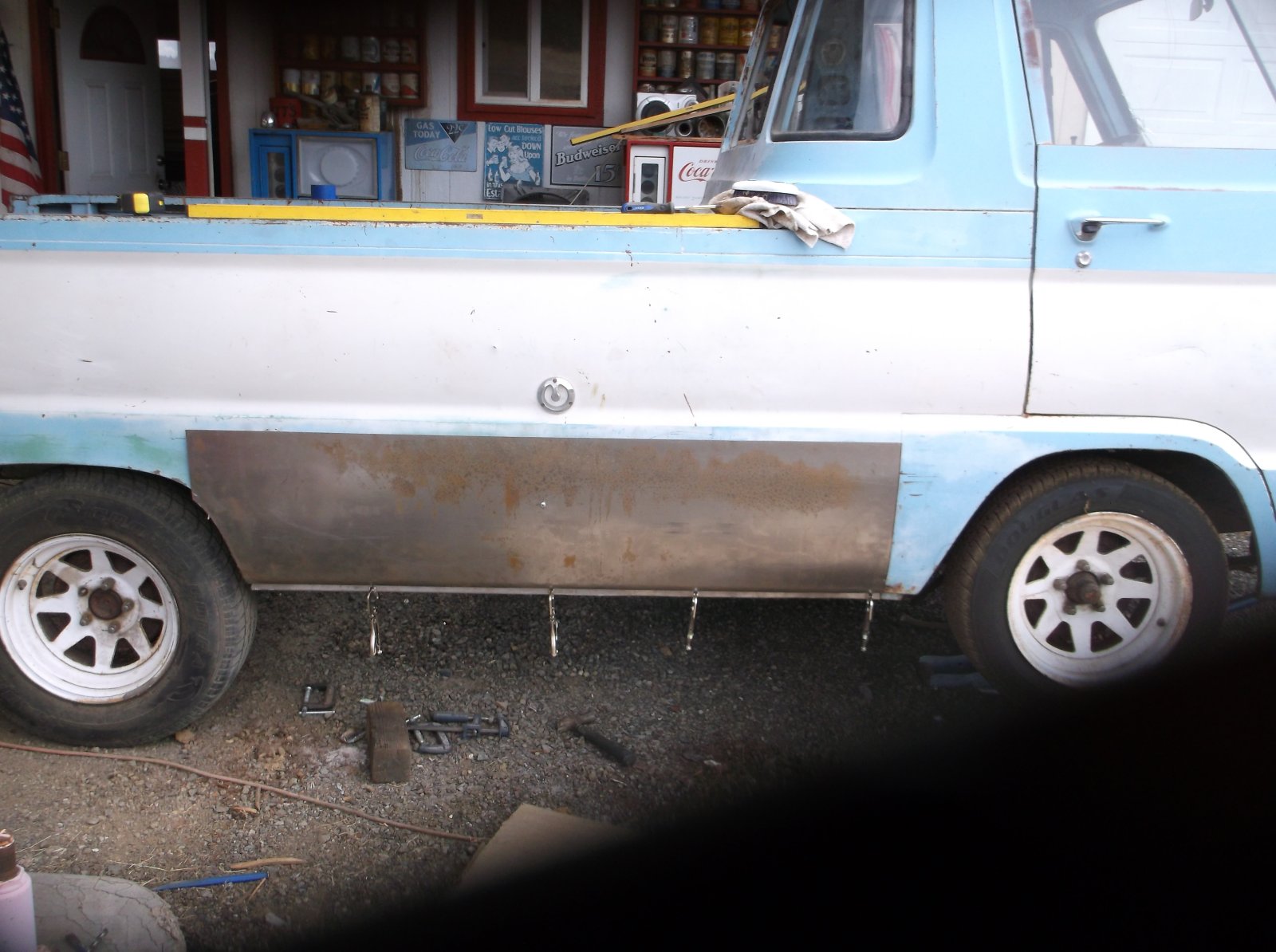

    ought originally .so replacing a 5 ft. section . but . been sidelined this wk.. couldnt say no . needed a parts car . but it run DSCF6231.JPG DSCF6228.JPG DSCF6232.JPG DSCF6233.JPG s so good im not sure i can part it .s6 3 spd. as weell . but more rust than id like to deal with . we ll see . hows things down your way ?
