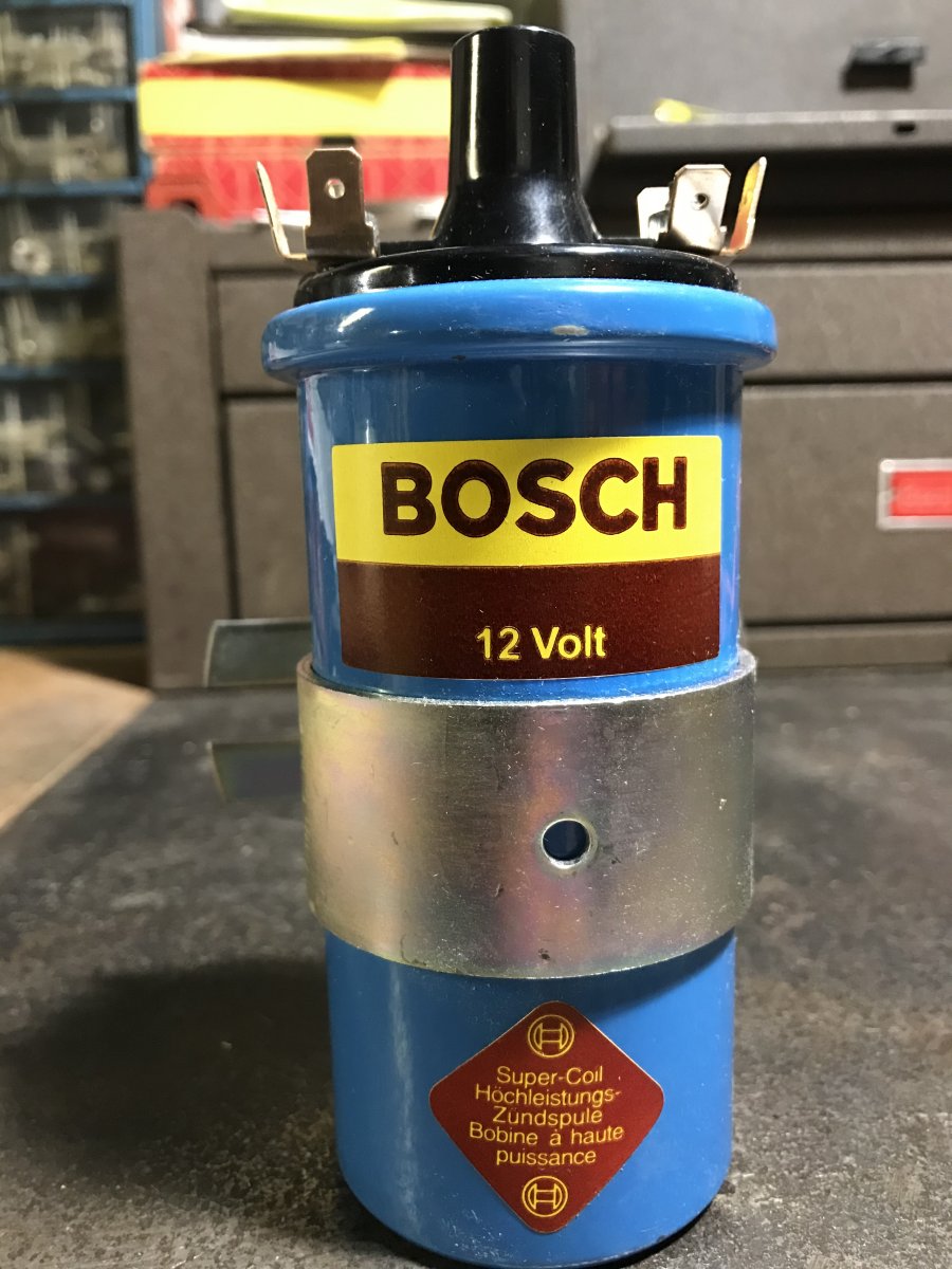

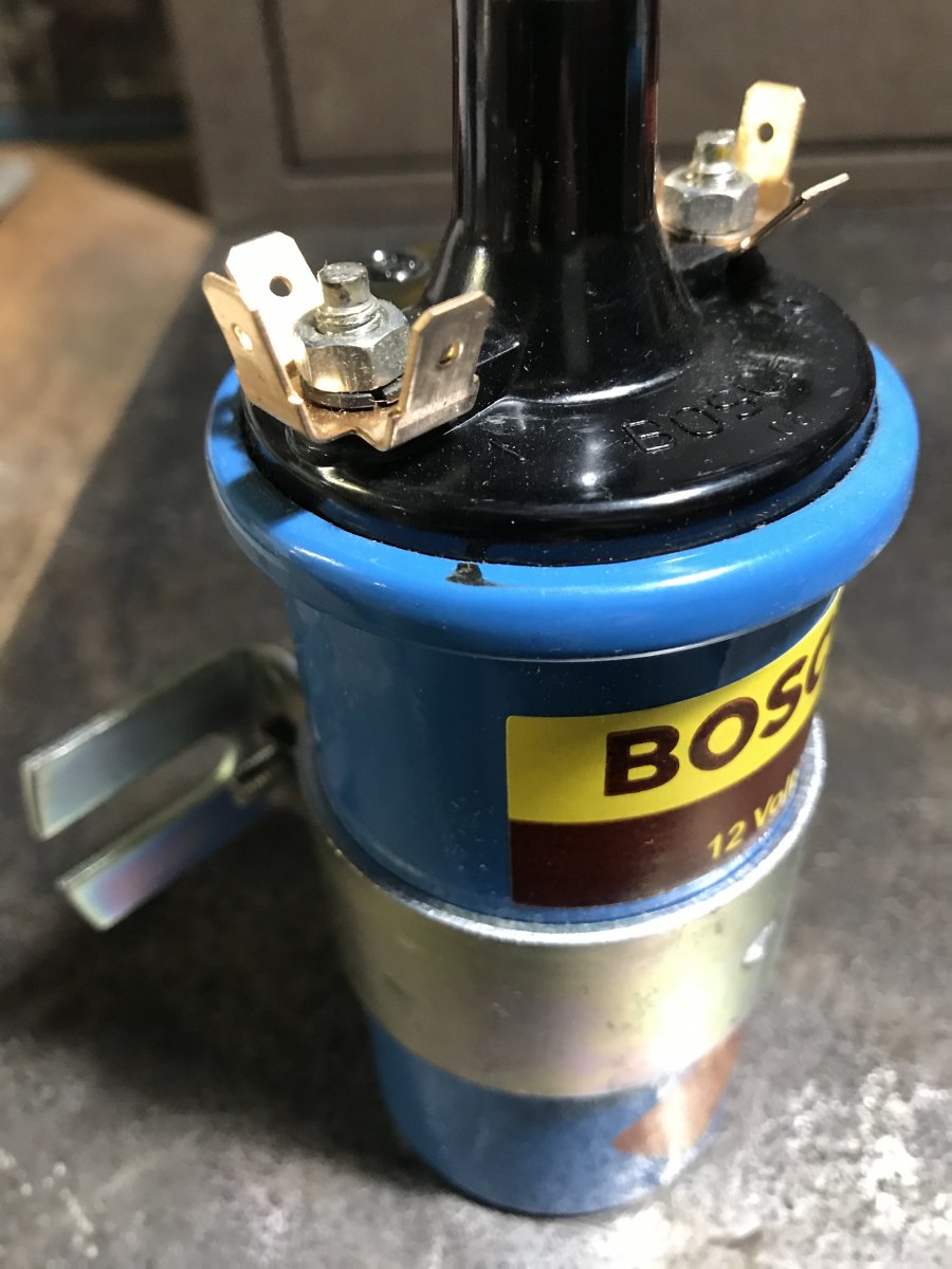

    Bosch 00012 coil made in Brazil...

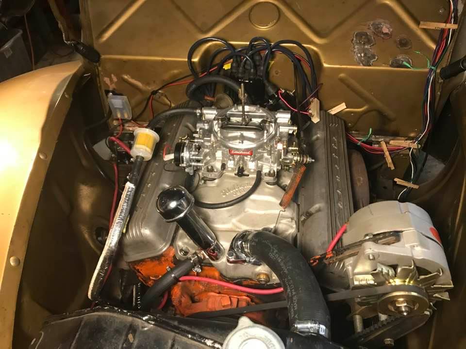

    I was lead to believe this is a GMC factory 30/30 cam - Vac*** is 16 inches at 1,100 rpm at idle. This 327 lacks strong low end - but really comes alive at 3,000 + but the idle at 1,100 is not very choppy - but you hear the chatter of the solid cam. This car sat in the garage for 45 years - never tagged and driven on the highway - had rings - bearings and cam build in 1970 - sourced out of a neighbor's 1965 Chevelle with low miles. This car was totalled in an accident.

    Glad the pics helped - thanks for the info - I really might try an improved coil - either the Bosch 00012 listed above or a MSD - prefer the back one to match period look. I am usually a Ford engine guy and run Duraspark dist and MSD box - works great until the box quits - which is rare. And keep the points. Looking for better - quicker starting and idle in the 327. But current is OK. My next improvement project is the starter. It is factory original - but I am using a single pole Ford starter solenoid to energize it. When I have run the '39 about 30 mins and got it really warmed up - it can be hard to crank back up - until it cools down some. Might try an insolutated blanket cover first - then go to gear-reduction Powermaster starter. I am not sure of flywheel tooth count - but looks like the hipo replacements will work with both flywheels.

    next time i run the '39 - I will lower down the idle and test it. Cam does not have strong low end - the little higher idle helps at stop signs and traffic light that are up hill.

    I've had coil issues with my 327. I see the Bosch Blue list w/3.3 ohms or 3.4 ohms. Does this matter? I have small-body HEI by Dave --> https://www.davessmallbodyheis.com/
    I'm looking for a reliable coil. Are all of the Bosch Blue coils the same?
    Thanks
  22. Fordors
    Joined: Sep 22, 2016
    Posts: 6,490
    Fordors
    Google Bosch 00012 ignition coil and click on “images”, three different Bosch coils will show. The blue, a black and one with a plain metal finish so if they all have the 3 ohm rating like the blue coil they are interchangeable.
    But, you run an HEI and if I’m not mistaken that uses a 1 ohm coil. I’m not much on electricals but no doubt Dave can give you the correct information.

    I reset the idle to 900 rpm. The 12-14 vacuum was spot on. I put a MSD Blaster 2 coil on - seemed to help vs stock coil, and I backed off the timing just a little. Need to buy a good timing light . Mine quit about 10 years ago. Will watch ebay for dwell meter and timing light.
