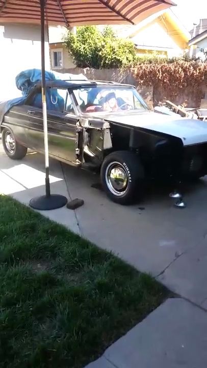

    It has been a really big day. My son was home from the Army for a couple of days over the 4<SUP>th</SUP> and we had a really good time and today he had his first parachute jump from a C130 he said it was a RUSH and loved it. For me it was that he was successful and was ok WOW. Also for the Comet it was the day she took her first steps. When the engine started back in January it was her new birth and now she took her first steps with my daughter driving. This called for a video (link below). This means the wiring works, the engine works, the transmission works, the driver shaft works, differential works, the brakes work and the 68 mustang shifter to PERL Works linkage works. What a great day. I also got some bling done on the door cards and they are finished (picture below). Now on to the gas tank, body work-paint, convertible top, tires, interior, &#8230; . Just a few more things to do not to mention the money involved.

    Congratulations! That is a major milestone for sure! And thanks to your son for his service to our country........My old man use to fly C-130s.

    Jeff;that is great!! Doors turned out awesome!!!Glad you got to spend time with your son!Where is he stationed? ROY.

    Must have been a great feeling to have your son at home on the 4th. Pride for our military is at an all time high. Must be a great feeling seeing your son grown-up & in uniform.
    Having your daughter working with you on the Comet is another really cool thing. Will always be a "lasting memory" for both of you. :)

    John: I am proud of my son and daughter and work they are doing. As for the video you should be able to click on the first picture and have it fire off.

    Lots of nice pics of your build...... and the "1st drive" video is a "keeper" to show your grand kids someday. :D
