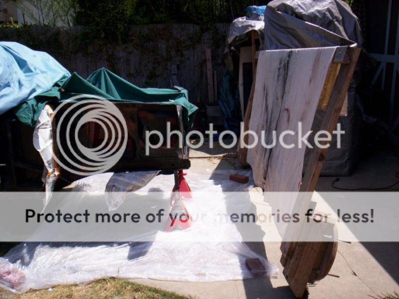

    6/17/2012 - I got a lot done but not much to show for it if that makes sense. I welded up all the 60 to 70 holes in the engine bay and ground them flat. I primed, seam sealed and undercoated the front wheel wells. I undercoated the rear p***enger side wheel well and the inside of the font fenders. Sunday was a momentous day it was father’s day and I bolted the first parts ON the car as opposed to cutting things off and dis***embling.
    Picture 1: my fancy paint booth.
    Picture 2: Fenders undercoated.

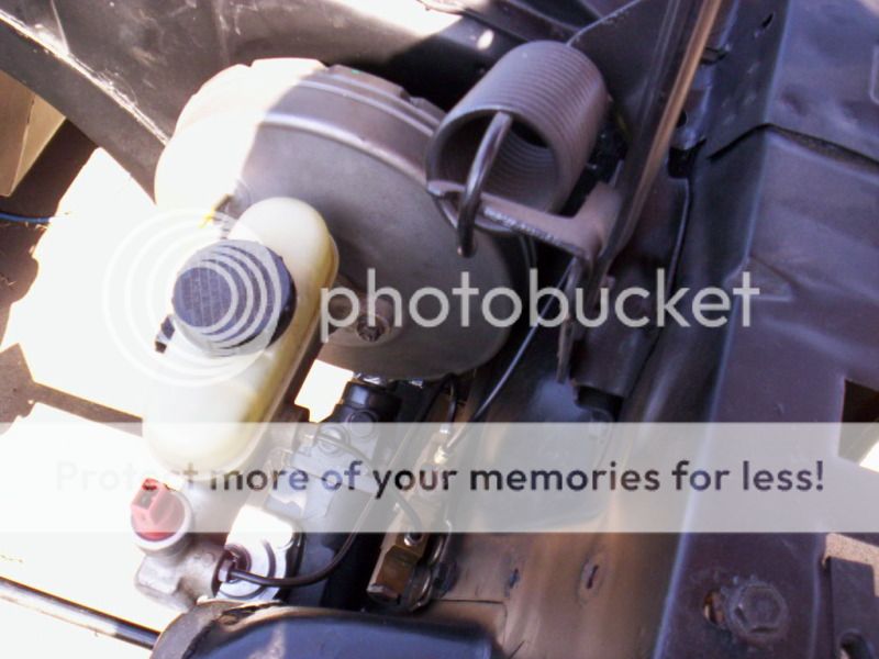

    Picture 3: The beginning of the Granada disk brake conversion. YES these are parts that are being put ON the car. This includes the Shelby drop and the coil cut out of the spring.

    Jeff;I bet that is a good feeling[put parts on for good],be sure and put the outer spring bucket back on,it is part of the support structure! ROY.

    Thanks for the heads up about the spring buckets. They are still in the garage waiting for restoration. I like to keep some projects for my daughter to do since she’s not into welding and cutting steel so she gets the wire brush and paint projects like the spring buckets.

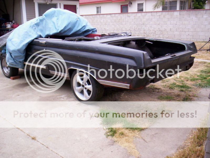

    7/4/2012 - I spent some time in Colorado for a softball tournament and we had a great time. I did get some work done on the 4th . I removed the 8 inch and installed the 8.8 pictures 1,2,3 and 4. Then I started to figure out what look my daughter wanted for the car. Picture 5 is the look she thought she wanted but wants to go more traditional. The rest of the pictures are some different looks. We need to make these decisions now otherwise down the line changes can get expensive

    Jeff;it is your and your daughter's Comet,but I am NOT a fan of big,modern wheels and tires on old cars,but it is your car,do what makes you happy! ROY.

    Like Roy says, it's your car. You're doing a GREAT job! However, I'm not a fan of that rear rim on this car.

    On the other hand, it might grow on me. :D

    Roy & JunkYardFrog: Thanks for your input on the wheels. My daughter agrees with you so I guess I am out voted. She originally said she wanted the rims you see in the fifth picture which are 2005 Mustang but after seeing them on the car she said there was no way those rims were going on her car. She wanted something more period correct. She has decided on the 14 inch steel chrome slots that you see in the sixth picture. Two came with the car and I have found 2 others that I should be able to get in October. The problem with this is the differential needs to be narrowed which is not the case if we use the Mustang rims. My brother and I are going to narrow the diff over Thanksgiving. You might say why not use the 8 inch that came with the car. The problem with the 8 inch is the condition, the gear ratio and the drum brakes so we are sticking with the 8.8. I don&#8217;t always take the easy way out just the least expensive. Thanks for the input.

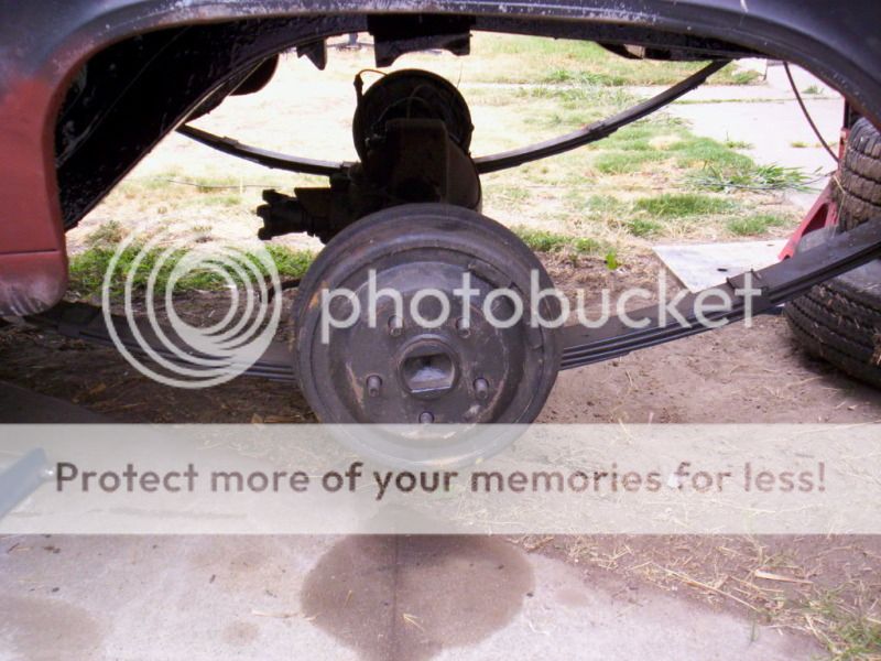

    Jeff
    You can narrow the 8.8 by using two of the short side axles and only cut one of the axle tubes. If I remember correctly there is about 3" difference in the length of the axles side to side.

    ffr1222k: Thanks for the info. That&#8217;s what my brother and I are going to do at Thanksgiving. Below is a link to the process in case anyone is interested
