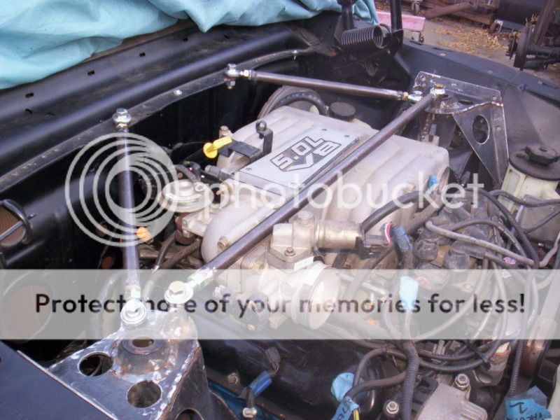

    It looks great. I love the car tilting idea. Great work!!! The engine looks great in there and I love the rod end style shock tower brace.<?xml:namespace prefix = o ns = "urn:schemas-microsoft-com:eek:ffice:eek:ffice" /><o:p></o:p>

    Thanks we are having a good time with it. As you said I am not trying to kill myself to get it done but I try and do something every day that has to do with the project.
    That is a Mercury Mountaineer (Ford Explorer) 8.8 it&#8217;s a limited slip diff. It&#8217;s the one from the donor Mountaineer we stripped for parts. I started out wanting to use it as is and found I had to move the spring perches. It is a little wider so I got 2005 Mustang rims that fit perfect the trouble with that is my daughter hates the rims even though she is the one who wanted them so now I am going to narrow the rear end by shortening the left side tube and using another right side axel. My brother and I are going to do that during the Thanksgiving break. Below is a link to the process in case you are interested.
