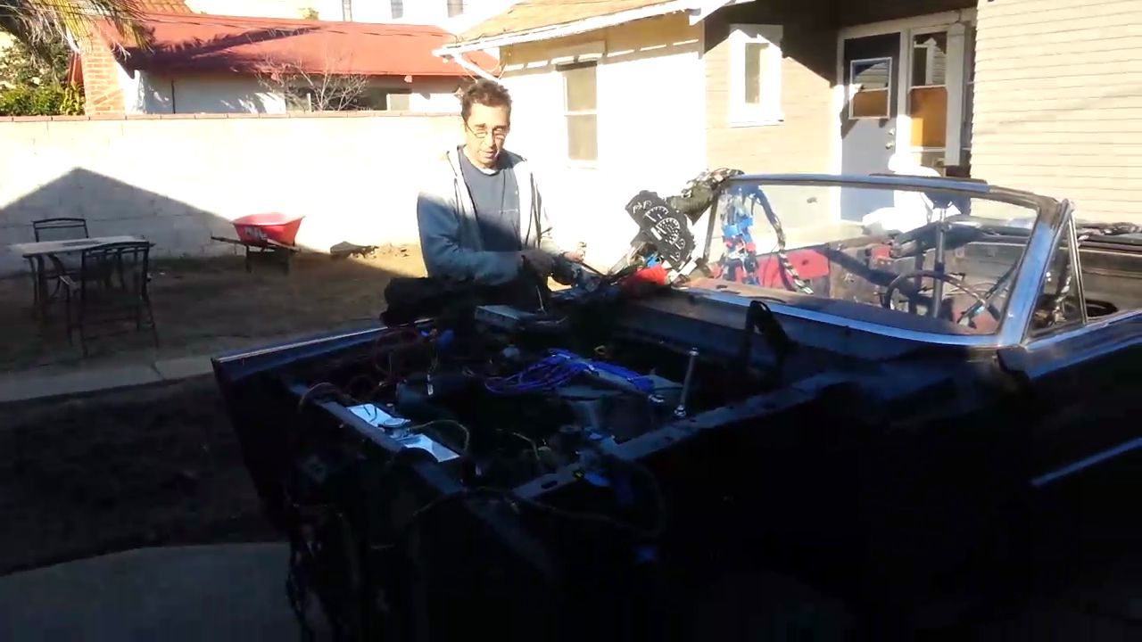

    Well it’s time to try the first start. I had my friend Art from Wirediet.com come over to help me out. He has worked on wiring for lots of different cars and diets stock harnesses for use in Factory Five cars as well as street rods. He first went over the entire harness and looked at how is was hooked up looking at grounds and connectors and reading the Helms wiring book as he explained the steps he was going thru. He then made some changes and adjustments and checked the computer with an ****yzer. We then tried the first start and there was a large arc at the negative battery terminal. So we started looking for the cause like stripped wires that were grounding or wrongly grounded wire and then Art took a look at the negative battery terminal. It was the one that came with the donor Mountaineer and worked fine when I started the Mountaineer 2 years ago. It’s one of those bolted clamp down on the wire kind of terminal. The wire was badly corroded. Once we cut back to fresh wire the car started right up.
    I apologize to Art. I thought I had a video of him starting the car for the first time but I screwed it up and it didn’t record. Below is a picture of Art and me working on the car and a video of me and my son starting the car. Sorry Art. This was my first try at a video and a new phone so lesson learned. Below is a picture of Art and me working on the car and then a video of me and my son starting the car

    Jeff;that was great!!!That 5.0 sounds solid,should be a good running Comet when you are done!! Those battery ends are really just for emergency fixes,not meant for long term use!!! ROY.
