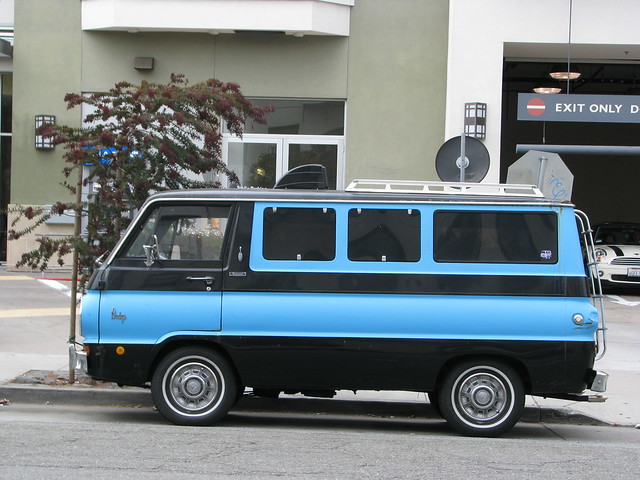

    Lots of ways to go with paint
    https://www.vinvanco.com/paint-job-gallery.html
    But a fresh solid color is great looking .
    I did a solid color then added a large decal graphic.
    It got lots of thumbs ups, a couple trophies and was used in one event's advertising a couple years later.

    Very cool!! If I didn’t have all the windows I’d probably do something different but since it does I’m going stock. Yours looks fantastic!

    With windows, you can highlight the upper inset around the windows (White or Light Blue) or merge (Black with tinted windows). Easier to paint...
    or come up with a nice stripe design Decal is easier
