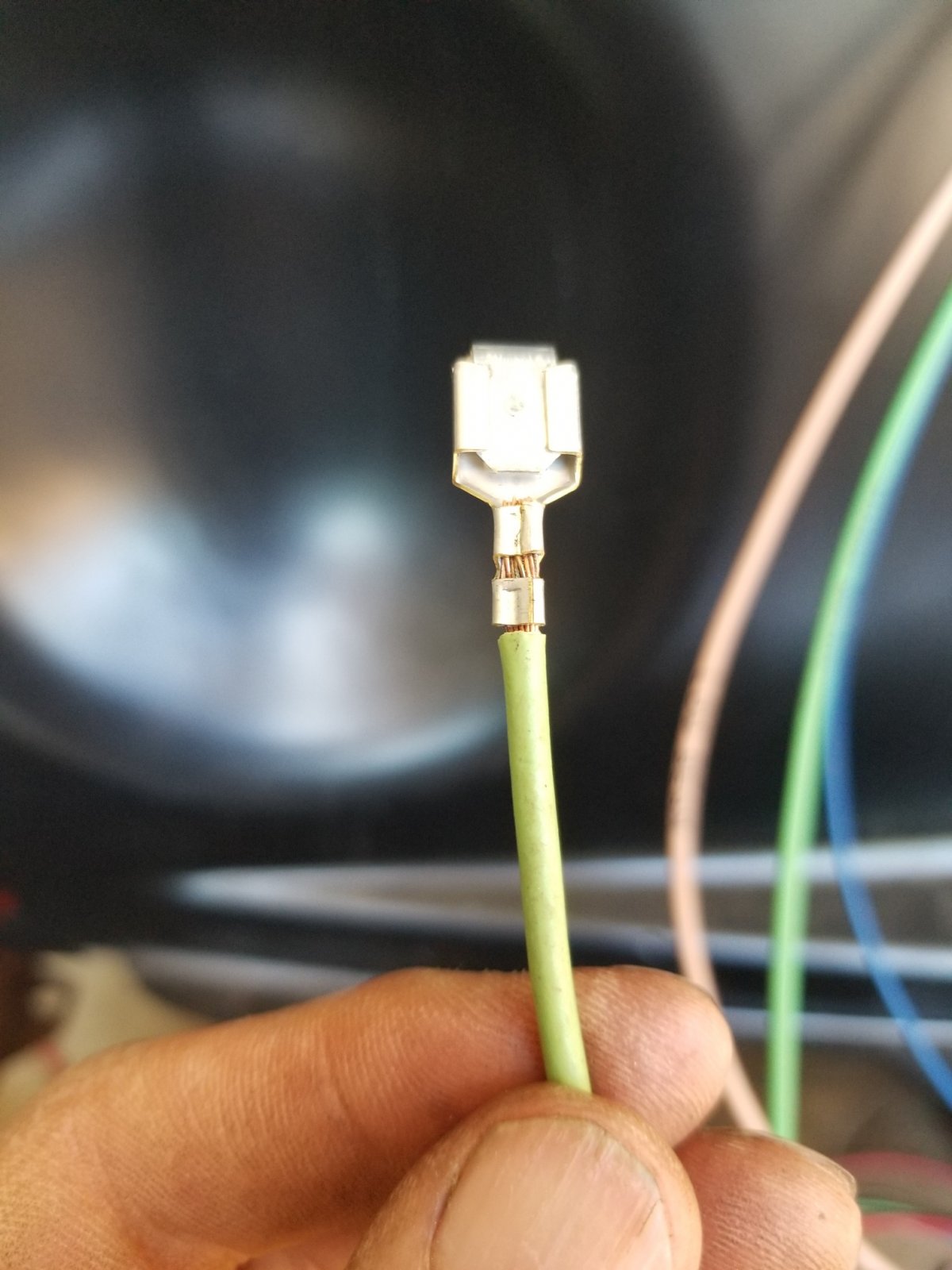

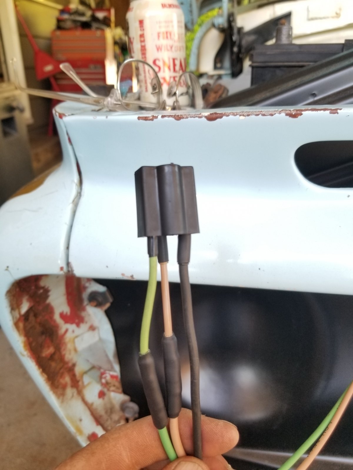

    While what you did with your crimp will work, the second set of wings on a Packard 56 spade are supposed to be crimped on the insulation, not the wire.
  2. Gulp! I can't remember if I caught that on the next ones or not - I remember looking it up and thinking something isn't right and if my Middle age brain serves me I think I cut them all off because I found the correct new pigtail. Problem is now I have doubts. All shrink wrapped so can't look at them. Will pop one off this winter to see if I corrected or not - and if not, I'll correct. Good catch, the only spot I used those connectors was for the headlight pigtails, everything else were **** style connectors. I cut all the stock insulators off and stretch wrapped everything because they looked hokey to me out of the package, also not weather proof.

    jaracer
    It isn't anything to worry about. Since you shrink wrapped it the shrink wrap will provide strain relief on the terminal.

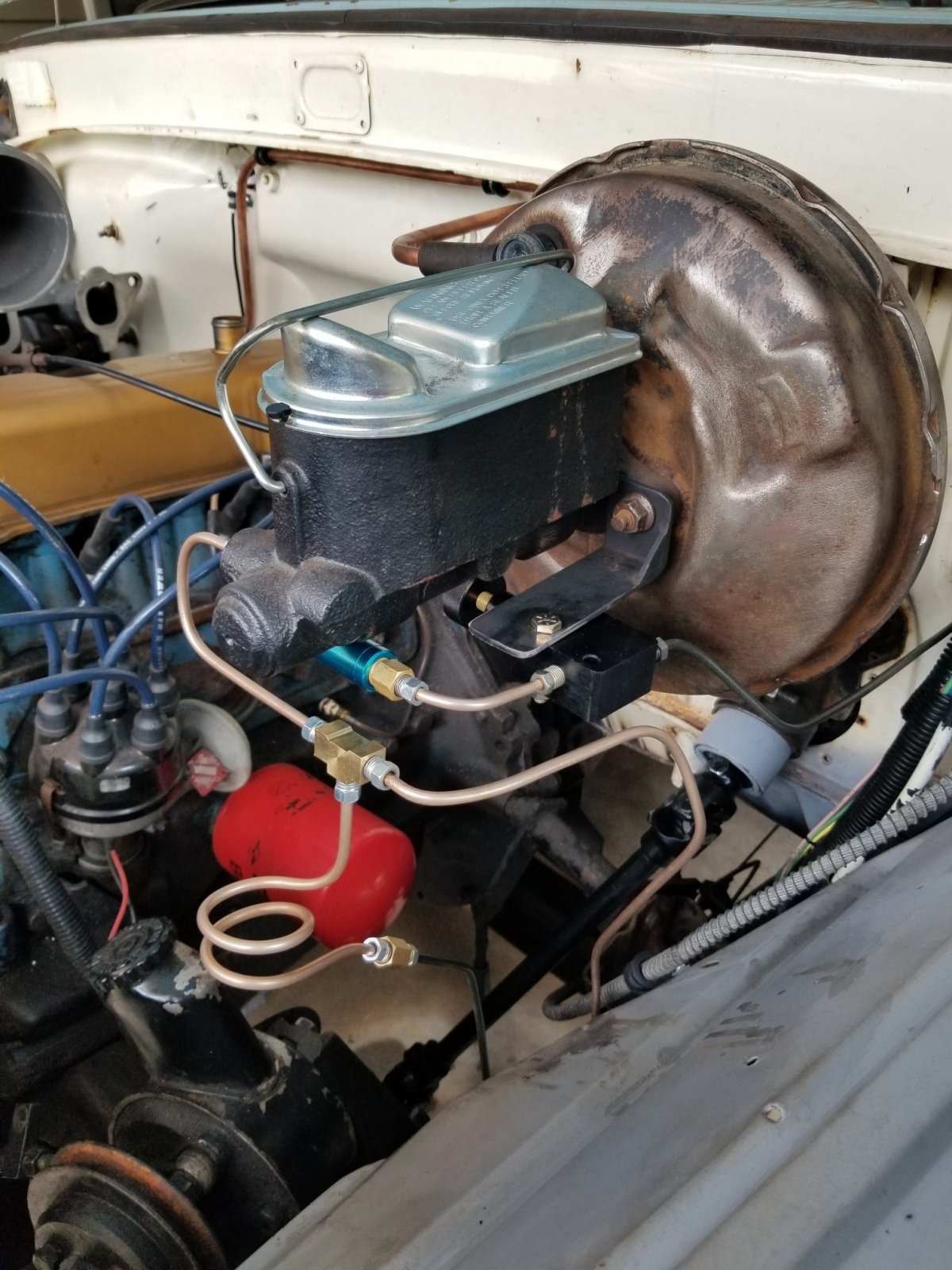

  6. New parts today, the day of the show. Proportioning valve, residual valve and a T for the front brakes. Getting rid of our distribution block. We zipped around and saw everything we wanted to see then back home in time to start installing. Shooting for Monday morning drive to work. Saw only 4 Slick's at what I would guess was a show of about 7-800 cars. Found myself admiring paint and anything in the '28-34's. My tastes are certainly changing as I age. Also spent time looking at customs. Could easily have been happy in a few we saw today - alright back to my ****per.

  8. Tried not to blow away all the lines I had fitting to the old distribution block. Because I'm short of tube nuts, I made all I could with the new proportioning valve under the hood by shortening our bracket. Will be calling brake shops tomorrow to see if I can buy what I need. Will possibly get residual and proportioning valves under the truck in the next round. Taking all this apart had me drizzling brake fluid all over the inner fender several times. Glad it's not final paint. Bent up old lines to bleed the master. It was fine.

  12. OMG! Leaking like a sieve at the proportioning valve. The residual valve came with adaptors, the proportioning valve didn't. Same brand, same supplier. I got 3/16" tube 3/8 - 24 long tube nuts and they threaded right in. The lessons are coming hard but, not fast right now.

    Actually the at***ude is partially because of a perpetual nagging leak at the proportioning valve. Ran a tapered 1/8" - 27 NPT tap into it to clean up the threads and thinking I need to now pull the leaking adaptor and put some sealant on the threads then run it back in. Brake pedal has beastly mount of pressure so if this thing doesn't stand on it's nose when I hit the brakes I'll be surprised.
