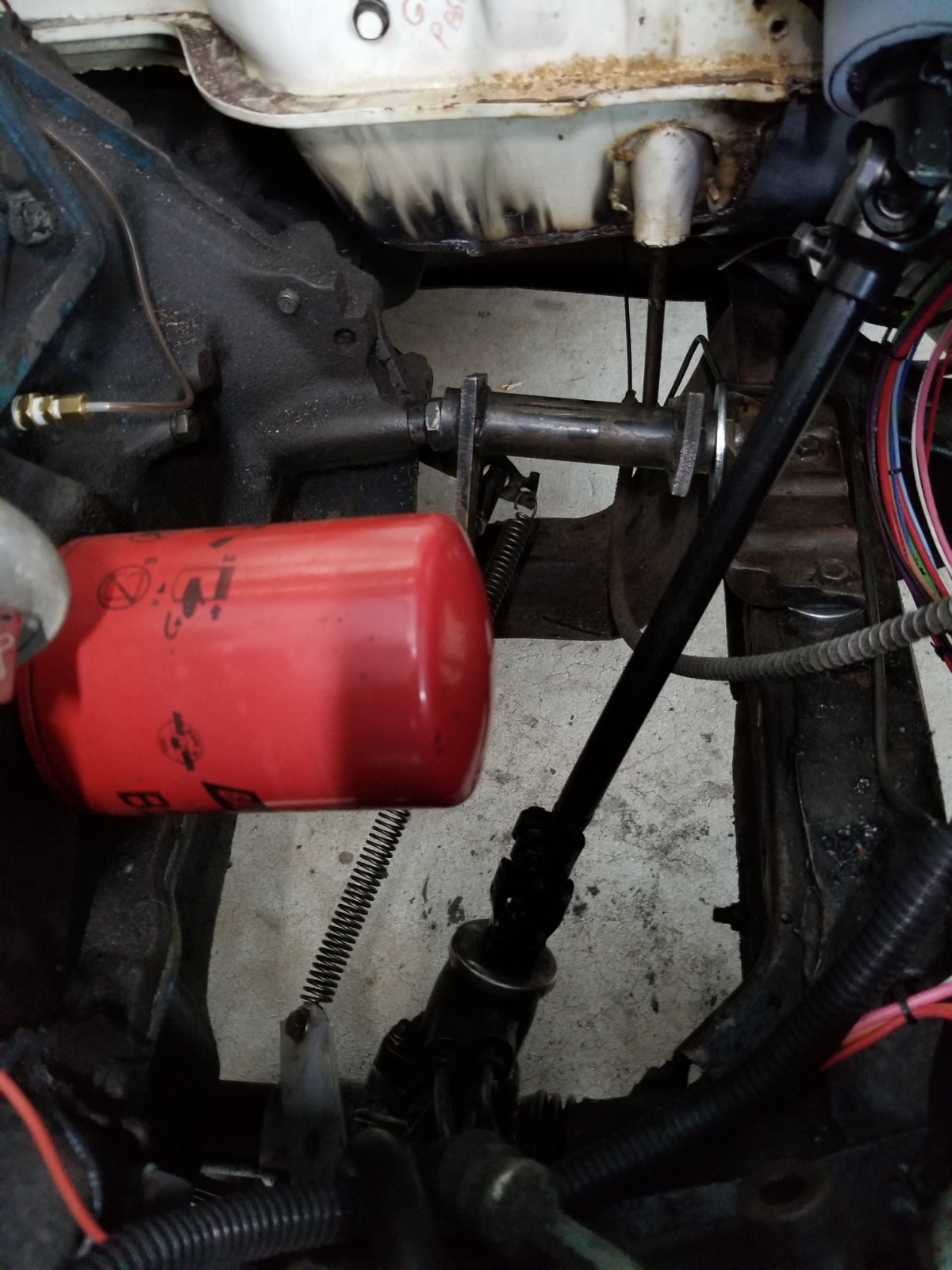

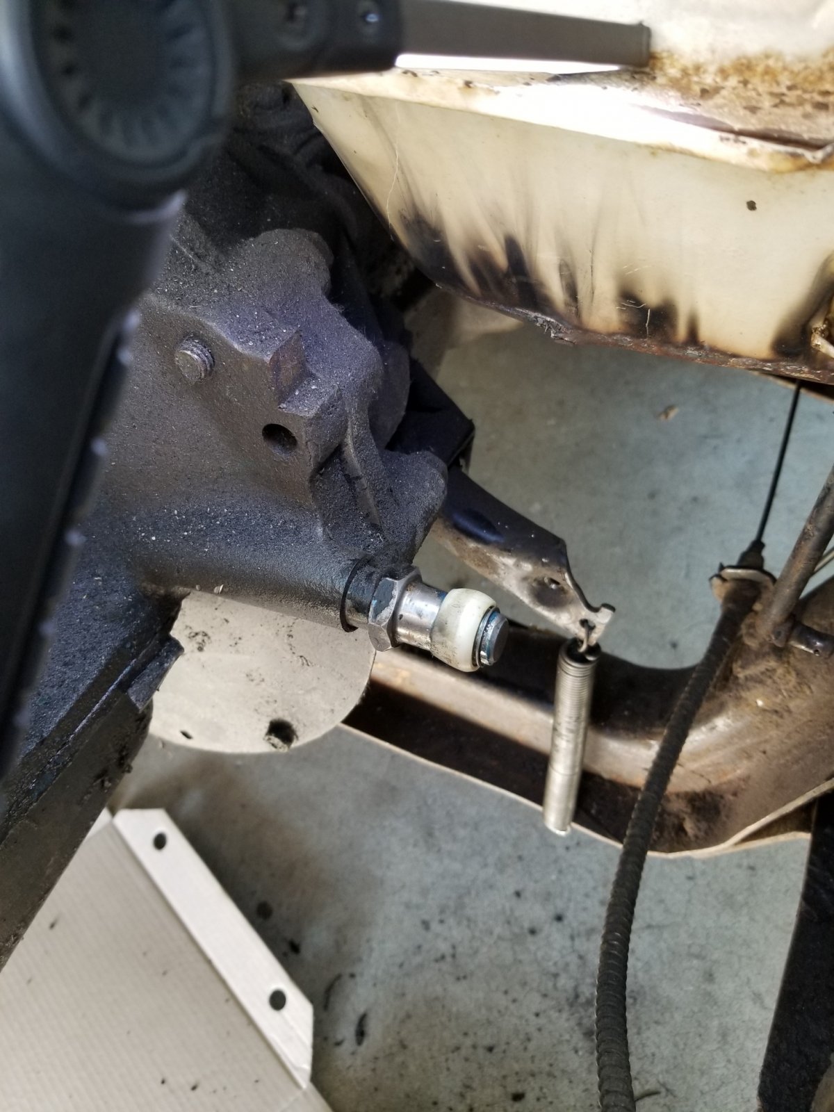

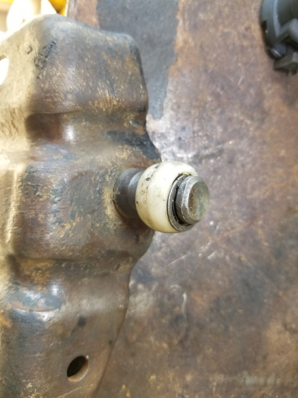

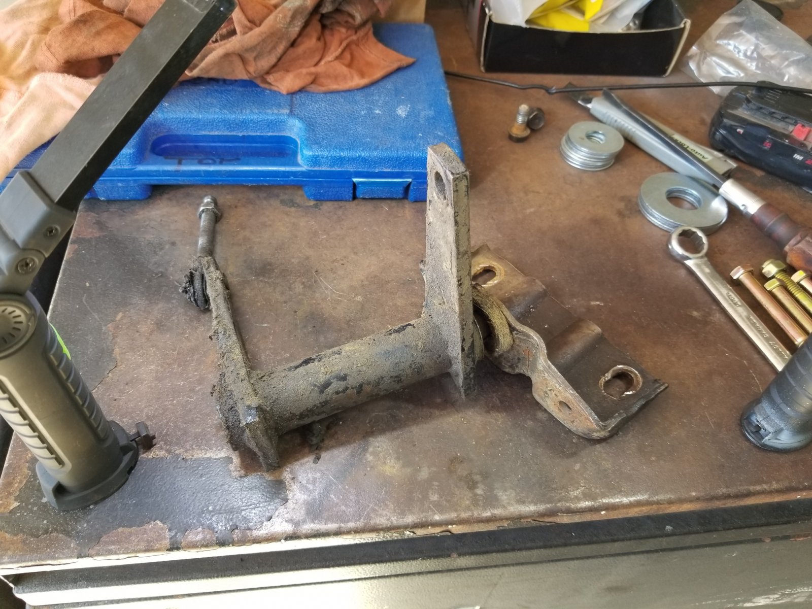

  6. Isn't this a scream. 57 year old bushings and linkages. Couldn't adjust anything because every part was at the end of it's lifespan/adjustment - the pencil crayon has worked a deep divot into the clutch arm. Thinking farm boy here, pull apart, clean, flip bushings around, lube, re***emble with a shim here and there and go. It only has to get to December then I'll rebuild whatever I'm keeping and chuck the rest. Reminds me of McGyver'ing a friends 32' Grady White while out in a 2 foot swell open ocean salmon fishing. We noticed the CD player started running slow. After some mild panic I was trying to remember high school science cl*** electricity. Anyway, I found a popped in-line fuse. Opened it up and saw it was corroded. Poked at the fuse to see it launch itself and it's spring overboard. Where are your spares Man? No spares. Spring from a bic pen along with an alternate fuse from something else we didn't need - Still no go. We got battery issues. Wired the batteries in series or parallel, can't remember, then bolted to the Marina with Led Zepplin playing or Alvin and the chipmunks, I can't remember which. We made it - So will this truck.

    Those rods ends are pretty bad! Maybe even worse than mine were!
    Those same issues are probably infecting the pedal pivots too. It's a pretty simple set-up once you get the pedal cluster out.
    If you decide to do the ball bearing thing on the clutch pedal shaft, let me know. I still have a short section of steel tube that's the perfect size for the bearing retainers I will send to ya.

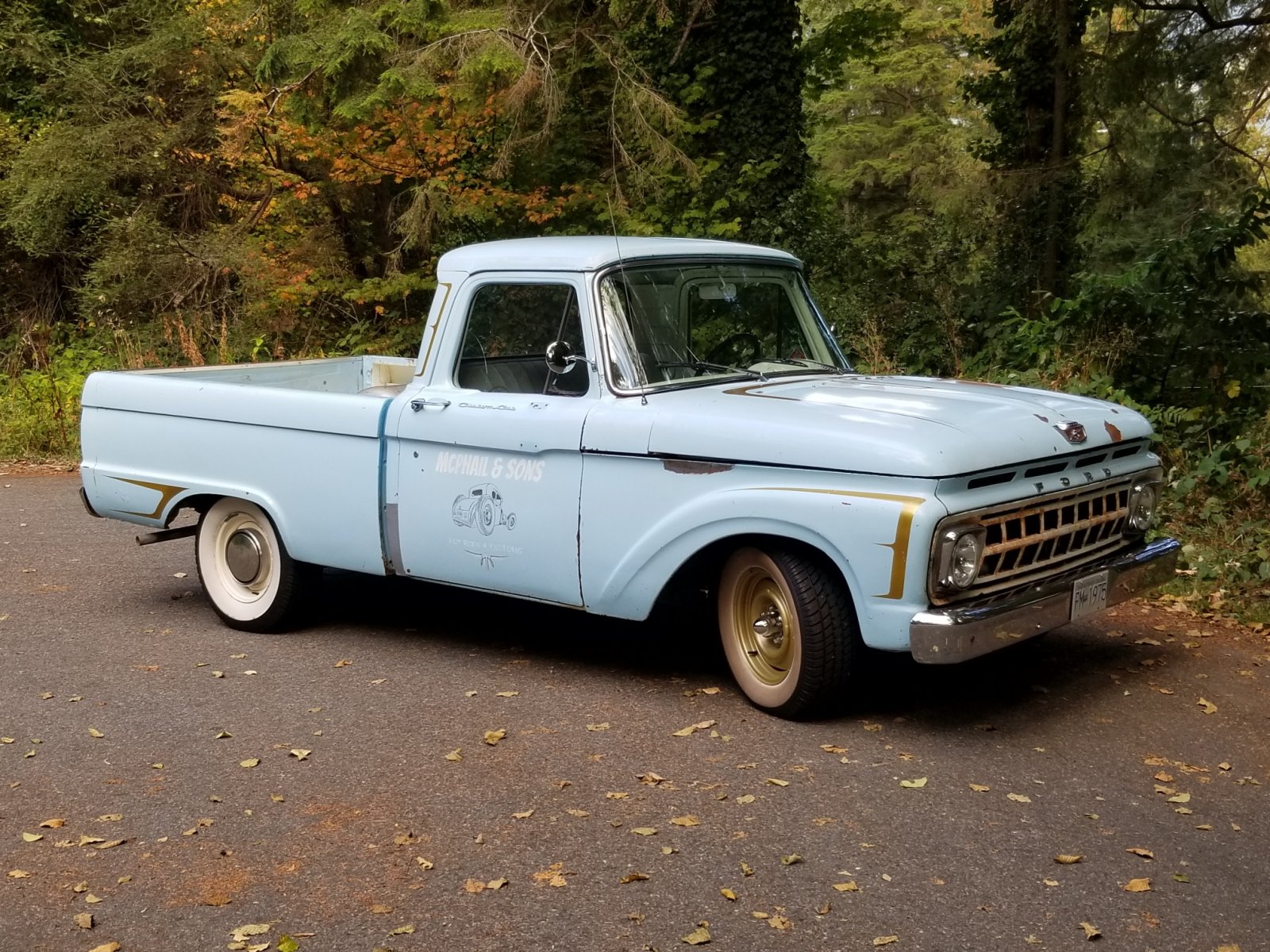

  22. So the report back on the first road test with our truck since all the work was done. @Mike Lawless relayed it best when his wife referred to his truck as the '****y Bouncer'.:oops: Keep in mind I have an OT front end in ours with KYB shocks and all new bushings and it still exhibits this rather harsh, 'heading through the summer fallow in 1st gear', ride quality. Keep in mind a 9 leaf spring pack with short wheel base. I better fill the tank as it needs the weight to smooth it out. The seat plays a significant role in all this in terms of springs/inch ratio. In spite of it's road manners, I couldn't wipe the smile off my face nor could the two separate groups of people I encountered on our test drive who gave me the thumbs up. Forgive the significant beige wall look. That's a new tire - what do I care at this point!! The old tires in the back - Money.

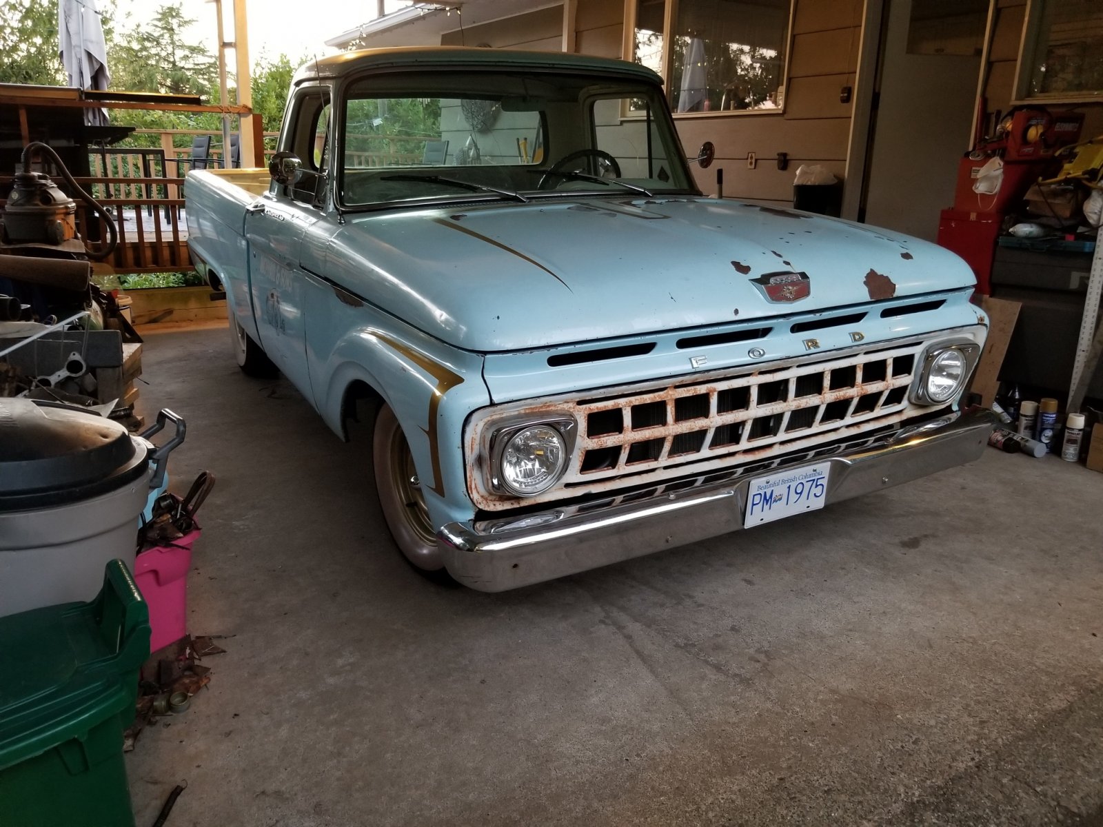

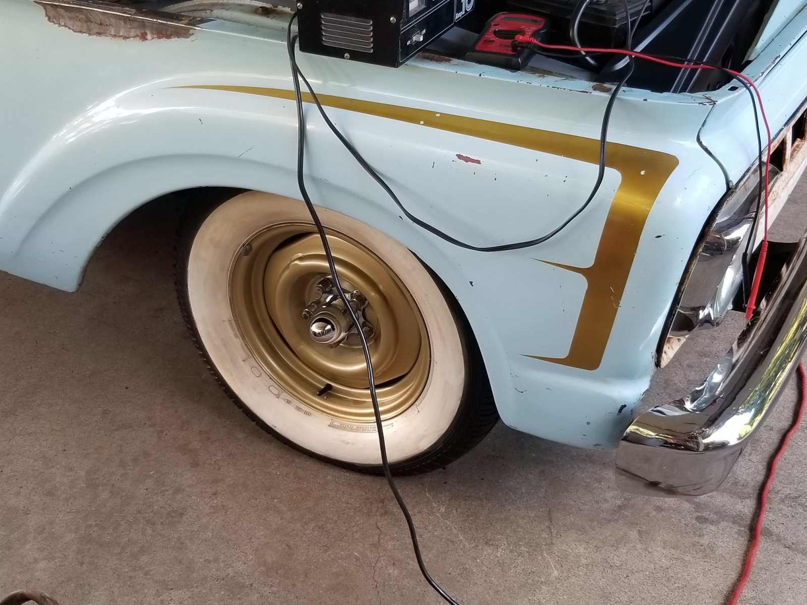

  23. 'What do I care at this point'? Big talker - I do!!:confused: Hit it with some acetone. I knew this new tire business was going to give me some 'Paint issues'. Figure the acetone took off the SEM vinyl dye top coat. The Plastidip underneath was pretty good. Will try the vinyl dye again later. Need some miles to expose those new shoes to the elements.

    :cool: Good for you Will!

    Dang! That tank + fuel weight is crazy! And it still bounces the ****ies? I'm laughing as I type this!
    Aside from that, the gold wheel/white wall combo is awesome. I sure like the bullet spider caps. Since you are kind of the trail blazer on the plasti-dip white wall approach, I think I'll sit on the sidelines for a minute and see how yours fare before pulling the pin on my own!

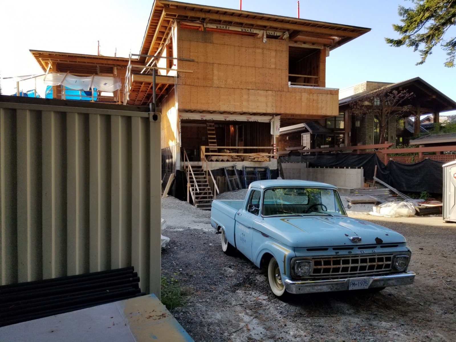

  27. Drove to work today along the ocean front!! I'll calm down eventually. Construction site so guys were asking me about it, Architect liked it, and none of them were car guys.

    What a cool picture of the truck in front of the construction site. Seems so natural, like it belongs there. lol
