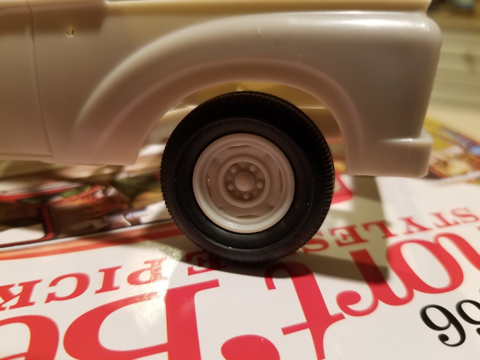

  10. This morning my kids blew out of the house enroute to a hobby store across town. When they blew back in with the wind, they had picked up a model each for themselves then grabbed one for me as a gift along with all the correct paint colours. It's been a few lifetimes since I've done one but, check this out. Going to try to do a faithful reproduction of our truck. Nights and rainy days now booked. Tonight I have to figure out how to lower it.

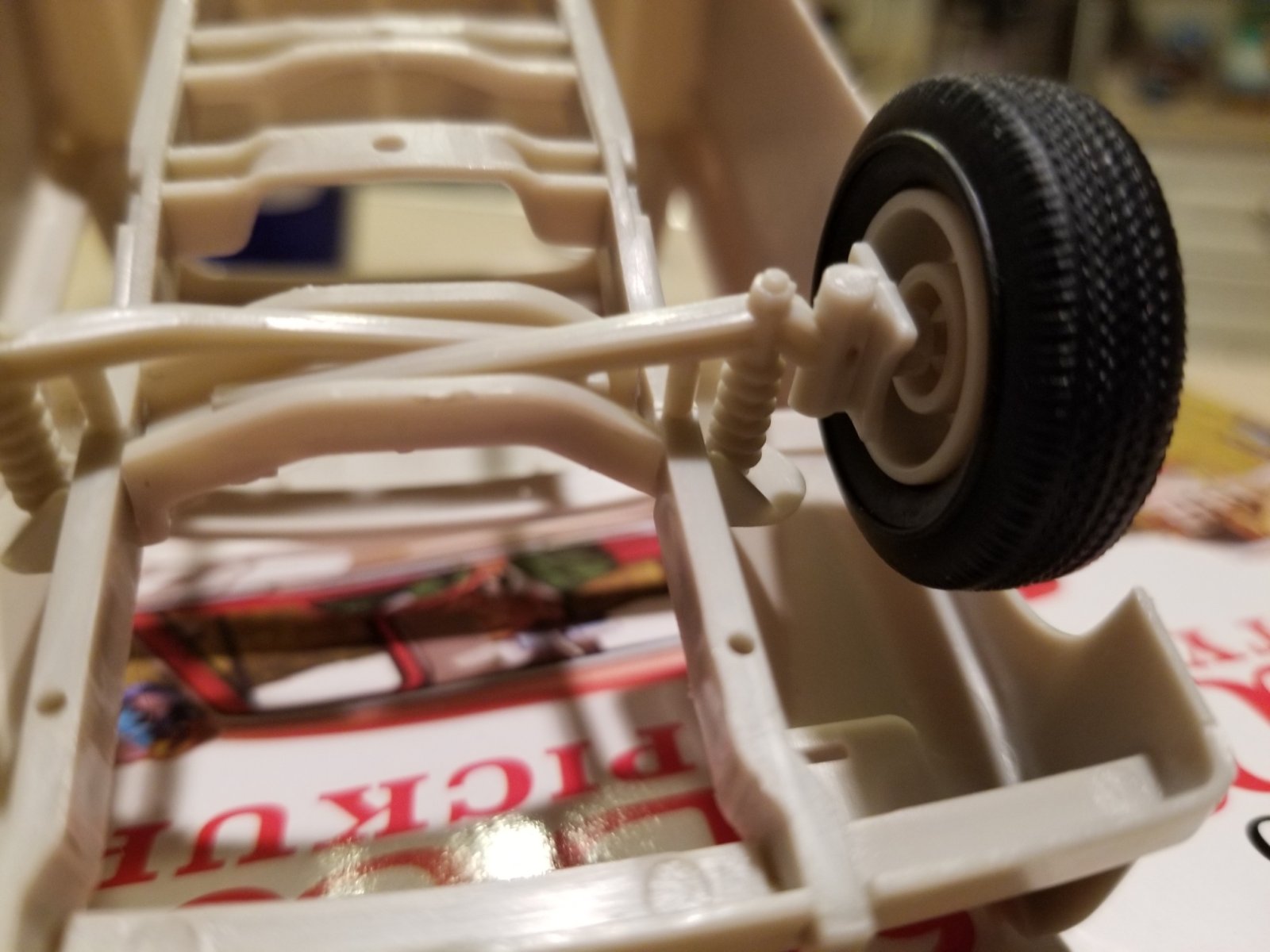

  11. Gotta get back on the real thing today but, check out the detail, if you can see it. It will prove no easier to drop than the real deal. Cut coils, bad camber. Will bend the Twin I beams to get them straight after cutting the coils. Rear, I'll slide the spring pack up and maybe a C notch. Very amusing. It's the same except I can barely see what I'm doing.

  12. For suspension modifications.... a BIC lighter is your friend.

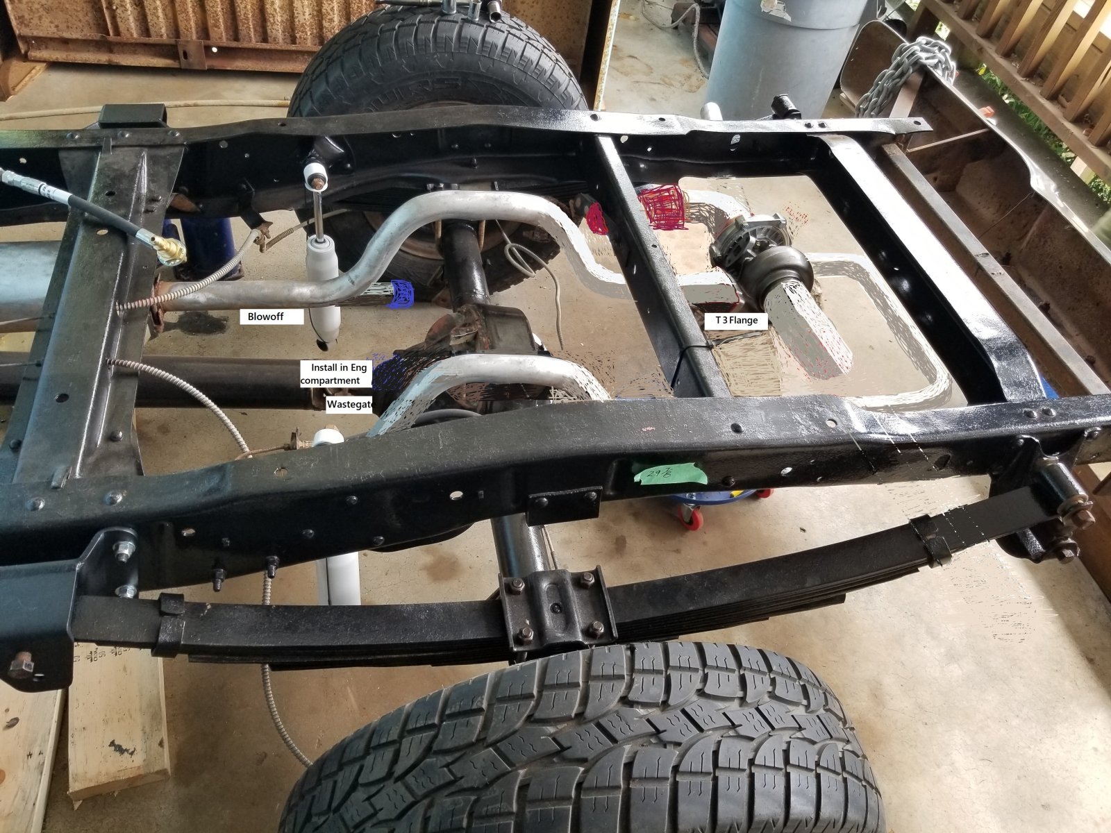

    This was an early mockup drawing I did. Looks good but, too many bends on the charge pipe side - reduces the max horsepower we can get by not being efficient. Redesigned the charge pipe to come straight out towards the engine on the drivers side without the bends by putting a bend in the exhaust side and mounting the hairdryer more to the drivers side. Kind of have it over there now which is not good so not going to show it as the box is on the truck. We can do better.

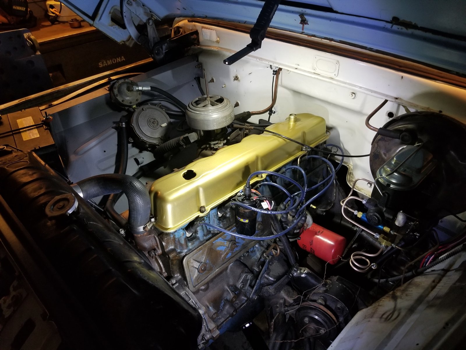

  17. Popped the valve cover off to check valve lash. What I thought was an exhaust leak could have been the rockers knocking as every one of them was really loose. Thought I would have heard some discernable ticking but, nada. I bumped through a few engine rotations and took up the slack at each lifter. When I got them all snuggy I only turned each nut a 1/4 turn not the 3/4 turn. Rational was I didn't hear that much lifter noise so didn't want to go too aggressive. Truck hasn't run in 2 weeks. Will fire up tomorrow and listen again to hear if the exhaust leak I thought I heard was actually lifter/rocker noise before I cut off the old exhaust to install the new stuff. I posted a question a couple weeks back on crema under my breather cap as a suspect head gasket about to go. Froth was just at the cap so it confirms for me at least, it is condensation. Haven't been working it hard enough and it needs a 195 deg thermostat.

  18. I should just edit the former post concerning Porting but, here is our Mad Scientist plan. Proma** offers a head that cost wise runs about what it would cost me to rework my head. Then I have to add shipping. David Vizard videos show him attempting to get an additional 50 HP out of a stock Chev double hump 186 head. I'm no David Vizard but, I will attempt to get some flow balls so I can put some science into our home P&P. I will try to emery the deck and head mating surface without cutting to potentially avoid the need for decking and pumping the lifters up by shortening the clearance in the hydraulic lifters height. I'll measure pushrods and mark short and long and match to the ports with equivalent high and low stem heights. The attempt to get to 0 lash. If I can get the bigger valves into the budget this work will be better realized - I know it does little at lower rpm's. The head is a recognized limitation for the 300 so my theory is I should be able to get some HP from the confines of the carport. Trying to consume as much science to apply to our head before I bust into this project. P&P work is time and not so much $$ and the logic is the 300 is not a valuable en***y so if I bobble the ball the world is not any worse off. This all ***umes I can do much without the need for machining but, again it's just time.

  20. 5" of snow got me more attached to the fireplace mantle than hanging over a fender. I found some gold paint so sidetracked into painting the valve cover and rear wheels while waiting for a 195 deg themostat and a breather cap. Have to book a dyno run so I can then start getting things pulled off knowing what our base HP is. Weather has been uncooperative as I'll have to trailer our show. Vintage Gold Rustoleum, this will be the complete engine colour and wheel colour. Picked up enough materials so every time something comes off the truck from here on out, it gets refinished.

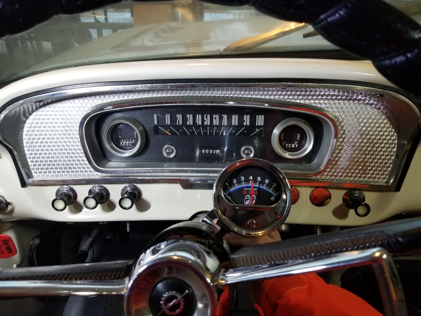

  26. Picked up some 3" exhaust bends and a Moon 1/2 sweep tach today. Slave to fashion - I've read these tachs are marginally accurate but, they look the part. Will mount the tach on the steering column initially then maybe the dash top if it works OK. Truthfully I drive by ear so I limited my indulgence. Picked up some paint pens in Silver and chrome to touch up the bezel - not bad result actually. A new bezel would look better but, this is OK for now. Beaming off To Seattle for a few days with the intention of getting down to Tacoma to check out the Lemay Car museum. Should be a fun quick trip.

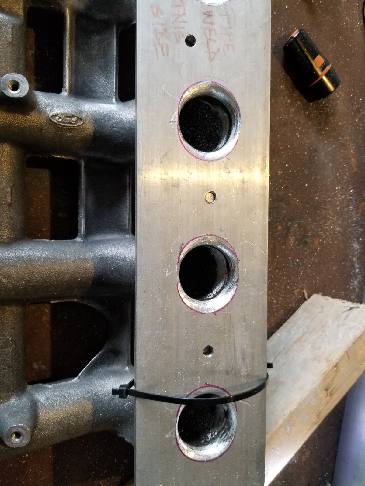

  29. Another afternoon of porting our intake manifold today. Took the die grinder to the plate that mates up to our lower intake and blended the port runner openings lengthwise. Once it is tacked together I'll flare out the openings and fab the end caps. I need to get it tacked and bolted on the engine before the caps go on in case we have firewall interference. I want to split the intake tube between #3 and #4 runners. The idea is if I elect to run a single carb I can turn a carb plate sideways to have each port feeding either side of the centre plate - If I go Dual carb the split centre will be even better. I was going to cut a slot in our tube and slide a plate in from the back side of the tube before welding to the flat plate which creates a smooth look from the top. The other strategy would be to weld tube to mounting plate then cut a slot in from the top side, drop in the divider plate then weld 'er up. Not as pretty. Dilemmas.

  30. Mike Lawless
    Joined: Sep 20, 2021
    Posts: 745
    Mike Lawless
    It's been quite the journey Will! I haven't looked in for a couple weeks, and I dig the progress!
    On the "Crema" in your valve cover. Most likely it's simple cold condensation. I get the same thing to a small degree because many times while it's been cold outside, it doesn't run long enough to get warm enough to flash it off. At least hopefully that what the case is for you.
