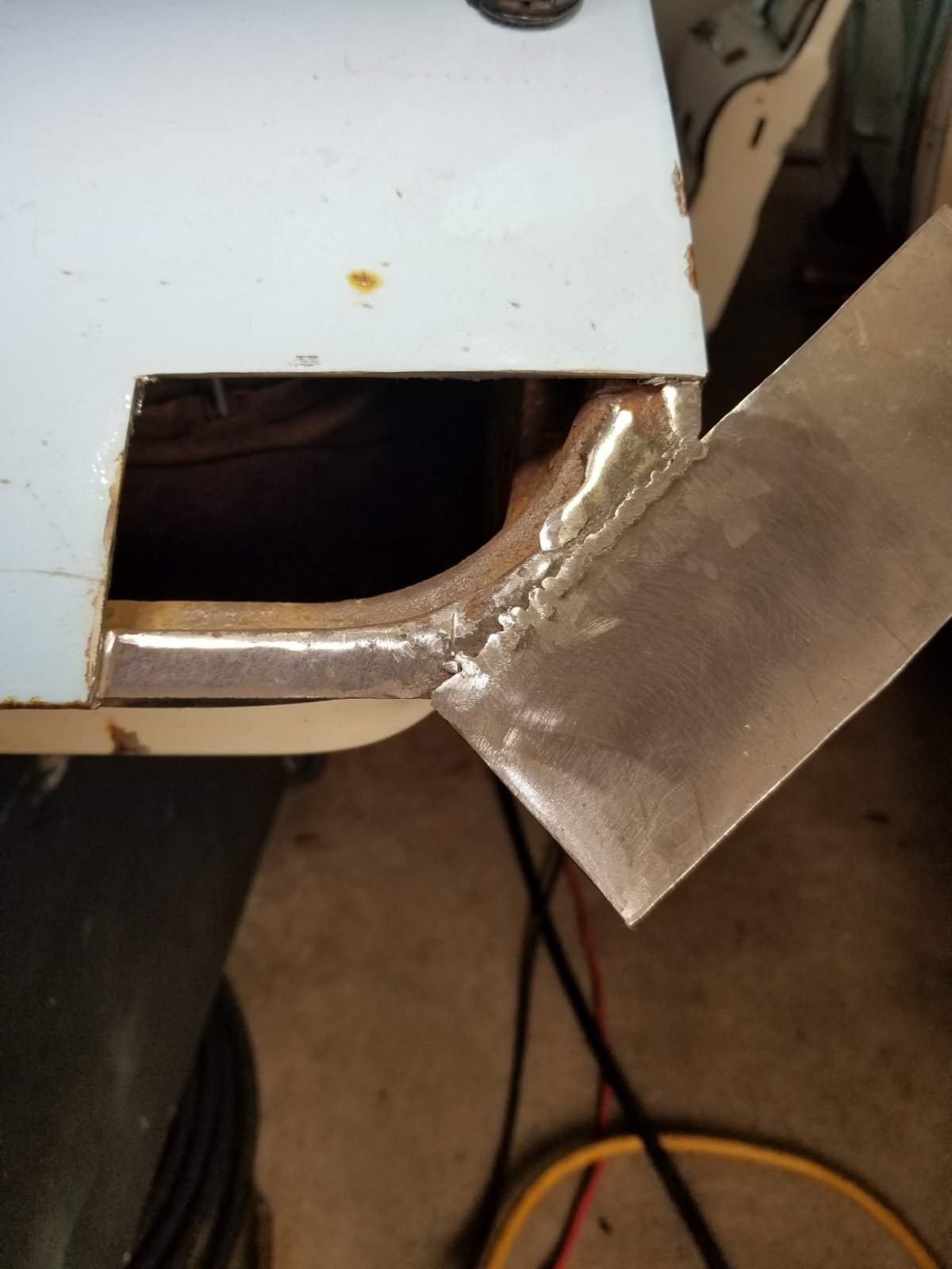

  3. Ok, back from Holiday weekends for a while. Cold and didn't feel like laying on my back under a truck. Welding up rust holes from old mirrors. Did the job then see I have a low spot. I have done some research to find that hitting the low with a torch then blowing with air can bring it up then send it down tight. Never done it and think it's worth a try. Anyone have any tips on how hot, colour of metal, do I bring up a peak then cool it to send it flat. You can see I have a skim of filler under the surrounding paint so I could leave it and bury it but, trying to acquire more skill. Haven't had the welder out for a while. My skill has regressed.

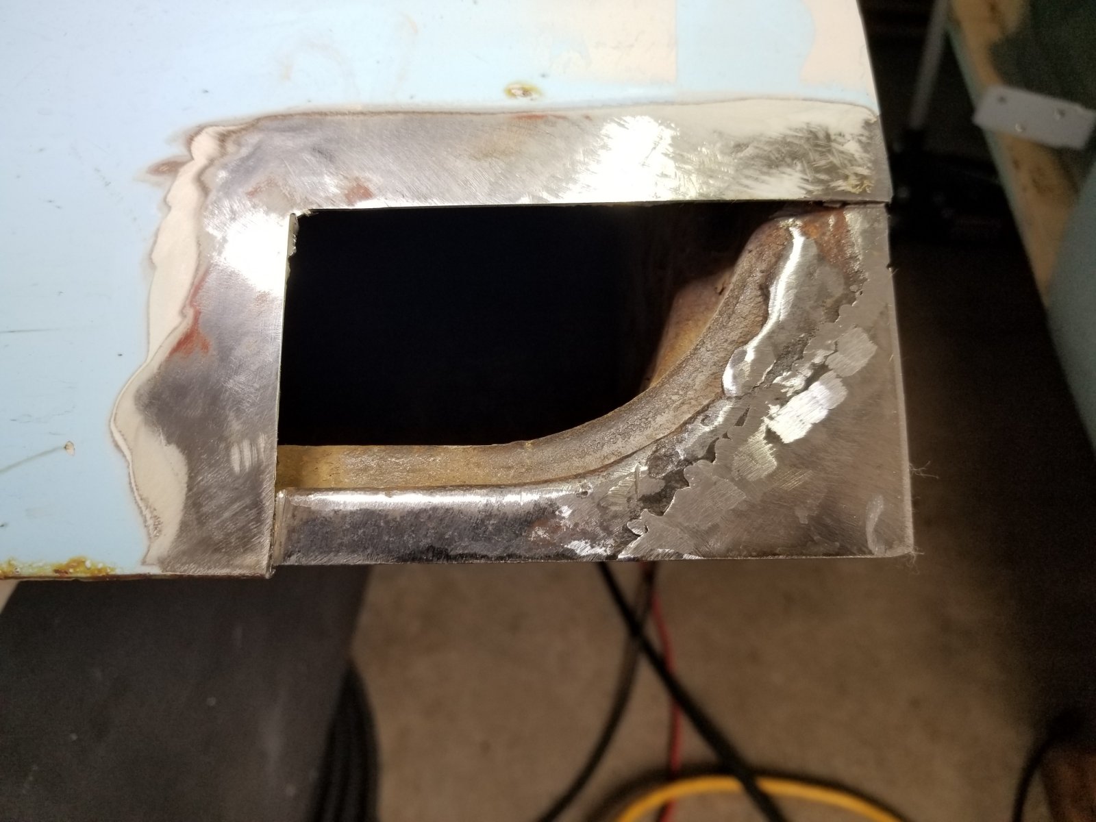

  4. Don't know how dudes with R.R.d's can sleep. This stuff drives me crazy. Left it as long as I could while I tackled other stuff but, welder's out. I do way less panel beating and bending and a whole lot more cutting and welding. I'll make the piece then scribe and cut out the old. Once out it's tack in place then make the skin, fit then weld it all together. Sunny and warm out today after 8" of snow last night!!?? I've got until nightfall to finish this.

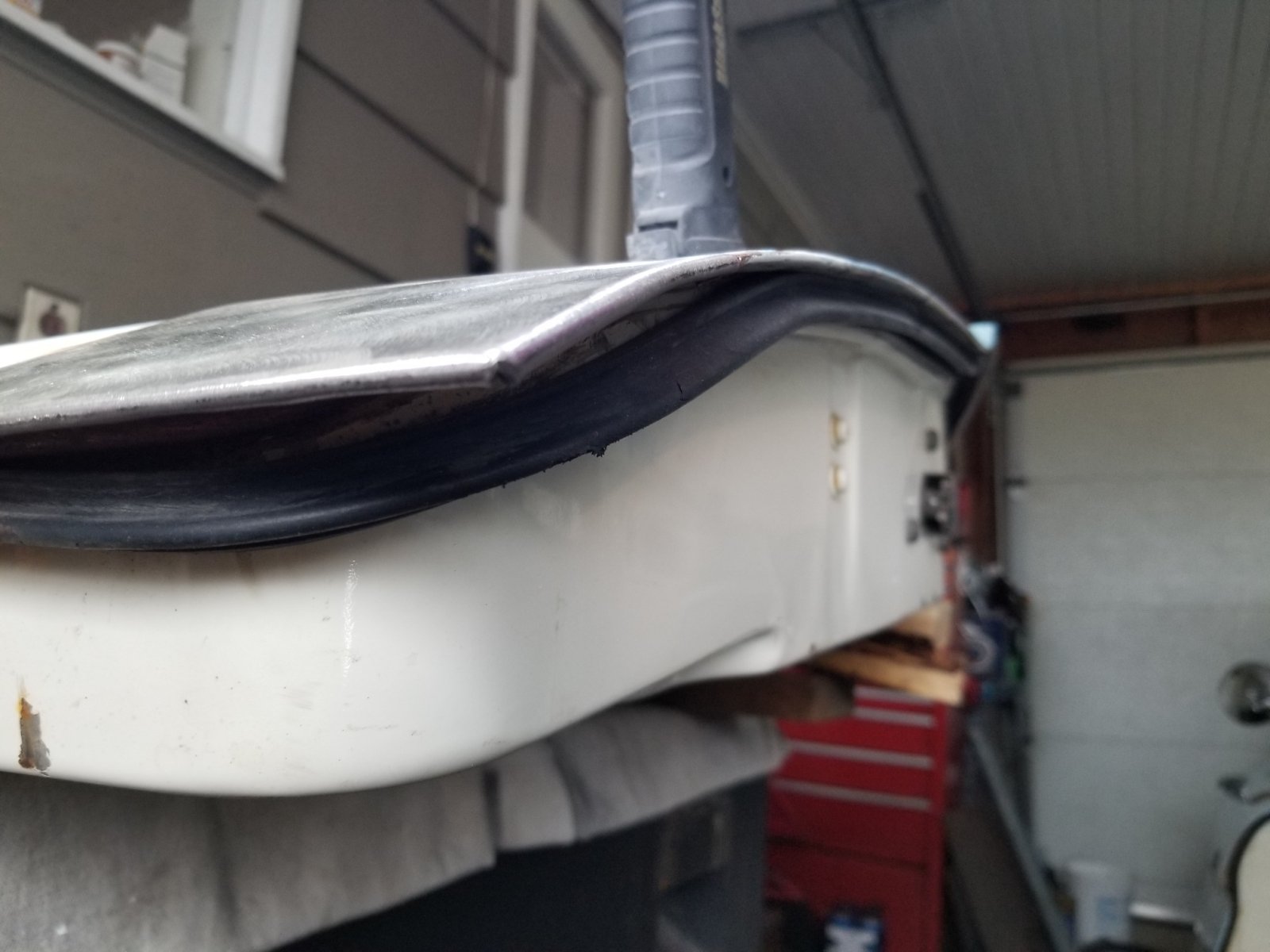

  5. I put a real time deadline on this - good one. Still have to pretty it up. Didn't get to the door skin. Battery ****ped out on my helmet so welding with my eyes closed. Bottom edge of the door is a little rough. Might chase this one a bit more. Seam will be under the weather stripping.

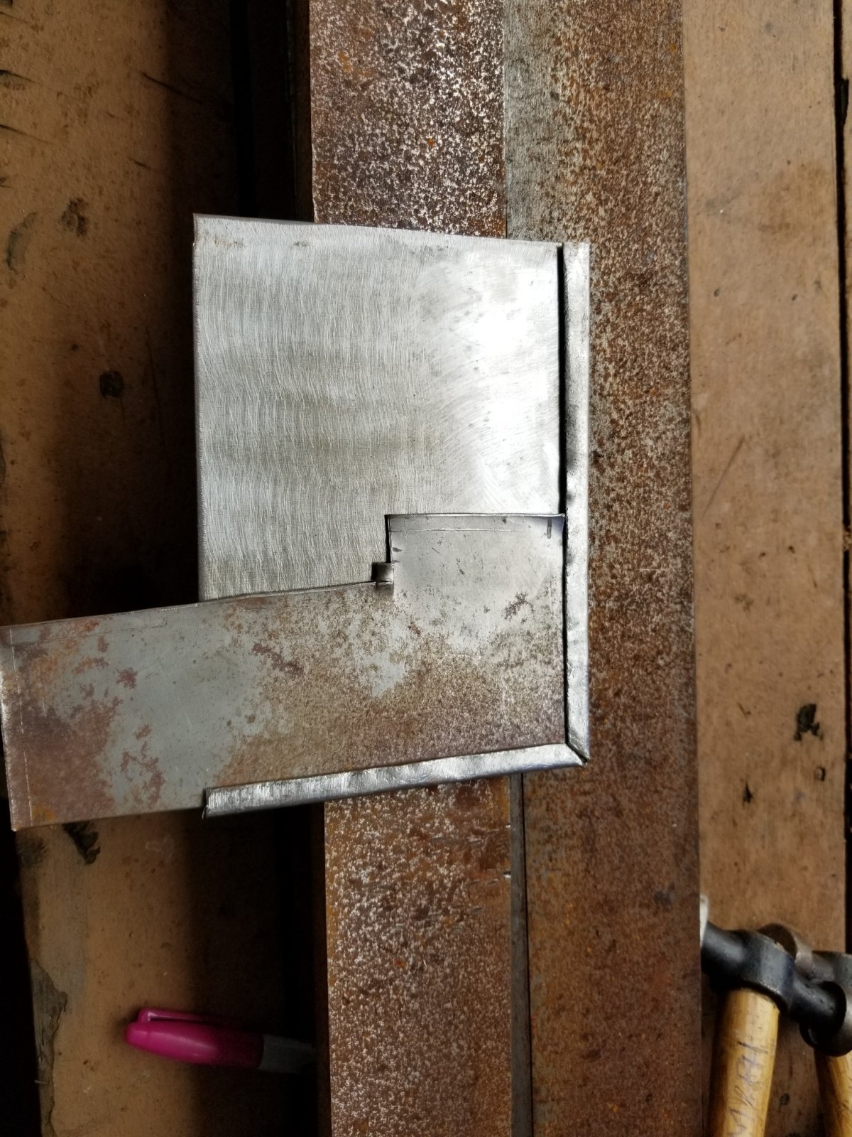

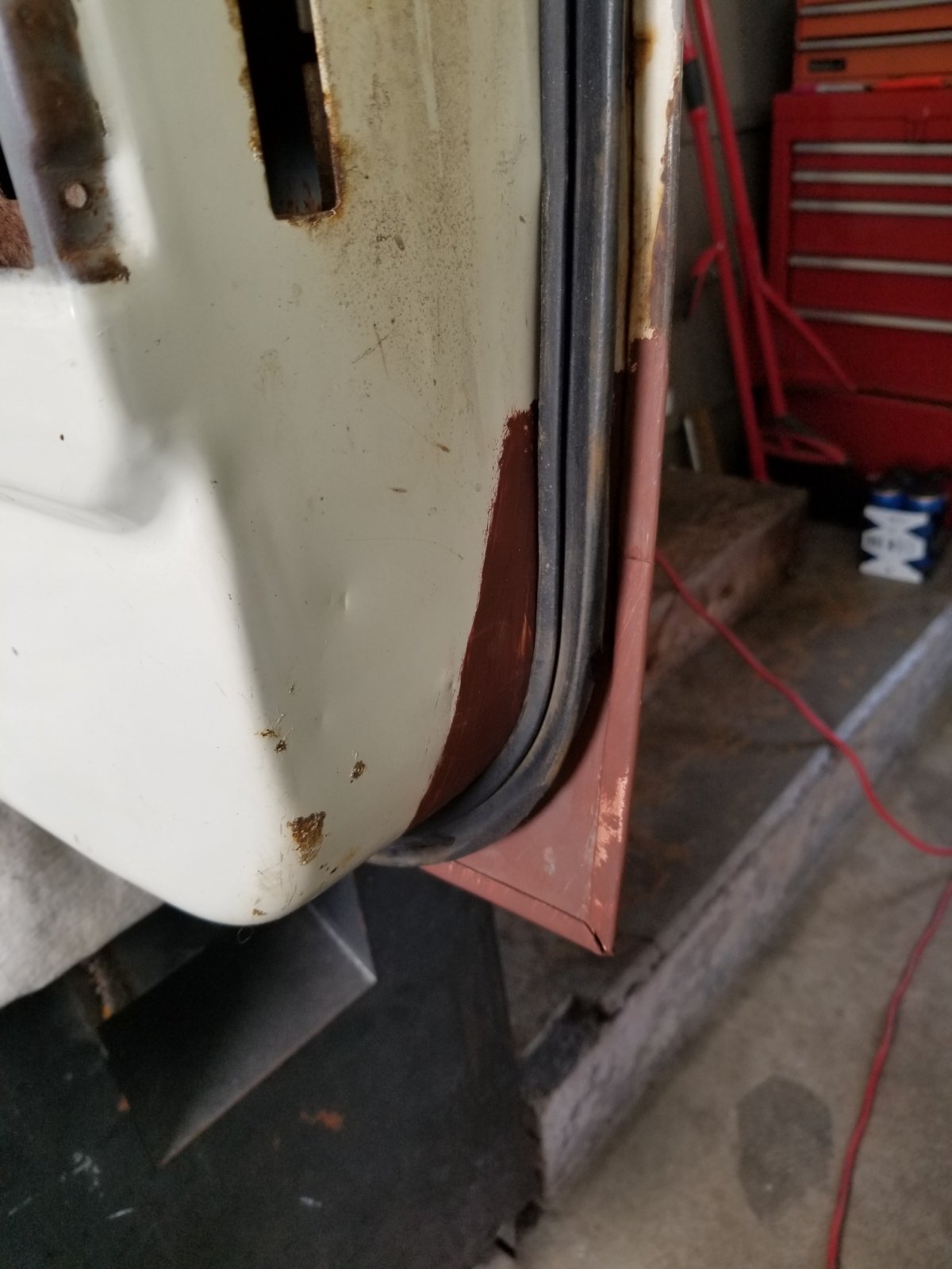

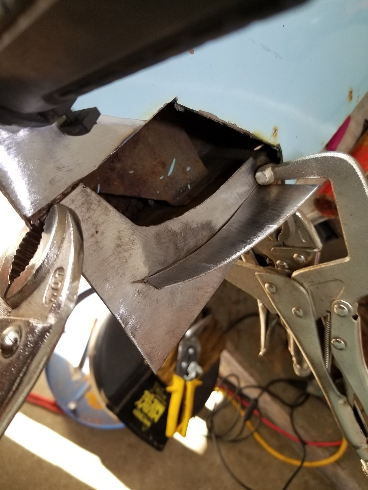

  8. On to the door skin today. My brake is a place holder with the box back on the truck. That was where I clamped and bent stuff up. So just barely beyond a dirt floor, I make myself a door skin for my repair and ended up making the wrong corner. No problem, will probably have to do all four eventually. Clamp, hammer, cut, grind, weld.

  14. Looking at the door on my bench with a plan to bolt it back on today but, now looking at the other lower corner - it needs attention. It'll never be easier with the door sitting flat and the corner I made wrong yesterday ready to go.
  15. Lucky, both lower corners are 90 degrees. Inner corner took a small patch then the skin. I'm priming with a brush now which is a bit ghetto but, I sanded yesterday's with 600 wet and dry and it's better than a spray bomb. All the spray bomb etching primer I've done so far is flash rusting. I'll eventually do a 1 skim fill for each of our exterior patches then colour match the spray so if the primer is a bit shaby I can sand it smooth. I see I have a few pin holes here and there but, it looks way better than our earliest patches.

    Weld through primer on the back of the skin. Brushed on the inner structure. The door skin isn't welded to the inner but, rather a friction clamp. By hammering the flange over onto a piece of sheet metal it takes a pretty aggressive tap to install it on the structure. I shaped the curve by pressing down over a pipe to get the shape of the door. It takes some heavy G force to shape it with the flange. I left a 45 deg corner of old door skin behind the new piece to hold it in place then cut and **** with the skin in place. It's brilliant and another Fitzee free trick. Cut the old door skin to get it right of your way at the door edges, tap into place and the whole thing is tight and hands free to weld.

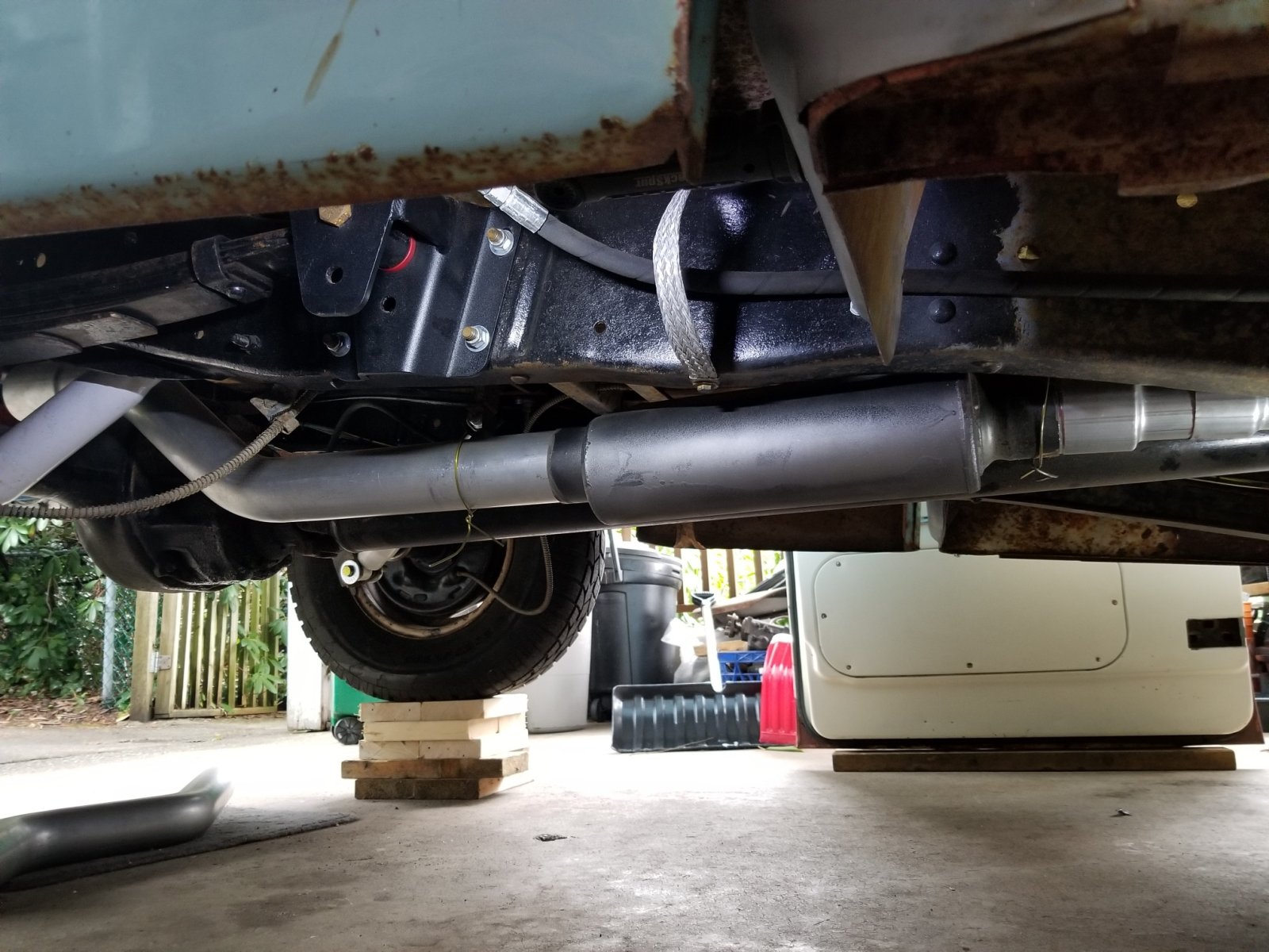

  20. March '23 is rocketing by and I don't have a fraction of what I wanted done over the winter. I decided to throw the exhaust back together. 2" from the exhaust manifold to 3" adaptor to the muffler back. $12.00 and she's up and running again. True to our objective, from here on out, nothing too big that would render the truck undriveable. Bolt the doors back on, hook up the tach and fire it up. April insurance back on it. I'll weld the adaptor but, will weld a bolt flange either side of the muffler then make another flanged straight pipe to sub in if we want to delete the muffler later when our stuff out back is running which could potentially muffle it enough to leave the muffler out. Wire coat hangers to hold in place while I fab. Hoping it sounds like the UPS truck.

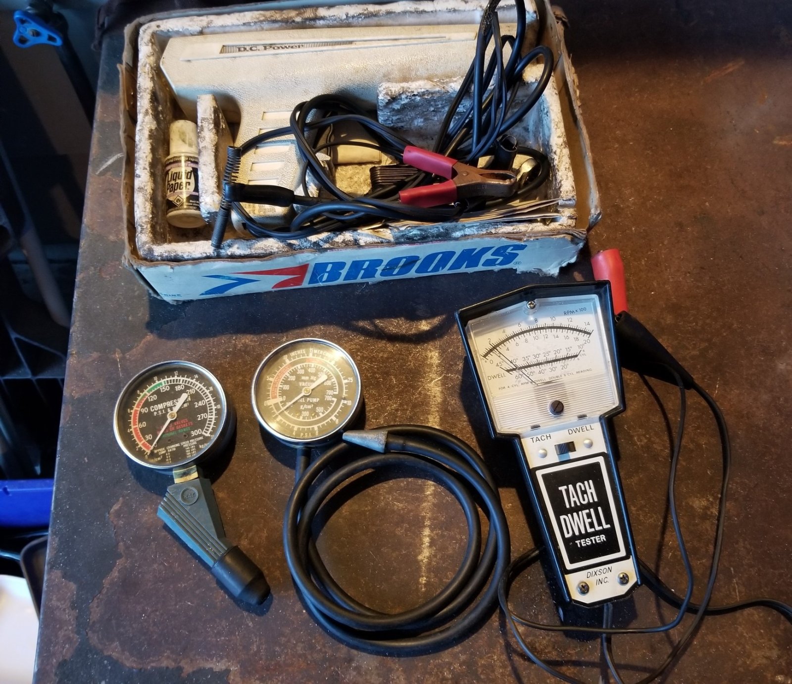

  29. Wow, found a Rac gauge Bezel on E**y this morning. I'm in awe. Fully chrome cast bezel. Hard to contain my excitement. On it's way soon. Also tuned out the Stumble with my, new to me, vintage tune up goodies courtesy of a friend from work. Mentioned to him I needed to get a vacuum gauge and the next day he gave me these nuggets of gold - Free! Picking up a case of Guiness for him to fulfill the good neighbour policy.
