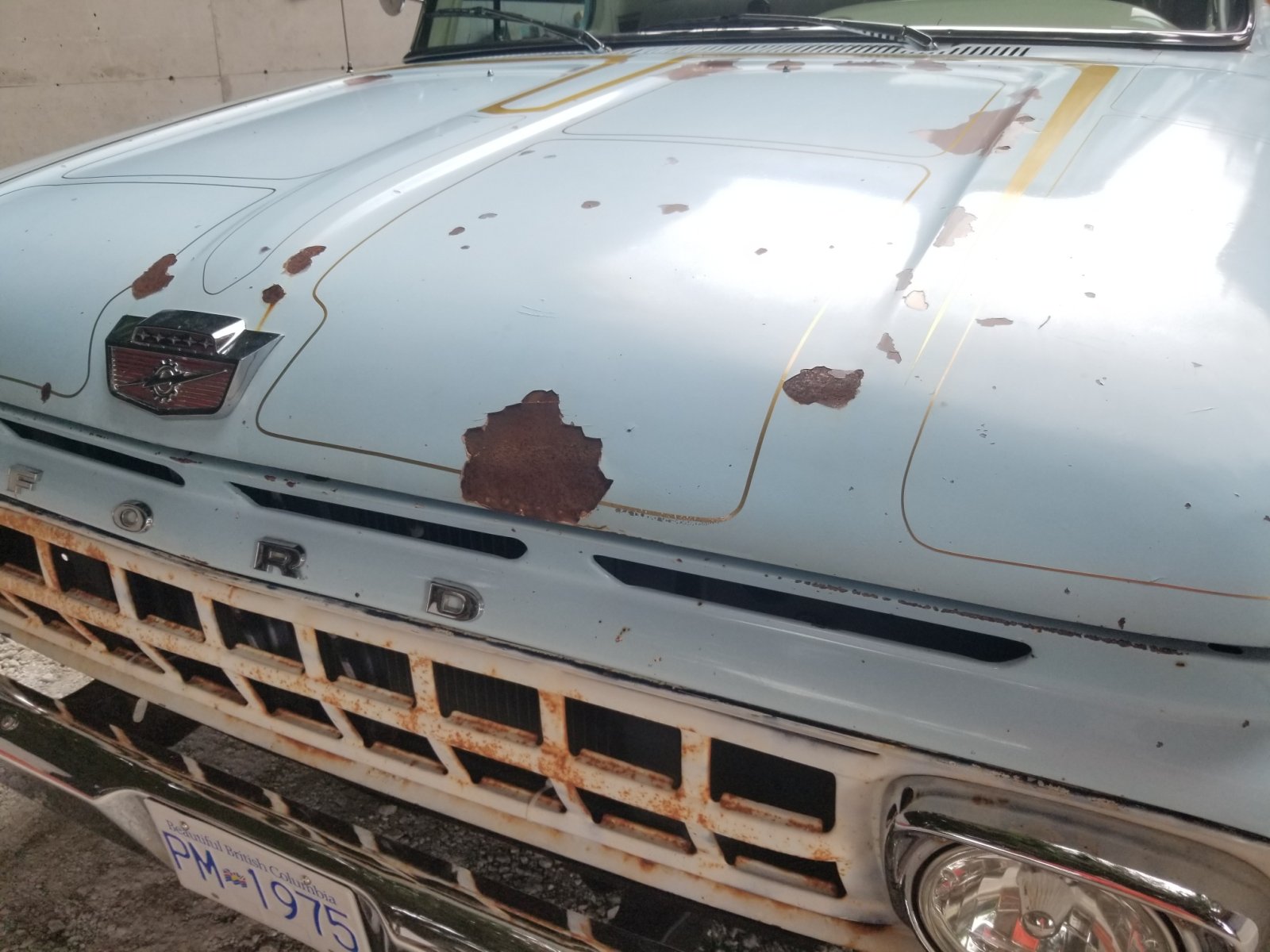

  2. Ha, We've been busy. Didn't know what direction we were getting it to but, apparently now that we've arrived, "
    '60's clapped out Show Car Hauler is our theme.

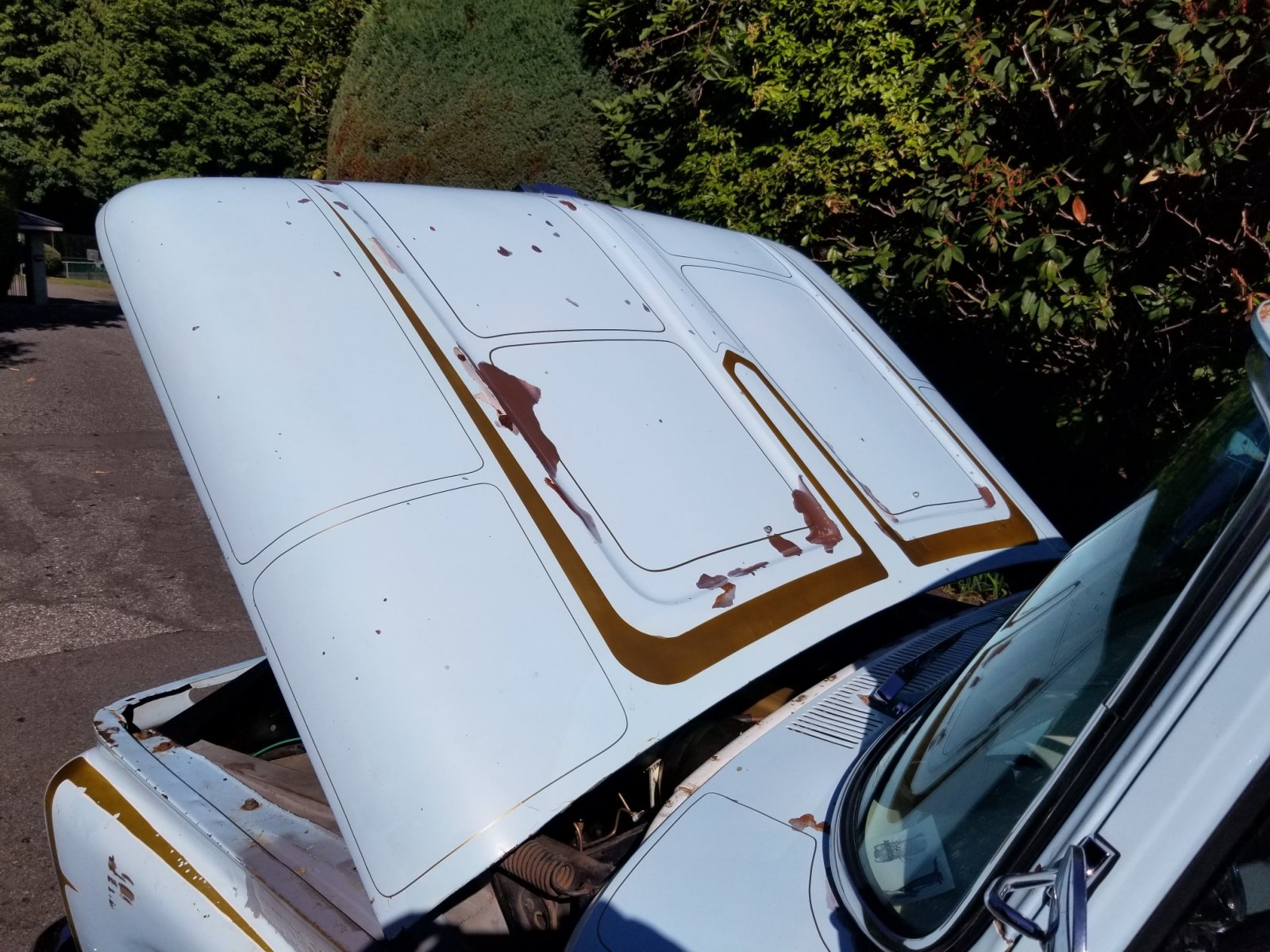

    Posts: 2,039

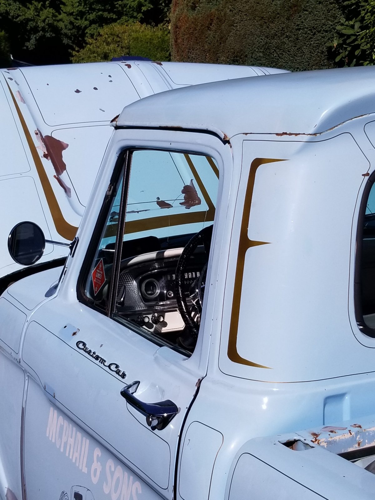

  5. More pinstripe pics after I took it to a little mini meet last night. Took the jamb nut off the booster pushrod to see if that gets the last of the brake rub out. On to the next item.

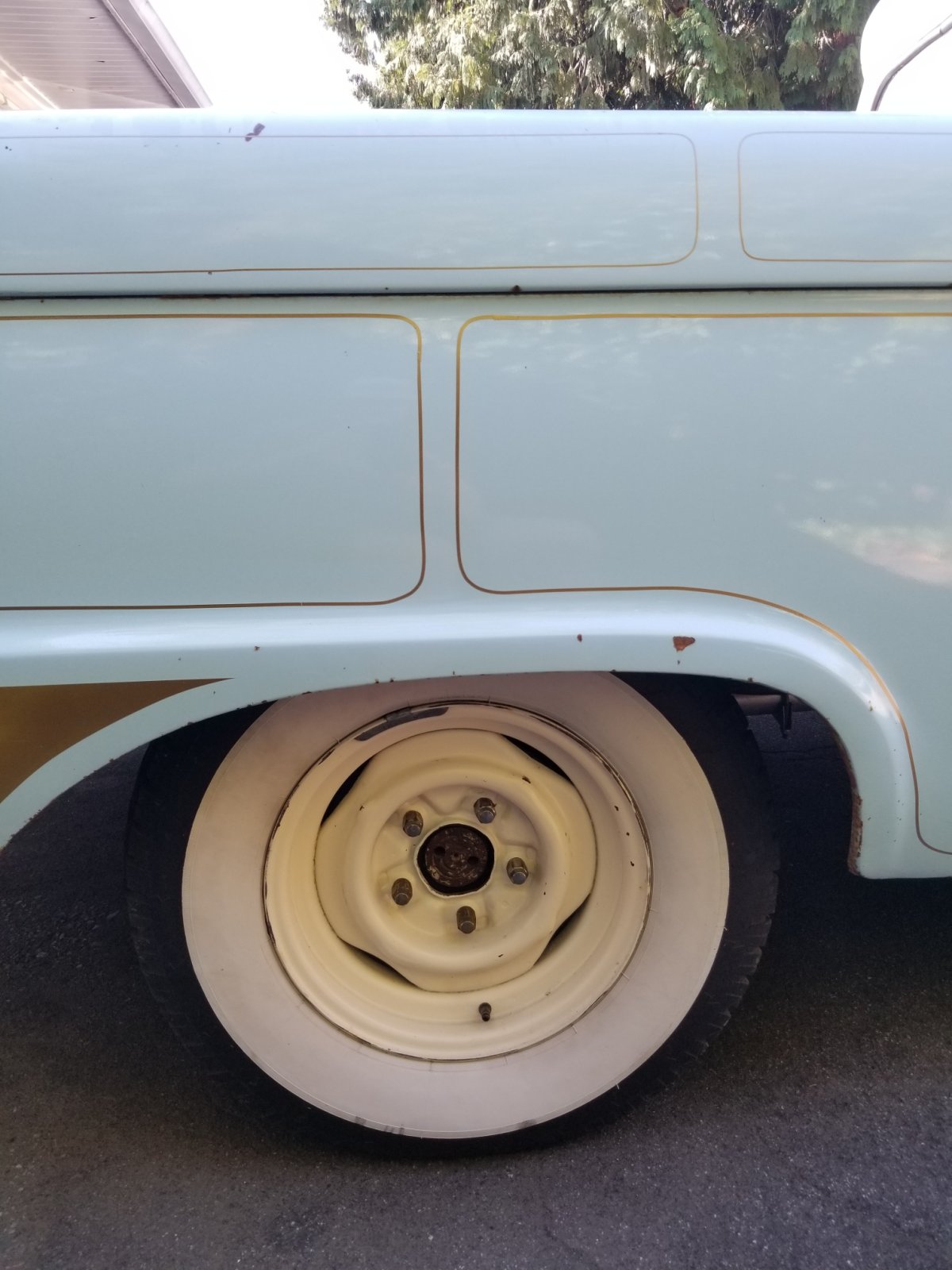

  6. Nothing to report on the Father and Sons project other than the Father is currently working on the Son's project. Oh, I got a set of 1-3/4" Port-a-walls to put on the front. I wanted the 3" but, lots of storys of them flapping in the wind. Going to pop one on the blackwall side for a visual. If not quite enough I can grind the white letter side then put these on to fill back to the rim. Pretty cheapskate.

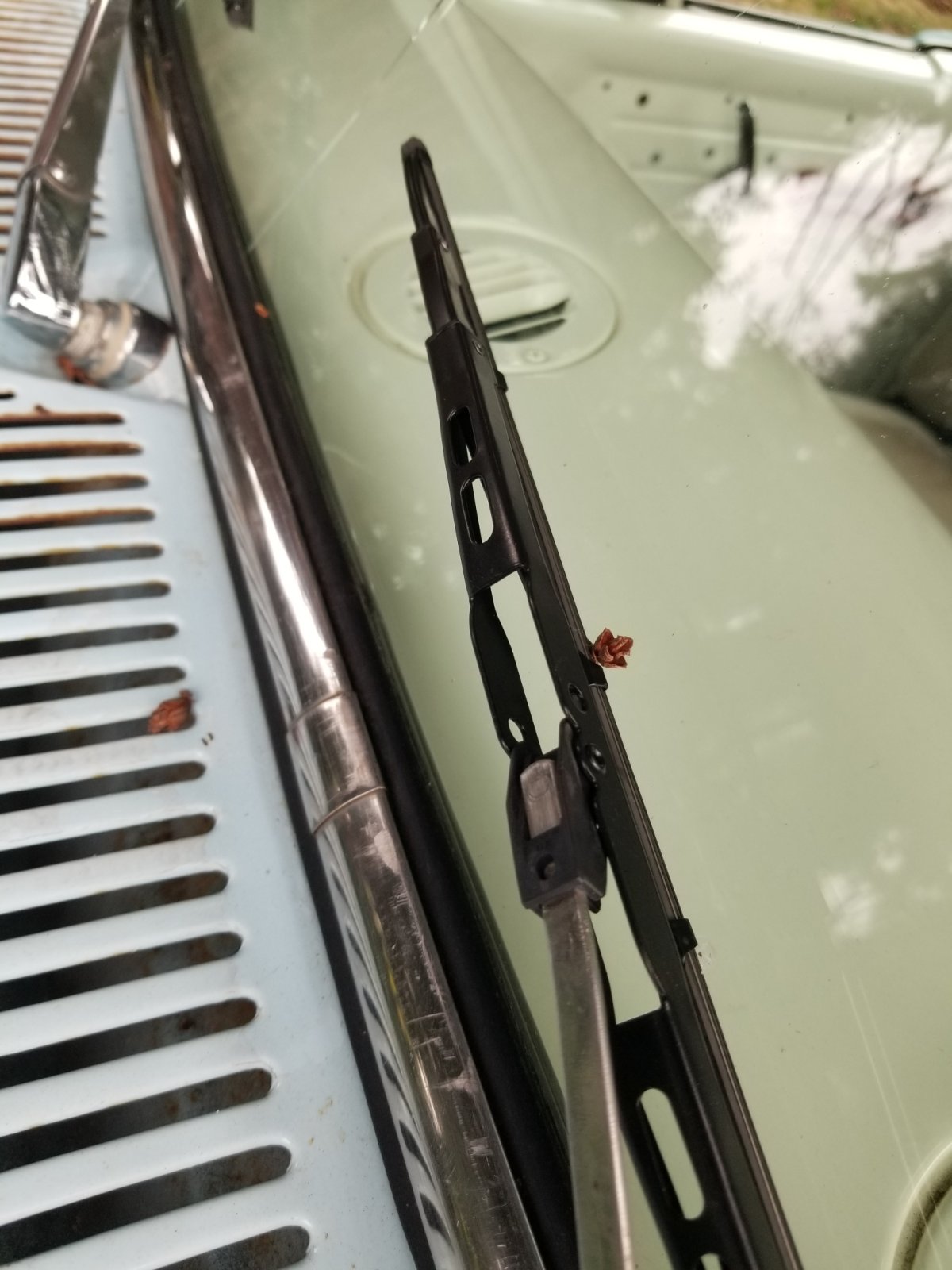

  8. Got caught in the rain yesterday cruising so turned on the wipers which promptly ripped up the rubber blades. Went to the local Canadian Tire to search - I had a good at***ude. Ended up opening about 15-20 packages (no packaging wrecked as all plastic resealable). Examining clips while searching for metal wiper arms that don't look like they came off Battlestar Galactica took a while. Got a few questions from employees and a couple of good lucks. Popped the clips off the new and swapped the clips from my old. Done deal!

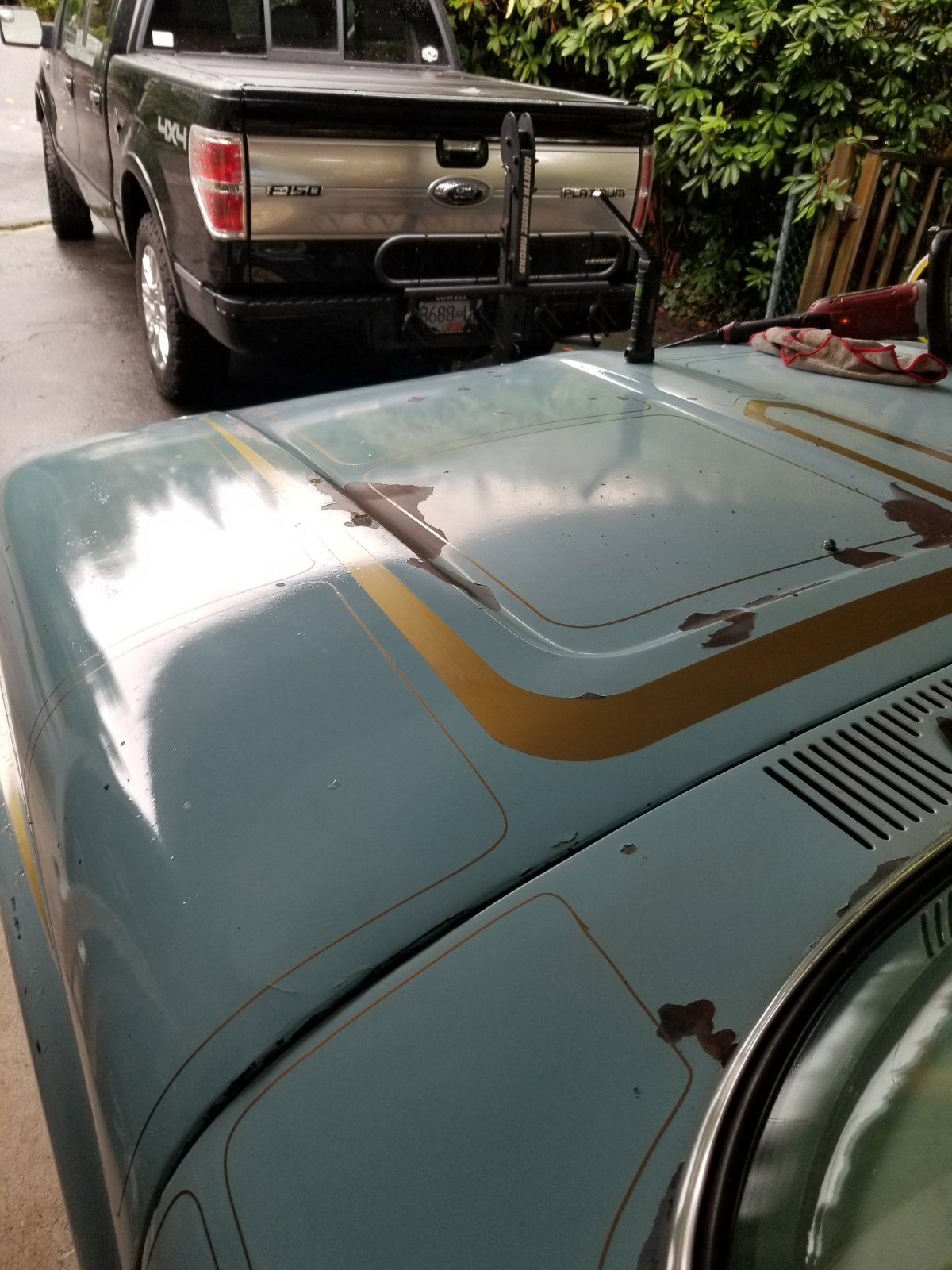

  13. Brakes are still down and ended up buying a polisher - logical. My kid's roof has flashed enough so figured we jump on it. His car was in the rain so went after our truck. Damn that was a lot of work but, it has never shined like that before. The roof was an orange peeled mess but, she's shinin' now.
