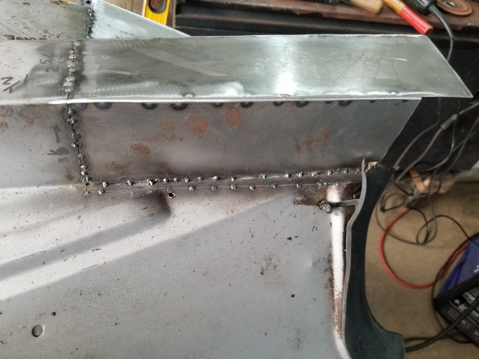

    I'm repairing my inner fenders and air deflectors on my 56 also. Are you using .024 wire? I know it still burns thru sheet metal but not as bad as .030. Looks like your repairs are good. I thought most inner fenders were available repop? I'm following along. Great job!

  4. Hi Greg, thanks for stopping by. Pearls of wisdom thank you! Hadn't occurred to me to go with thinner gauge wire for thin metal. Welding is a new sport for us. 65-66 inner fenders are their own species, and they are extinct. Support for fat fender trucks is huge comparatively, lucky you. The 67-72 trucks have found the love as well. You can walk into a local tool supplier here and buy Chev stuff off the rack. A few guys from high school days had 61-66 trucks and I wanted one. I'll stop by and check yours out later. I have to get these damn inners done. Last of my days off today.

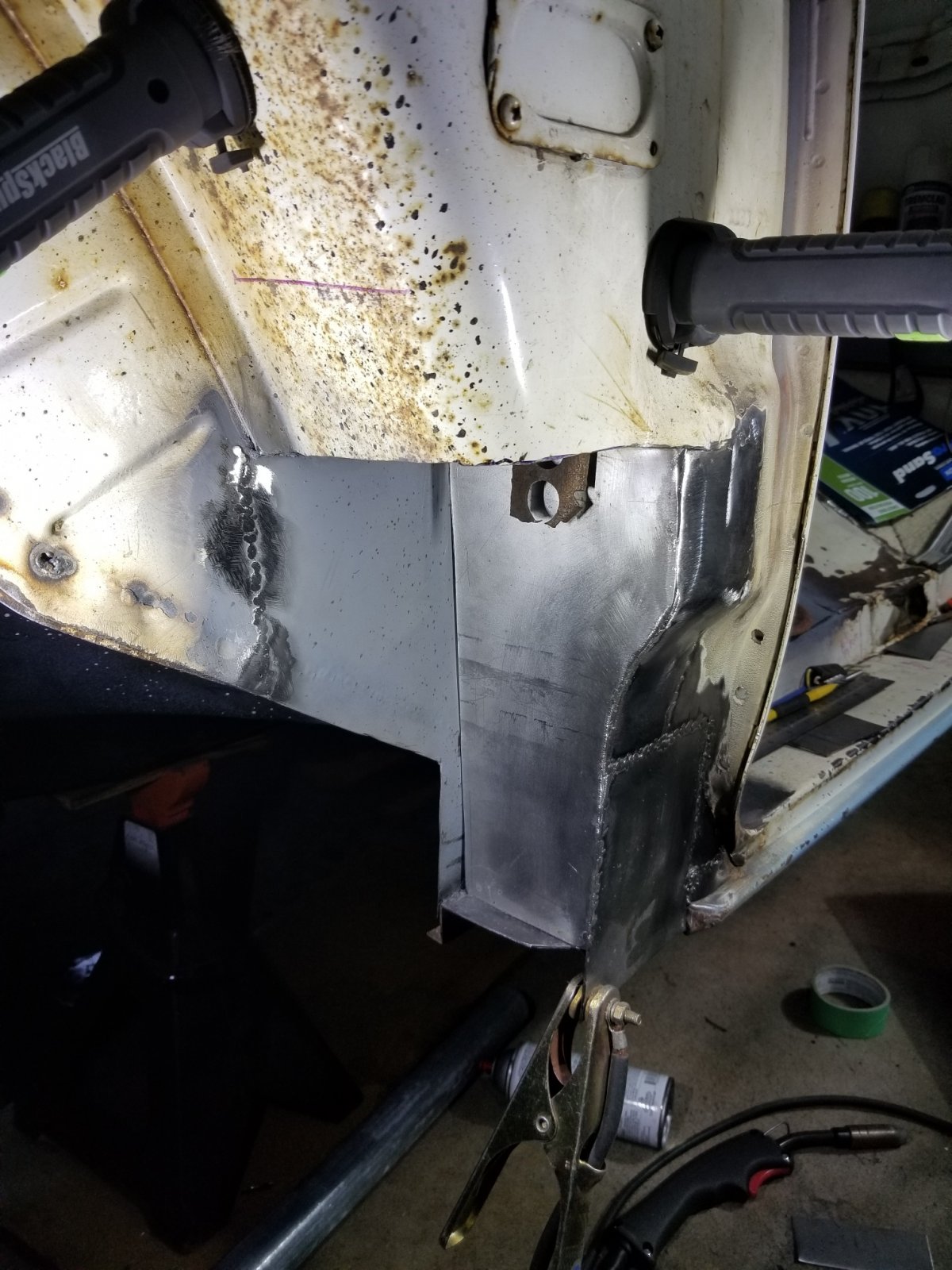

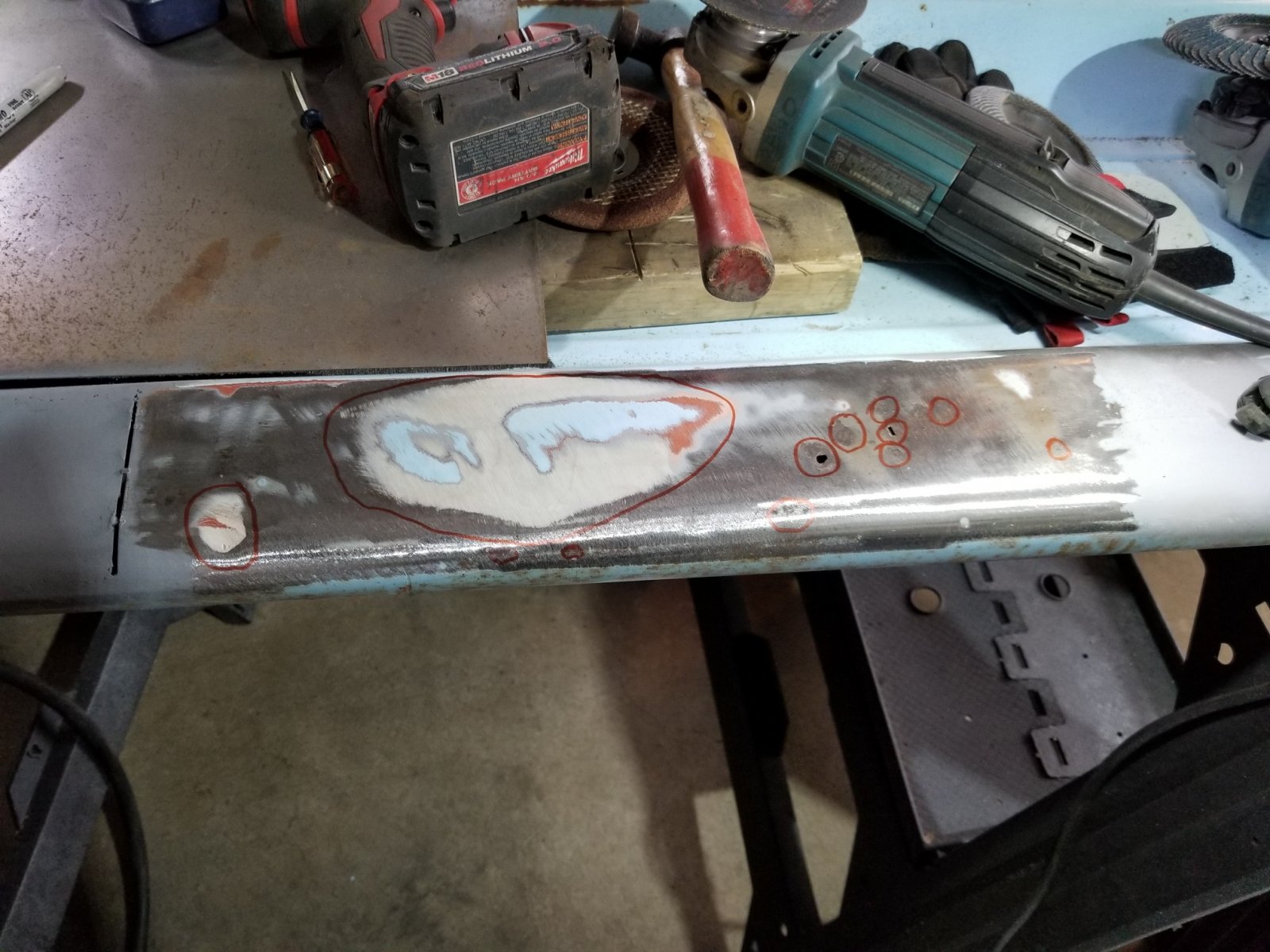

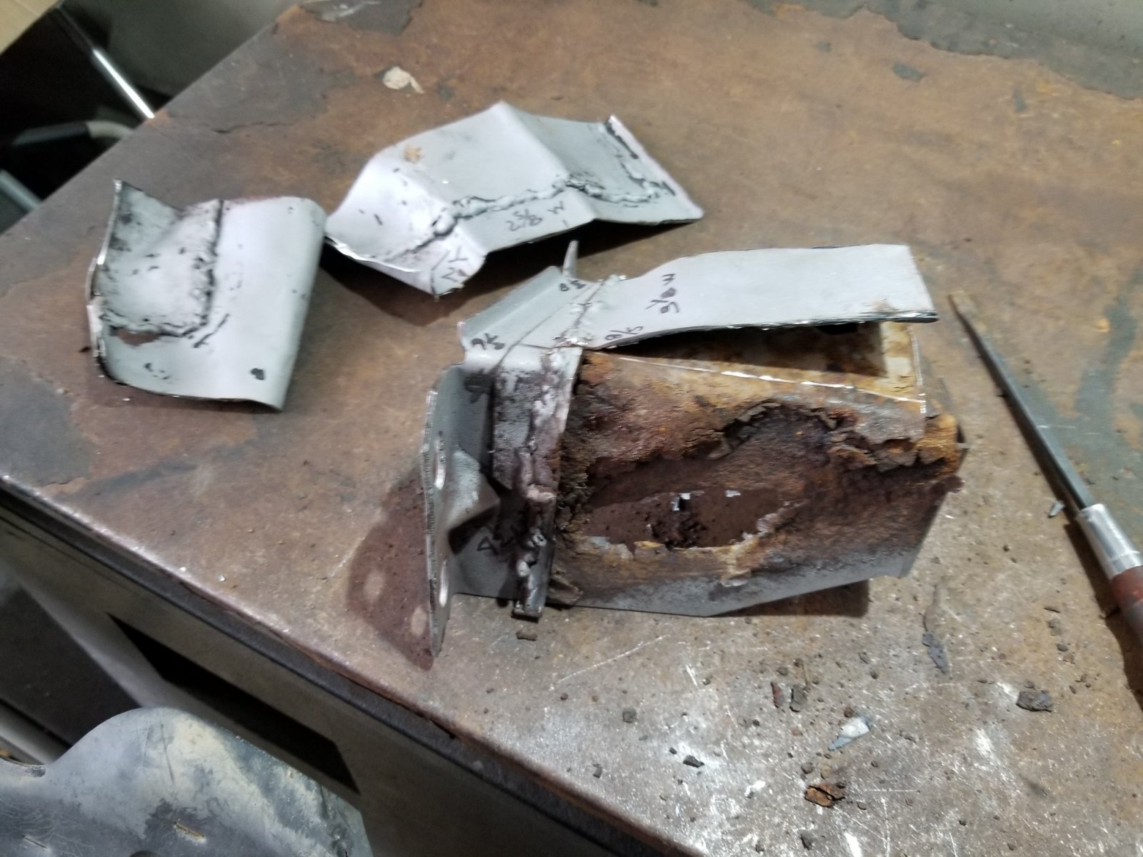

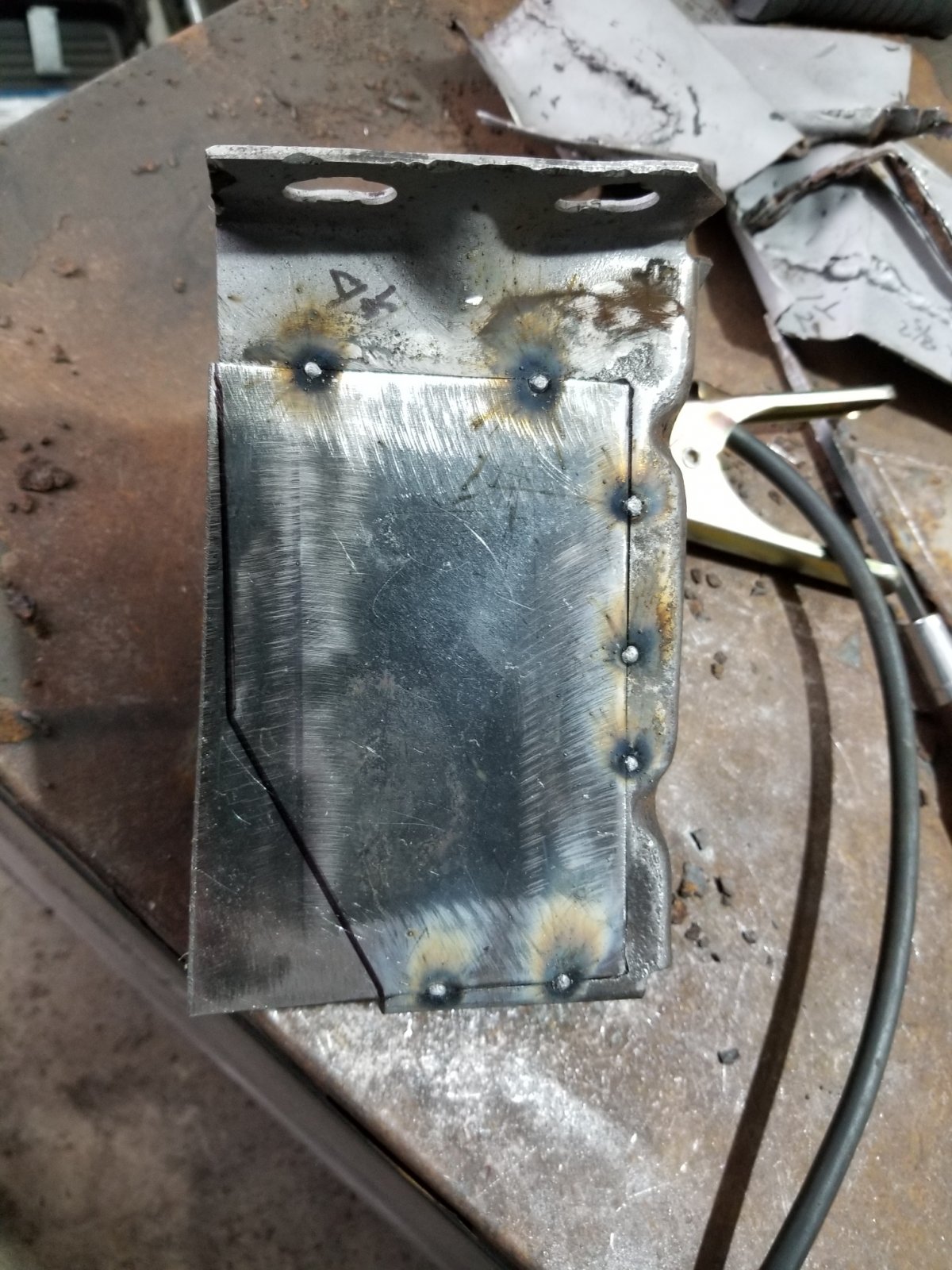

  6. Didn't get the p***enger inner fender done today, too many errands. Just have to cut apart the old mounting bracket then repair and reinstall and finally decide if I'm going to weld up all the drilled holes or live with the character. Suspect I will be welding them up.

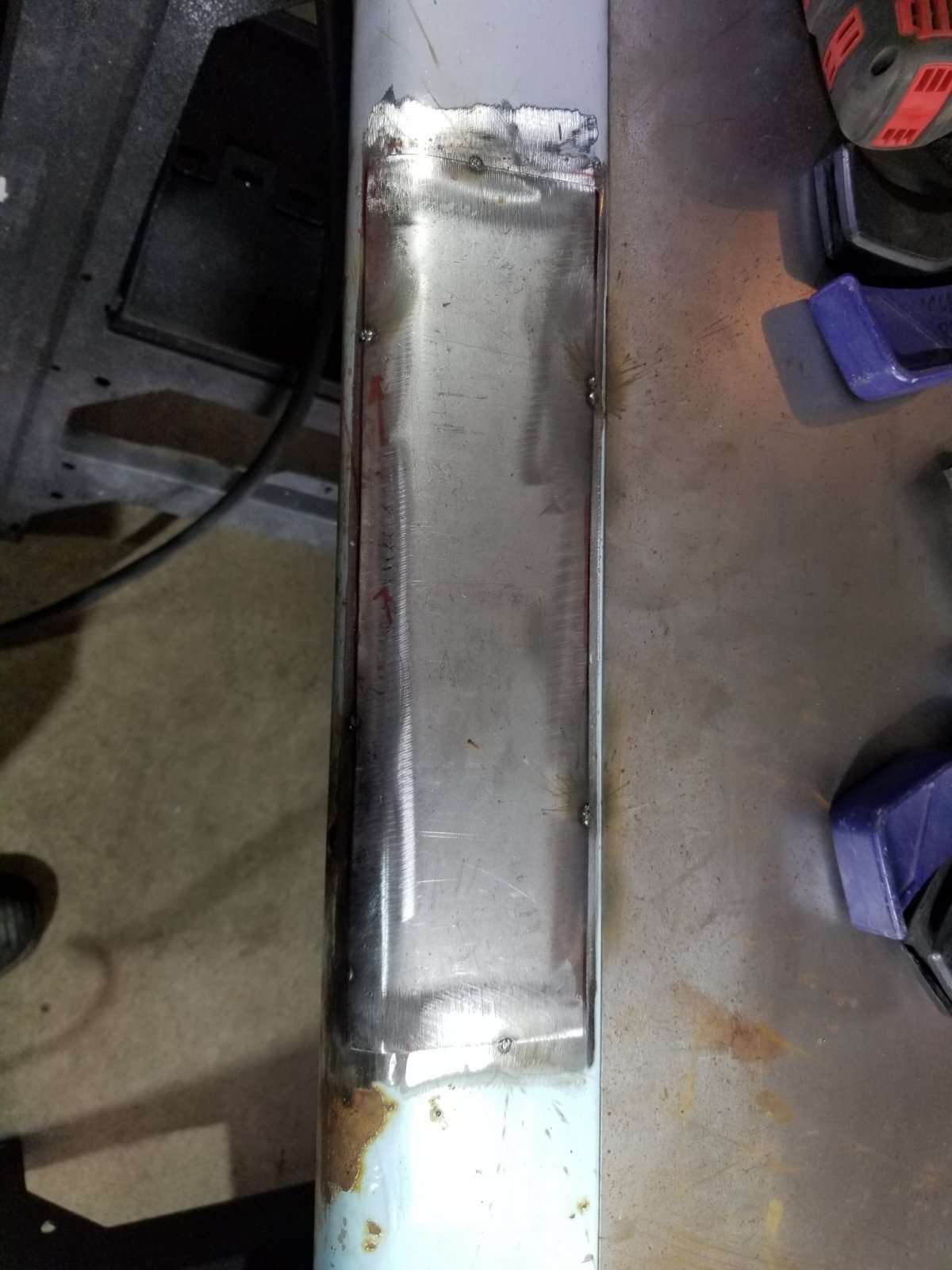

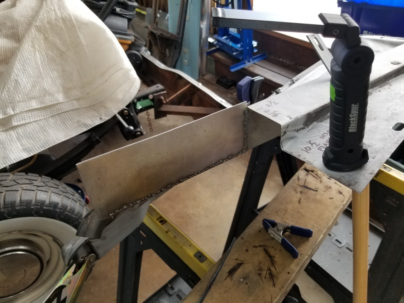

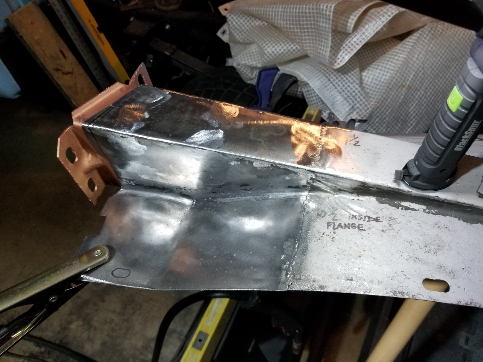

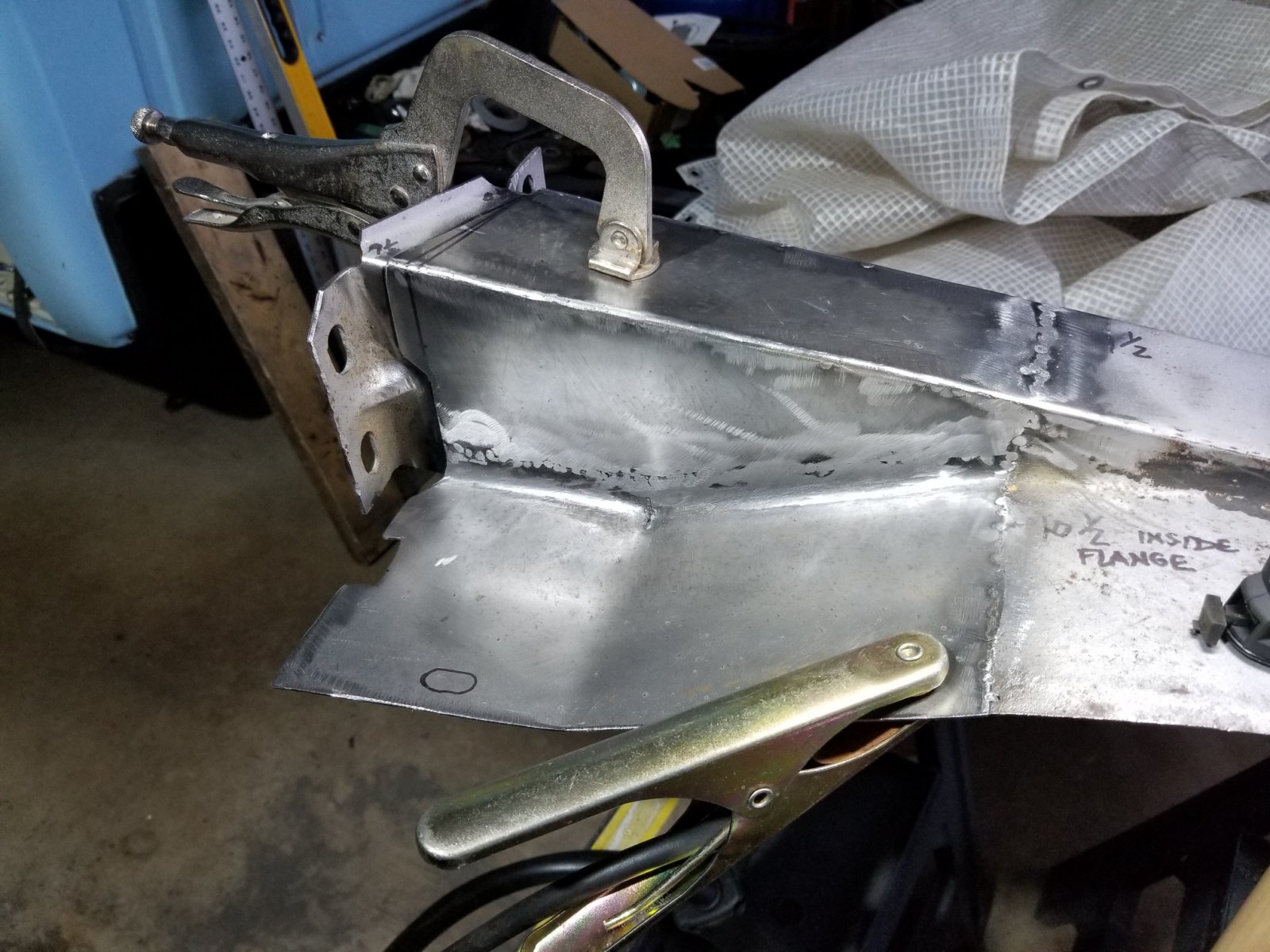

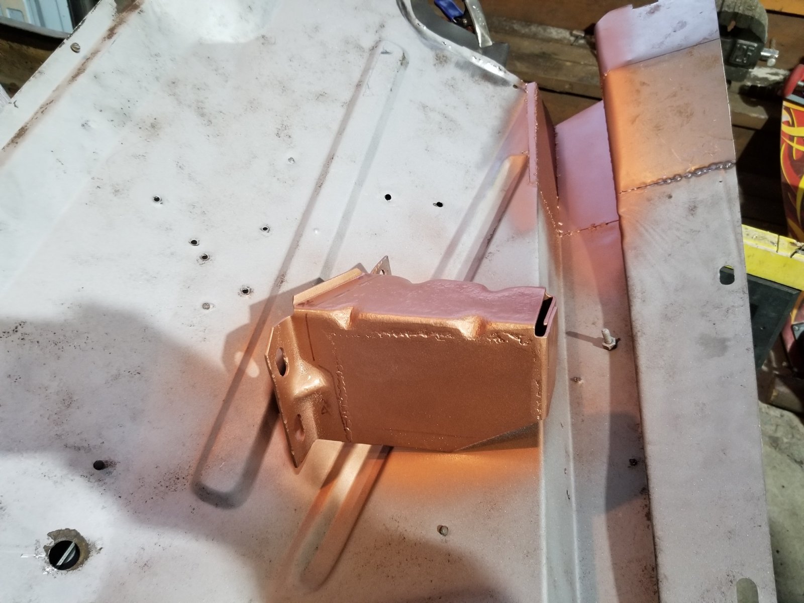

  7. So after investing something approaching Riddler hours on these damn inner fenders, I bolted them on to make sure the repairs I made fit. Now grind 'em down and fill some holes next weekend. 22 on the drivers side and 28 in the other, the willy nilly kind not including factory. Maybe I'll have to leave the hood off.

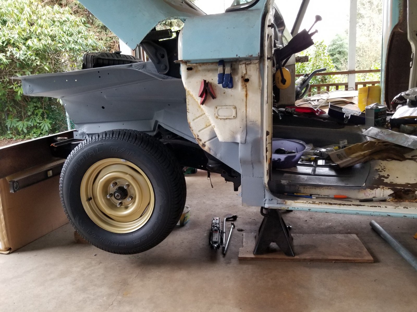

  8. Managed to squeeze in a little painting early Saturday and a partial bolt up including the new rad support end of the day Sunday so we can stand back and evaluate. Hopefully rotors come in this week then a couple of roller tires for the front and we should be able to drop the front end on the ground.

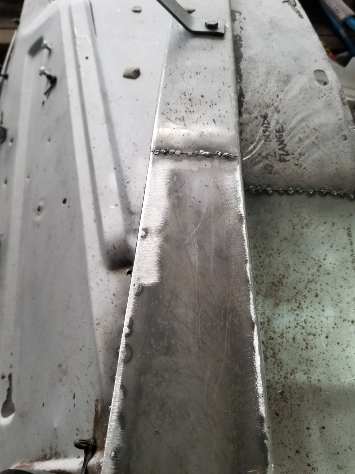

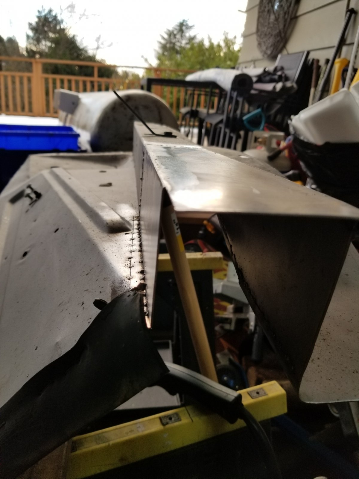

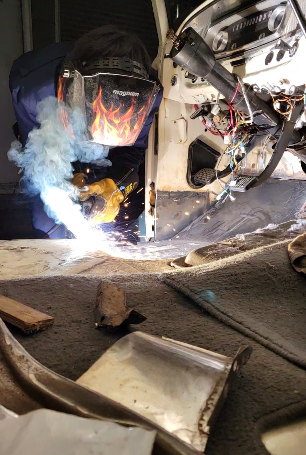

  12. Lot's done today. Both inner fenders primed and mounted. Finished welding drivers rear cab corner, tacked contour repair under gas pedal - drivers floor. Have to get the cab on it's back to finish weld as it is curve to a curve and with the transmission in I can't tap it to flush. Frankenwelded driver's A pillar - 6 pieces. Should get it finished next weekend with flanges and spot welds to make it look stock. Deadlines can be good. 20220116_131726_resized.jpg View attachment 5289453
  13. In my quest to get this thing done it was head down production mode this weekend. Productive yes but, Sunday my 15 yr old came out and asked if I needed help. I looked around in the tight space I was in with tools, cords, parts and said no thanks Pup, I'll catch ya later. Last night it dawned on me I kind of missed the point of this project. Told him next time, I step back and he slots in - Good grief. Photo below kind of shows status. Have to replace both brace ends under the seat where they meet the sill plus the sill section that is rusted to dust then we can complete the floor. Need to disconnect anything remaining holding the cab down and get it on it's back and done. As if we don't have enough stuff going on, we are trying wrap up our current home and go buy another then move. Let's get a few more balls in the air shall we.

    Are you using an extension cord to your welding machine?!
    IF it's too small (prolly is) it makes the welds look a lot like bird dookey! Axe me how I know this and I'm a welder!
    Just a thought.
    6sally6
  21. Hi 6sally6. You probably hit on why I can't seem to tune my welds to something nicer regardless of changes I make to wire speed, amperage or height off the material. My carport has no power so I'm forced to use a cord. I made a 5' cab tyre extension cord equivalent to an 8ga dryer plug. I'm using flux core .030. I want to use gas but, I'm keeping my rig light until I move to the next house. Flux core cleanup is getting old given how much welding we are actually doing but, I get good penetration. Not sure how to improve on what we've got going right now, any other suggestions. Pride of workmanship is a big part of our show.

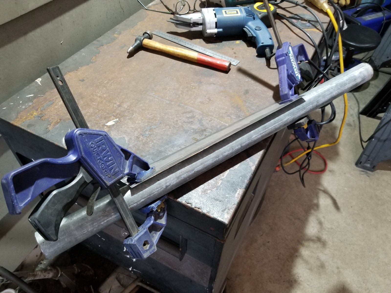

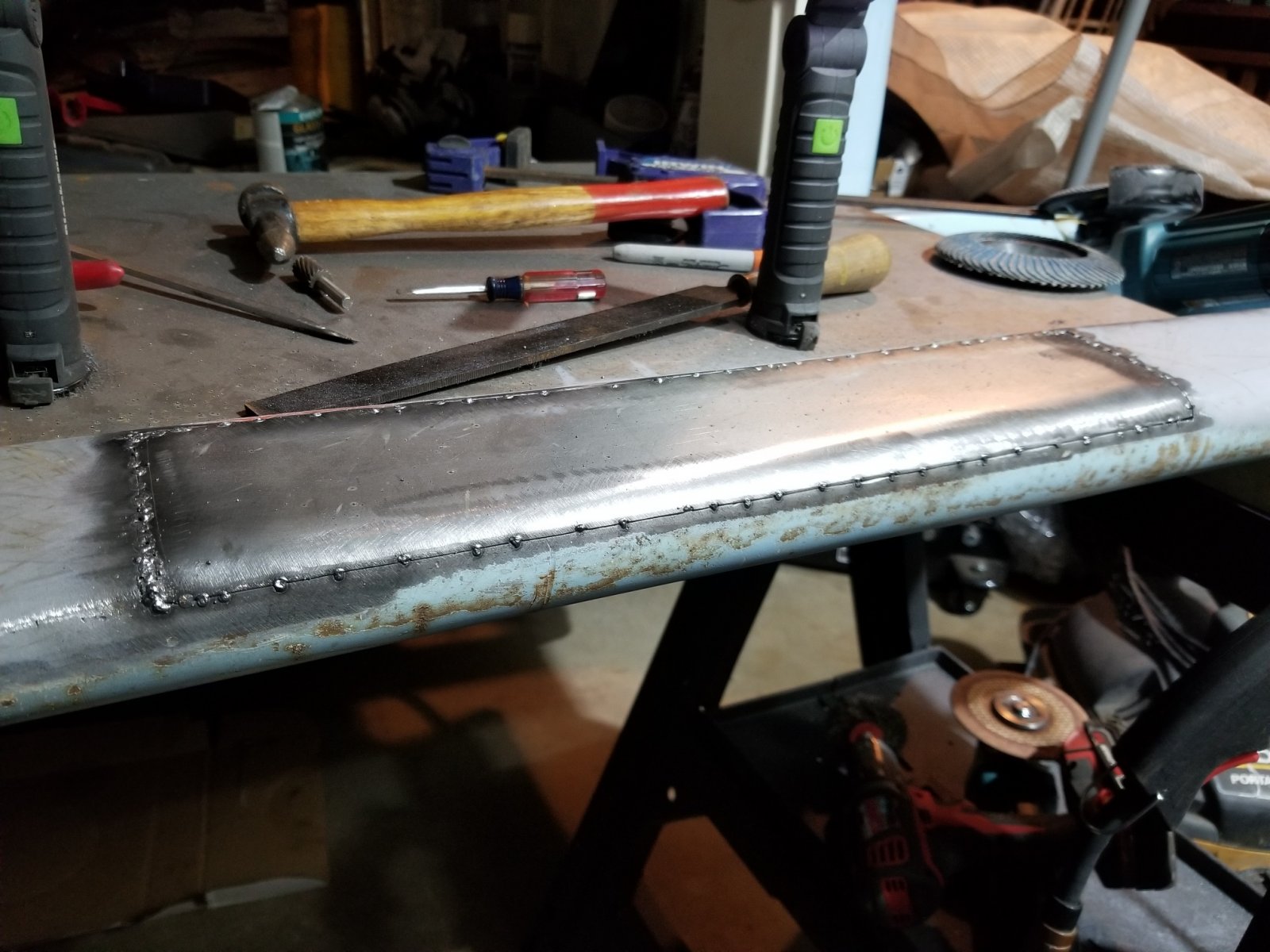

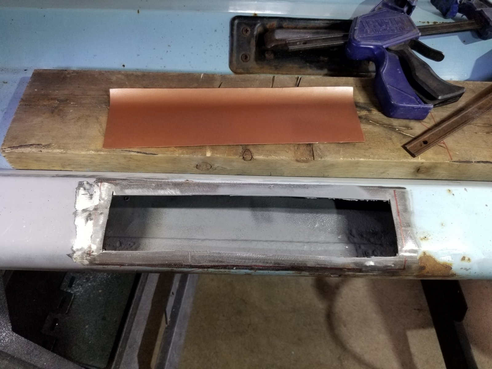

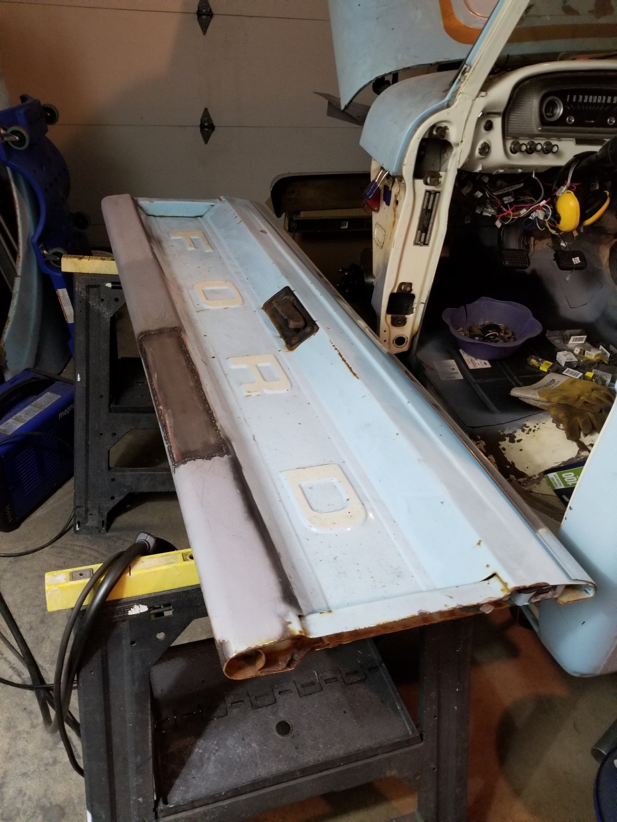

  24. Tailgate almost finished. The whole bottom outside of the tailgate has now been replaced. 5 pieces in total as I can't handle anything longer than about 16" when it needs to have some shape. A 36" sheet metal break is on my wish list. The last patch had 5 holes and 2 dents so elected to just cut it all out and replace the whole piece.
