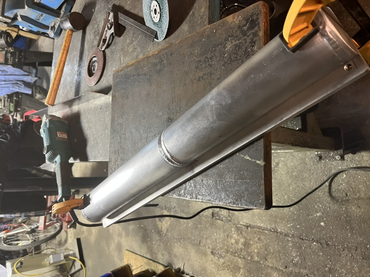

  15. Made end caps and centre divider to hand off tomorrow.

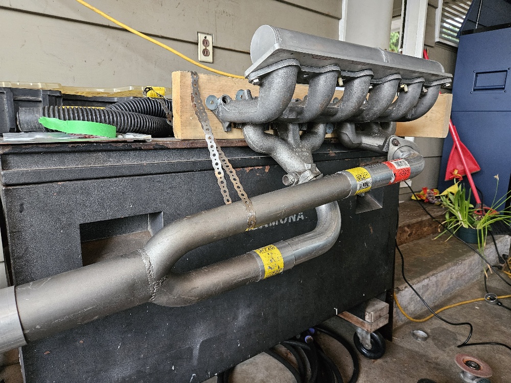

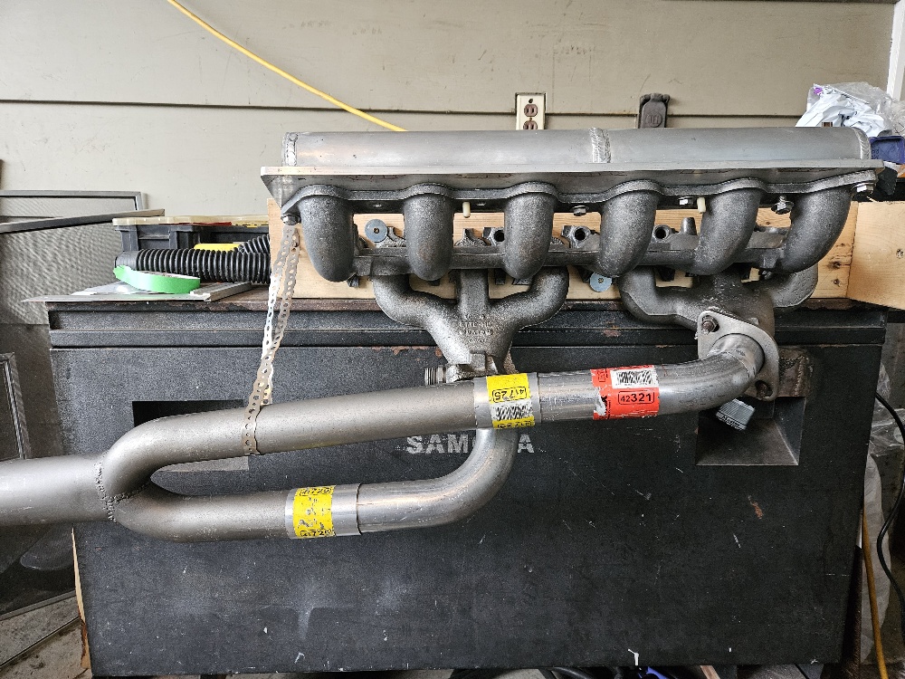

  25. Hoping the intake arrives this week. In the meantime, my daily needs some service work so the F100 needs to be back on the road meaning I can't tear it apart. Mocking up exhaust manifolds to clear the starter then transition to a single 3" pipe. I made the 2 into 1 transition last spring. Mockup today probably took me as long as it will to build. Some sump pump pipe was the only sacrifice. Figure I need either a couple of U's or two 2-1/4" 90's and a couple 45's which was why I did this - to figure out parts. Just need to get it close then I can tack and install then put it together and downtime should be minimal - or at least that's the plan.

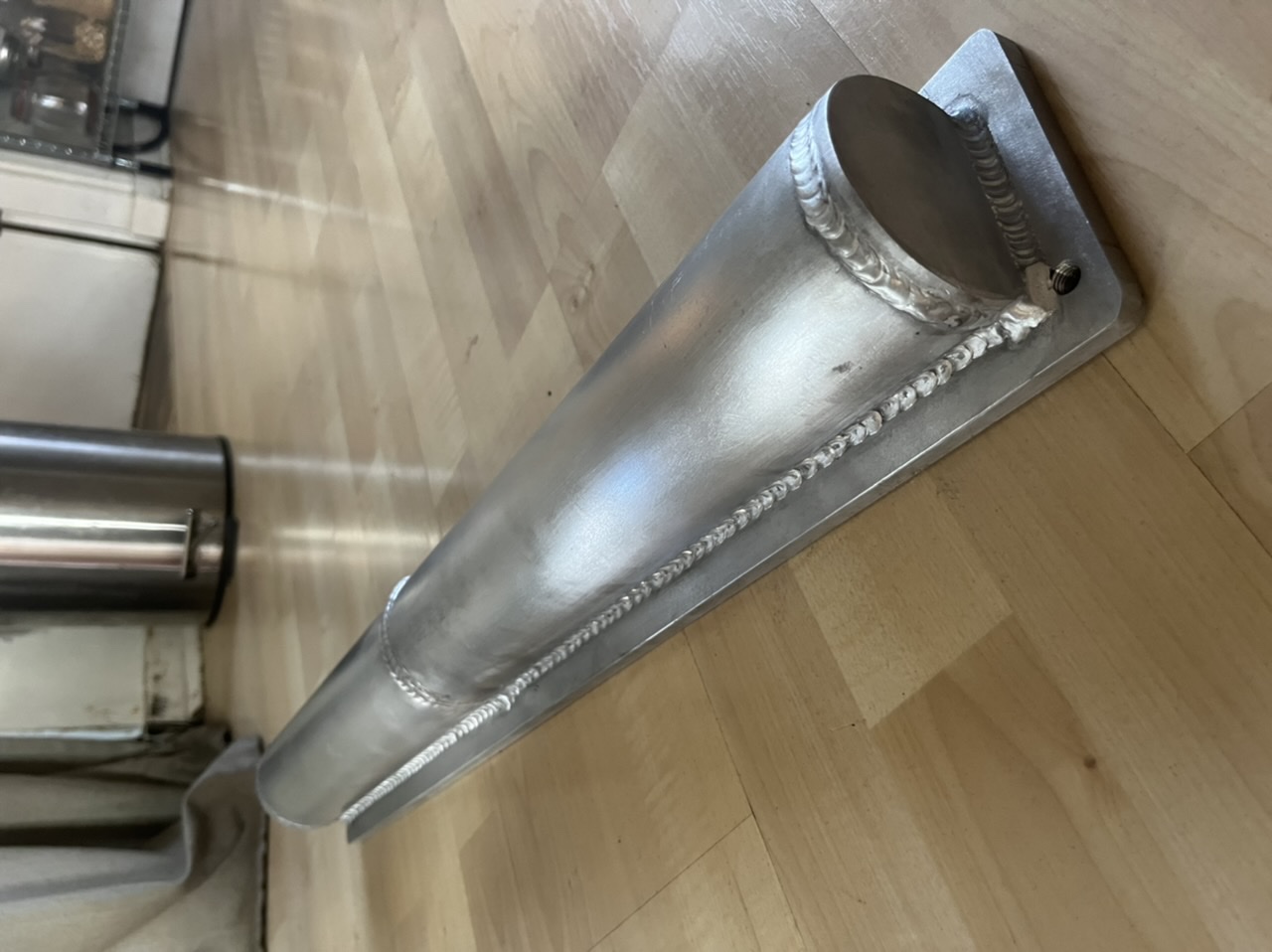

  26. Teaser, not finished yet but, getting there. Hope to have in my hands next week.
    OG lil E likes this.

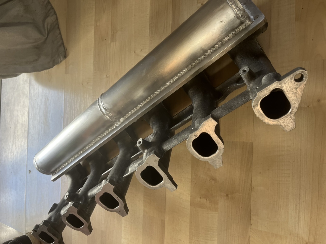

  27. Done for now. Next up - go chat with some local Alt fuel experts about my plan. If I get some thumbs up I'll know what type of mixer/carb to put on then cut mounting plates and give back to the guy who welded it up to complete.
