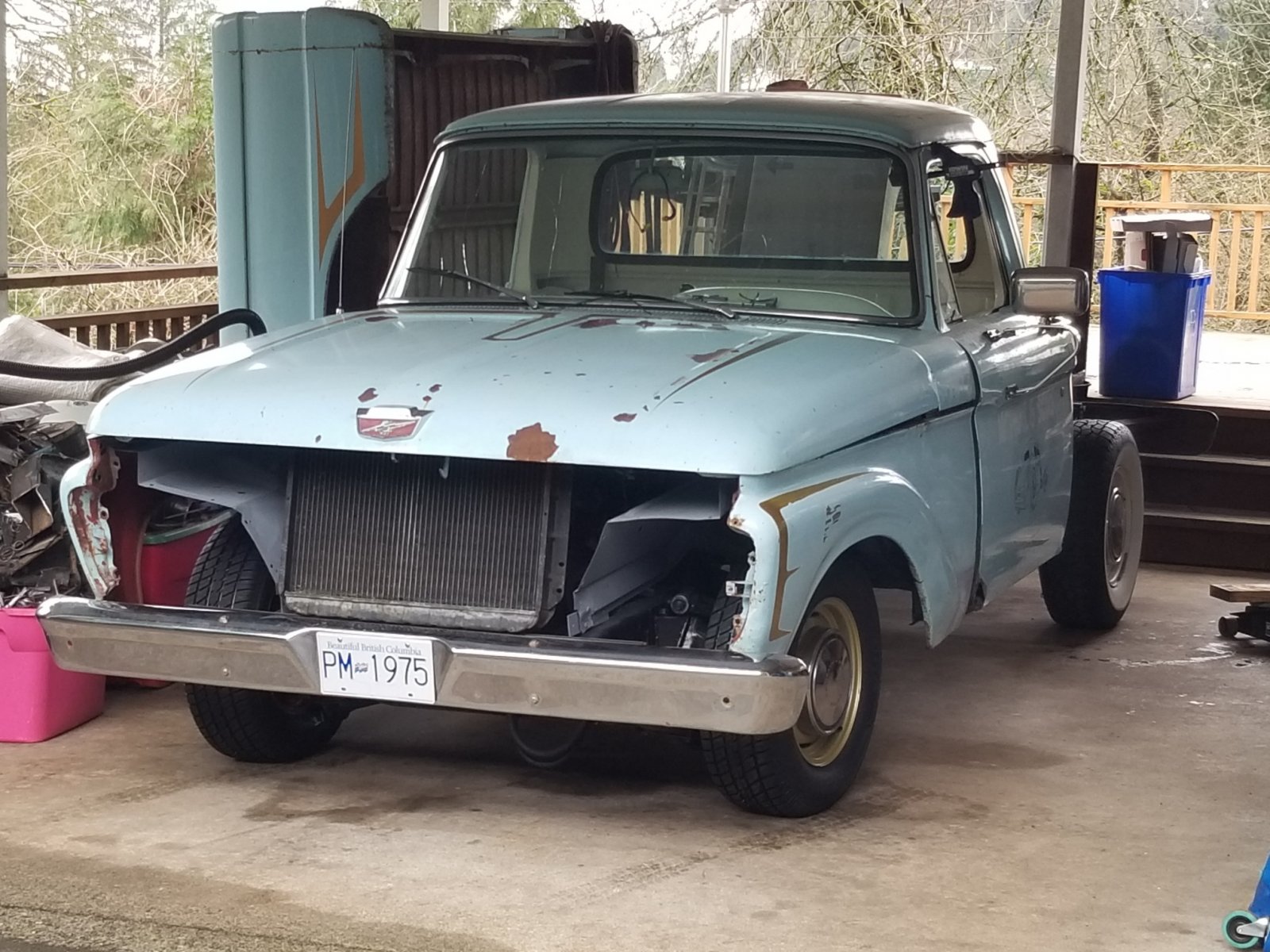

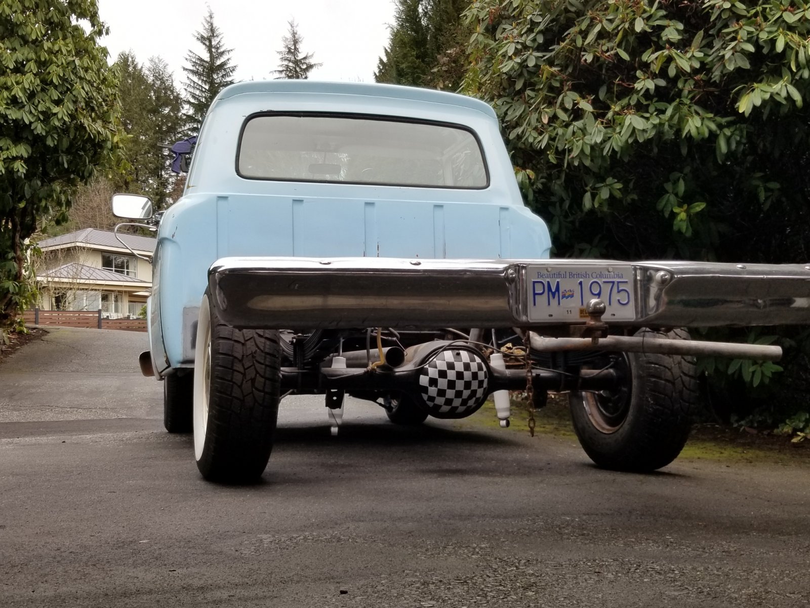

  1. Front tires are 26-1/4" not 27.4" as advertised but, rears are 3/4" less than calculated as well. Top of wheel arch is 28-1/4". Once everything is bolted on maybe we get another 1" of drop. I'll run this setup for a while as there are a couple of options to get the front lower with either a lowered coil or spacers. If it looks like a jack rabbit with the front lowered further to get rid of the tire gap, I'll likely drop the overload leaf from the back to tune final ride height. What do you guys measure out top of arch to the ground stock vs modified? My original twin I beam had cut coils so I don't know the true starting point but, the top of frame rail was 21-5/8 and is now 20-1/8" exactly both sides, making it look like about 3 -1/2" lower than stock? Right now it's 3" lower than I started out back but, I expect another 1" once the box goes on with the fuel tank in the bed. I need to roll it outside to ***ess but, it's been pounding rain all day. Call it a grin day not quite a full toothy smile day. Photo with front white walls was the day of reckoning before I started cutting it all apart.

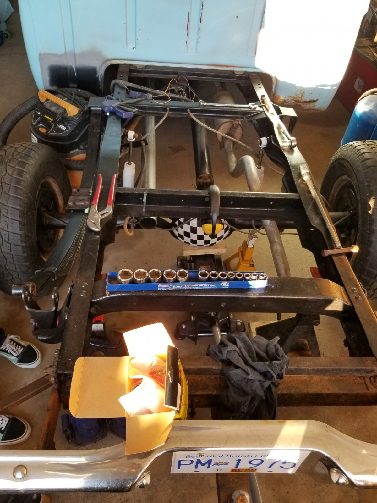

  2. 20220131_170106_resized.jpg And...have to admit this has been bugging me pretty much the whole damn day. How much do fenders weigh, battery, rad support, steering wheel, doors, seat and carpet. I climbed on the front bumper and asked my wife to read the measurement at the wheel well. Dropped an inch with me standing on it. Feeling better!

  4. Rolled out to the driveway for a stand back. Gotta lose 2 more inches up front. Wally the Sheepdog looks away in disapproval.

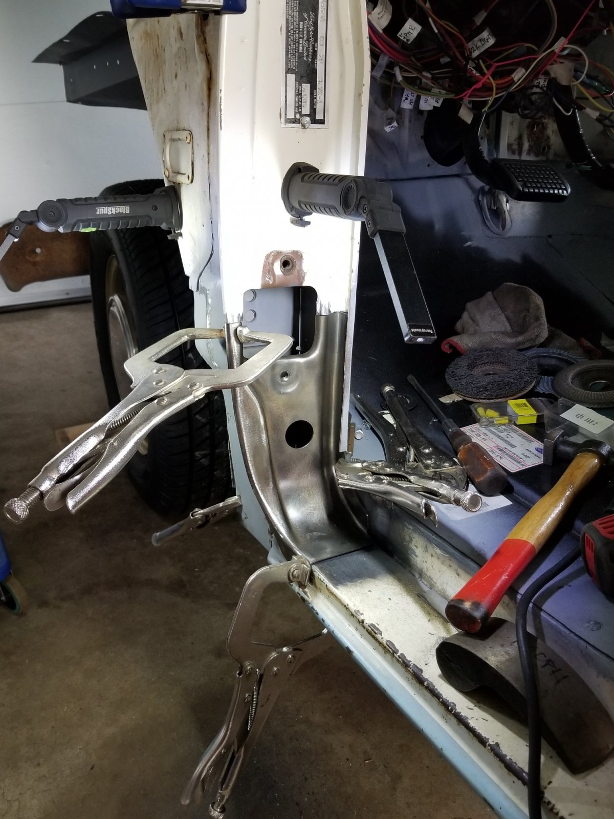

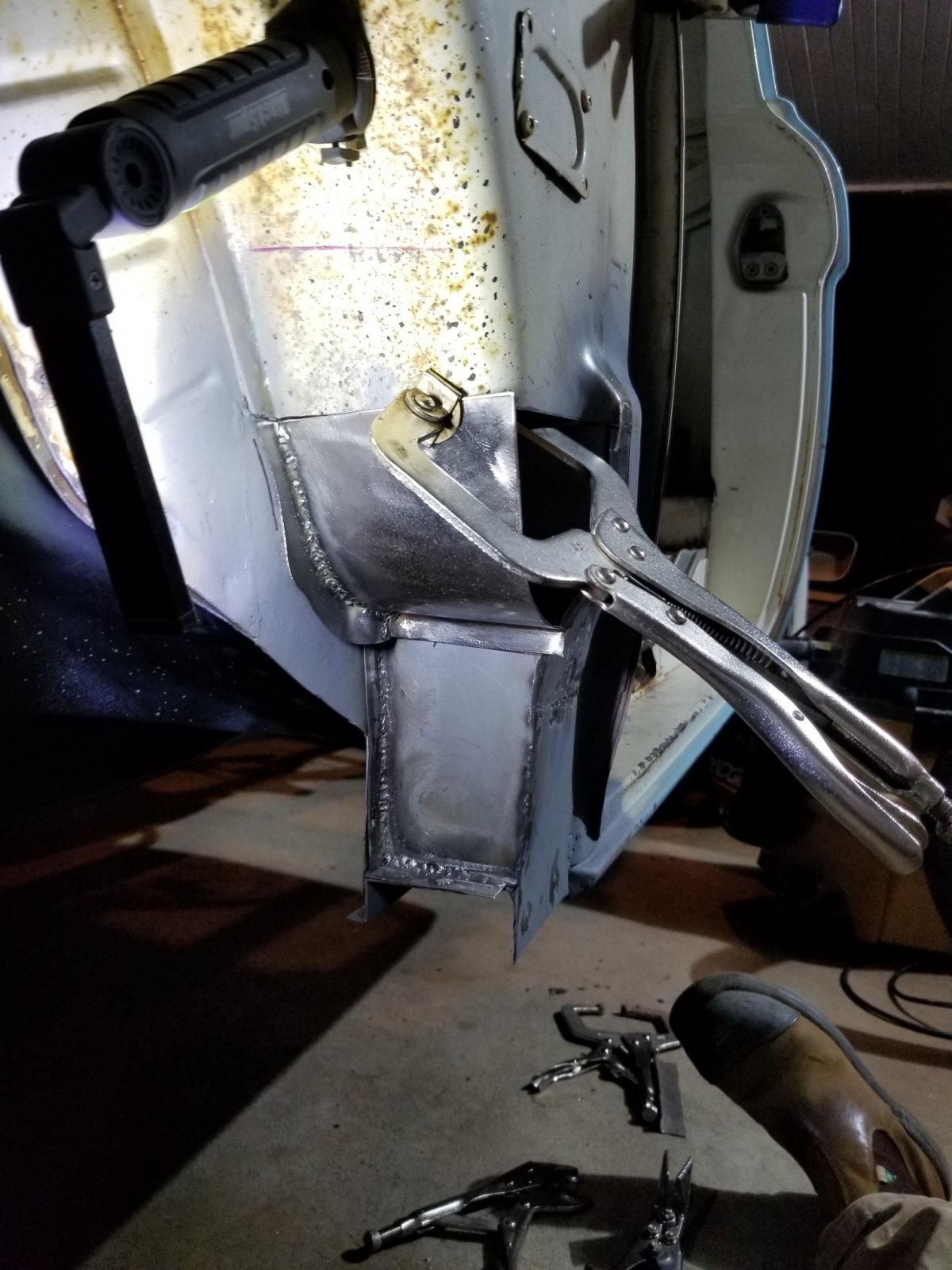

  5. Big cleanup day. Clementine 's coming along but, can't let the homestead take the hit. We pulled out the gear and either blew out swept or vacuumed everything as it was looking tough and it's hard to work on something that's surrounded by a bomb zone. Back at the driver's side A pillar. Will weld everything up tomorrow then grind and prime. Next up is the p***enger side rear cab corner. My young guy worked at helping me clean up including using one shop vac to clean the other shop vac. He worked the die grinder to open up the holes for the rear U bolt perches so we could replace old with new. 20220205_155951_resized.jpg

  9. Both kids were off working today so thought I would put in a shift. Didn't quite get the driver's A pillar done as it is curvy, tight and frustrating. Did the p***enger side complete in a day, this one not so much, I think this one will look better - Ebb and flow. Started to change out leaf spring bushings yesterday. Got OEM rubber versions but, they came in too big. Rather than replace them I went with poly versions. Putting the kids on this task.

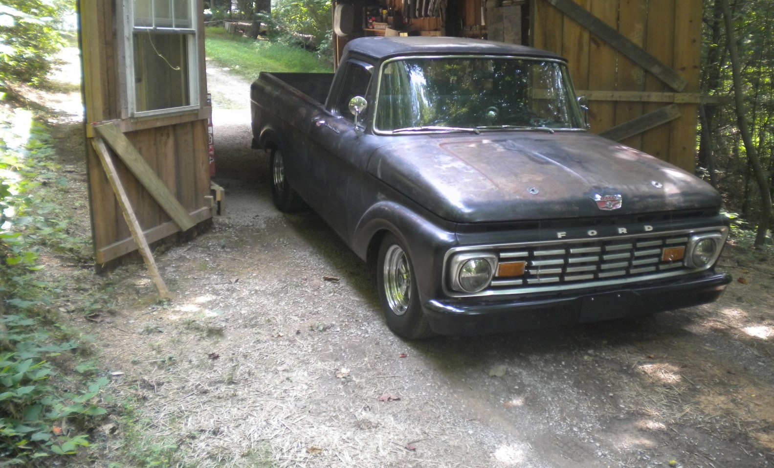

  13. Callmaker
    Joined: Feb 17, 2020
    Posts: 170
    Callmaker
    No, it's a uni. I have 15x8 wheel on the front with a 235/75 tire and they scrub just a bit when deep turning.
      410.6 KB
      162
  14. Love those Uni's - nice truck. I had 235/75's on the front to start with. The I beam was wide and it looked like if I dropped it hard they would rub. Looking at your truck confirms I have to get rid of my dent side mirrors. More work!

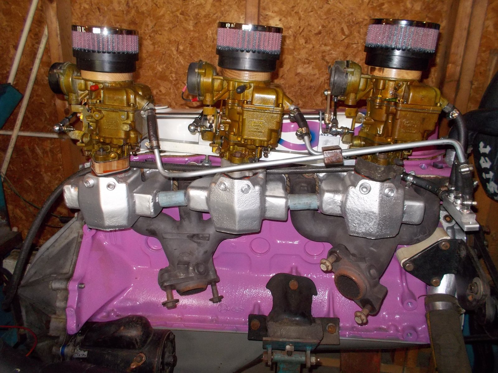

    If you visit the fordsix.com website you will notice there are low cost options for an intake manifold you can make.
    One is a tri-power from three stock 1V intakes. Another is a multi carb intake made using the lower half of an EFI intake. While the EFI lower half may be O/T it is no less appropriate than a T5 transmission.

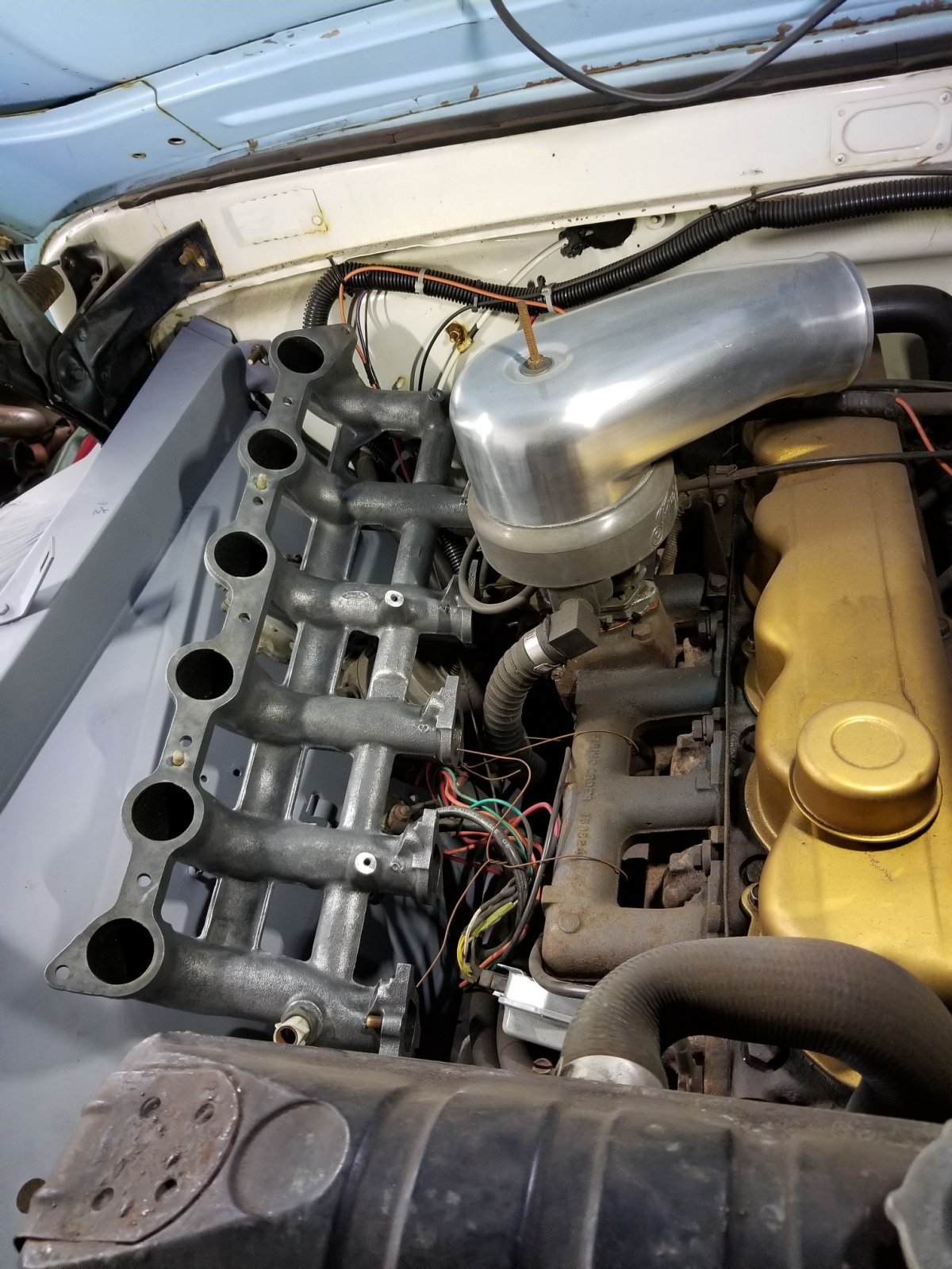

  21. Spending a bit too much time researching intake manifolds. Danger. Now have visions of building one.
    warhorseracing, catdad49 and MRW1994 like this.

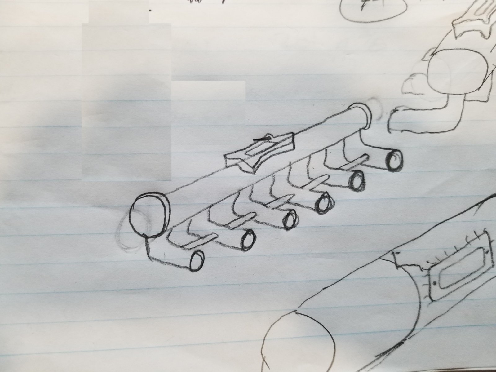

  22. So it's settled, I'm building an intake manifold given none are available. With some helpful photos from FTF and research on fordsix.com I'll build something along the lines of the following. I chatted with a fellow who can weld aluminum so just need to pull it together, fab it and hand it off for welding at some point. Not exactly on a ****tail napkin but, not far off. Will make it look like something early industrial era to mix in with the theme.

    We knocked off the driver's A pillar today. My kid said to me a couple of times, shouldn't we try to get this thing flush - the wisdom of babes. He is going to turn down 2 of the oversized poly bushings for the rear leaf springs this week in wood shop. Once that's done we can install then turn the truck around and get the p***enger rear cab corner done.

  24. 2-1/2 hrs of messing this morning and I got 2 more bushings out - I hate leafspring bushings. I looked at Caltrack traction bars and I see they would use a solid bushing installed in the front - not sure I want to go through this again. Will see as this thing has displayed some epic wheel hop.

  28. Fighting to keep my/our focus specifically on the body and specific tasks to get Clementine back up and running then will allow distractions to run amuck. Need to convert this mess into a carbed intake. Kind of raring to get going on this thing to see what we come up with

  30. Thanks very much. Just like a little kid - I couldn't stop myself. Hard to imagine this not being an improvement. The injector ports are not threaded. Need to come up with an idea to plug them.
