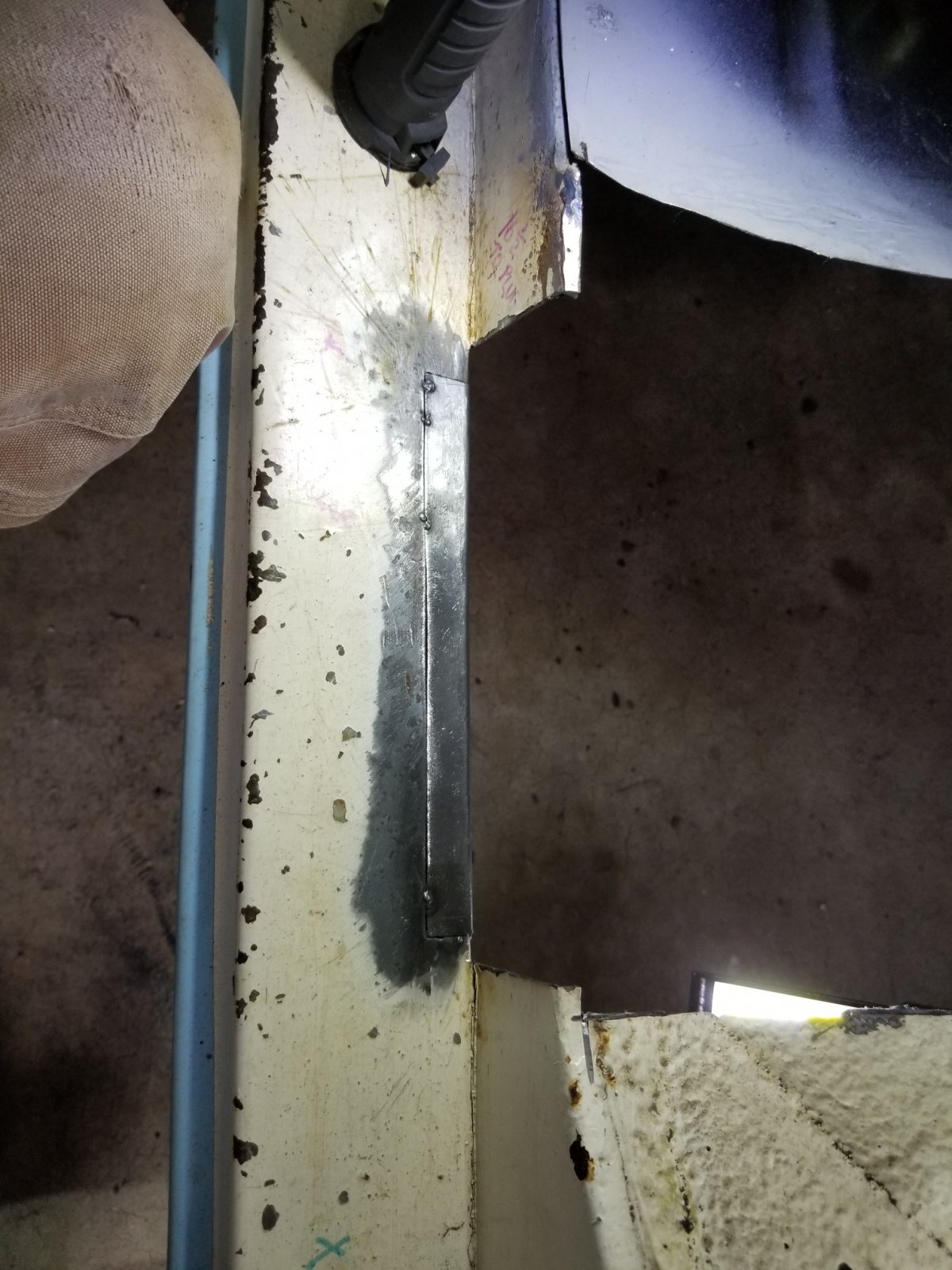

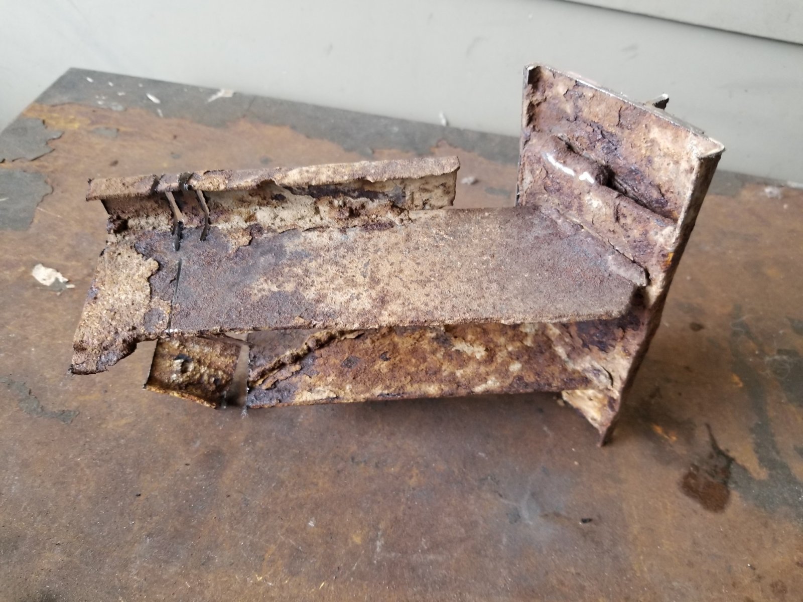

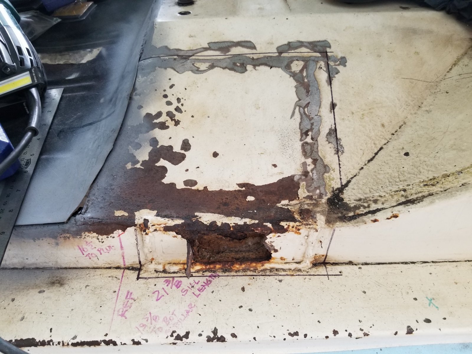

  3. Enough playing around with cool engine parts, back to the salt mines. At the risk of boring everyone with rust repair, this is partly for me and my kids to look back on. When something is bad on this truck you know there is another layer. Rusted original metal with rusted **** scabbed over it so removal and cleanup is more challenging. So, floor comes off and the sill support was so toast with 1/8" steel strapping scabbed over it, I had to look up what it should even look like. You can buy the supports but, another $100 in parts plus shipping and lead time, we'll just make them. Ran out of wire or I'd have more to show for the day. Roll #4.

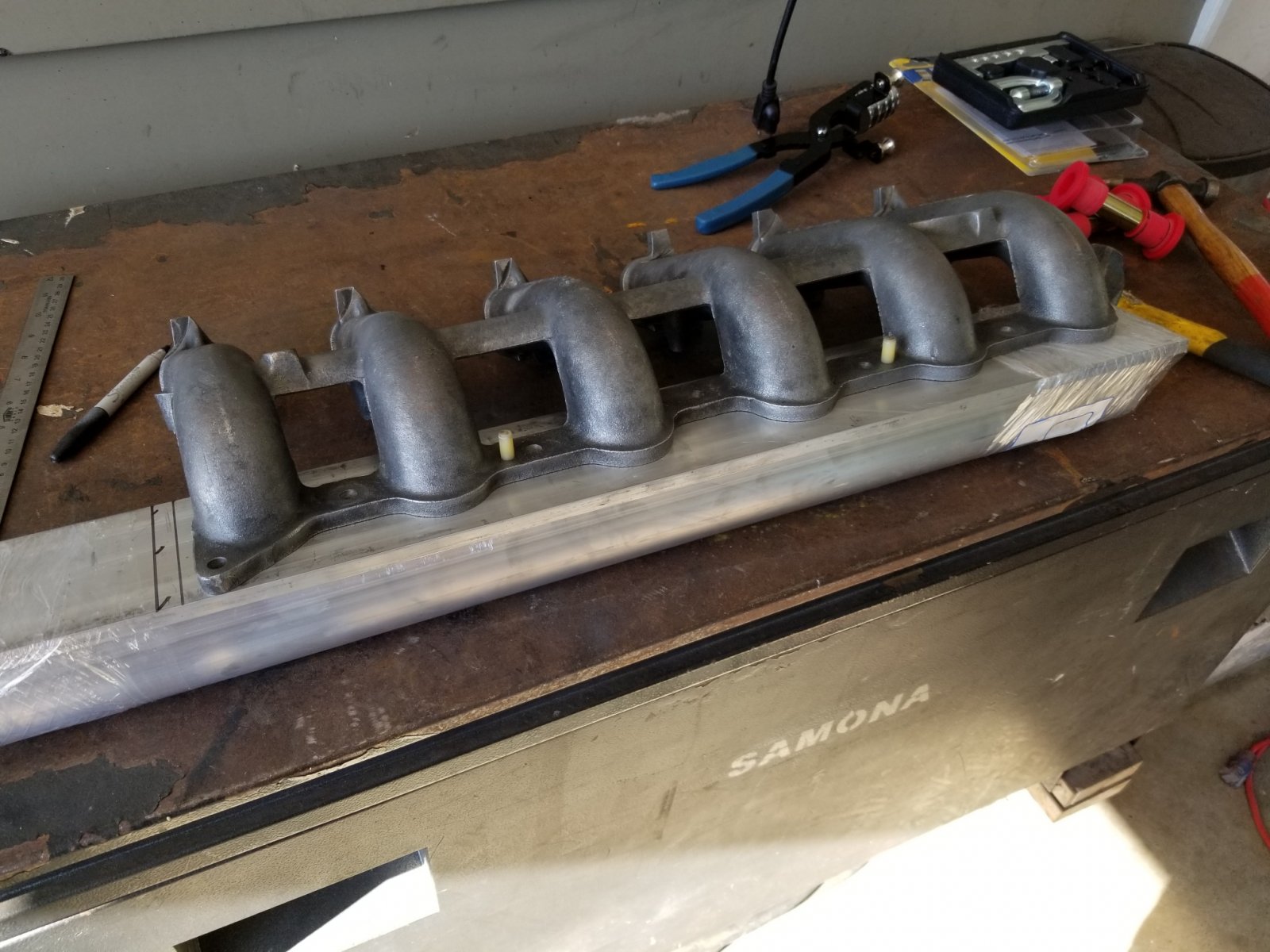

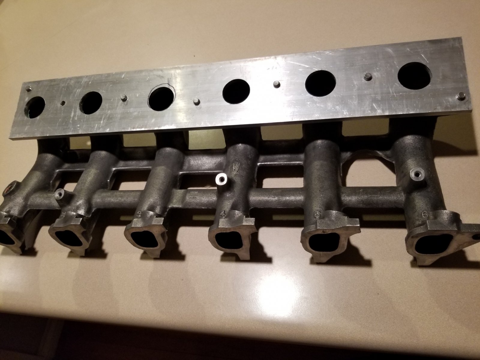

  12. 20220305_223346.jpg 1646549062967100011466111066712.jpg Intake manifold layout. Have several designs emerging in my head for the mounting plate but, think the best plan is a 4" wide plate with thick wall pipe welded on. Cut a flat portion of the pipe to weld to the plate after. The end caps will be round so the end won't look like a flat tire when you look at it from the front of the truck.

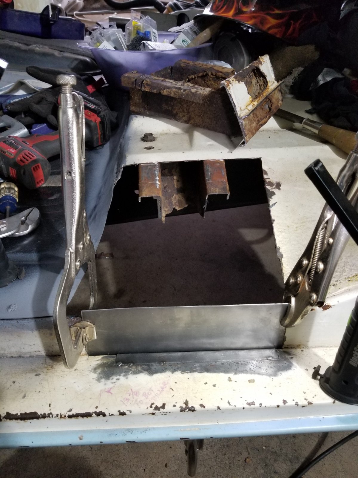

  13. Help please. Because of all the funky previous work I have lost reference bends and the patch panel floor is pretty vague with a curious curved edge. I'll put carpet in eventually but, it would be nice to get the bends in the right place so the carpet fits. Can someone look at their floor and tell me which line I should hit. The one I made at the panel edge or the one at the inner bend? A photo would work. Should it be straight with the raised seat floor profile or should it hit the corner of the raised seat then vector forward to the front.

  16. Got the bend info for the floor. Thanks to Mike Lawless!

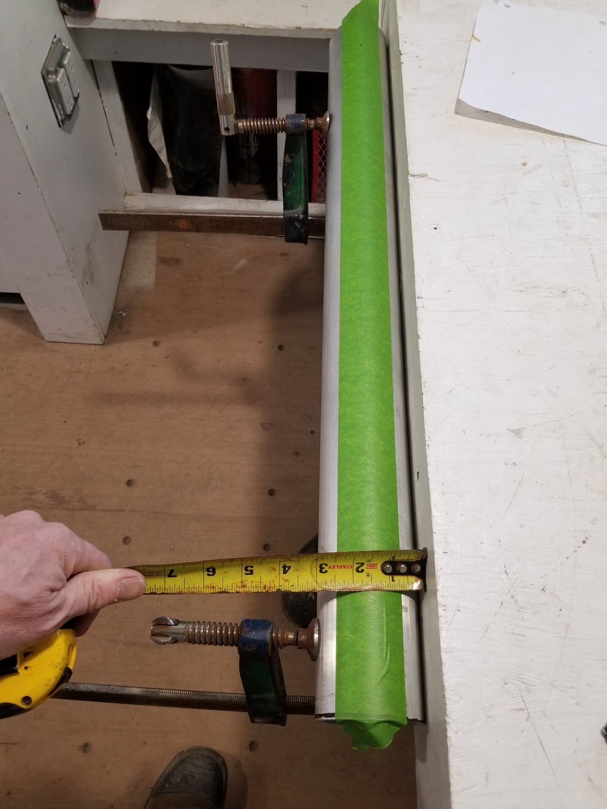

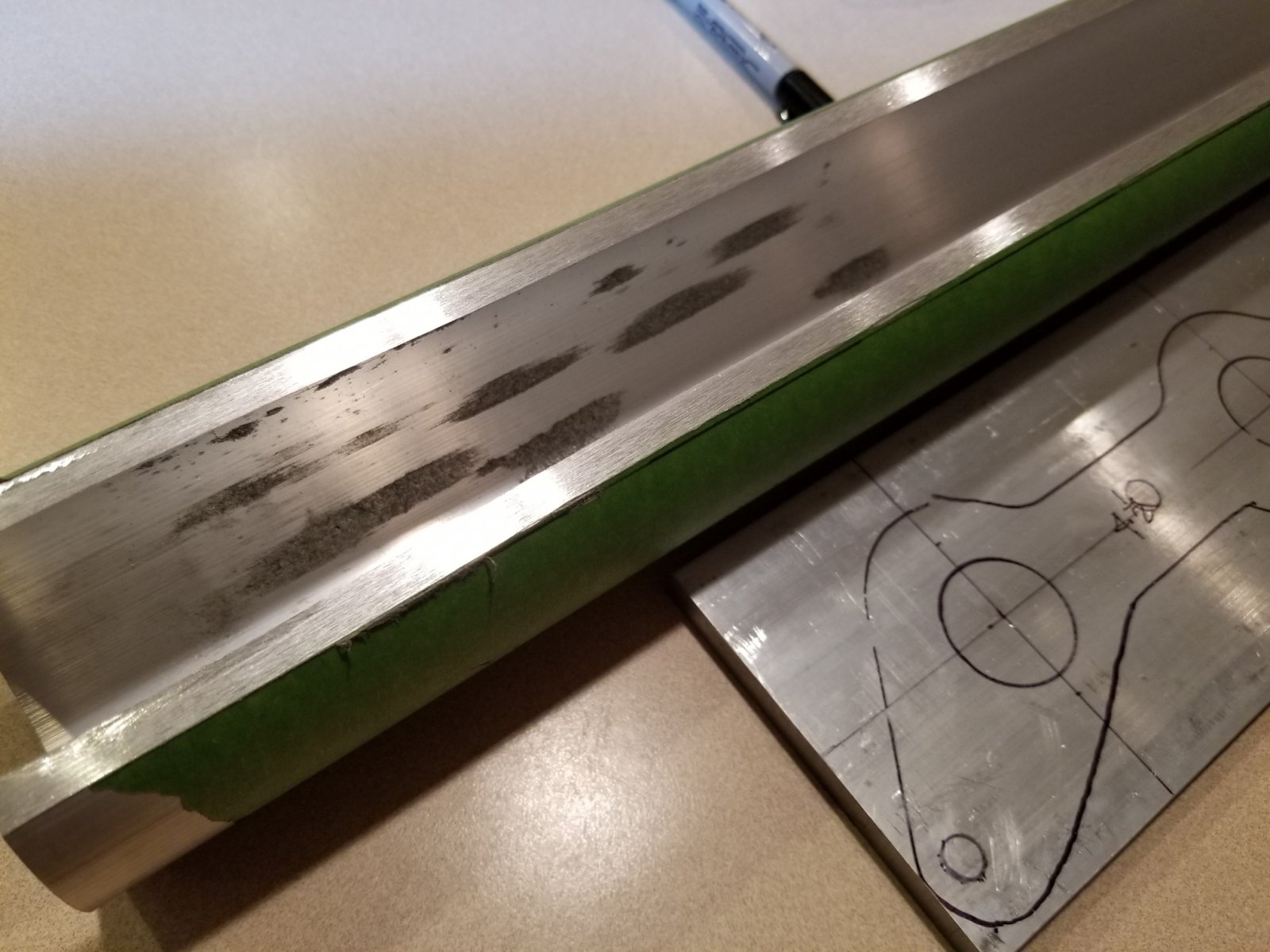

  17. At the risk of slow playing this manifold I took a few minutes today and layed out the tube cut. Marked the centre line to avoid Barber poling the line using tried and trued carpenter methods then realized (hockey anology) I'm on a breakaway and I left my wingers behind. Will wait for them then dig into how I will make the cuts using a pinch jig etc. Gotta show my dudes how to do this. Photo with tube standing upright. The cut line is the outer shorter line. I'll sand to the 2nd line to get it flat and sized correctly.

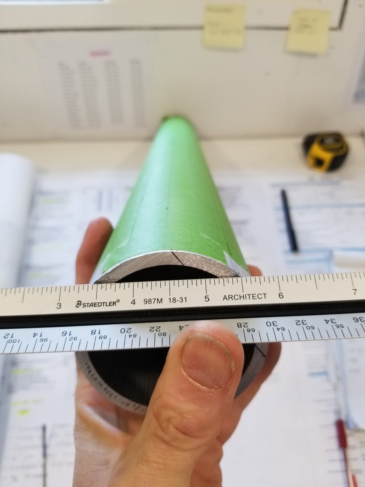

    Calculated the intake volume of our intake design using 2-7/8" O.D. pipe and got 235 ci. for the intake plenum volume including the lower efi volume (loose numbers). 300 ci eng x 0.75 = 225 ci. target ratio for normally aspirated motors. If I have the 240ci motor I would be at 0.979. If one were to push some atmosphere at one of these motors I've read you could go up to 1.5 for intake volume ratio over engine displacement. Think the volume I'm at should be fine. If I want more or less volume I can make another upper intake - very flexy.

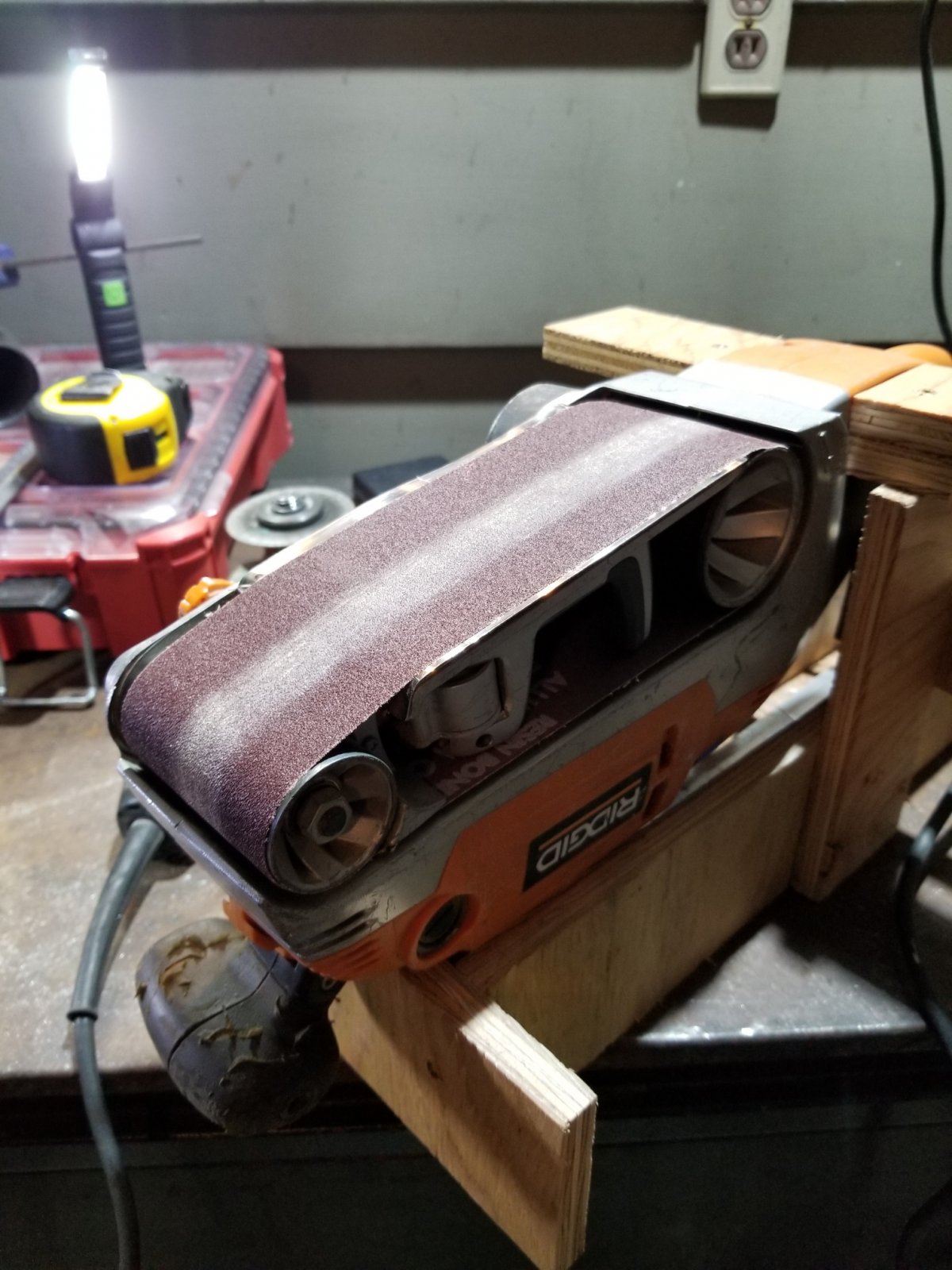

  21. 20220312_125359_resized.jpg 20220312_125849_resized.jpg Carpenters milling machine/pinch jig with adjustable guide, and yes, I amuse myself sometimes.

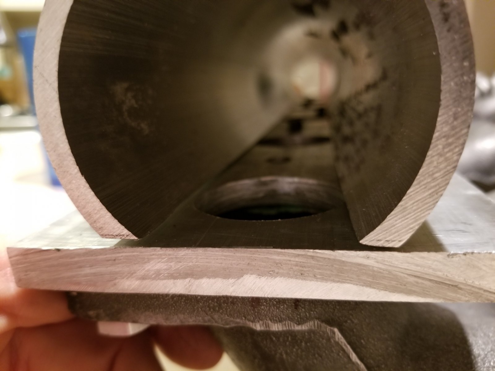

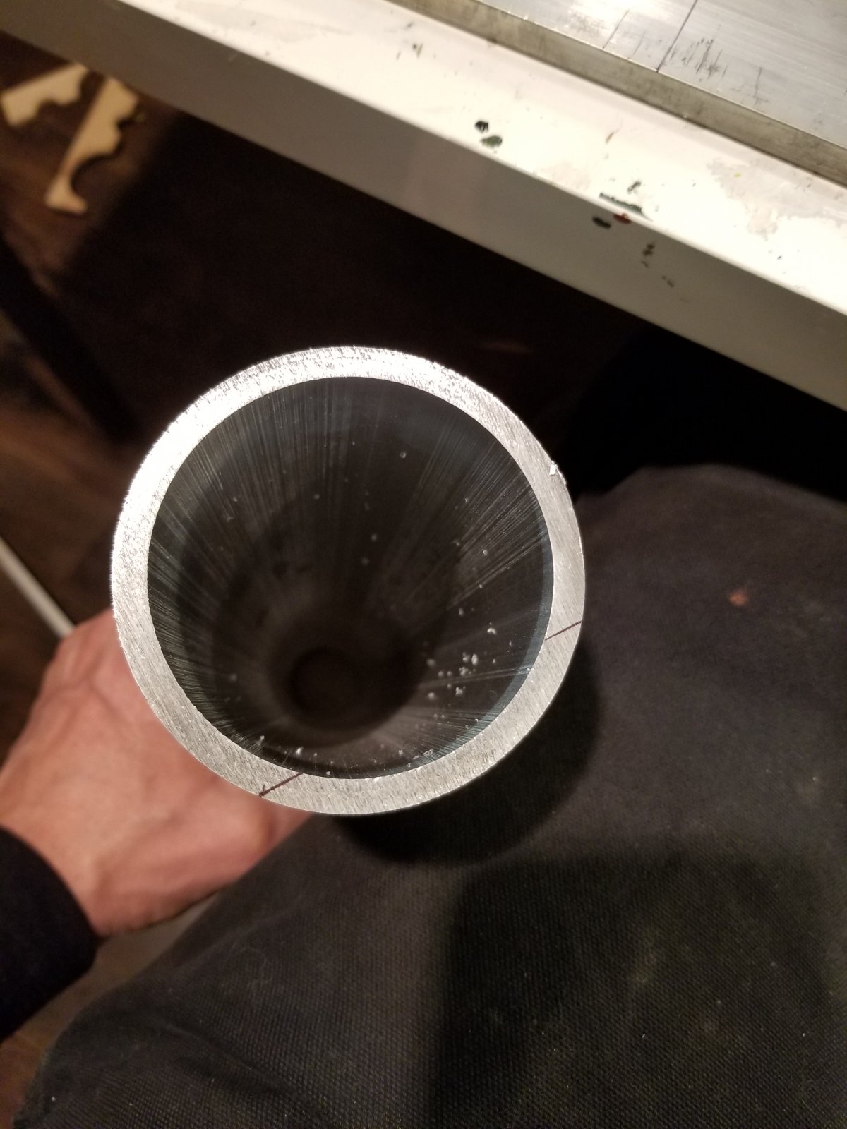

  22. 20220312_171033_resized.jpg 20220312_194121_resized.jpg 20220312_202853_resized.jpg 20220312_202957_resized.jpg More errands today so didn't quite get the tube done. Little more fine tuning needed as it has an ever so slight amount of barber poling in it. Deliberately working a longer piece so I can cut it to length after mockup based on best fit. I like how it's coming together. I'll wait until it's mounted on the engine to cut and fit the carb mounting plate. Note the holding cleats for the belt sander, mounted to my holding jig. Normally when you scribe something you clamp your sander on it's back and a minute later you're up and running - no need for the exotic holder. Guess I've done that too many times because first squeeze of the trigger clamp I broke the handle off the sander. Makita belt sanders by comparison are dead flat on the back so they are tailer made for this but, of course that one is on a site. Not so much this sander - not sure why I would have even bought it but, it's working now. Free wood working advise!

  25. Thanks, cut came out acceptable. A milling machine would have been so much quicker and precision would have been better but, I can live with it.
    Moratorium on rust repair today. Gets a bit old so to keep it fresh I spent the day on the intake. If I miss the deadline by a day I'll know where it was spent. Kind of blew port #3. Was getting tired and I missed my mark on the centre line, like a slow motion mistake. Will evaluate after blending and if I need a weld bead to fill back in I can get that done. I needed 7 stainless steel bolts, the supplier had 6. I'll use washers so bolts will essentially be flush to the plate. I can grind them flat if I need to.

    Did you take the tube down with only the belt sander? That seems like a lot of work! I have used tablesaws and routers with carbide blades/bits with great success. I recently heard that if you soap the sandpaper (with bar soap) it helps reduce clogging. I haven’t tested this yet.

  27. Thanks @brEad. I cut the tube first with an AL disk on a grinder using my hi-tech plywood milling machine with the adjustable guide. I touched up a bump with a flapper on a grinder then belted it to flat. Wasn't much sanding, maybe 40 minutes with 60 grit and that was more tuning to get it flat - no clogging. Hand drilled and tapped bolt holes. I spent more time waiting for batteries to charge than actual drilling. Clearanced three holes in the lower intake to allow bolt holes to line up but, otherwise fairly smooth. I used an 1 1/2 hole saw for the ports to allow for some misalignment then will die grind to port match. Plan is to tack together, mount, then cut for carb mount. Will bolt it to the lower intake for finish welding to avoid warping. For anyone considering a similar project, Aluminum makes it easy, I give it 2 out of 3 wrenches on the difficulty scale. Nothing hard just precision.
