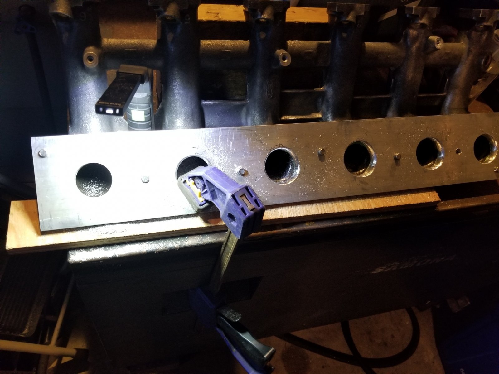

  5. So while on holidays this past week I spent some time with the ford six world. It turns out I likely have a 240ci engine. Researching Schneider Cams for what bumpstick to get. Plan is to do some port and polish work on the head and sleeve the intake and exhaust valves when they get upsized just in case they are not done as our show runs on propane. Hoping to get the engine to run hard after we get the rust repair done and bolted back together. Plans are already getting hatched for the Phase 2 and Phase 3 part of the build. Full sized photos are posted - bigger job than I thought.

  6. Ok, now this is time consuming. At least it's aluminum. Already starting to dread the port and polish I'm planning on the head.

  7. Not quite finished but, port grinding to match intake to runners took about 3 hours for all 6 ports. Low speed grinding as opposed to high speed because high speed clogs up the carbide cutter. I still need to step down to a roll to sand nice and smooth so the journey isn't over yet. Back to rust repair tomorrow - fun.

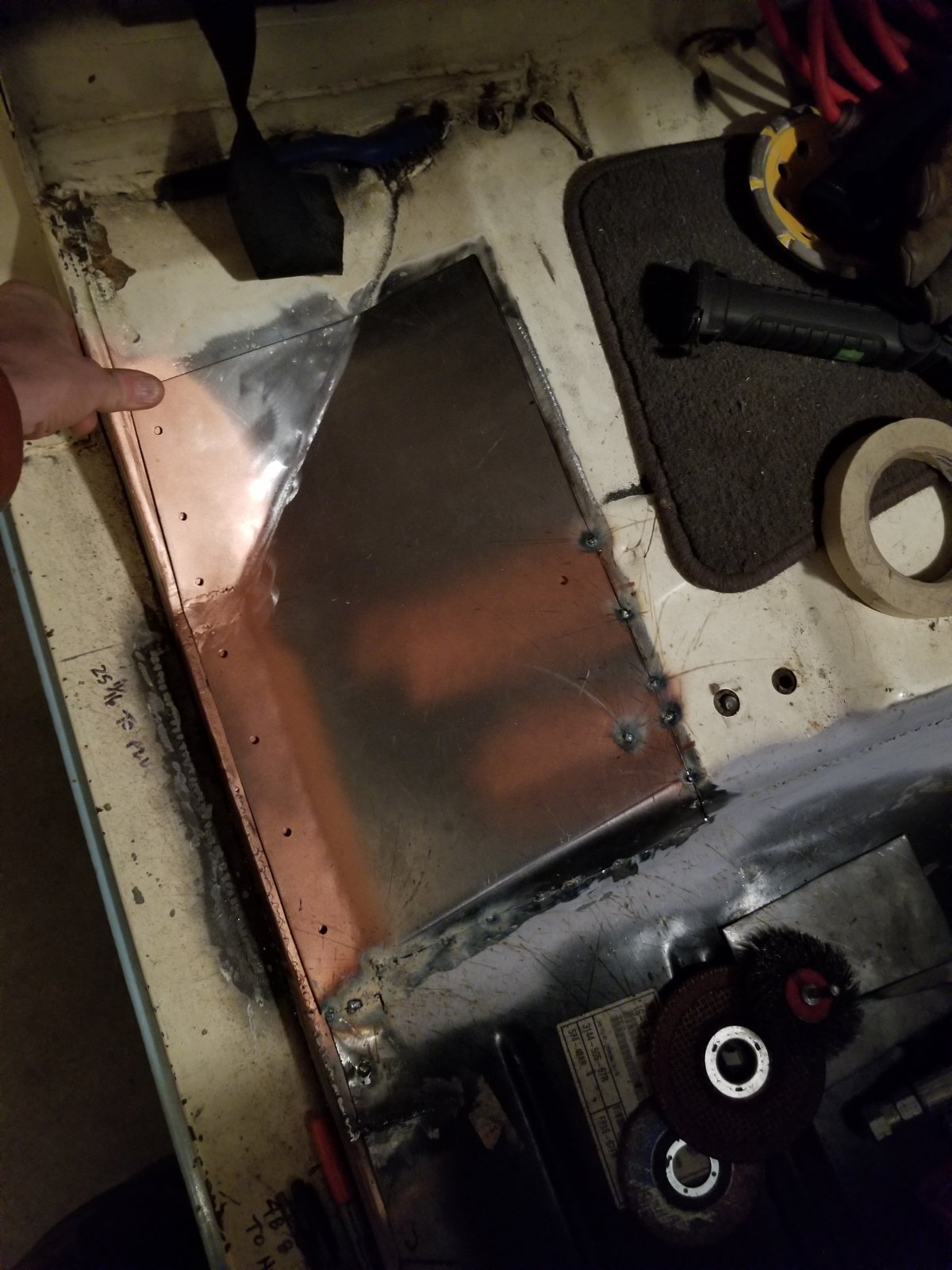

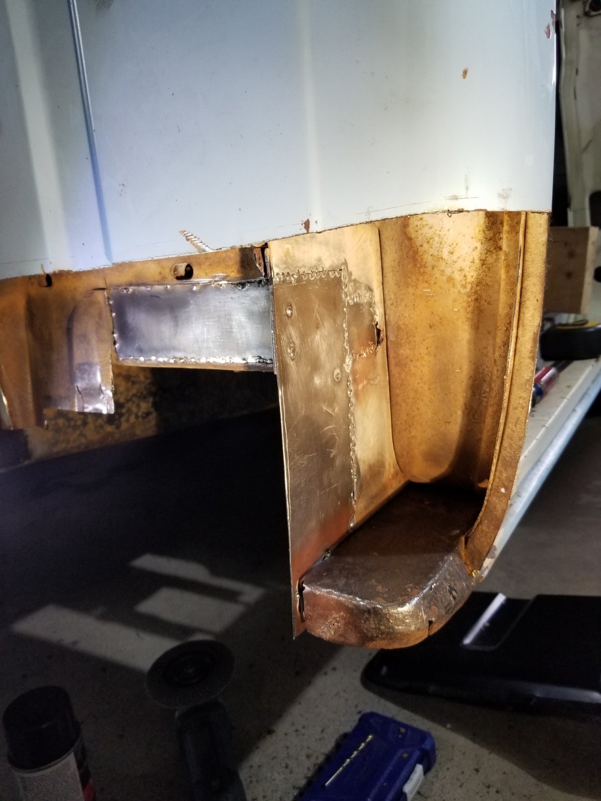

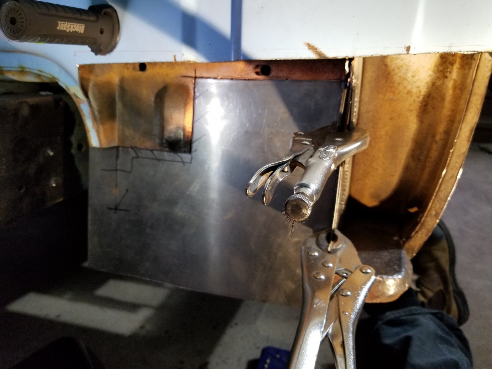

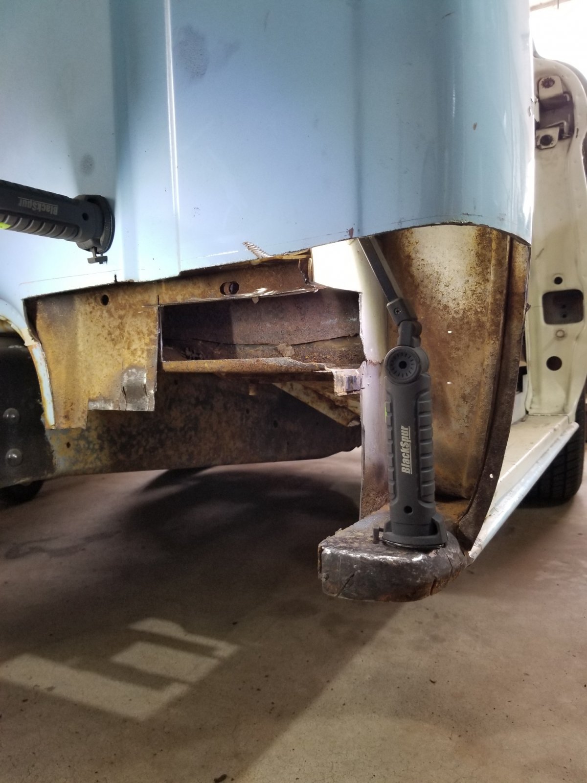

  8. Will it ever end! The most difficult panels to make are those that need to be replaced! 18 separate pieces on this side of the cab alone. Still need to do the cab sill support under this last patch but, I'm eying the calender. Moving on, I can add it when the cab goes on it's back.

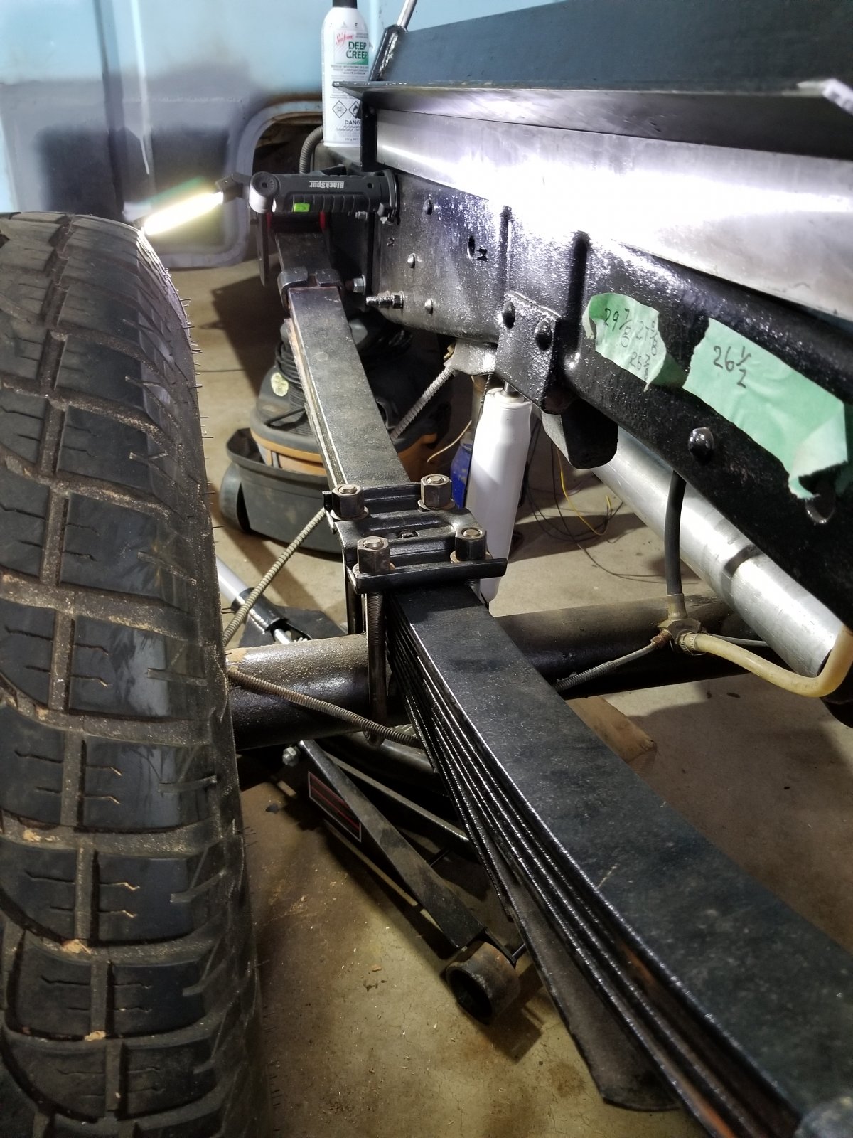

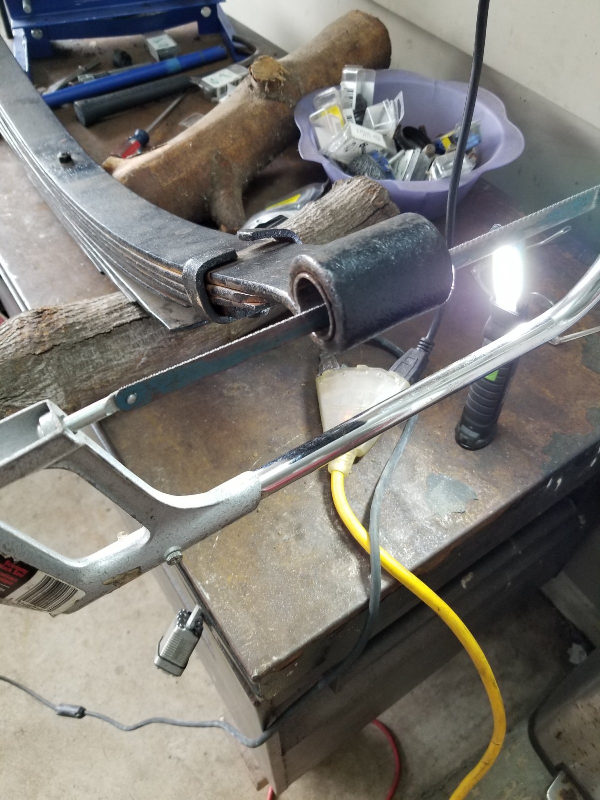

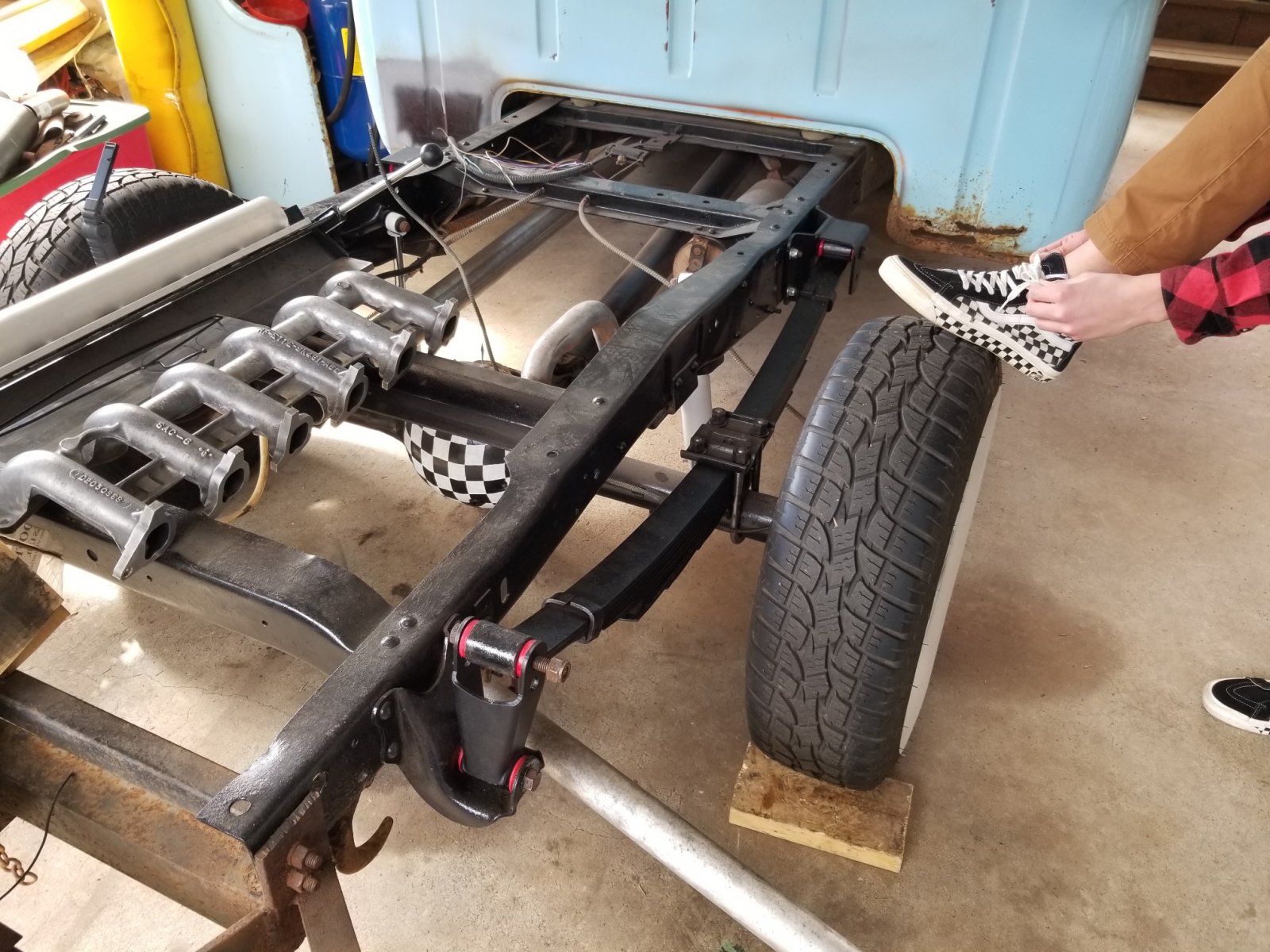

  9. Have I mentioned how much I hate @#*#!! leaf spring bushings? Forgot I had one to go, which I need to have done to drop the truck, roll out and turn around for the last round of metal work on the p***enger side. Drilled out my DJM drop brackets for 5/8" bolts. Tackled the one bushing with a vengeance which has turned into an all day'r. Like all hi-end shows, the use of firewood is vital.
    20220327_160021_resized.jpg 20220327_160242_resized.jpg 20220327_164321_resized.jpg 20220327_151405_resized.jpg
    brEad and MRW1994 like this.
    Nothing can withstand 120 megahits with a 3lbs. mini sluggo - goodbye bushing. Back on all 4's again. Have to get new brake lines and make it all new and fresh this up coming week. Lots to move around on the driver's side to make room for steering linkage etc. It all looks like a haphazard unplanned mess.

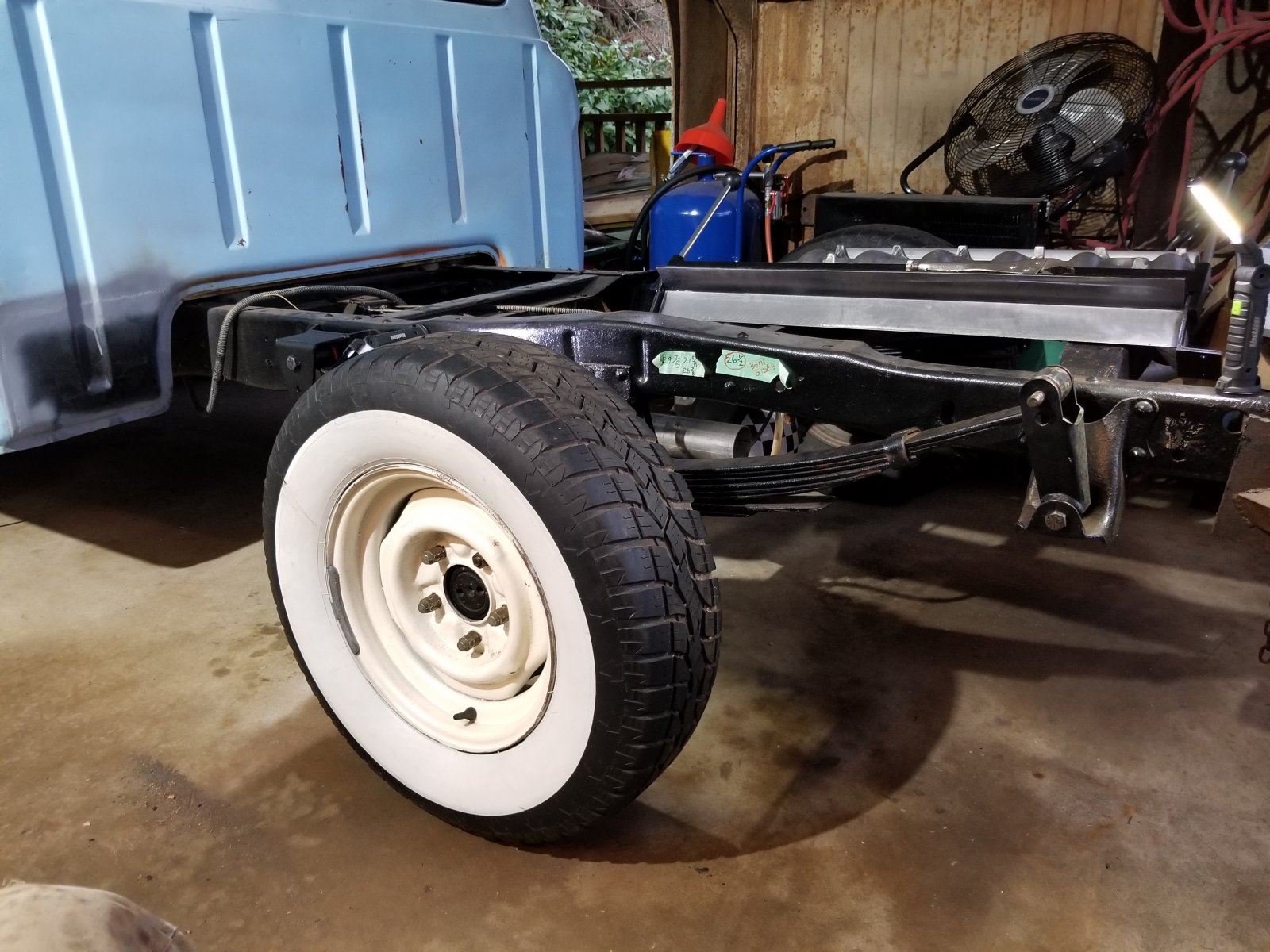

  19. It takes 3 of us to turn this rocket around. My guys jumped up on the back so I could see what it looked like slammed another 1/2".

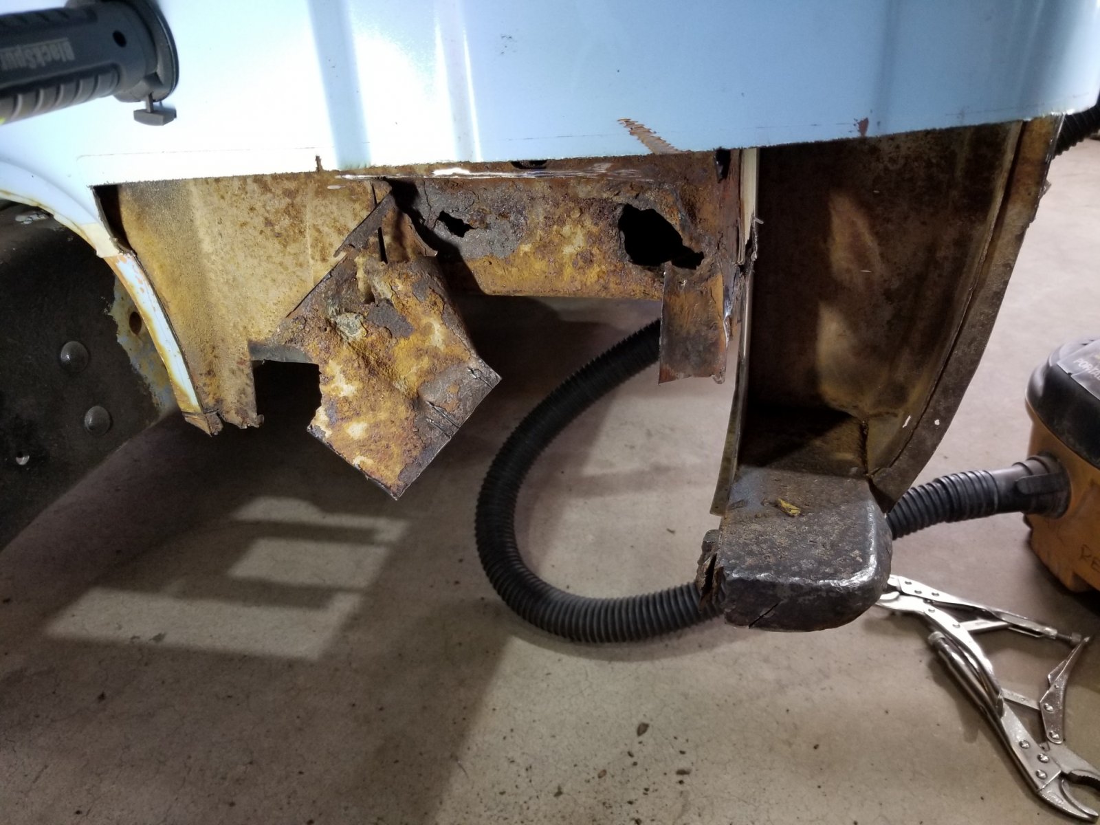

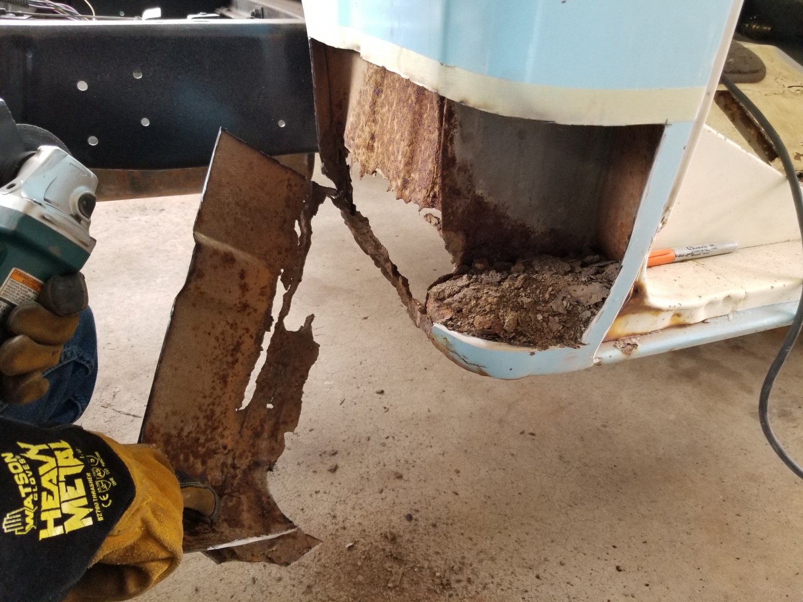

  20. So I figured driver's sides are always worse and that I would knock the corner of the cab off in a weekend. This side was way worse. Due to confined space and fiddly pieces I still couldn't quite get in there. Listening to my inner truck whisperer, I had difficulty but, ended up having to leave a little bit of bad in there due to access issues. Welds are questionable for the hole patching as there was still some rust and the tacks wouldn't grab. In the end it's solid and better. Made the last piece so I may end up pulling some shifts mid week now that we have some daylight at the end of the day and get it welded in.

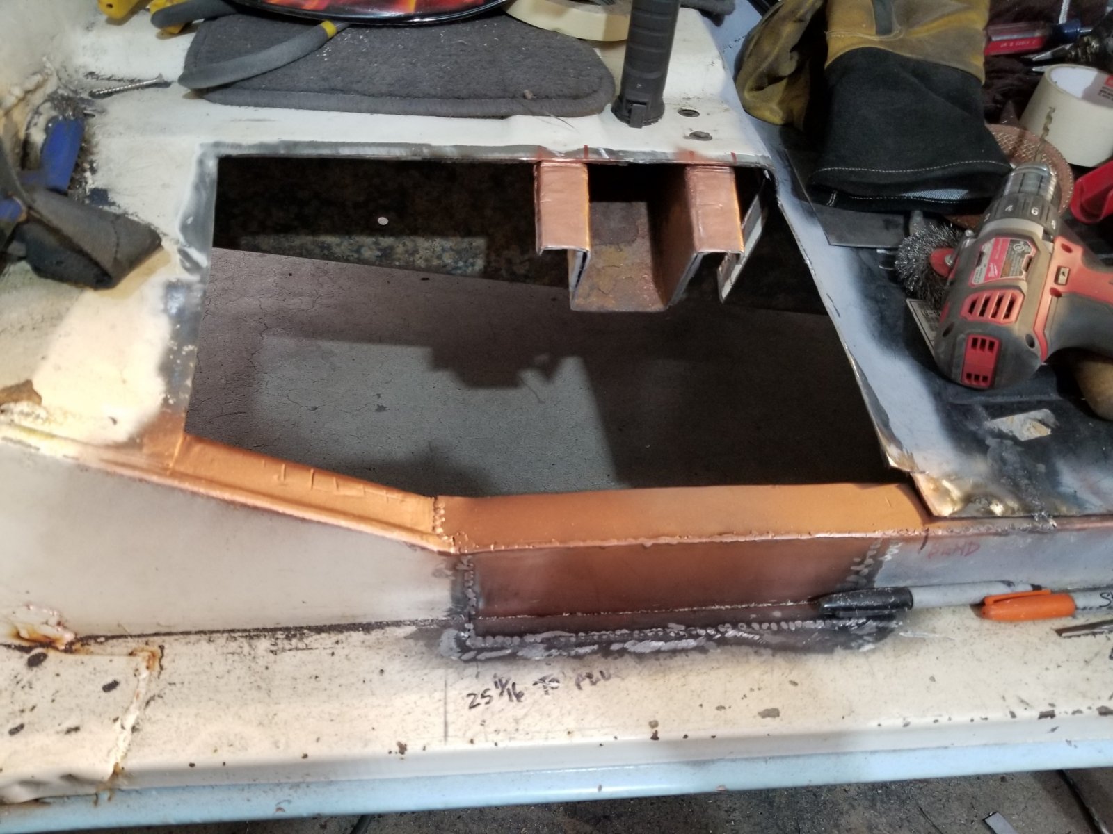

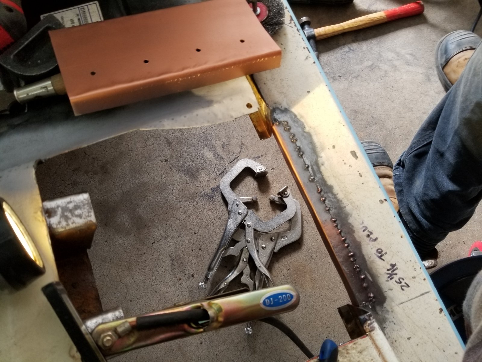

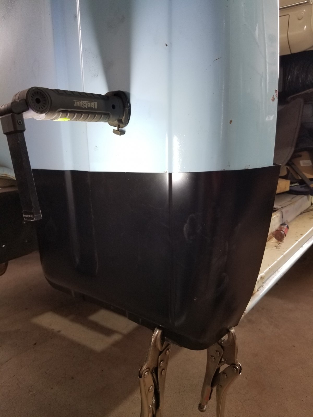

  21. Getting near the end for the cab:confused:! There was a ton of Bondo in this corner. New p***enger cab corner fitment was pretty bad. Inside corner profile was too shallow and the outside near the door was too deep which took most of the day to rework. Suspect I have an old BC Highways truck on my hands. While grinding I hit orange under paint but, over primer. Back in high school Highways trucks were orange - that orange. The repair is more visible than the other side but, this one was way more work. Think I got a bit too much heat into the part that will be hidden by the box. Nailed it on the outside visible part. Might be tempted to put a thin skim of mud on this one.

  22. This is the last patch I'm going to do for this round of the build. 4 pieces today from scratch. When I tuck into it again next winter I am likely going to pull the cab off. When this is complete we will start bolting the whole show back together.

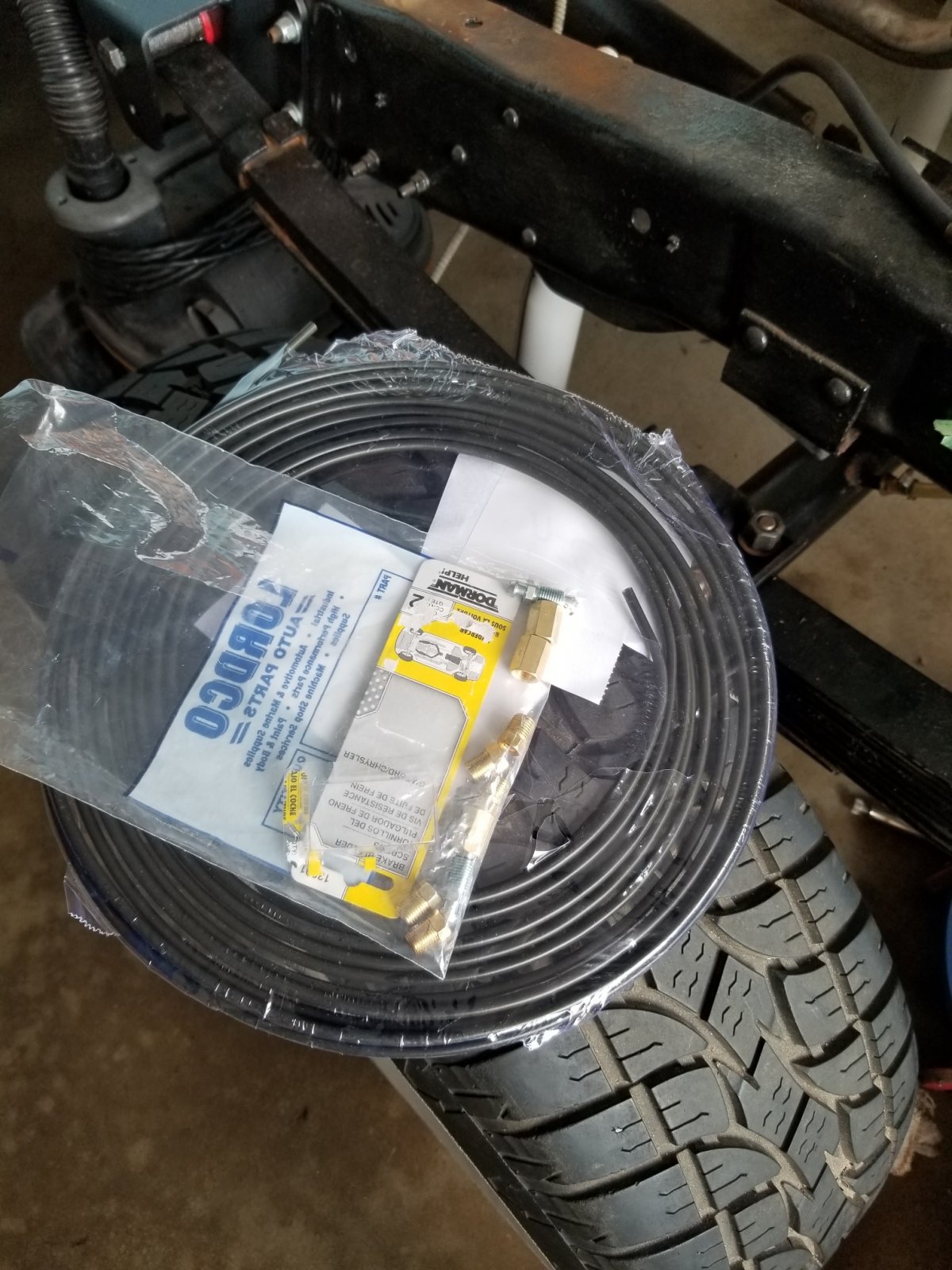

  29. And this is from last night. Have to use all available time to thrash this thing to get as close to our date as possible. It's like the playoffs, we are mathematically eliminated but, if we were meant to get this thing done we will. First time using Nicopp brake line. Super easy to bend and flare but, the less than straight lines oddly makes me cringe a bit. I know it's my professional life mindset interfering with, it's only brake line task. May have to do steel at the master because I'll look at it every time the hood is up.

    Love the checkered flag on the diff. My 38 Plymouth had that on the firewall and driveshaft!
