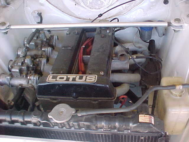

    I had the same model car as yours but with the "perked up" engine option
    And the period correct wheels for these cars are "Minilites"
    I really miss my Cortina ! It was the most fun car I ever owned [I loved racing it in the rain where it would blow the doors off high horsepower racers]

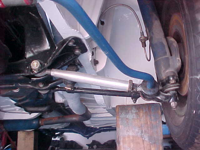

    I cut-n-shut the front LCA's and welded a 7/8" UNF bolt to them. Then machined up an alloy adjustable LCA with a L/H thread Heim on the inner. [camber adjustment was easy]

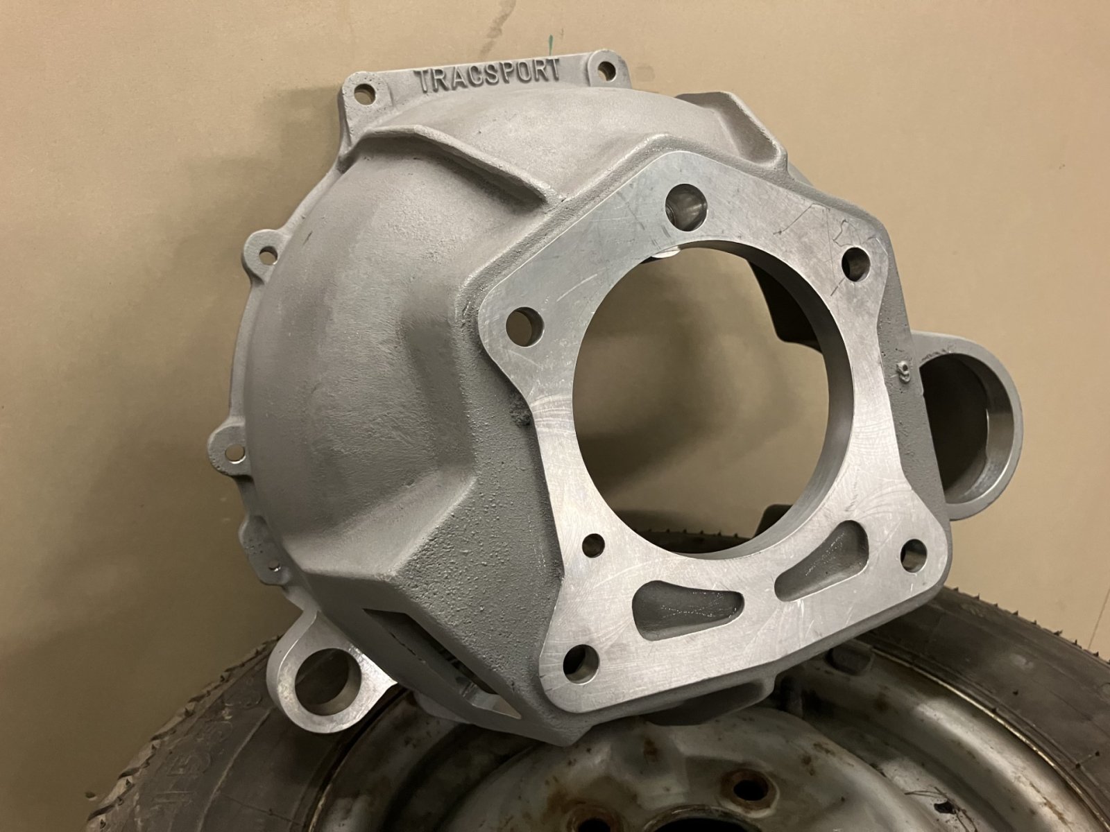

    I'll be using a 2 litre Zetec (which I have) and a 5-speed Sierra Type 9 trans which I also have.
    I have this bellhousing for it, to use the original Cortina slave cylinder.
    Bought it from Retroford.
    I appreciate your advice on the brakes, thank you.

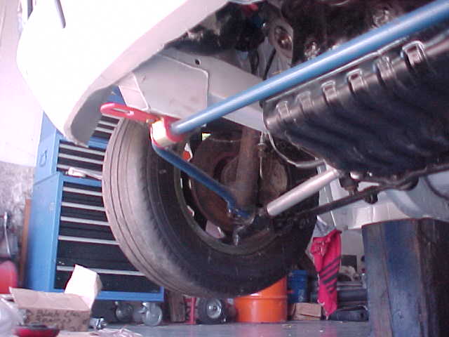

    Those callipers are what you want.
    Especially when you can use vented MK3 Capri discs.
    I used Mk 4-5 calliper setup and got some "Performance Friction" 90 compound pads cut to shape .
    I could almost stand the car on the headlights.
    My Cortina was LHD [which is extremely rare in NZ] and one problem I faced was brake fluid boiling over onto the exhausts which caused a fire once. But I never had any stopping issues ever.

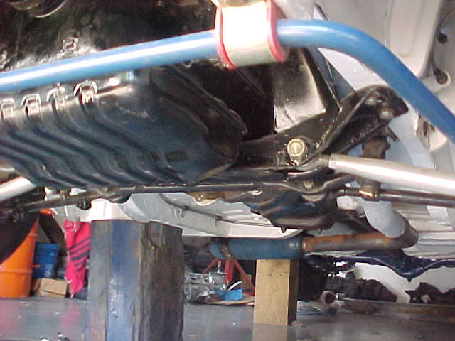

    Your biggest issue with a Zetec is finding a suitable oil pan .
    You will need a steel pan to cut in modify.
    On my engines I built a trap-door baffle system inside. And the WINGED SUMP was donated off a Toyota 2LT Diesel engine
    The swaged winged sump looked Factory
    Note the lowered front mount for the sway bar. This created Anti-dive under braking
