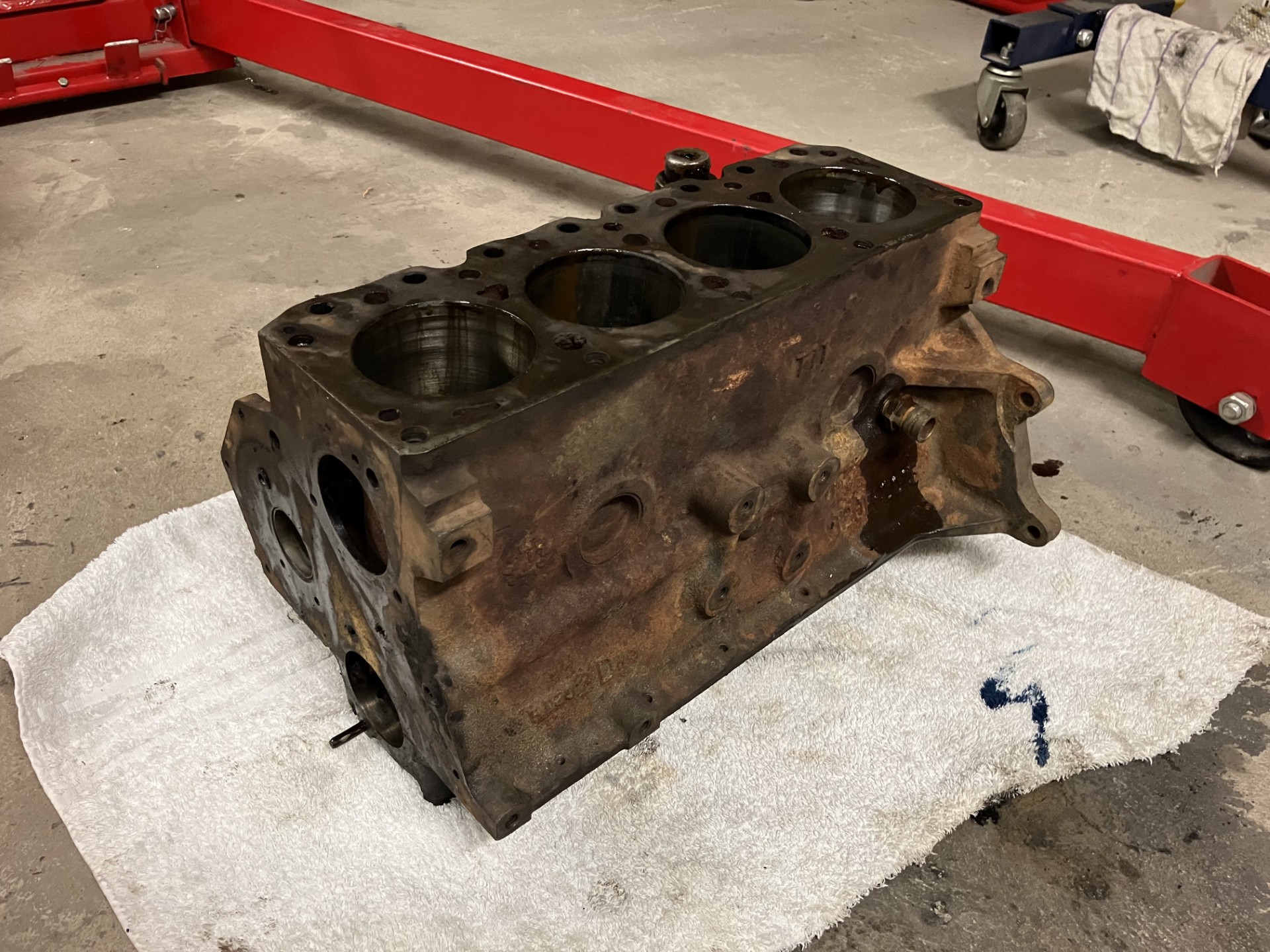

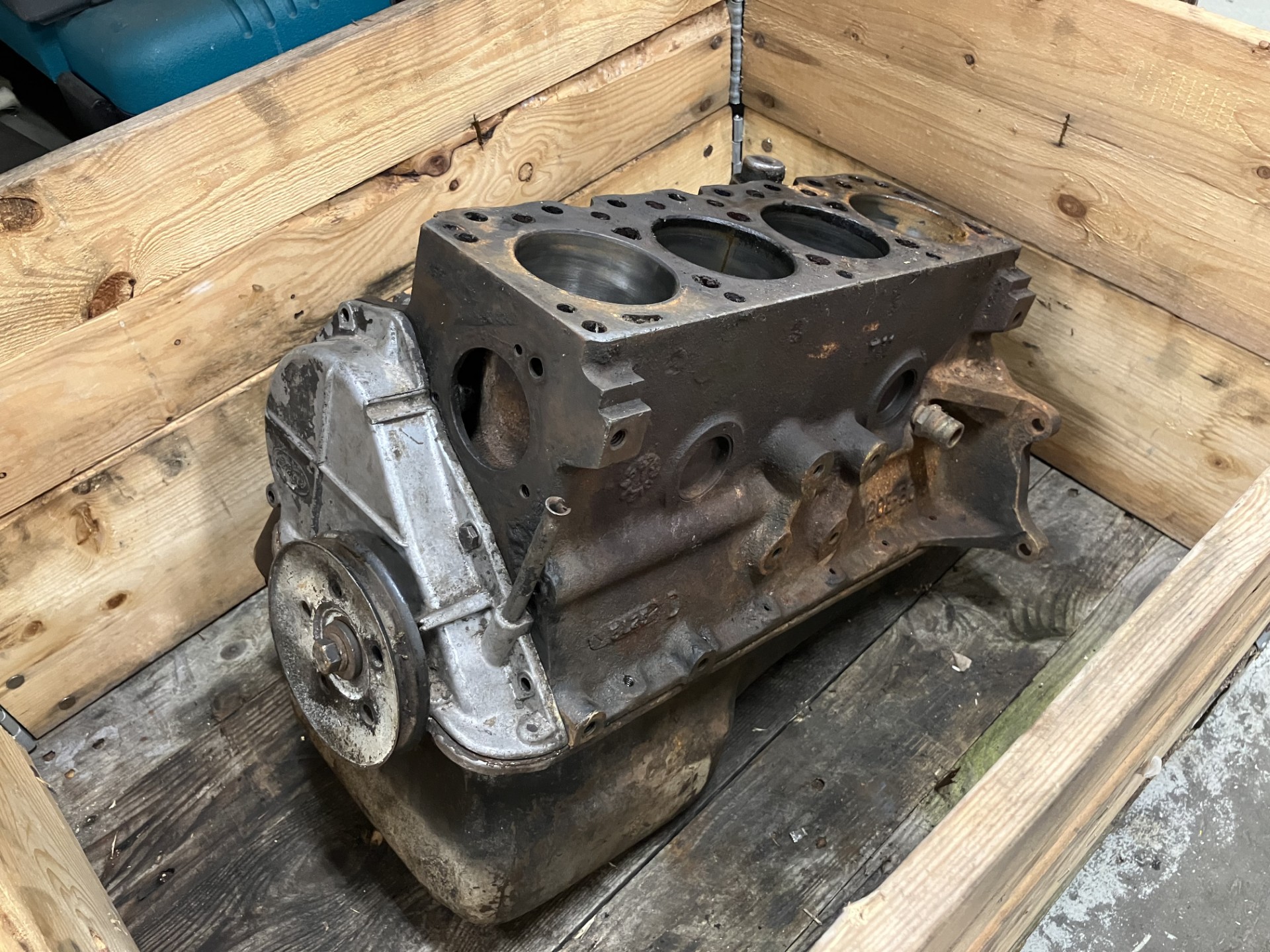

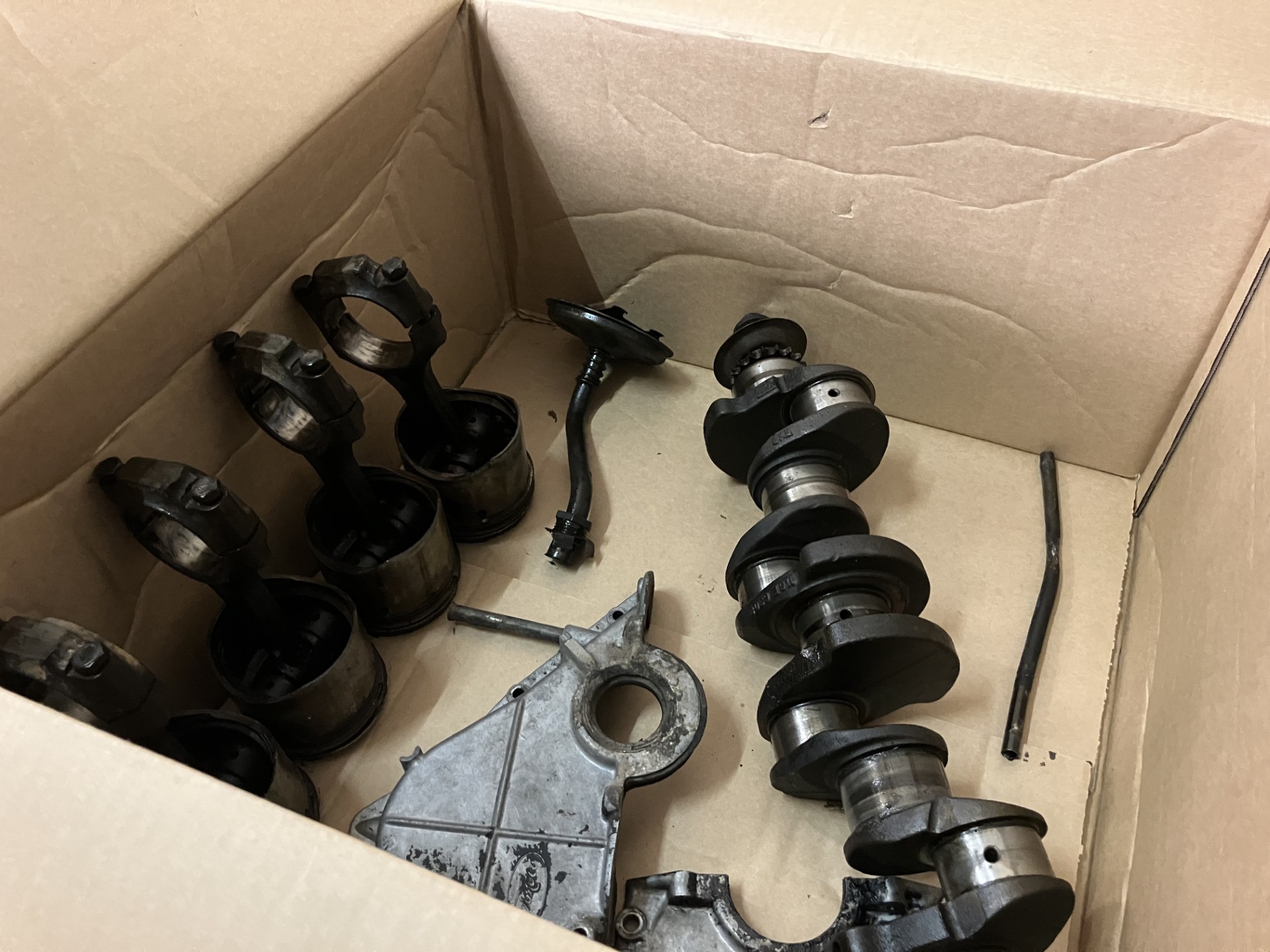

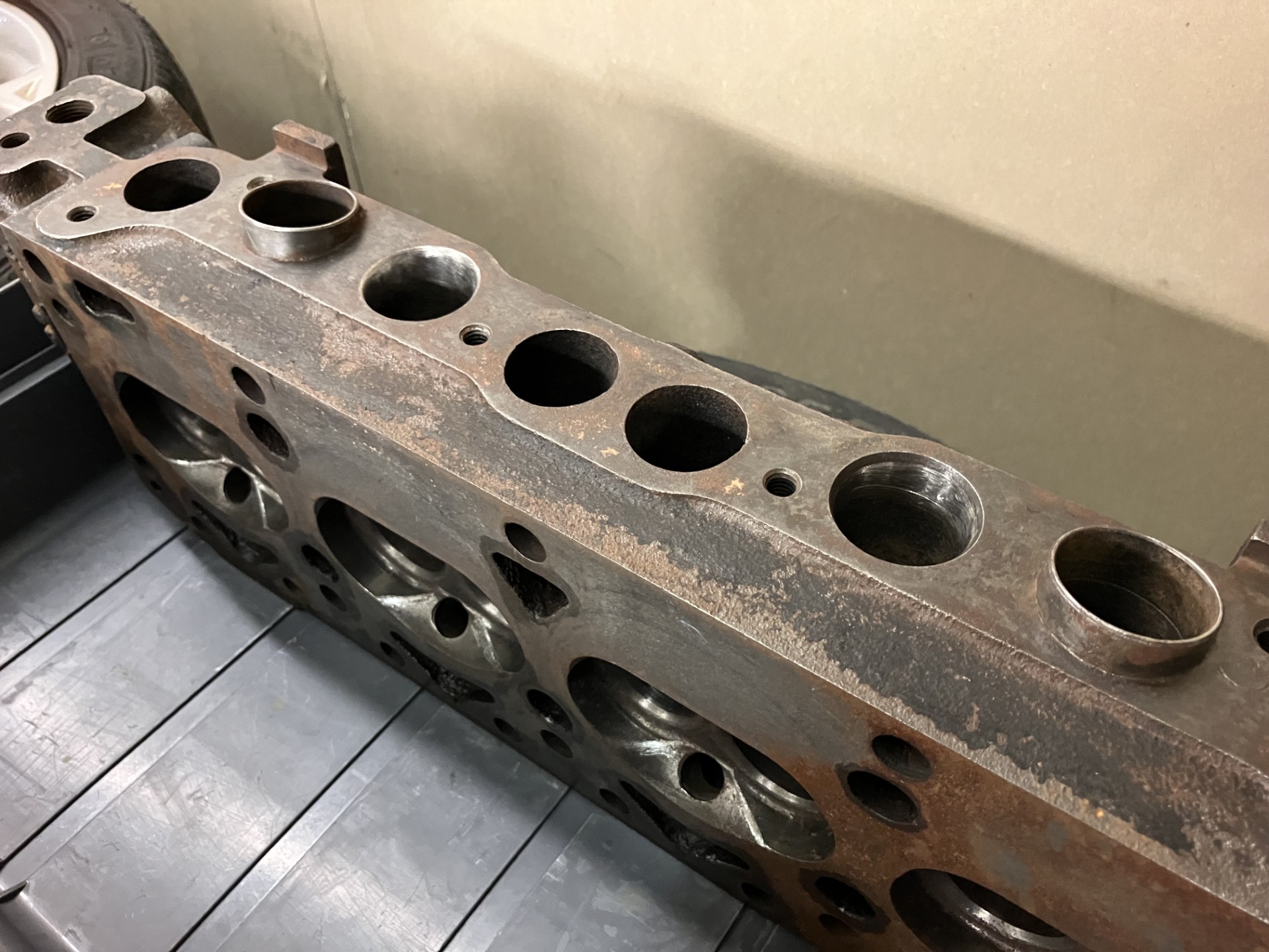

    Boxing day was spent tearing the 1500-engine apart.
    Ready for cleaning, inspection and then off to the machine shop.
    I also got the inner intake ports cleaned up a bit so now the head is ready to be converted to unleaded fuel and some milling to raise the compression just a little bit.

    Is that a stock 1500 block? or the taller deck 1600 block?
    You can take a 1500 pre-crossflow out to 1680cc reasonably cheap. By picking your components correctly
    You need a 1600 crossflow crank AND pre-crossflow 125E Rods
    Then you hunt down a set of VW 1500 [air cooled] Flat Top Pistons that are 83mm bore standard or 83.5 oversize
    These pistons have a 39.6mm compression height
    1500 block is 200.5mm deck height [200.4mm to 200.6mm]
    125E Rods are 121.92 length
    1600 crank has 38.8 throw [77.6 stroke]
    VW pistons have 39.6mm compression height
    That leaves 0.18mm deck clearance [0.007"]
    83mm bore = 1680cc
    83.5mm bore = 1700cc
    And the engine can look stock on the outside
    Edit: if you're going to turn a 1500 crank to high rpm you will need to cross drill the crank oiling because #2 and #3 rod journals will starve the centre main journal.
    Ford performed this mod at the factory on the 1600 crank

    This is a stock 1500 block, 120E-6015 casting number.
    If going the route of 1600 crank I guess I would also need to use a MK2 Cortina oil pan and rear oil seal housing, for lip seals instead of rope seals?
    Sharpone and porkshop like this.

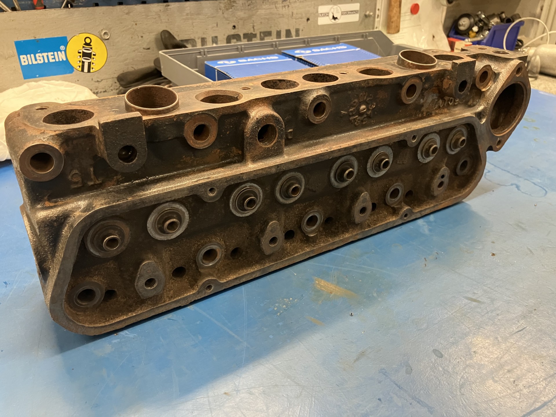

    Dropped the head off at the machine shop the other day to have it converted to unleaded fuel and some minor milling.

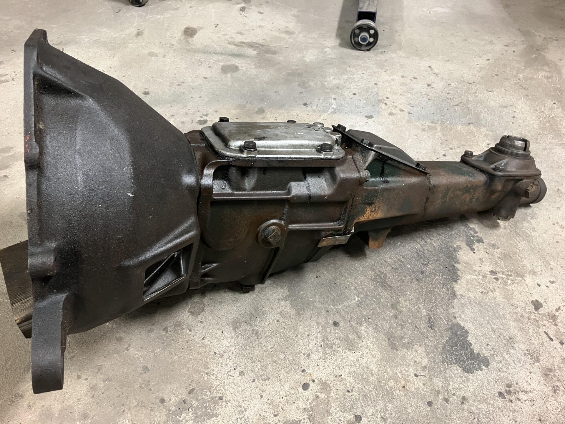

    Also found a gearbox from a MK1 ****** Mexico, better gear ratios than the standard box in my Cortina.
    Plan is to build a "hybrid" gearbox by replacing the tail housing on the Mexico gearbox with one from a standard Cortina gearbox.
    This will give me the better gear ratios from the Mexico while I can retain the original long Cortina gear lever = No cutting of the floor.

    Got the head back after milling and conversion to unleaded gasoline.
    Just some paint needed now.
    Sharpone, Deutscher, porkshop and 2 others like this.

    Down our way the 2 boxes were incorrectly called a "bullet" [early] and "rocket" [late]
    Those were the names off the early and late compe***ion boxes.
    The late box [behind 2.0 SOHC] is a "Type E"
    I had a genuine "Rocket" in my Lotus [the ratios are very similar to a M20 Muncie]
    Ford converted these boxes to close ratio using a special Input , Countershaft [Cluster] , 1st gear, 3rd gear.
    The most abused gear for rallying was 2nd gear, so Ford kept this as an "off the shelf" for easy sourced replacements.
    If you want a Type E transmission with the forward shifter position check out the Australian MK2 ******s.
    They were all 1.6 and 2.0 SOHC engines .
    The Aussie Type E trans had a special tailhousing with a forward mounted single rail shifter.
    Here is an Aussie Type E box
    For a street car [if you have a Type E bellhousing] a better choice would be a Type 9 5-speed from a Sierra.
    It allows you to retain original [or lower 4.44:1 van] ratios and is more highway friendly
    You will need to move the shifter hole and crossmember rearward
    Sharpone, Deutscher and porkshop like this.

    I don't want a Type E or Type 9 since I don't wanna cut a new shifter hole.
    So I'm staying with my plan to use the 2000E ratios from the Mk1 ****** Mexico box.
    More fun to drive with 2.97 on 1st gear compared to 3.54 which I have now.
