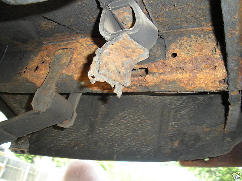

    A buddy of mine wants to do a Altered wheelbase straight axle 65 Cyclone build. All the Uni Body project Cyclones he has come across have this ugly rear under trunk Frame Rail detioration similar to the attached pic. As we know the frame rails are vital and a load bearing structure however NO FIRM offers replacement sub frame rails for the Comet, Falcon family and they differ from the early MUSTANG.
    Is there hope for a rotted 65 Cyclone for a Alertered wheelbase build?
    If, can a man fab a full frame in lieu of patching up already weakened Uni Body?
    Thank you Kindly.

    On my falcon I cut behind the rear shakel and moved the rear end forward 10 inches, I had a sheet metal shop bend up some metal to tie the rails to the back of the car, I cut them to length and welded them in, He could do the same thing, just cut out any bad metal and replace it.

    You're kidding, right? Just slap up a 3X2 rectangle set of rails that tie into the front frame horns and it's done. Make a template to hold up to the floor and cut out just that section and slide the rails up and weld away.
  5. No reason why you couldn't back half it. Build yourself a rear subframe then take some square (rectangel?) tubeing and build a set of subframe connectors. Put the rear end where ever you want then move the wheel openings to accomodate.

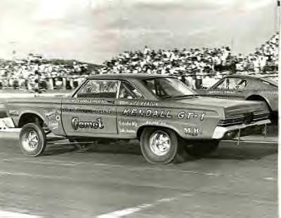

    food for thought ..

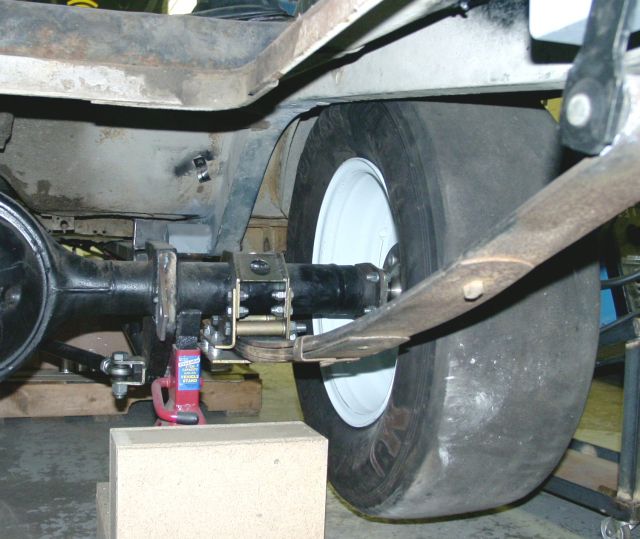

    Hear is the rear set up on mine. Crites rear spring relocators with 1" mini tub 8" wide wheels mount enough slick to do 5,000 RPM launch with the wheels in the air.

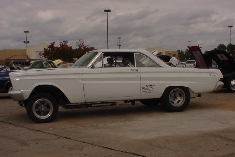

    Here are two pics. Both stunning examples of the 1965 Cyclone. I know its hard to tell but to the best of your abilities do both these machines have the rear wheelbase segment moved forward or are they in factory stock position. A third pic of factory 1965 Cyclone is attached for comparrisons.

    Love 65 Cyclones. What you describe you want does not sound like a B/FX car
